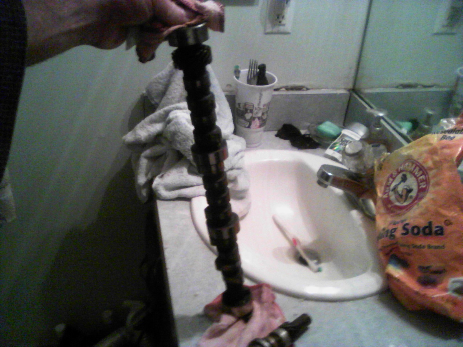

Please tell me how to remove the camshaft from the 3.1 engine.
My guess is it pulls out from the front. However, the camshaft itself has two or three
tabs near its front end. These prevent removal.
The 1992 Service Manual says only "remove camshaft."
Re: Camshaft removal, 3.1
It just pulls out the front... as you said... It can not be removed with the lifters in place and IIRC the oil pump drive gear also needs to be removed.
Juro
Posts: 43
Joined: Wed Nov 05, 2014 10:41 pm
Post by Juro »
all lifters have been removed.
this is how far the Camshaft will come out.
the oil pump is still in place, but how does it come in contact?
Oil pump drive gear is holding it in place.... The distributor plug on top of the motor by where the transmission attaches.
See how the drive gear is before the last bearing journal...
If the driven gear is still in the block it stops the cam from moving any further.

You need to removed the oil pump gear...
