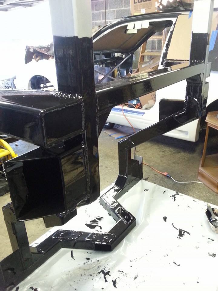

Sand blasted and painted POR15 on the rear sub frame. Next step is mating the rear sub to the body rails and finally having a rolling chassis !!!!!!!
Re: Beretta Z28
feel like i should have went satin on the frame like i did on the axle ........but my buds seemed to like the gloss........so its done......gloss black frame it is.......

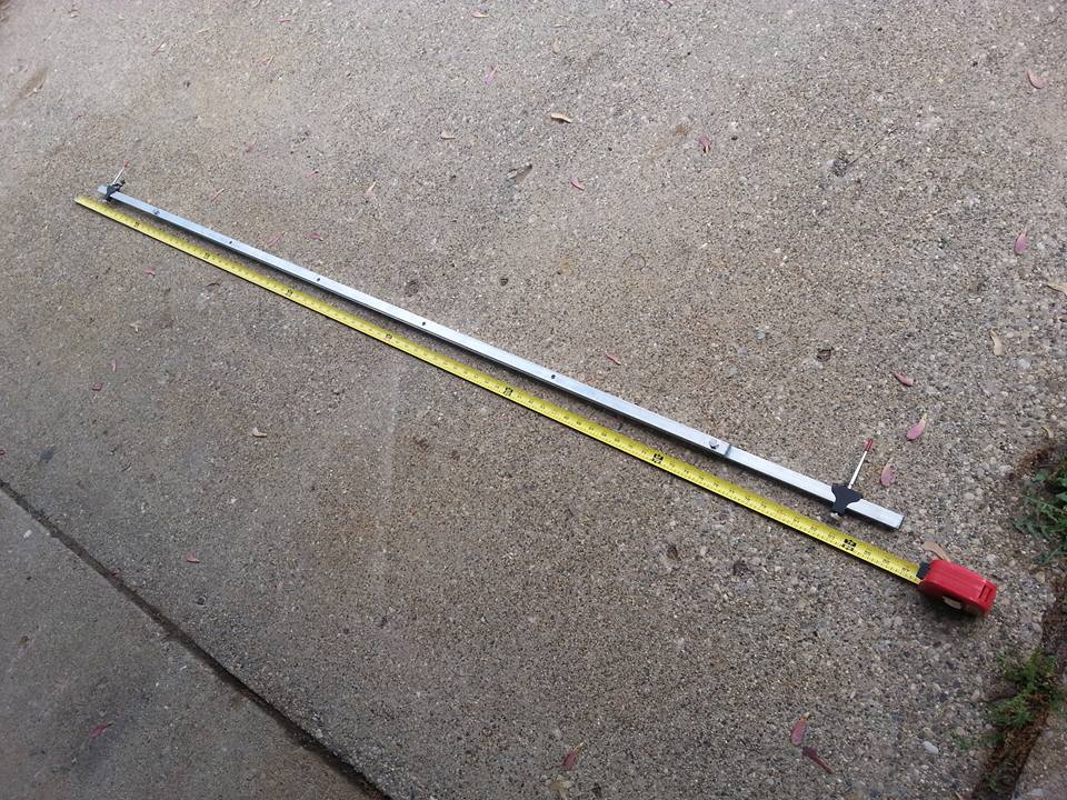

prob should have done this a while ago ....... but made an adjustable trammel bar gauge for measuring and mirroring points so I can make sure my rear subframe is as square as possible when welded to the body rails......I made it so it can adjust up to 11 feet in length if need be for checking those Long diagonals.....i gotta square this frame up and weld it already.........
