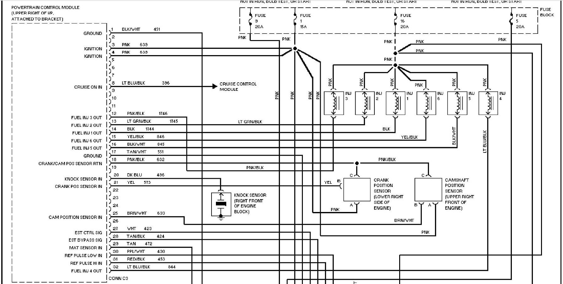

The injectors you can Ohm test from this main bulkhead connector...
Here is a picture of the wire colors that go to the injectors... Pink is the common hot, or 12v lead, and the grounds are what goes to the ECU to be triggered, the six colors are listed on here.
