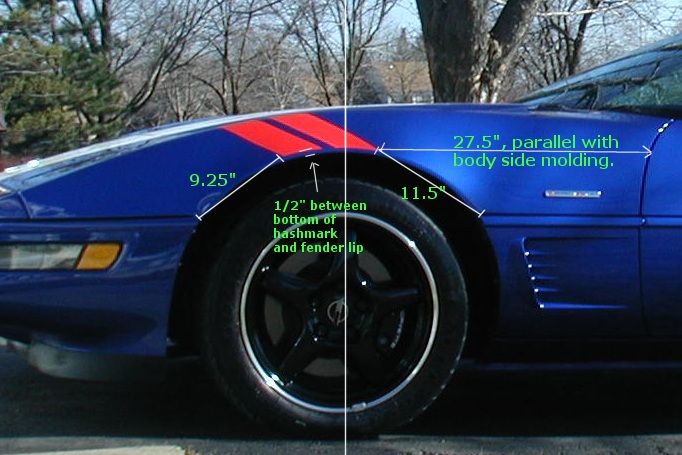

Re: The Derretta, 1994 base with some attitude.
I like the Hash Stripes.
Something I have been thinking about long and hard for my California GTZ, but only on the Left side.
I do have an issue with the outcome however.
Attached are the actual GM Corvette specs FYI.
With all due respect, yours are too far forward, the angle is wrong and they should be trimmed at the fender flare.
The actual measurements won't help you much. but they are close, and the hub center line matters and will be relative.
But what a great car!!! :beer:
Be Well.

Re: RE: Re: The Derretta, 1994 base with some attitude.
Post by whiteretta »
Asylum wrote:I like the Hash Stripes.
Something I have been thinking about long and hard for my GTZ, but only on the Left side.
Attached are the GM Corvette specs FYI.
With all due respect, yours are too far forward, at the wrong angle and should be trimmed at the fender flare.
But what a great car!!! [emoji481]
Be Well.
It's fine, the paint is far from perfect, and if the car gets repainted in the future I'll have it done properly and professionally lol. These are leftover vinyl scraps from over ten years ago too!
