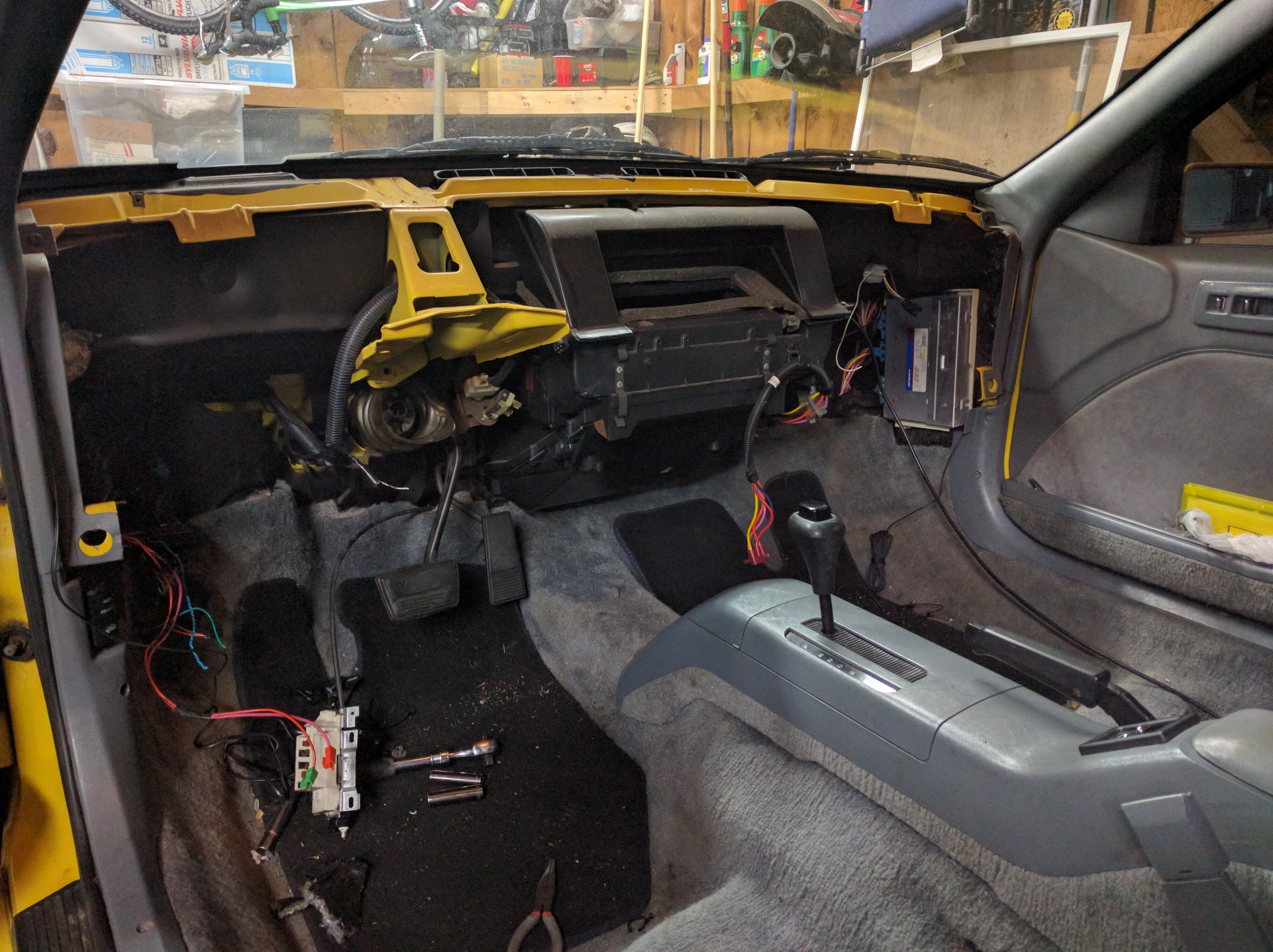

Slow and steady progress on the Indy... The dash I acquired from Geoff and his GT that he parted out was in much better shape, but as almost all of these dashes are it was lifting from the reinforcement base around the defroster vent and such. There is only one small crack in it that has been previously repaired so that's where it is much better than what I had. I've spent the last few days gluing and bracing the dash to hold those lifted parts down... So far so good using "Amazing GOOP" takes a while to dry but holds pretty good in the end. I hope to be installing the dash at the end of this week and have the car back to a running state so I can drive it some and make sure nothing else is wrong with it. I also purchased some cool white LED dash lights. It will be interesting to see how these change the illumination properties of the Digi Dash.
From the Heater Core swap... Should have just waited till the dash was out... Oh well.
Pulled Dash
Old lifting
Harness removed... Cleaning up keyless and remote start setup.

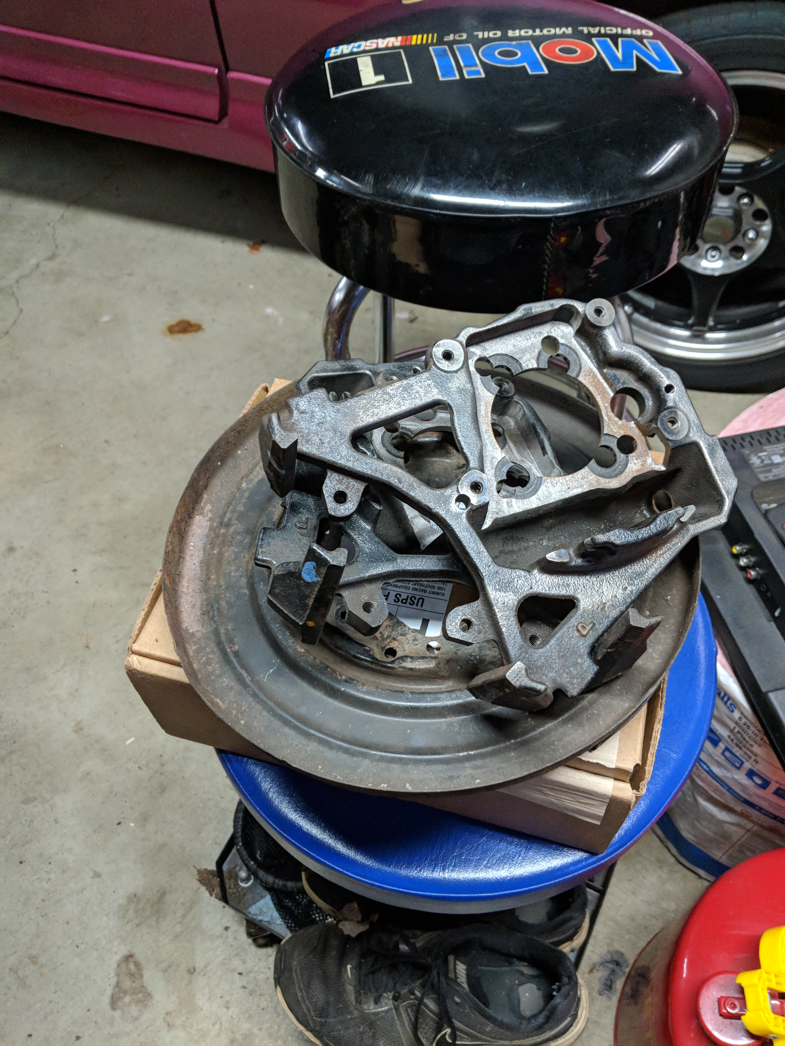

It's getting some love again, this time in the brake department... New 92+ front disc setup and the Neon rear disc, as well as swapping in a new brake booster and a 2000 Monte Carlo non ABS master cylinder.
While I'm in there I'll also be installing the Del-A-Lum bushings I got for the front control arms and possibly installing the poly rear swing arm bushings I got from Tyler... I just want to make up a center spacer for them since they don't fill the whole bore.

And here is one of the big problems I found when doing the bushings... No clue what application this arm is for, but the right side arm did not match the left side when it comes to bushing size, and is incorrect when it comes to the correct bushings for a Beretta... They have always been a small front bushing with a large rear... NOT the same size front to rear. Shane is going to send me his 92 GT arms since he already has a set with Del-A-Lum's installed and wont need his original ones.
