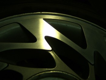

Post by ifixalot »

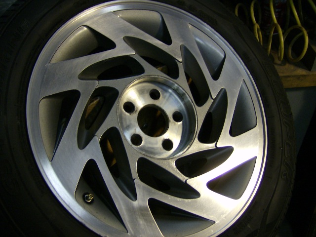

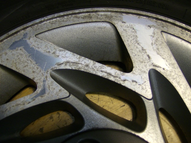

I'm using some mold maker polishing stones to clean up the aluminum after stripping the clear off.
Then I spin them on my Bridgeport mill using a wire brush to shine the surface. Not perfect but much improved
over what they were. I can't wait to put them on the 88 GT. Then I'm coating them with polyurethane.
It takes a few hours per wheel. I just hope it stands up the the weather.

They look very nice. Good work!

Dang that looks good, awesome job man!

I got em all done. I'm thinking of putting some tire dressing under the edges of the rims to try and combat
the corrosion that causes rim leaks. Then I can install them on the 88.

Maybe use some 303? I don't know if it will do much different, but it should hold up better than regular tire dressing, I would imagine. Not sure how either would hold up against the heat of the wheels...

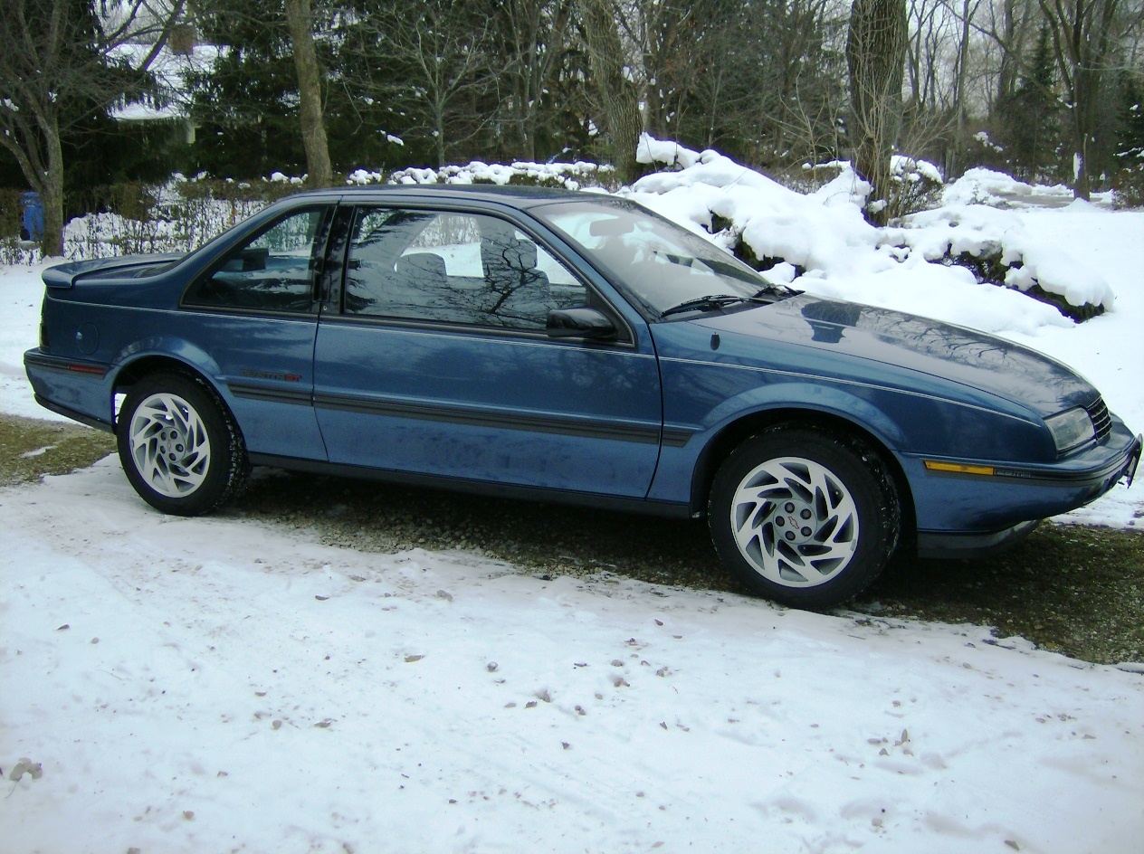

I might that that 303, I see it on Ebay. In the meantime I used Turtle Wax "Ice" that I had lying around.
Below is a pic my 88 with her news shoes.

Looks good! I love that color too. AutoZone sells the 303 now as well!

Looks great. I recommend putting some sort of sealant to protect the wheels.
