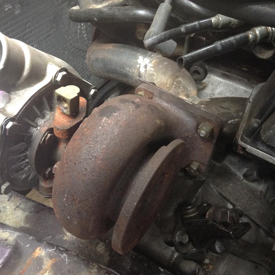

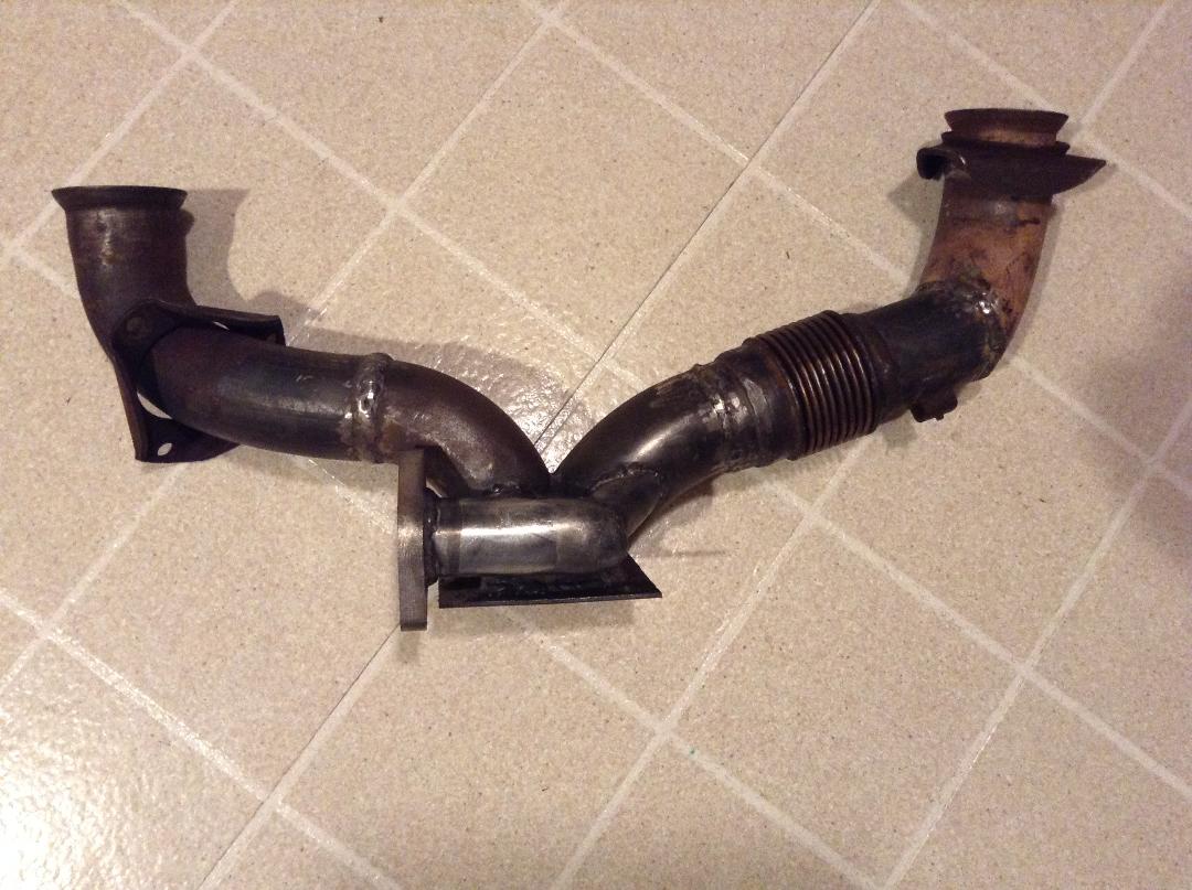

Got the crossover pipe built today, except for the T-4 flange and outlet for the external wastegate. My Garrett T-04 has an offset angled inlet: the front part of the port runs straight into the housing, but it has about a 45-degree sweep-in at the rear of the inlet, so I used a 90-degree elbow from the front bank directing flow straight into the housing, and the rear bank angles in to let the housing turn the flow. It was a little trickier to build, but I think it will help to keep both banks balanced (at least at some RPMs) and still allow me to push the turbo forward a bit more to give more space for the intercooler. It will definitely flow better this way, and far far better than just chopping a hole in the side of the crossover pipe would. :no: I haven't 100% decided on just wrapping the crossover pipe, or if I want to modify and re-use the factory insulated heat-shielding.
Edit: Finished the flange today, and snapped a few pics. Remember, this is 2.25-inch pipe GM used on this thing, from each bank!
T-04 in for fitting...
Twins might have actually been easier after all... Maybe next time.

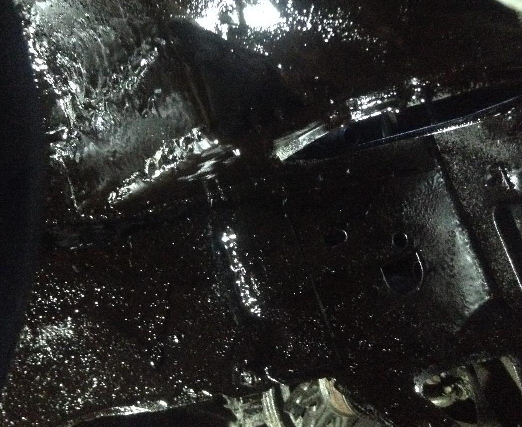

We've talked recently about how hard it is welding thin metal -well this is as thin as these cars get.
Hard to see anything in this shot.  The undercoating really sealed everything up though.  It was hard making myself stick to just stitch-welding the new corner in, but it is better that way.  There is a lot of overlap here too, on both sides of the cut.
I started out building an actual battery tray out of stainless steel, but it is such a tight fit it just caused problems. So, I just grafted-in a small corner piece instead. There was about a 1.5 inch gap created in the steel, to give an idea how much the metal had to be moved to make room for the battery. Given the usual corrosion issues that batteries cause, I am glad I listened to my own complaints and upgraded to the stainless for this part. I then primed the whole area, and topped it off with rubberized undercoating. I also applied a generous coat to the underside, where it could be exposed to water. I am actually pretty happy with how this all turned out.
I still have to do some paint touch-ups here, I do not have any BRM touch-up paint for it, so I may just go with black industrial-grade paint or epoxy paint for now.

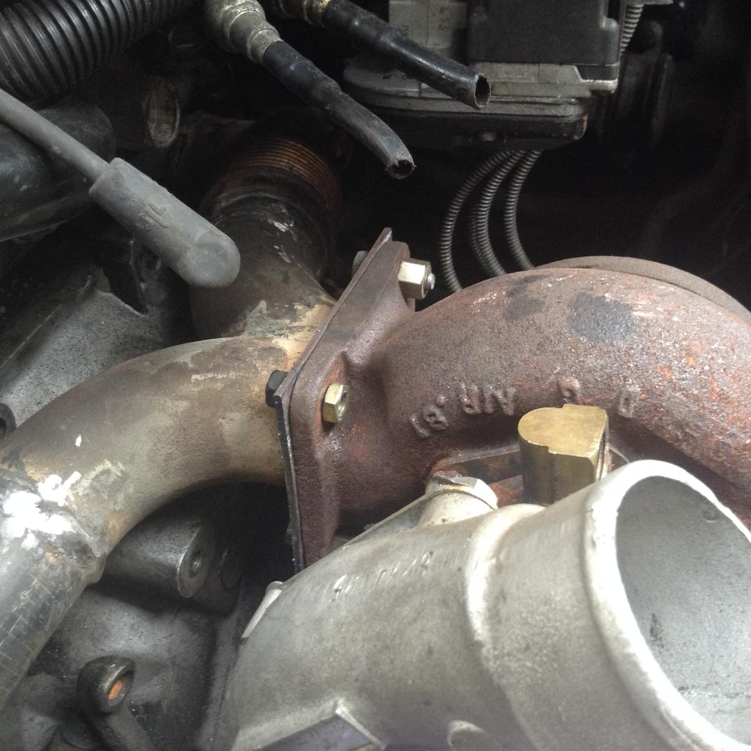

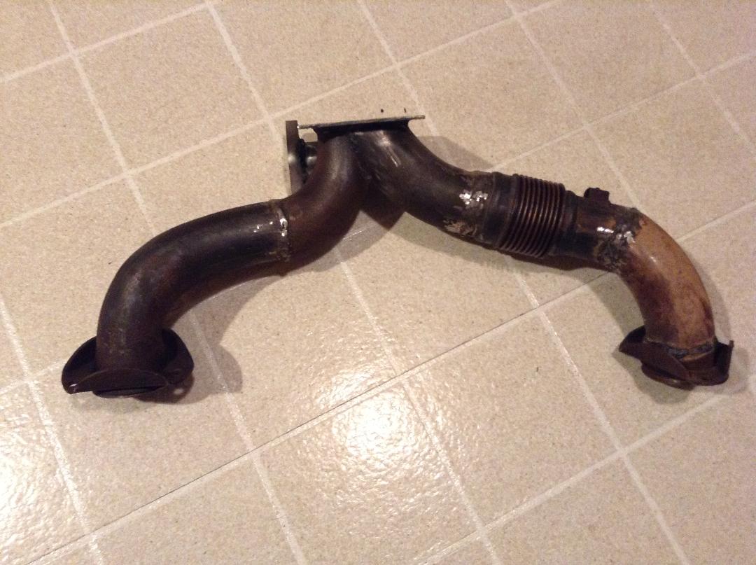

Finally took enough time today to finish the external waste-gate supply-pipe from the cross-over pipe.
I really didn't want to chop into the joint of the two banks as they come together and into the turbo as it just seemed like it would effect the exhaust flow, especially from the rear bank. So, I decided to draw individually from each side of the joint.
It turned out pretty clean, but I didn't like having to add the Waste-gate supply pipe to this, it already looked done to me.
You can see clearly how different the angles of the two banks are, directed into the turbo's inlet.  This matches up with my T-04s offset turbine housing.
I am really happy with how this turn out. Now if just needs finish cleaning, paint, and thermal wrap. I must say, adding the external waste-gate is a PITA -it is a good thing that I am deleting the coolant pipe running from under the throttle-body (I have no need for a TB heater, thanks) to the coolant outlet by the water-pump. Not only does it clean the engine up by removing pipes running half way around the engine, but it adds over one inch of clearance to the front cylinder head in front of the throttle body, so the waste-gate actuator valve has enough room. Now, running the pipe for the valve's outlet will still be tricky, as the clutch slave cylinder sits right underneath the valve, and my outlet points down towards it...

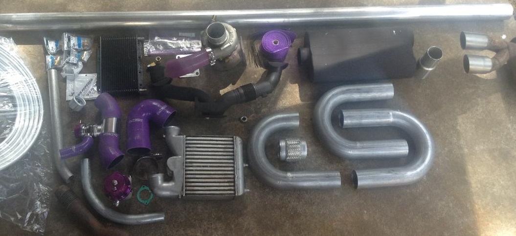

Snapped a quick pic of the exhaust parts and turbo pieces. I had intentions of running two 2.25-inch pipes out of the muffler (single 3-inch in, dual 3-inch out, would use a pair of reducers like the one pictured with the muffler to bring it down. A single 3-inch pipe flows more than two 2-inch pipes, btw, so I was going to go 2.25-inch to keep restriction out of the exhaust) over the axle-beam, then to the rear as semi-duals, but the muffler body is too long to fit in the catalytic converter cavity, so the exhaust will just stay 3-inch single to the rear, with the muffler mounted in the stock location and splitting from there (I waited to buy the smaller tubing because I wasn't sure the Flowmaster would fit). My old '95 Z-26 will be donating its' exhaust-tips (slightly reworked to mirror the stagger originally present), so the car will have four total outlets, with a factoryish look. Not certain what I will put back on the old Z yet -I would like to use a single large rectangle, but I'm not going to put any money into it right now, it runs and drives nice but needs so much work I'm not sure what I'm going to do with it yet -that is for another thread though.
98% of the necessary parts for the intake and exhaust, including enough aluminum tube for four or five turbo oil-return setups.
I am overall really happy with how tight the intercooled intake setup is. It all stays inside the bay, nothing running back and forth across the car, nothing in front of the radiator core-support. Clean, short, compact.
Yes, the waste-gate, bypass valve, and silicone intake fittings are all purple, as is the exhaust wrap and even the silicone radiator hoses are purple -hey, the car is Black Rose Metallic, which is really just a super-dark plum color, so it fits. :pardon:
