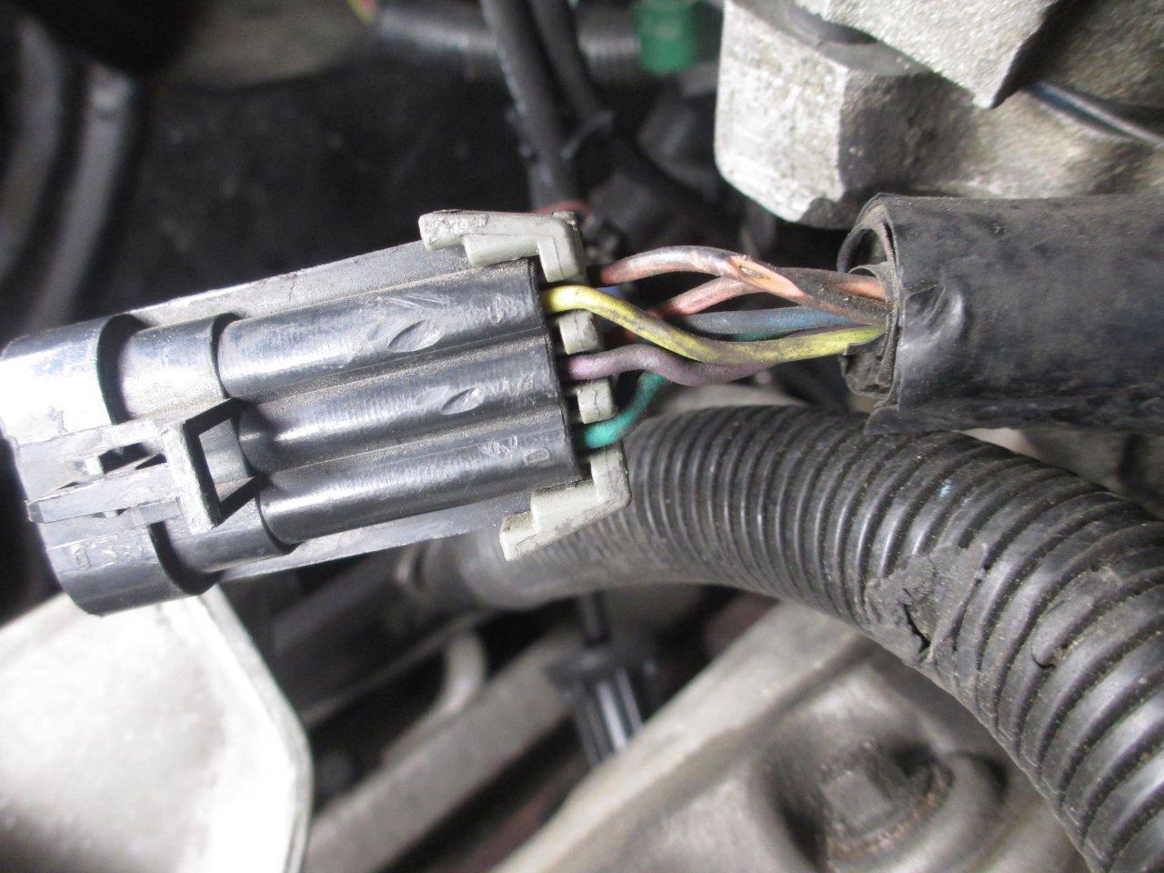

This is one of the craziest electrical issues I have experienced, and a good example of how one thing leads to another, so I had to share:
we are taking the Beretta on vacation in a couple weeks so it was oil change time. I had never put plug wires on it since I've owned it, so I figured that would be a good idea. I also realized I have put 30k on the car! I was pretty surprised and thought time for a fuel filter too.
Got some nice belden plug wires on RA closeout for $9.
So I get this all done yesterday, not bad at all and I took my time moving some harnesses around with zip ties to keep them away from potential rub points.
I start the car and it sounds perfect for about 30 seconds or so, I was just getting ready to back it out of the garage.
All of a sudden: stalls. I think oh it's probably from when I changed the fuel filter. So I crank and crank, nothing. w
Now I'm like: Sh$t! I decide to check for spark, nothing. I'm thinking what the hell happened?he'll
So I get out my OBD 1 scanner thinking id check for an rpm signal. It keeps coming up "no data" so I'm checking the connections and everything.
Then I notice no check engine light! Luckily I thought to check fuses. Fuse #1 is blown, it has a vague description of "fuel injection and electronic control" or something like that.
I put another 15a fuse in that I borrowed from my pickup and as soon as I turn the ign to crank "snap" I hear the fuse blow.
so going through what work has been done and what could cause this, I found it. Somehow I had moved the fuel injector harness just enough that the spinning rear bearing on the alternator had rubbed through the insulation on one of the wires and shorted out!
I had to take the belt off and get the alternator out of the way, but once I repaired the insulation, wrapped the harness, and put it back together it fired right up!
I gotta admit I either got lucky, or I should just be proud of my troubleshooting because I had it figured out and fixed in only an hour or 2.

I've been there before. Fix one thing only to realize your fix caused something else to fail a certain way. Then your stumped and wondering "now what."
Now and then in the past I used to wonder if that rear alternator bearing would ever hurt the wires or if the alternator would melt those wires. Now I want to go zip tie them away from the alternator. lol.
This actually reminded me that I should keep some spares with me.
That whole situation where the P/S lines, alt wires, FI wires, and plug wires run together back there is kind of ghetto.
On my car, I'm not sure if it's a PO's repair or stock, The return line is rubber under the alt, and then it switches to steel line down closer to the rack. The rubber hose barely leaves clearance for everything else.

That was good thinking to go over what you had done to find the problem.
My daughters Saturn blew a fuse related to the oxygen sensor. It caused problems
and warning lights but still ran. I disconnected the oxygen sensor and the new fuse did
not blow. I figured the senor heater had shorted out so we bought a new one and installed it.
She took the car for a ride and all seemed well until she got back home and backed up on the driveway.
As soon and she shifted into reverse, the fuse blew again. So, I thought I moved the wire loom
to the sensor and the wire looms moves just a little when the engine rocks so I examined the loom.
Sure enough the loom was resting on a bolt on the engine and the years of vibration had caused the
blot head to wear through the loom cover through the wire insulation shorting out the fuse.
I zip tied the loom after wrapping it in tape. End of problem. Too bad I couldn't find it before we spent
$60 on an oxygen sensor we didn't need.

I recently had an electrical issue too, on a neighbor's Astro van. They had taken it into the dealership a few years ago for a no-start issue, and they had replaced both the Park/Neutral safety switch (AKA range/position or PRNDL switch) and the pigtail to it, they did a nice clean job splicing in the wires with crimp fittings, heat-shrink tubing and dielectric silicone grease, but left about 10 inches too much wire attached to the new plug and didn't stagger the cuts and crimps (so there was a large bulge in the loom where the crimps were). I hate crimps anyway, but what could I say about it?
Anyway, the Park/Neutral switch went out again, and this time they brought it to me, it actually was shorting out and popping the start fuse, I could see the resistance to ground drop to zero when I pushed on the PRNDL switch housing -problem solved. The same day they picked it up, it failed to start again -intermittently. The new switch was good, the fuse was good, nothing I could find wrong and it kept working for me... I thought maybe the relay as it seemed to be getting hot (Astros use a back-and-forth wiring setup for the starter, going through two fuses, the ignition switch, the PRNDL safety switch, and a relay before finally reaching the starter solenoid, and the PCM even gets involved to authorize the relay actuation... Stupid, just stupid). Finally cut open the wiring and found out that when the dealership crimped the wires, they mashed them so tight that they cut all but one strand to the PRNDL, so when I had replaced the switch the wire bundle had moved enough to cause a bad intermittent connection, in all likelihood it was this bad connection that caused the first replacement PRNDL switch to eventually fail and start shorting out.
