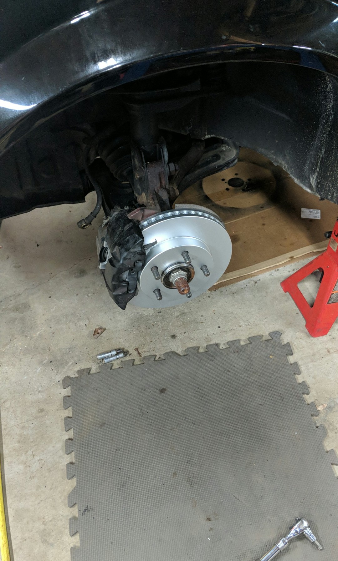

Rebuilt all brake calipers
replaced all brake pad
replaced all rotors

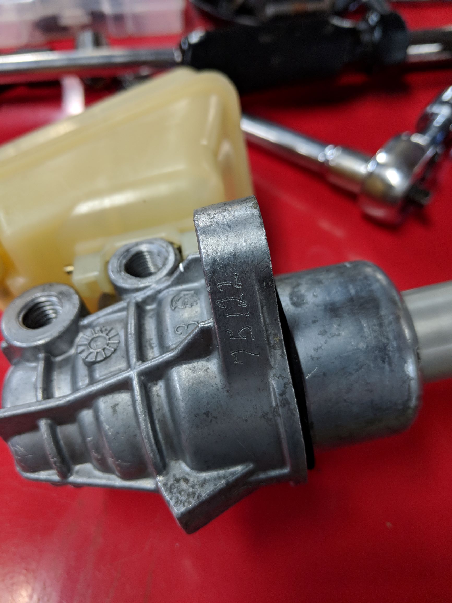

tore down, cleaned up and rebuilt brake master (can't find seals to replace, application unknown)

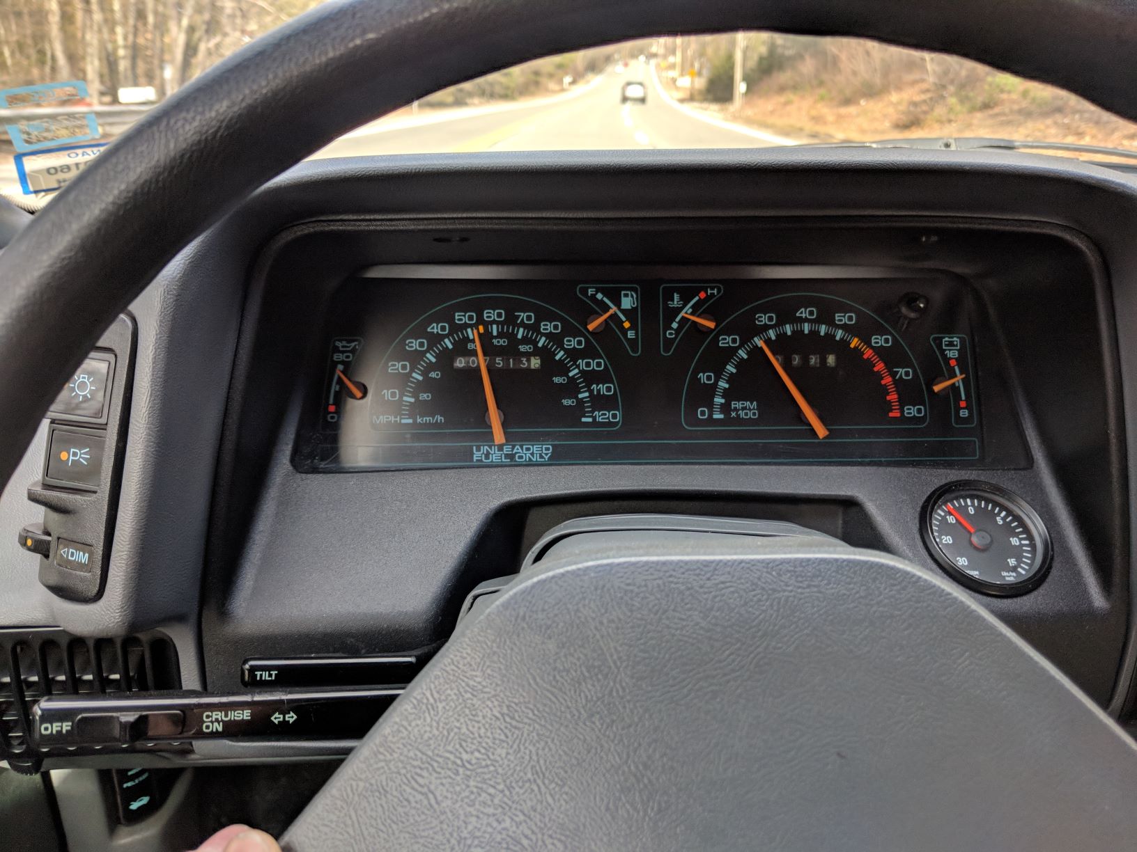

Car had sat for that entire time... When I saw it in 2011 ODO reading, 7471 From what I can read, bad angle.
And shortly after I got it road worthy... yes I know I did not take a ODO pic when picking it up... So at the most the previous owner drove it 30-40 miles since I saw it in 2010.

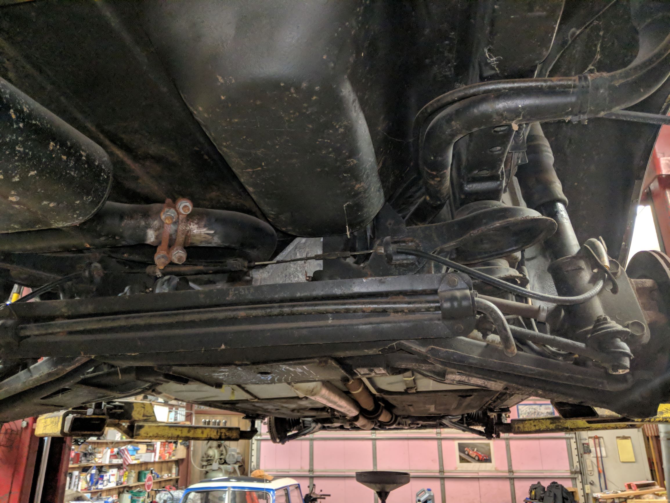

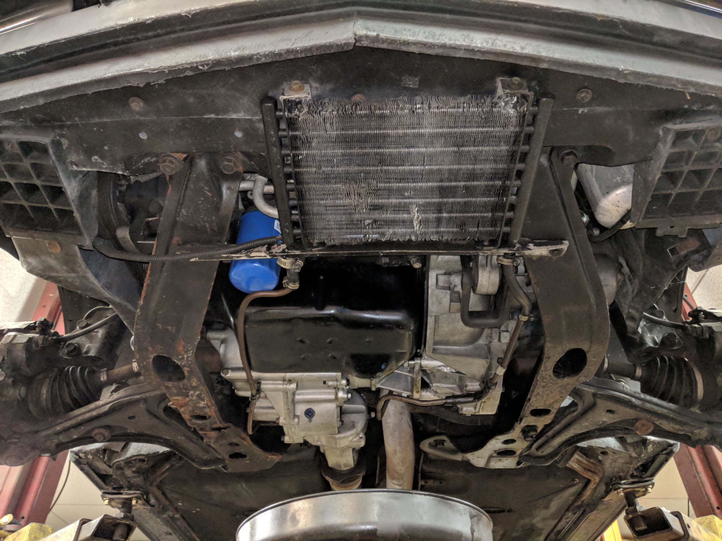

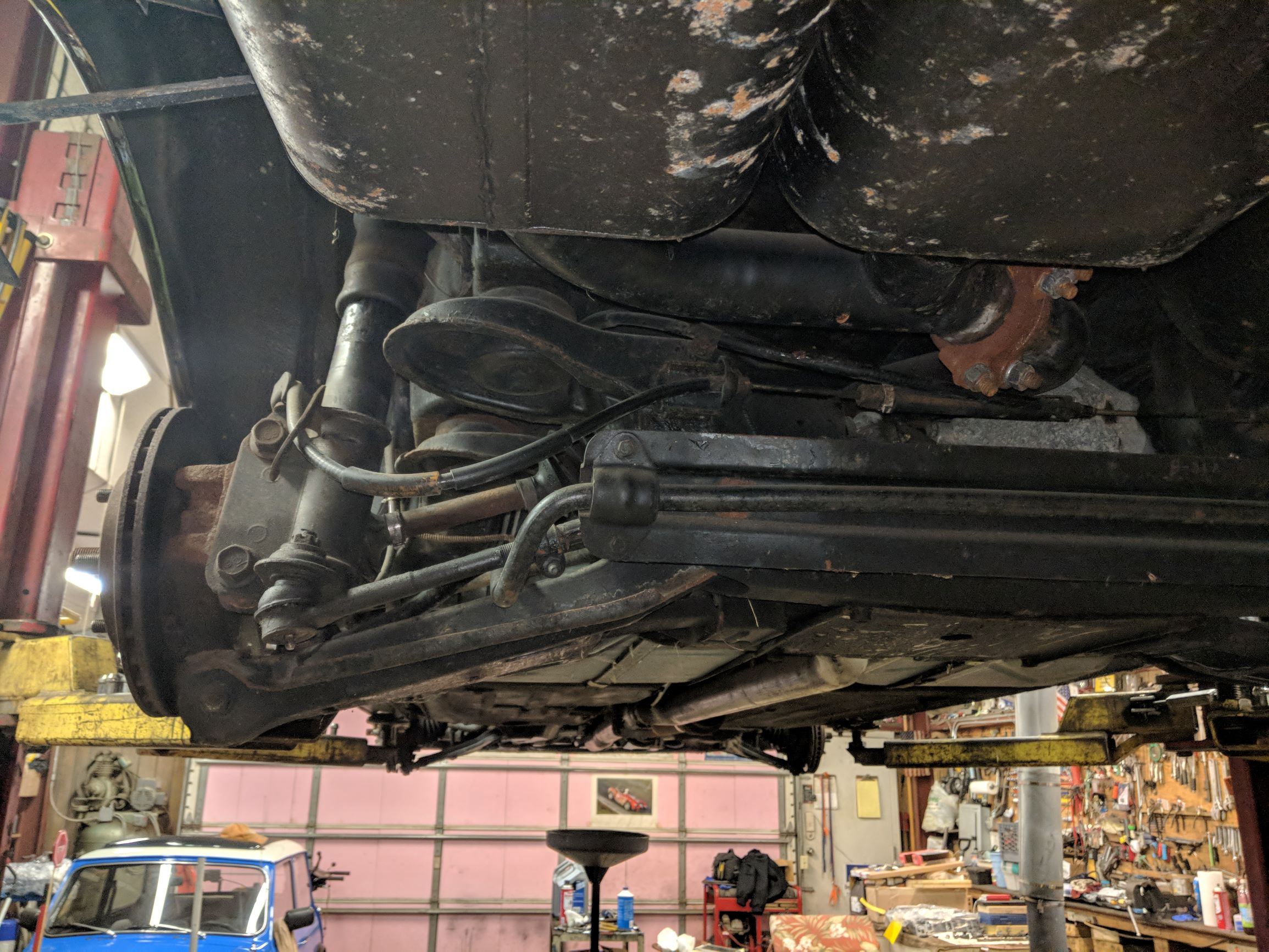

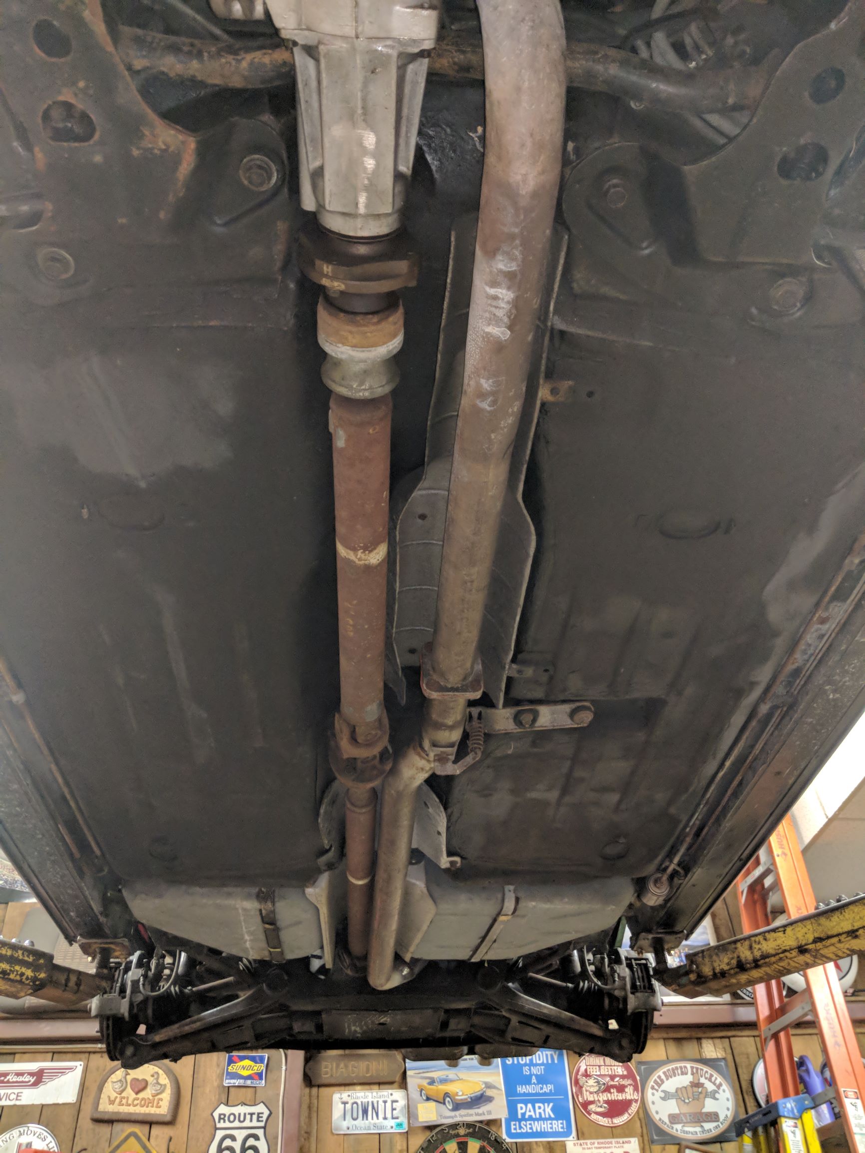

Here is my first looks at the car when I got it on the lift.
No special order here...

First things first was to get the brakes all set, so I figured out it has HD A-body front calipers and Fiero, or Pointiac 6000 rear calipers. I ordered up the various rebuild kits and rotors to fix everything that was on there. The rear pads were soaked with brake fluid and it was leaking from everywhere back there. I did some quick seals on the fronts, and rear calipers and set it up to bring to my house since it was being stored at my father in-laws for the mean time.

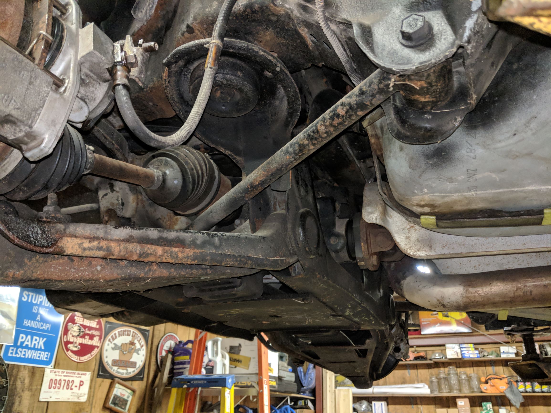

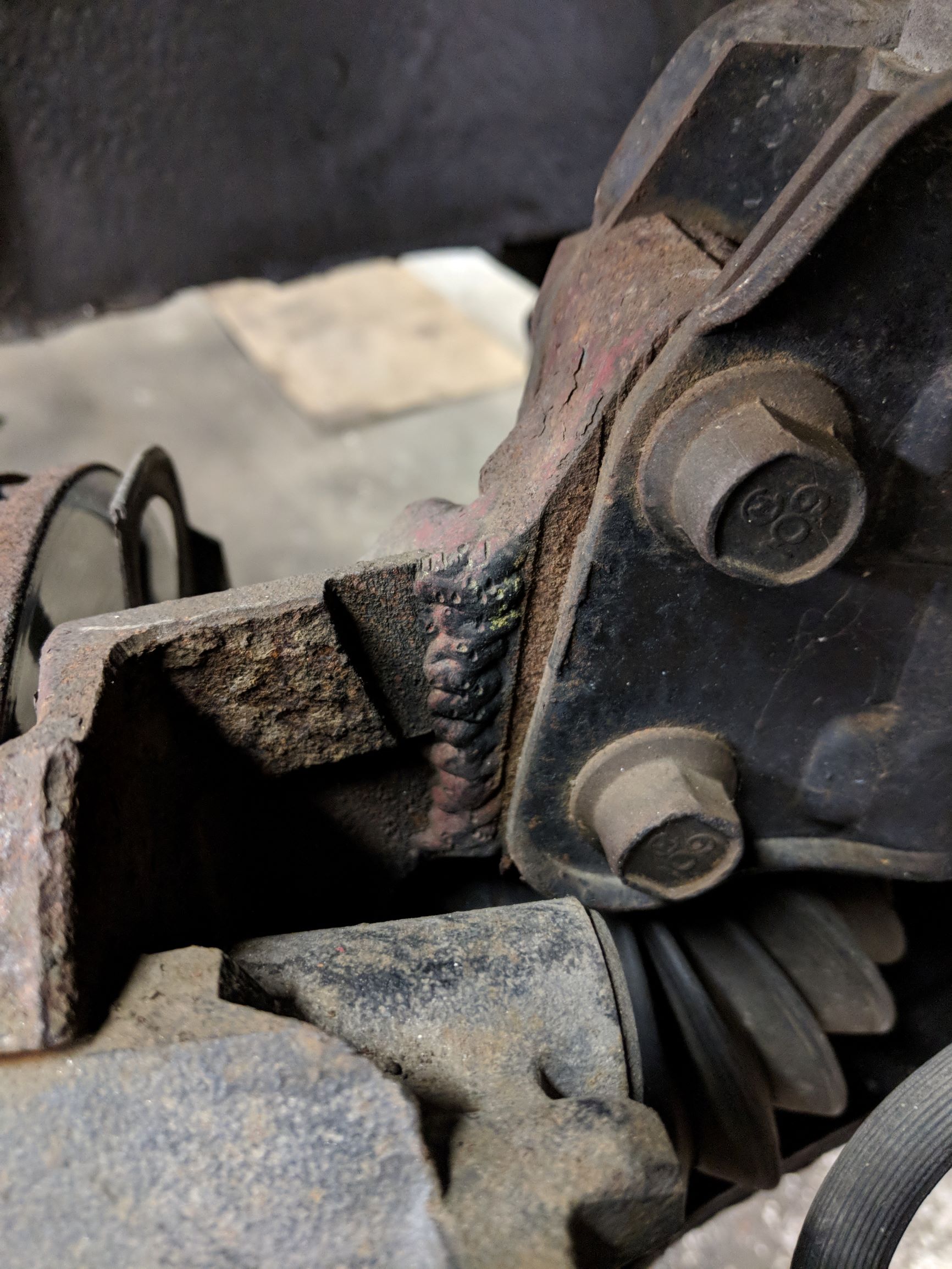

Found something interesting and learned how they adapted the A-Body knuckle to the Beretta strut... The just cut the top off and welded these together!!!
Same welding marks where the ball joint mount goes... Yikes.

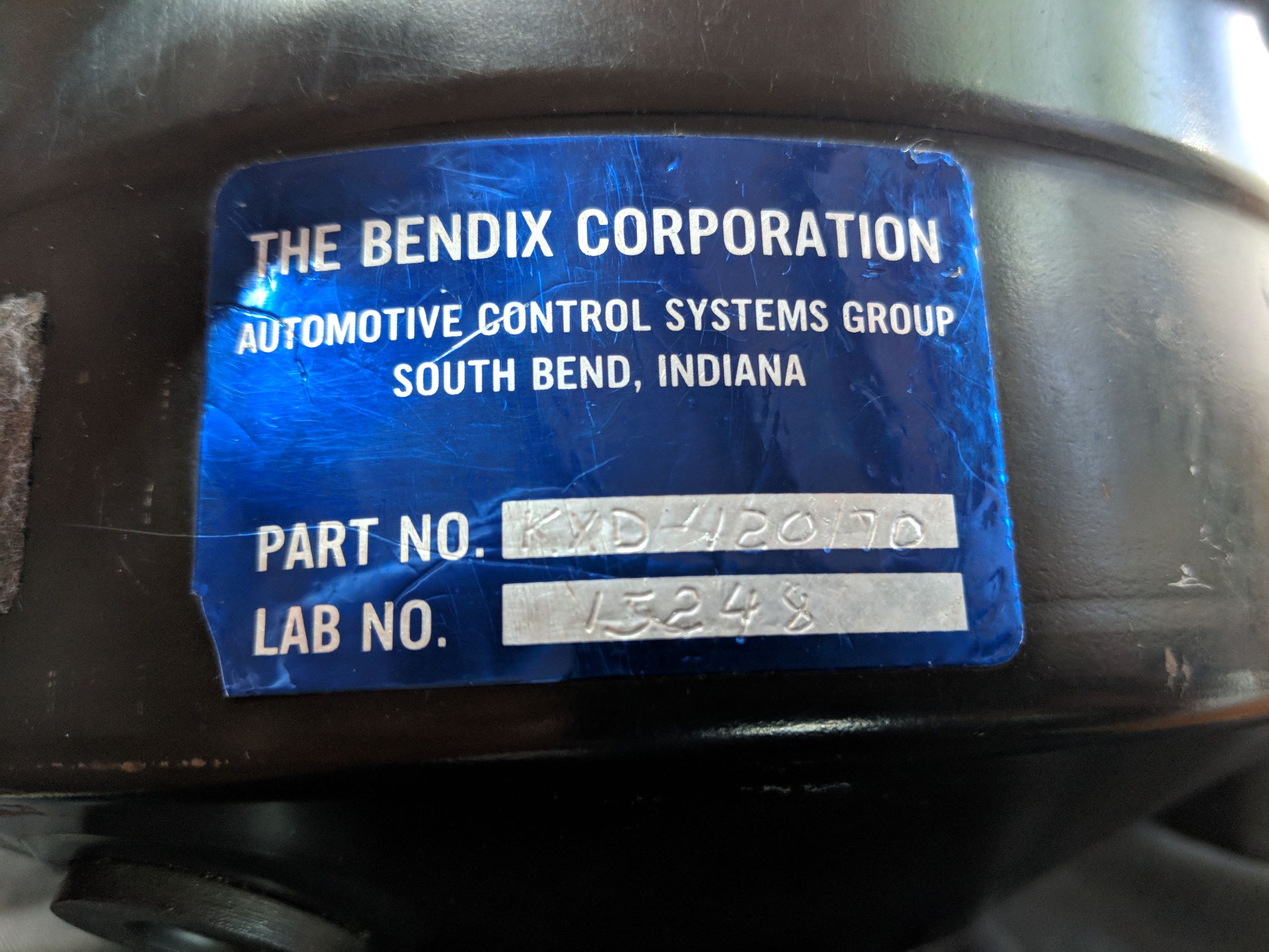

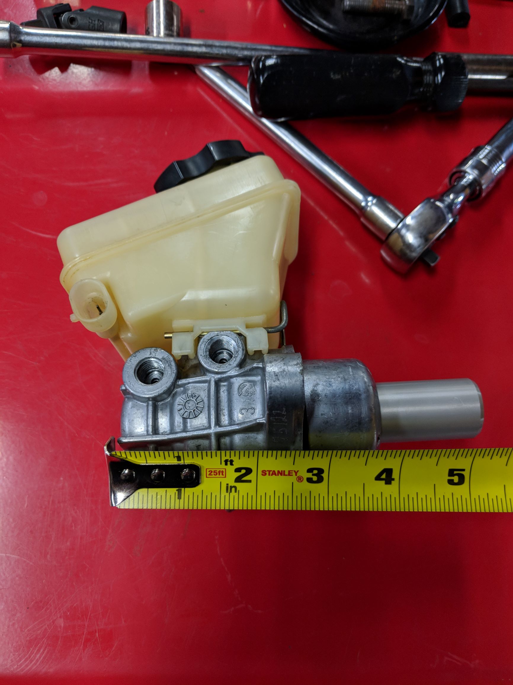

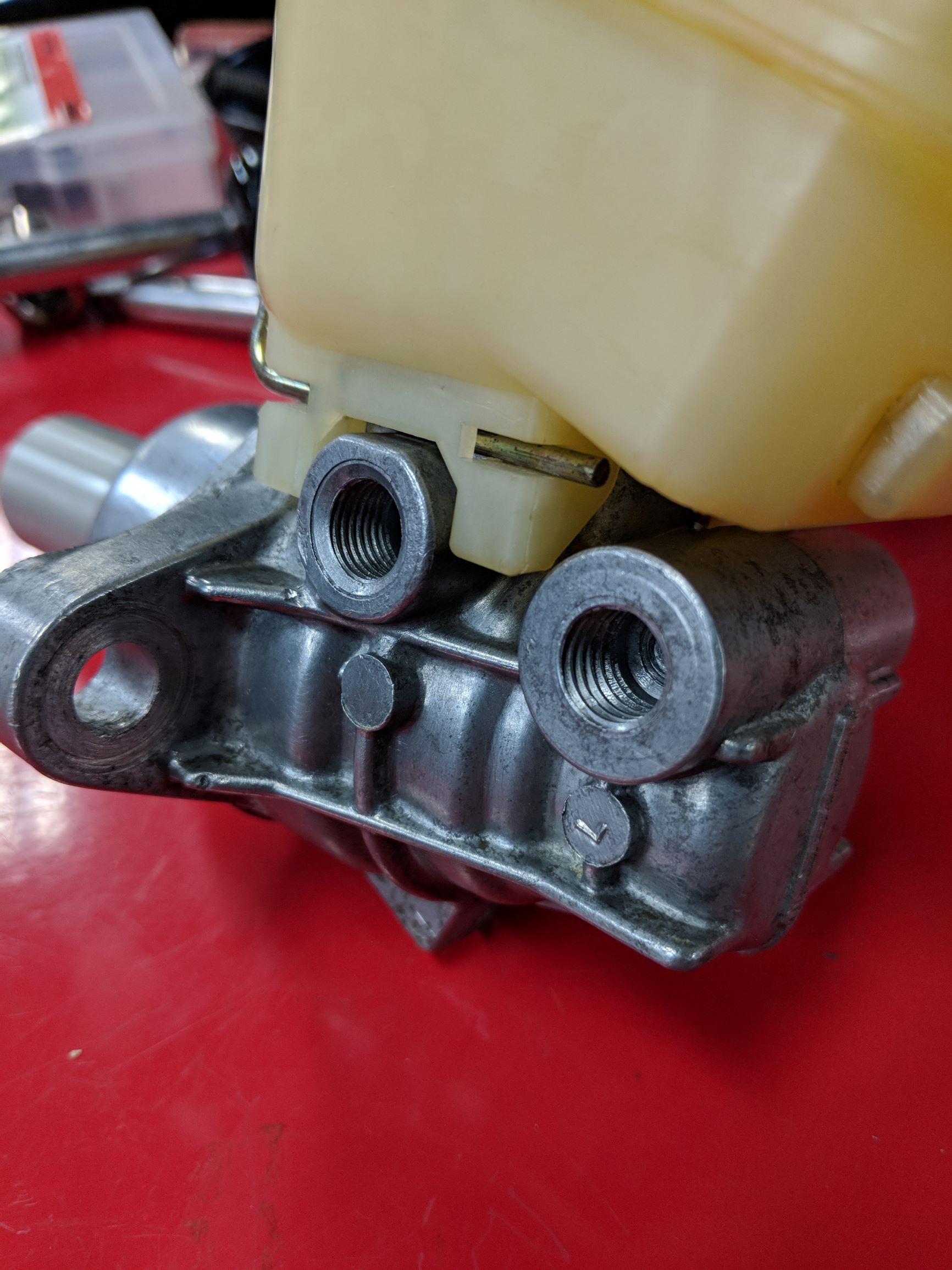

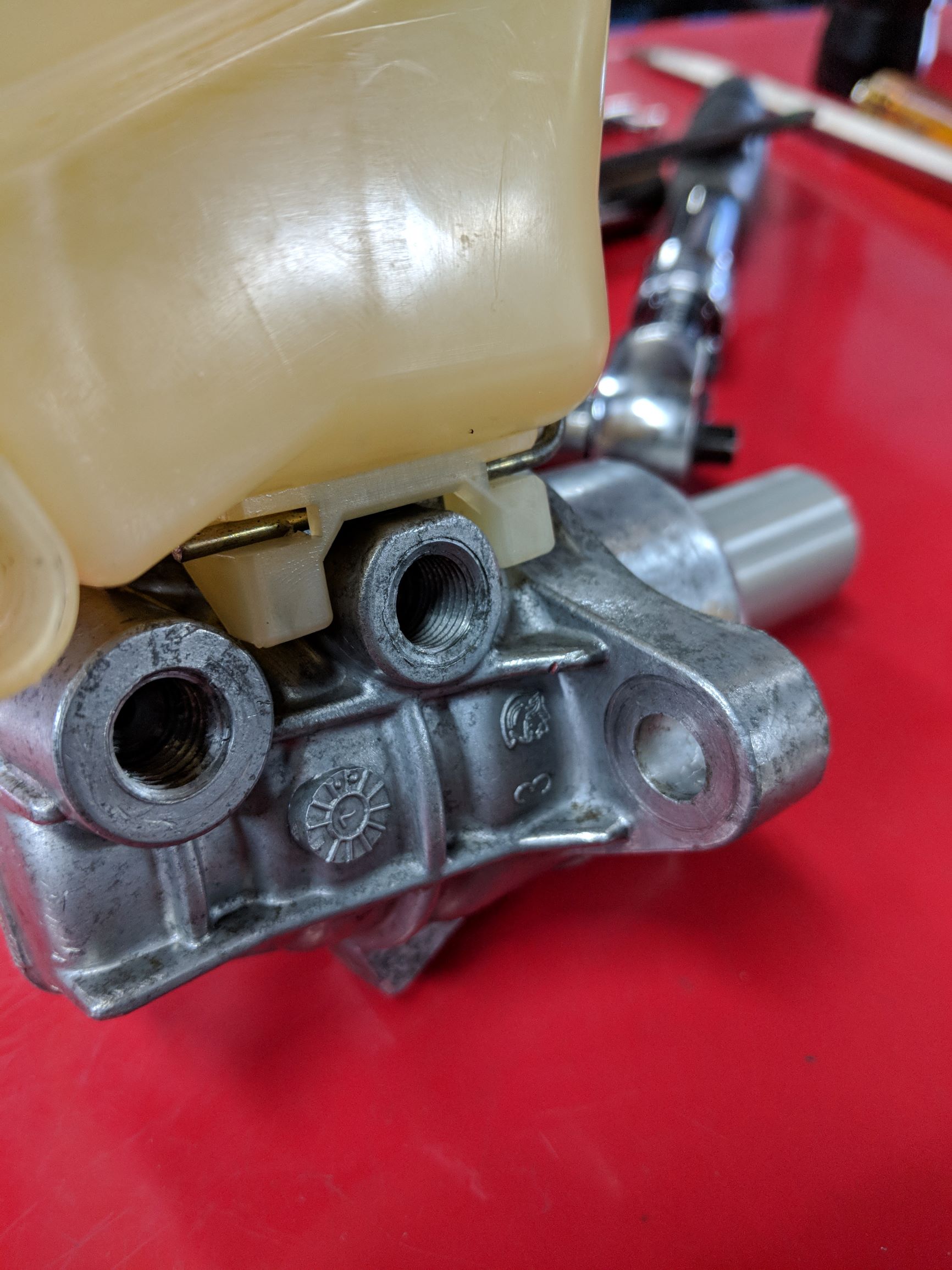

Now the fun began... Pull injectors and send out for cleaning, fully repair brake system including replace lines and rotors, also re-build the rear calipers again because I missed something the first time around (they were leaking again), as well as pull apart the master cylinder for cleaning and documenting. Still have not found what this is from... closest I found was a Isuzu truck, but the one I bought was much larger than this version.
Their highly customized brake booster.

Cool to see these details. Did they offset the brake booster?
Re: 1988 All Wheel Drive Twin Turbo Experimental Car EX-5115
Changed the angle of it to point more up, (sorry that's hard to tell it's a side profile picture of the booster mods) and it's also not a stock type booster at all. They welded the factory bracket to whatever this unit is.

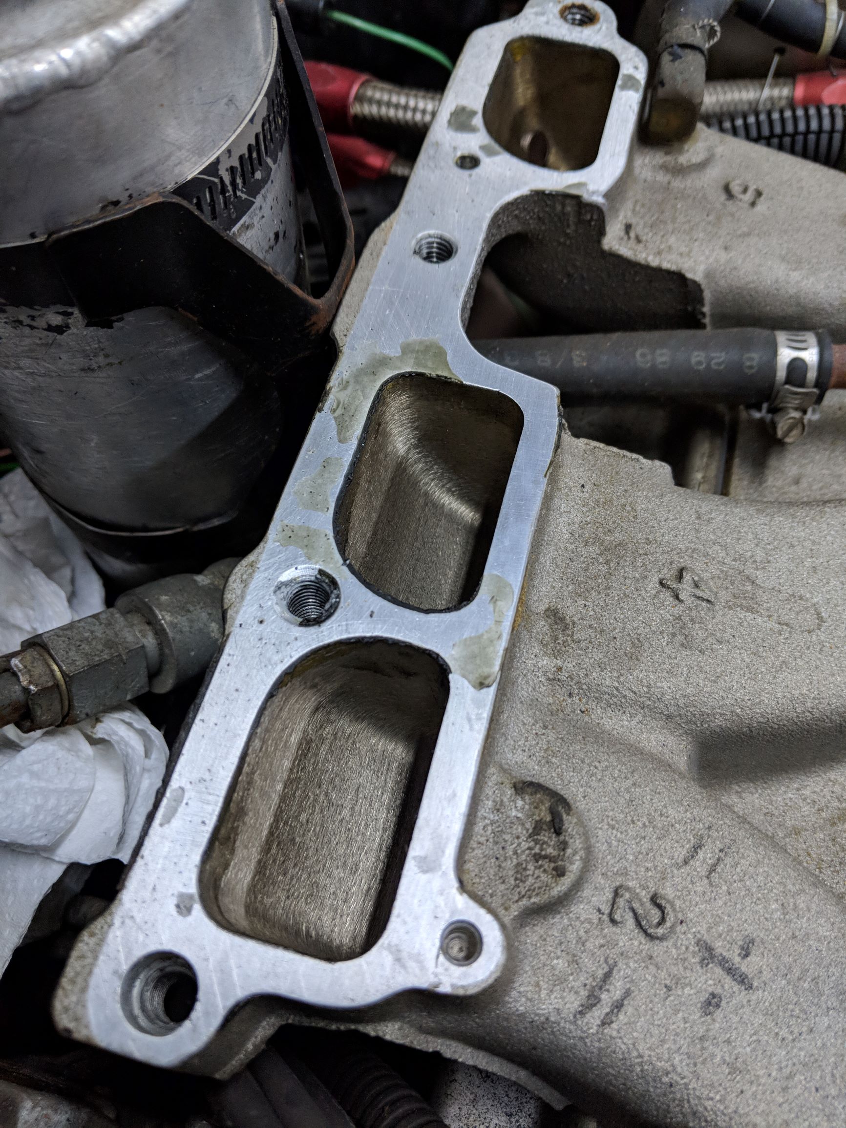

Clearly some port work done to the runners... That's not stock casting.
Ported
Ported

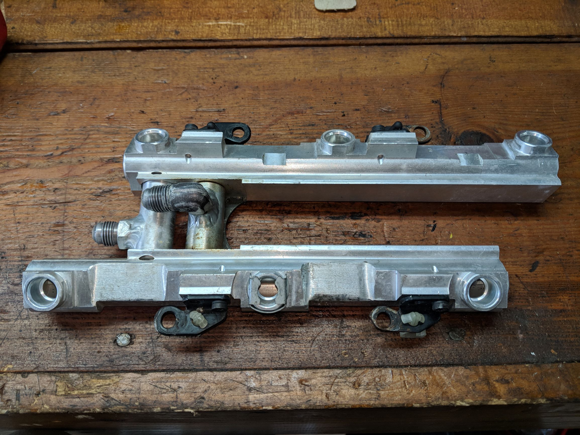

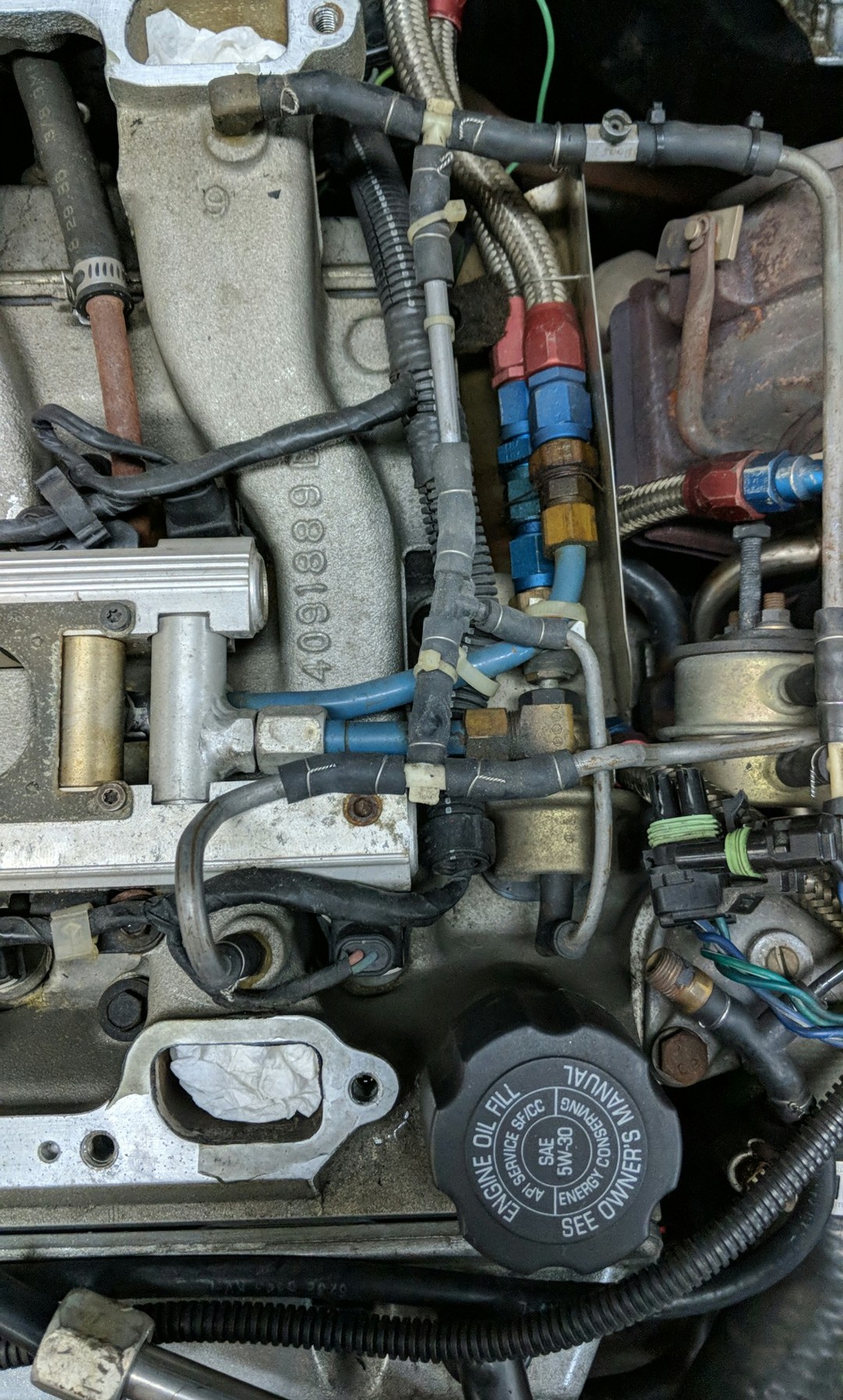

Fuel Rail
Fuel Rail
Customized fuel rail for AN lines.

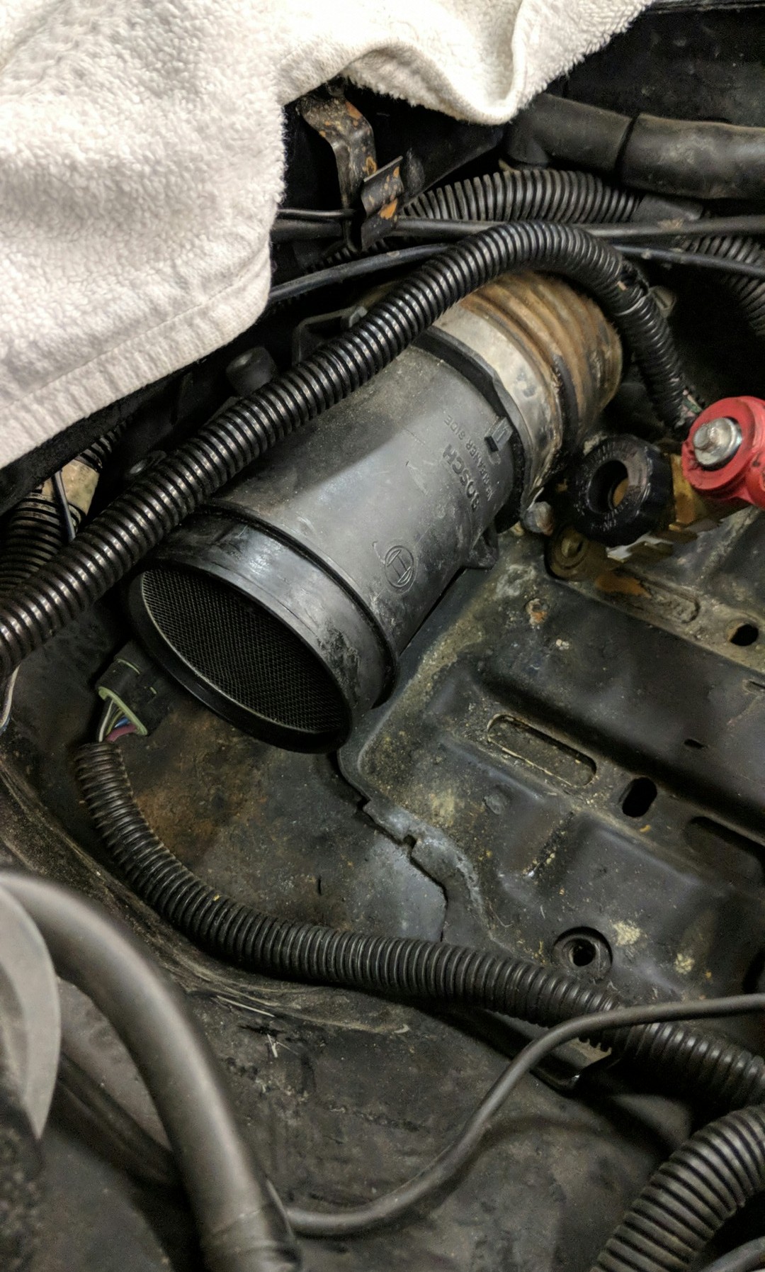

Air Filter housing
Air Filter housing
Their custom air filter location, and filter

Custom air filter
Custom air filter
And the mess of vacuum lines under the intake. Notice the Holley jets that they used to bleed off boost for control... yikes... this will be interesting to iron out after I get the turbos refreshed.
Vacuum line mess
Vacuum line mess

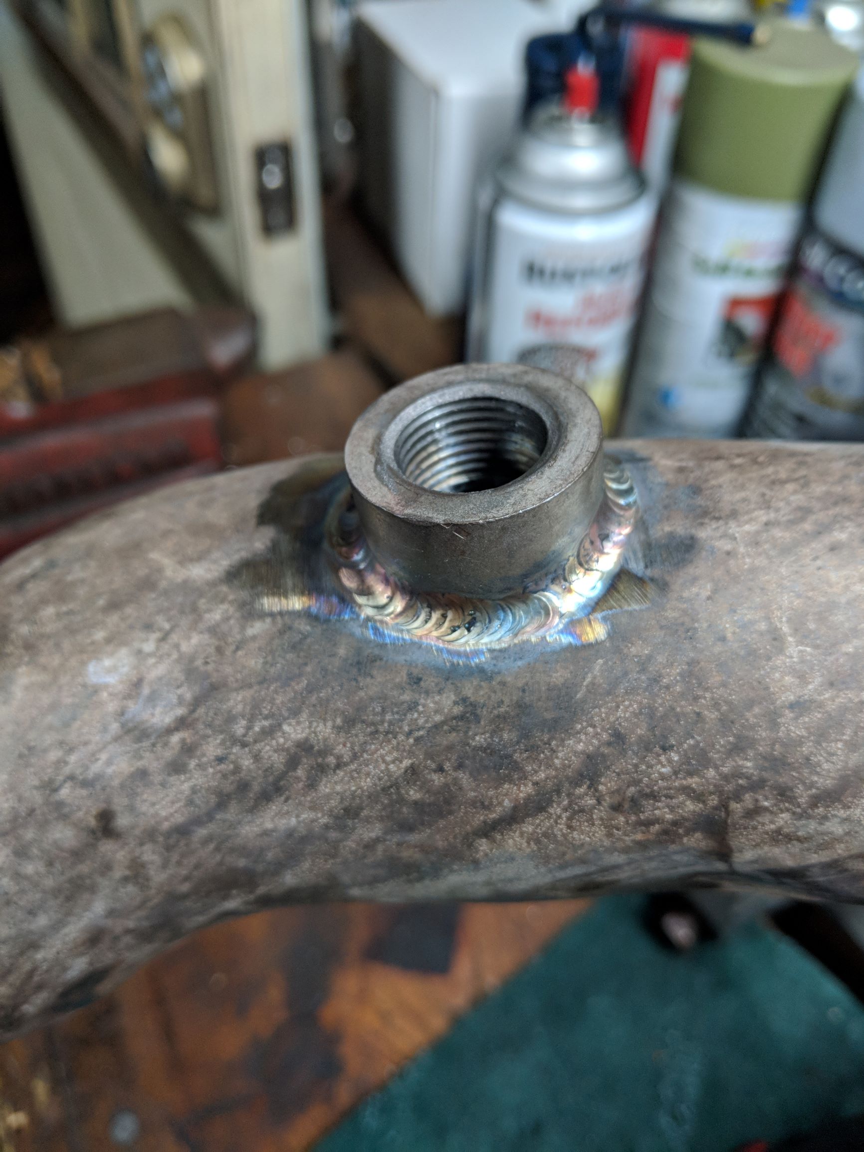

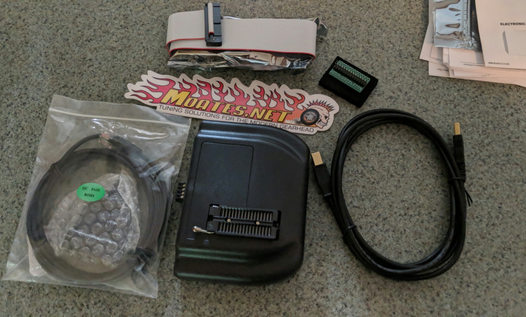

Since doing most of this work I also had to modify the tune on the ECU. I was able to use a Moats adapter to put their chip off to the side, read the details and modify the MAF tables at idle to help it run better. Something else that I noticed is this car doesn't have an O2 sensor. They had the BLM's locked and weren't even monitoring it with a wideband... that's just nuts. I installed a bung and put a wideband on it so I could see how it was running, that is how I found that idle was super rich. And with the Moates real-time adapter I was able to make changes while it was running and see it's reaction to it, vs burning chip after chip... insane how that's possible with an 88 Corvette ECU, but not OBDII yet...
Added O2 sensor bung on downpipe.
O2 Bung
O2 Bung

Moates Hardware used.
Moates station
Moates station

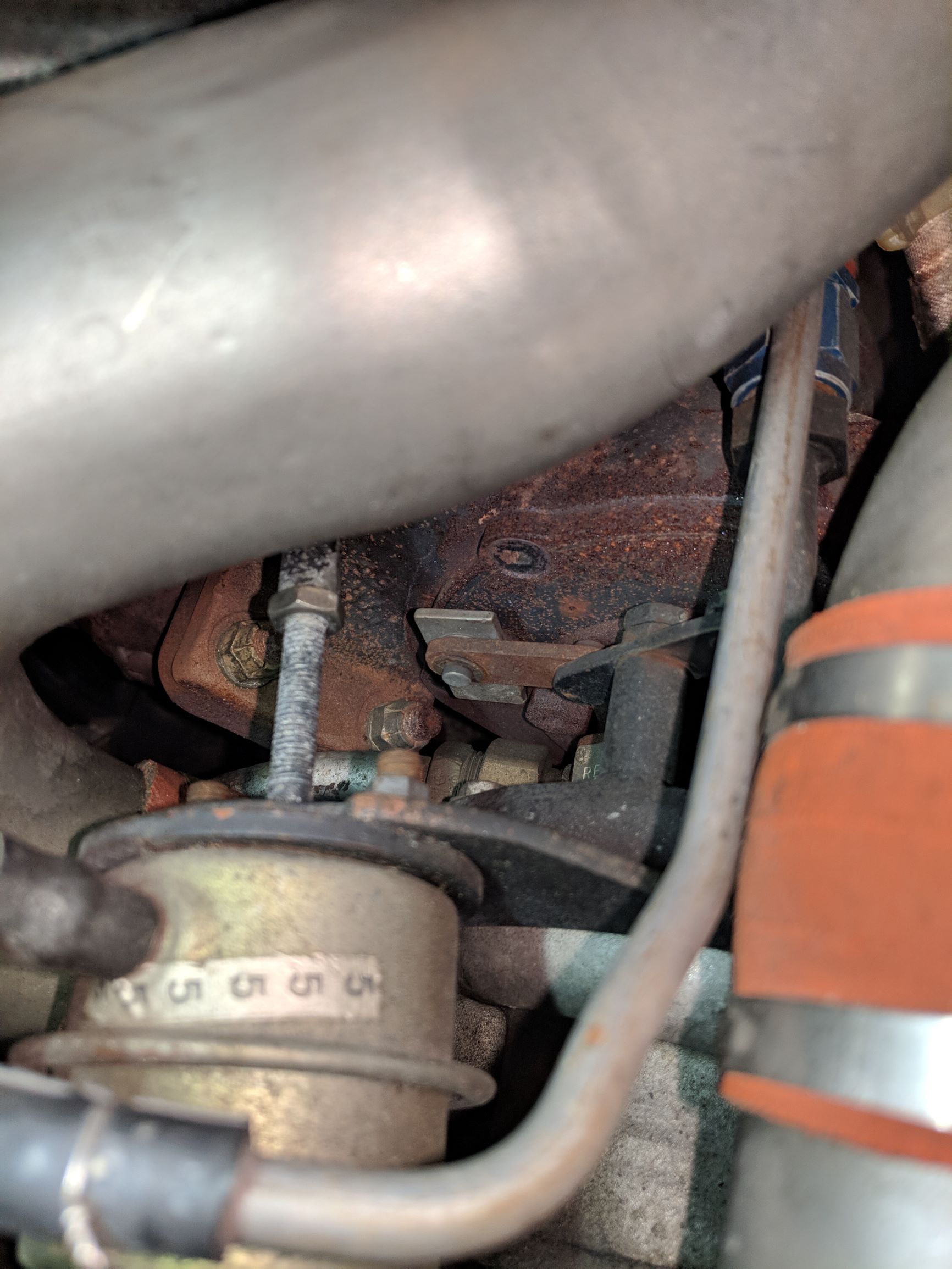

Internal Waste Gate arm, Silver tab in center of photo, the diaphragm pictured is for the wastegate.
Internal gate
Internal gate
VNT actuator arm.
VNT System
VNT System
Dual vacuum diaphragms, one for vanes and other for gate.
Dual actuators
Dual actuators
