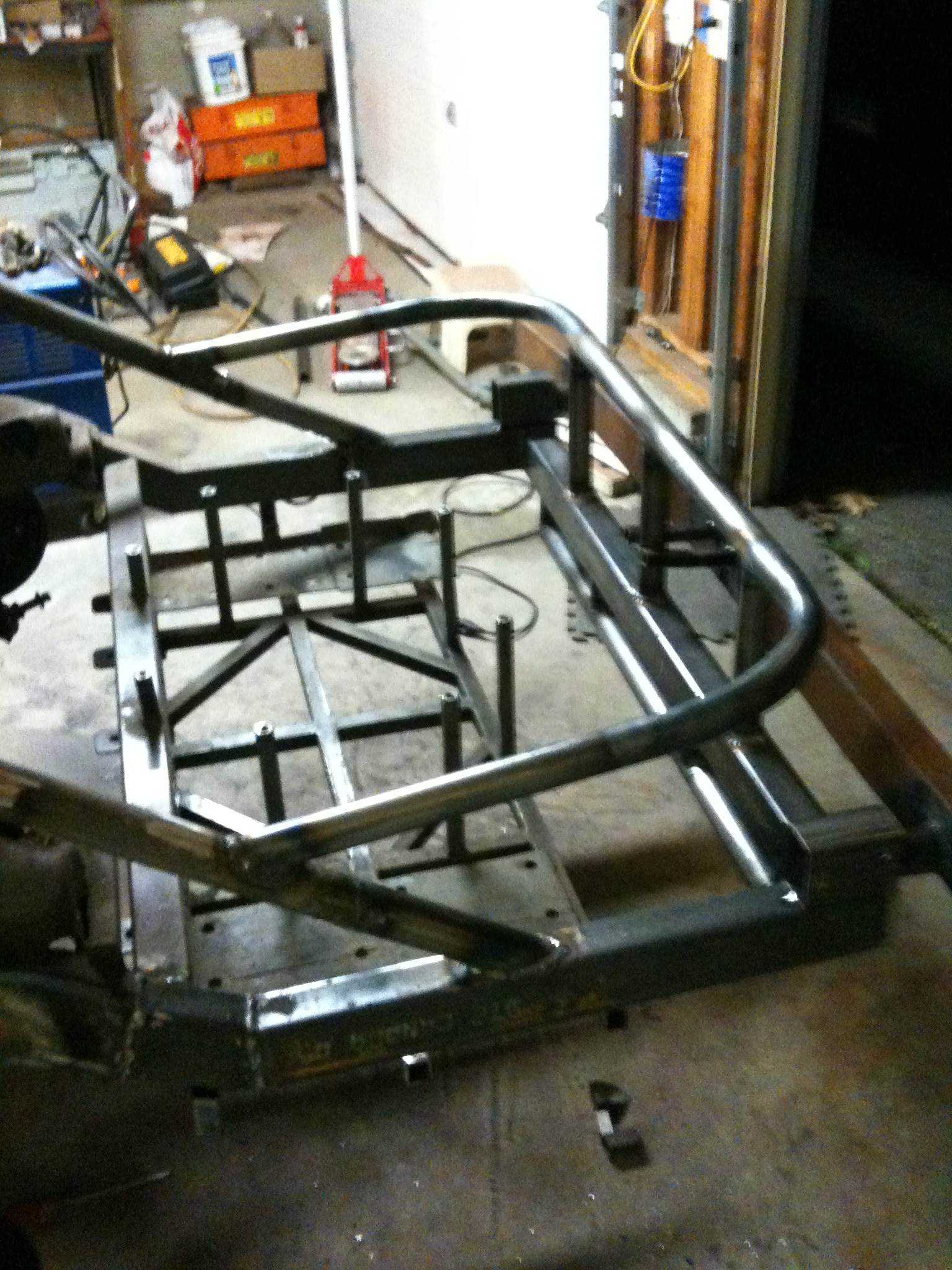

Yeah this is the car that wrecked my arm, and I just finished up about 95% of the fabrication last night.

After many days work and lots of welding.

How did you bend the steel?
I'd like to do some of that kind of work one of these days.
Re: What I've been doing
LOL that's the funny part... We wanted a similar fuel protection hoop as we had before, but it would have ended up being 90* corners if we didn't bend it. Currently we do not own a pipe bender, so I just used the torch and slowly worked my way around the raidus till I had something that worked.
I was trying to have him get the pipe bender from Harbor Freight just to see if it would work, but since it only had Die's for the center and not the outer edge he thought it would kink the pipe, and it also didn't have one of the important sized die's we use for pipe. All the ones from Speedway motors and such that are bottle jack powered are like 700+ minus the Die sets.
Granted yes that's NOT the proper way to do it for something that will be protecting you such as the main hoop, but that bar is simply there to prevent another car from going up and over the top of your fuel cell so its really just a secondary bumper.

You redneck. I thought that's what it looked like.
Not gonna work for a rollcage, which is what I really think would be fun to build.
Now I see why you were cutting that square tube. I was sure at a loss on why you would be cutting something like that.
it was only necessary to protect the cell, which some guys don't even have so with the way I did it I think it's perfectly fine and will hold. But yes I agree for a cage you should bend it properly, and 800+ for a bender to do one pipe wasnt worth it. and it takes alot of skill to bend a cage and figure out where the bends should be without wasting a bunch of pipe.
