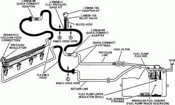

testing the fuel pressure requires a special tool something most places dont have either, unless you make one or order one online. its just a quick connect that plugs inline to the fuel line and has a schrader valve to test the pressure.

Re: 94 Quad 4 starting/idle problems
i found a pic
Depends on the quad fuel rail used too. Pauley's quad has a shrader valve right on the rail, Patrick's doesn't. Go figure.
You can see the brass cap on his FPR

88-90 Quad 4's have the earlier style with the built in valve, and 91+ are like the picture Steph posted.3X00-Modified wrote:Depends on the quad fuel rail used too. Pauley's quad has a shrader valve right on the rail, Patrick's doesn't. Go figure.
