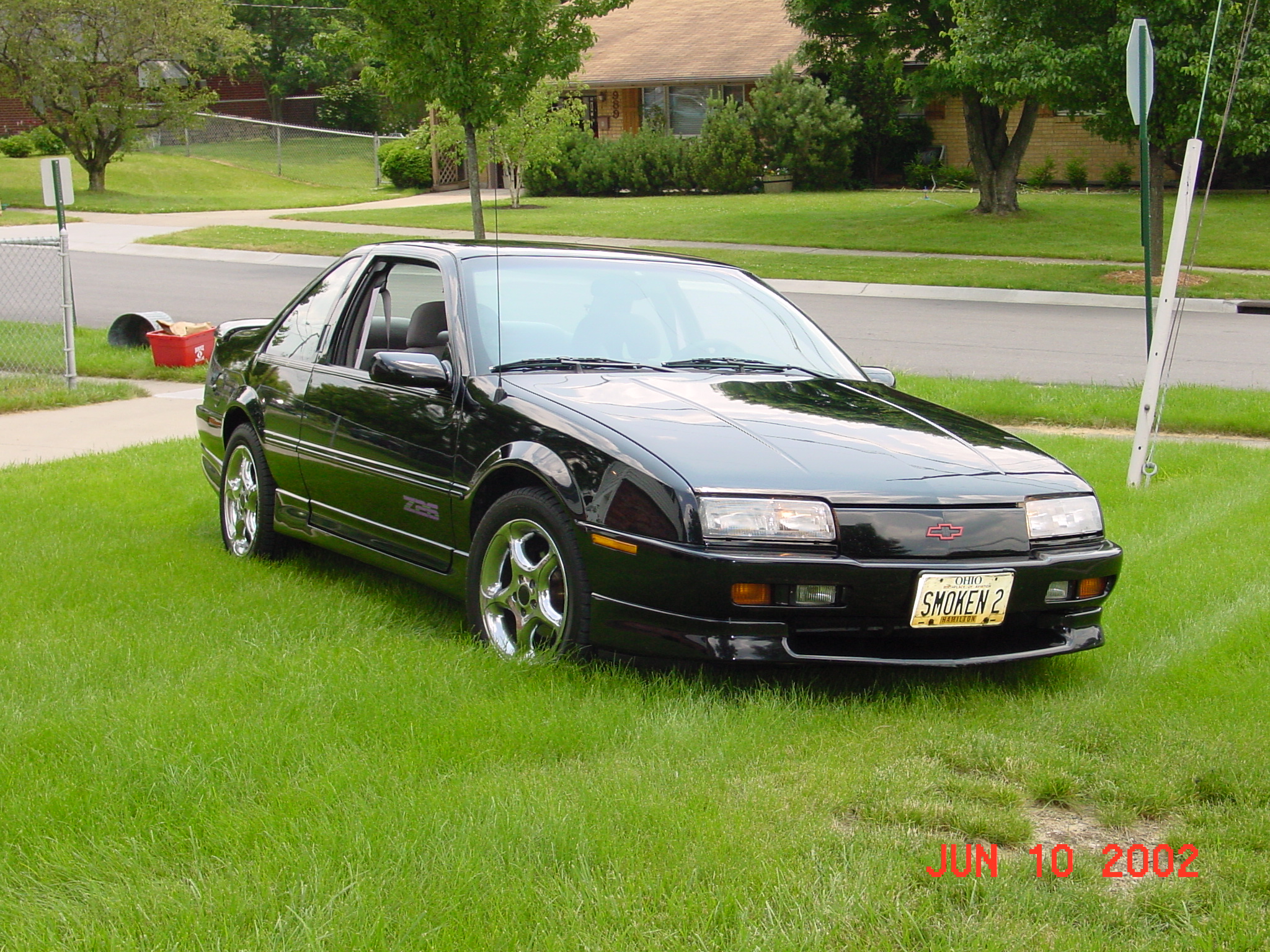

This was the car back in the day. Before it got a new set Konigs. Then the Konigs got stollen. End of story.
