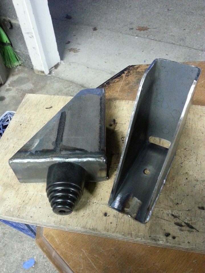

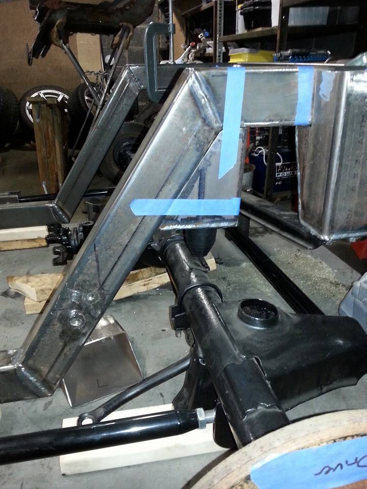

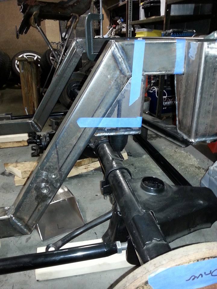

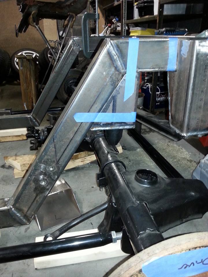

Rear suspension bump stops done......

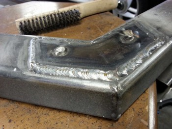

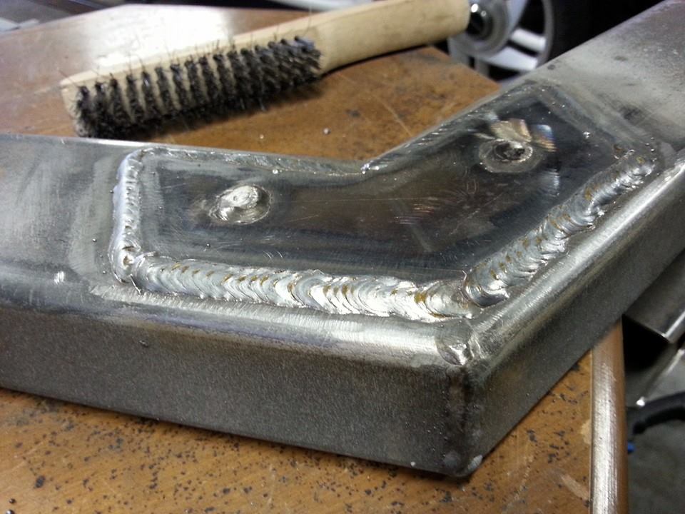

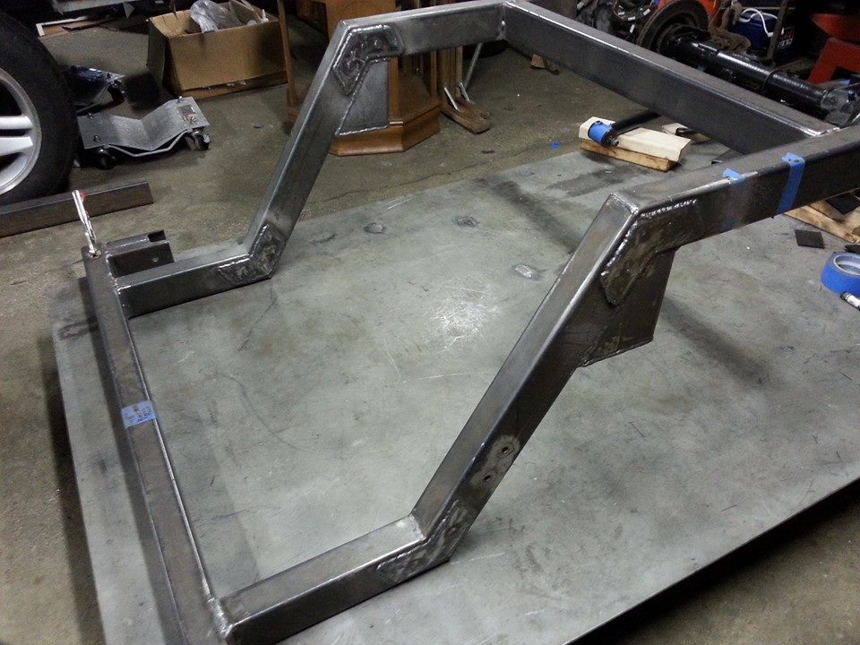

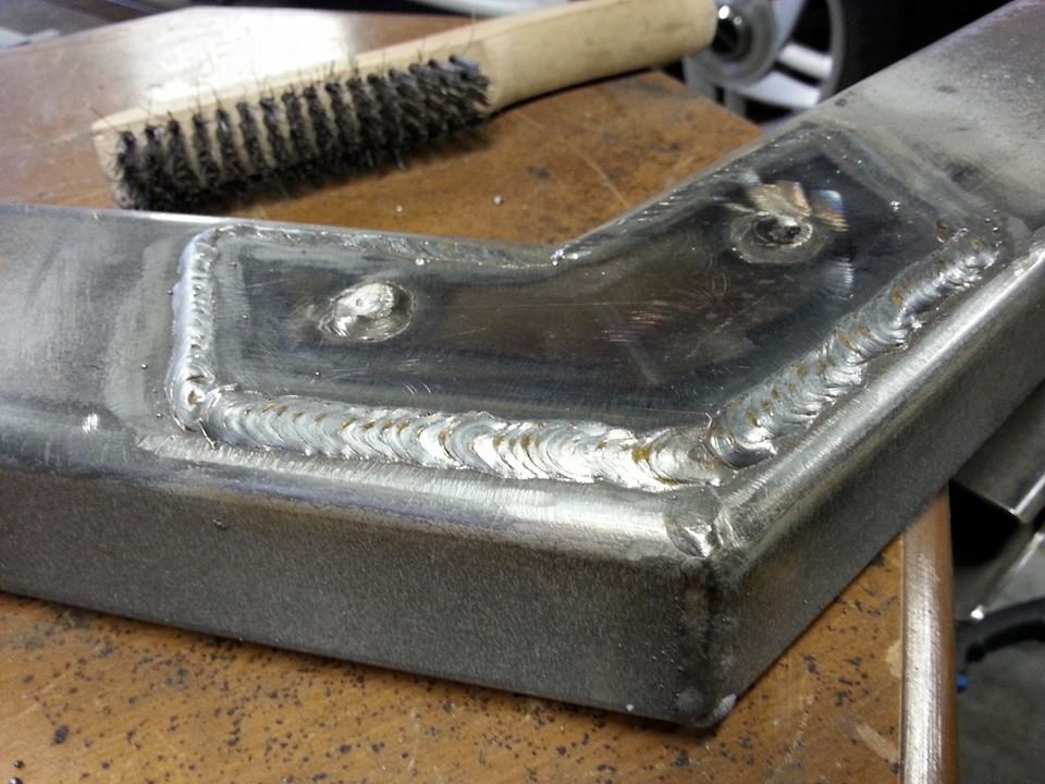

jjanke wrote:yeah i will seal up all the box ends.......gonna start adding the gusset plates spanning all the butt welds soon too.......
Remember to add in some sort of water drain-ports... Another idea might be to coat the inside of the tubes with hot boiled linseed oil -it might sound stupid, but that is the approved anti-corrosion method used in general aviation for steel-tube structures. One of the last things you would want is for this framework to rot from the inside out...

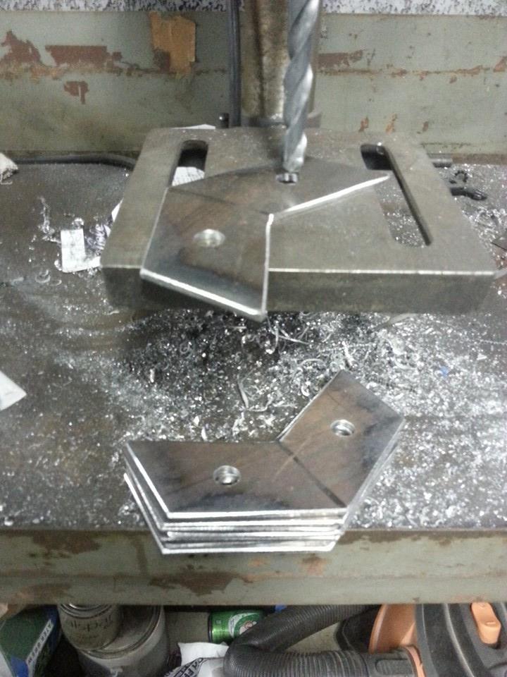

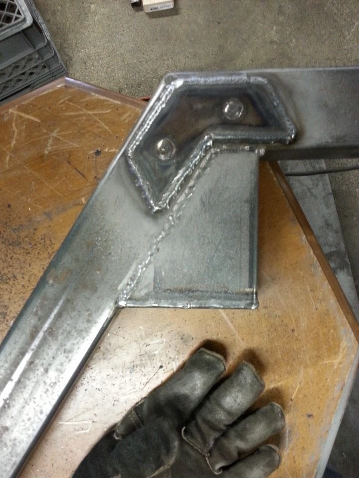

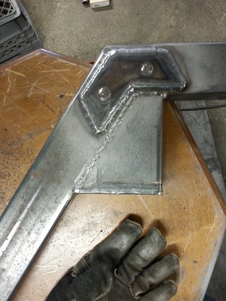

main frame rail gusset plates and rear axle bump stops welded in..... still more plating to do......

yeah i will have to look into some ways of sealing up/coating the inside of the tubes...........this car isnt gonna see any salt but better safe than sorry
Re: Beretta Z28
If they are welded shut then the odds of anything starting to eat it from the inside out is very slim... You would have to dunk coat it and have holes in the rails, OR you should have primer/sealed it before welding. They actually sell a sealer that can be welded through for rocker repair and such.

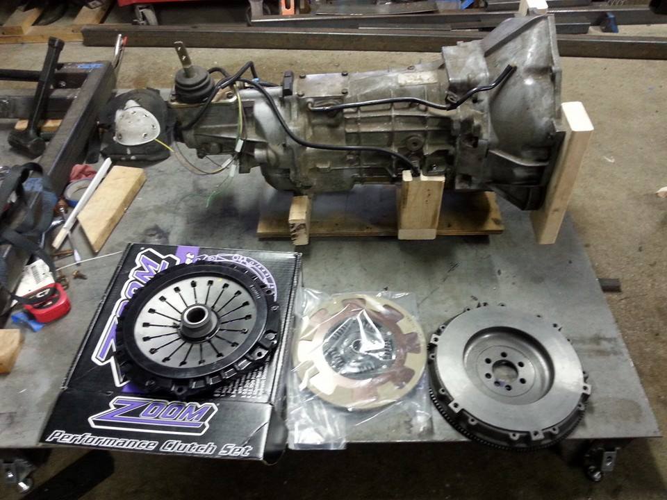

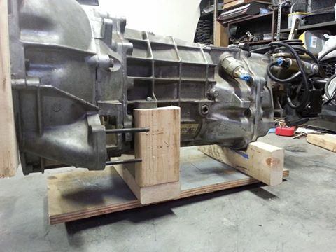

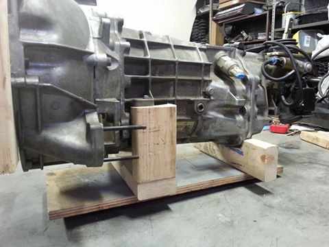

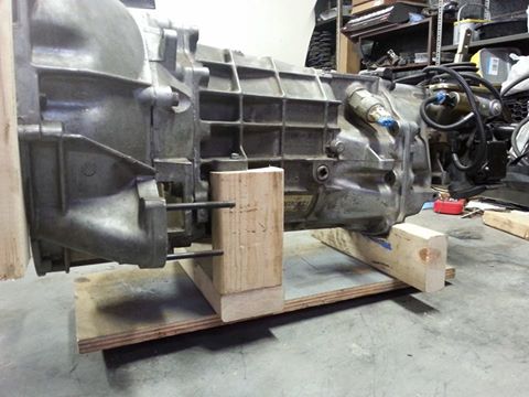

Well its been awhile since I posted about project...... .made a lil stand to help support the t56 during install and almost ready to install the new external balanced fly wheel and zoom HP Kevlar clutch and pressure plate. Just waiting on some new bellhousing bolts and the new flywheel bolts.

Yup, same funky style pull clutch I got. haha
Posts: 1833
Re: Beretta Z28
woody90gtz wrote:Yup, same funky style pull clutch I got. haha
...Also used on the Muncie/Getrag 284 found next to the 3.4 TDC quad-cam engine in a few W-bodies. Getting very hard to find parts for that thing -glad mine was already rebuilt, getting worried about future clutch replacements though...
That T56 is awesome, jjanke. Double-overdrive sixth... Very jealous here, as I have three Camaros that would benefit from those transmissions and the extra gear, if I only had unlimited funds for upgrades. :Rose:
