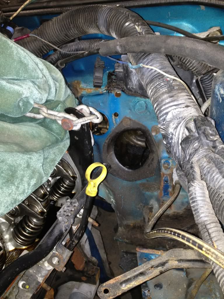

Yeah, look at that brake mastercylinder hole... right behind the head...

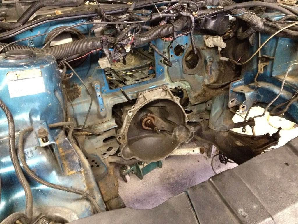

I did find that my 282 clutch disk is the same spline as the t5, which suprised me. Maybe I can mod the clutch fork and use my current spec clutch, the 2.8 RWD flywheel looks different.

Yeah its a t5 out of a 88 camaro 2.8. Dual pocket bellhousing. Has a older tailshaft so it has a cable speedo. Like I will have a guage cluster... yeah right.

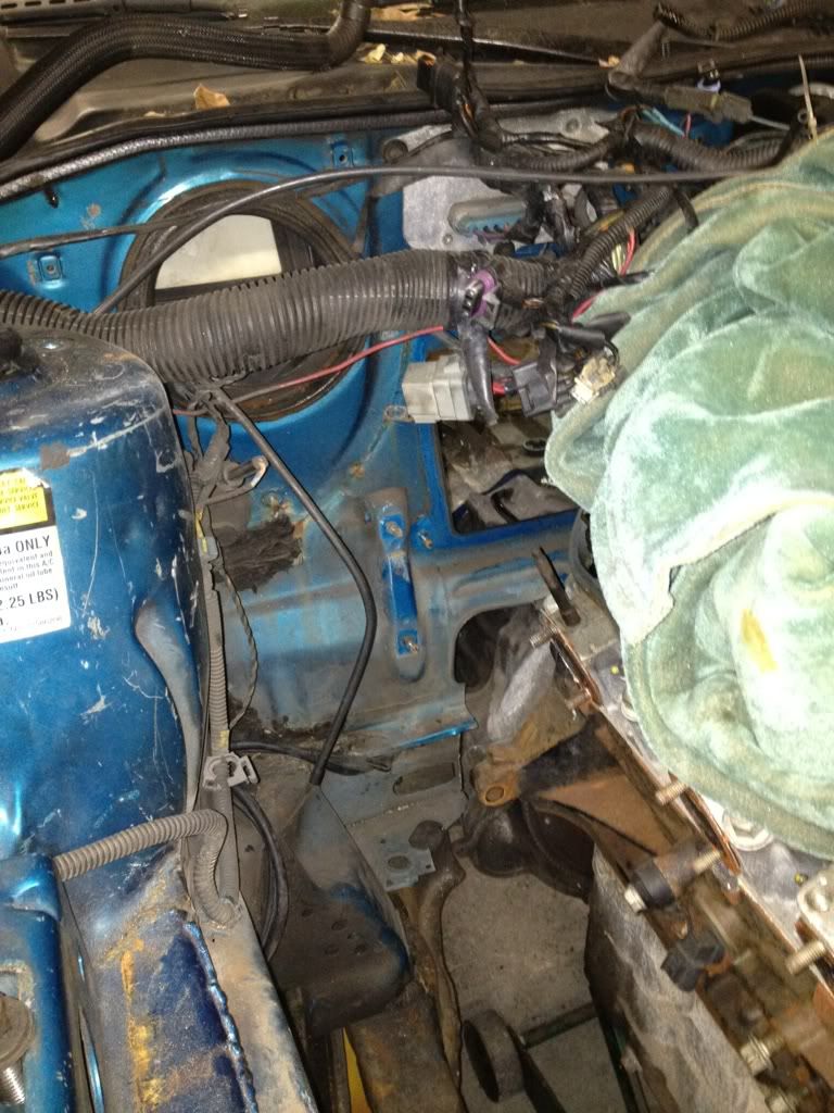

Can you bolt a universal manual brake master next to the clutch master on the firewall? That area is still on the plate for strength. I converted to manual brakes on the Camaro to get rid of the booster and it gives you better pedal feel anyway. You might be able to extend the pin on the brake pedal for the master pushrod and leave the pedal where it is.
