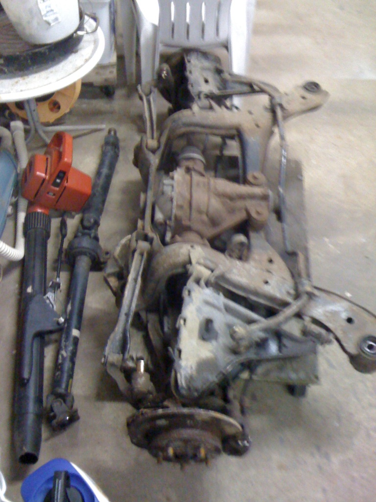

Re: Project: Slideways z26
Heres a picture of my grandmoms leaf blower. She has a heated garage so I am working there this winter. I dropped the car and the parts off tonight. No pics of coilovers at this moment

Brakes are being held till next week for Shane. All other parts are forsale. Good wheel bearings, ABS wiring, Hollow z51, FE3 bar, gas adjust shocks, springs, axle, etc.
Tomorrow I will take the 240 stuff apart to make it lighter so I can get under the car with it and see what kind of mounting modifications I need to do.
