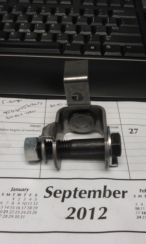

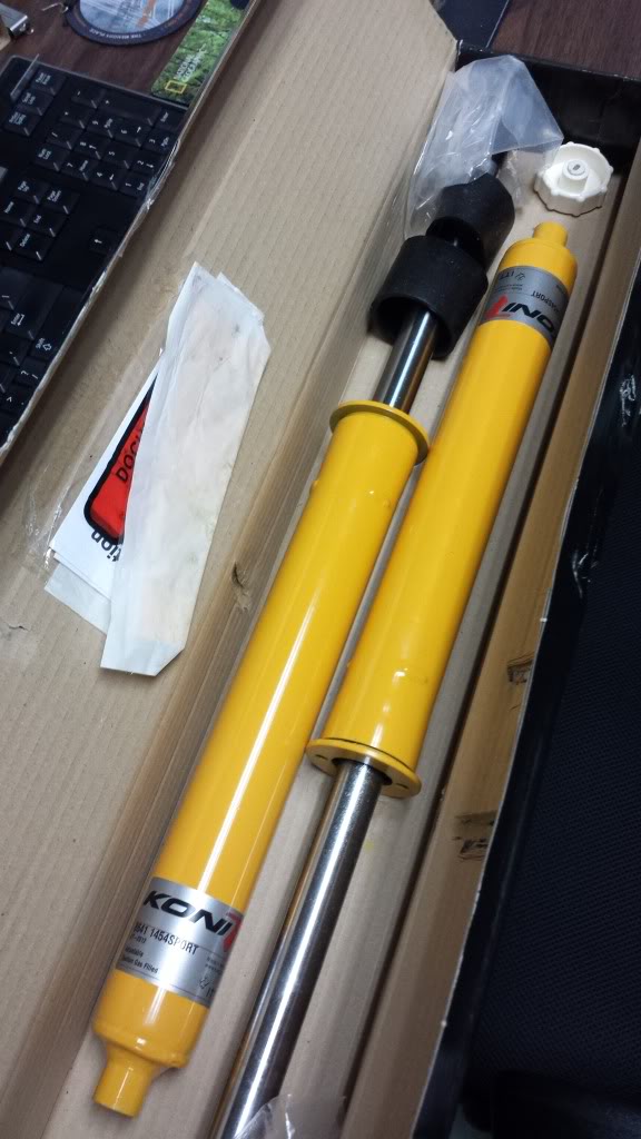

Found a new shock for the rear for 95+ cars... Verifying some info on the bottom eyelet but the only change between the saab and the new one is the bottom mount is a 14mm collar. You can either bush it to match the 10mm that comes with some Monroe brackets, or drill out the lower brackets to be 14mm and get a bolt.
The Gabriel shocks I bought to get the brackets from ended up having a 12.5mm bolt instead of the typical 10mm, so I have to braze a washer on it for the meantime if I wish to use the saab shocks this weekend. I will probably order these to replace what I have. 19.2" uncompressed and 11.85" compressed they go shorter than a stock Beretta shock so that's really good!

Lower bushing is 41mm wide vs 36mm so you will have to customize the bracket width to fit
This is the bracket I got with some $9 Gabriel shocks. Needs to be widened to fit the Koni... I will verify this is even possible tonight.

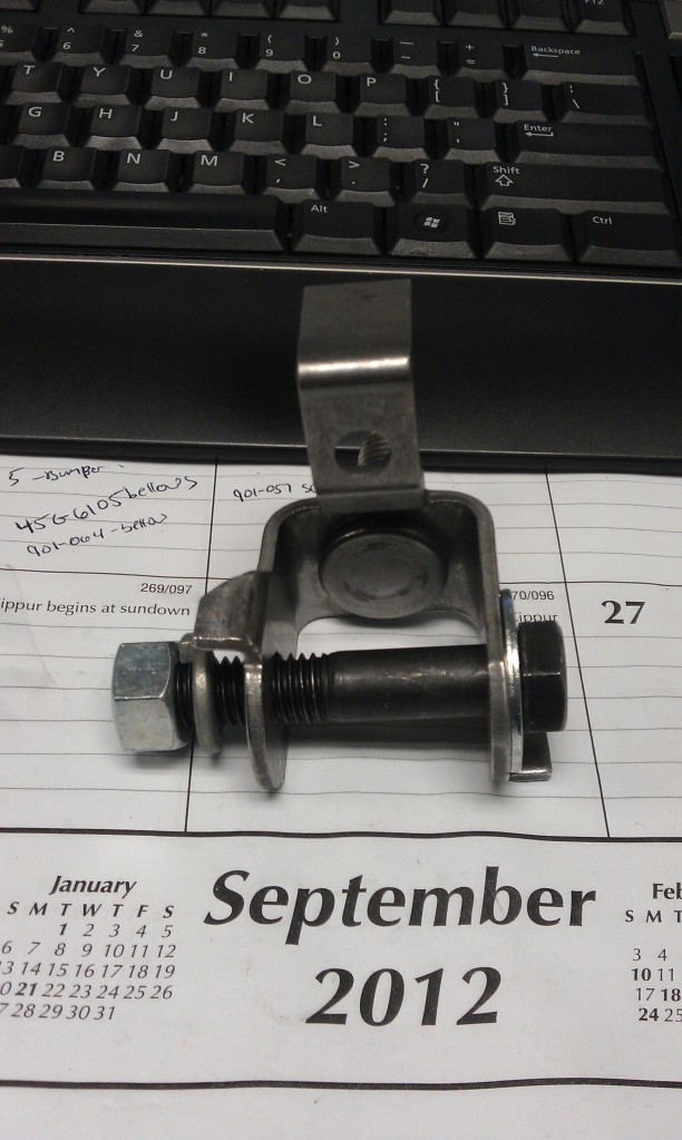

*Update

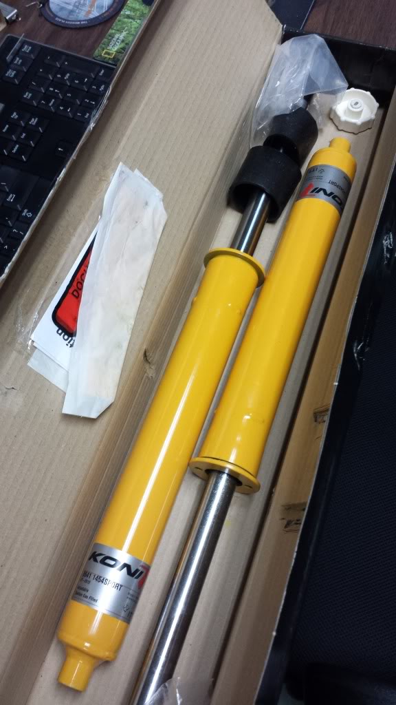

But Just remember this... You can go KYB and be done, OR you can go this setup and open up the world to a perfect suspension setup... The awesome thing about Koni shocks is you can take them and send them to a shop with all of your spring specs, your sprung weight and everything you want to do with your vehicle as well as the rest of your mods and they will re-valve these things to better suite your application. The possibilities are endless when you have people willing to custom tweak them.
