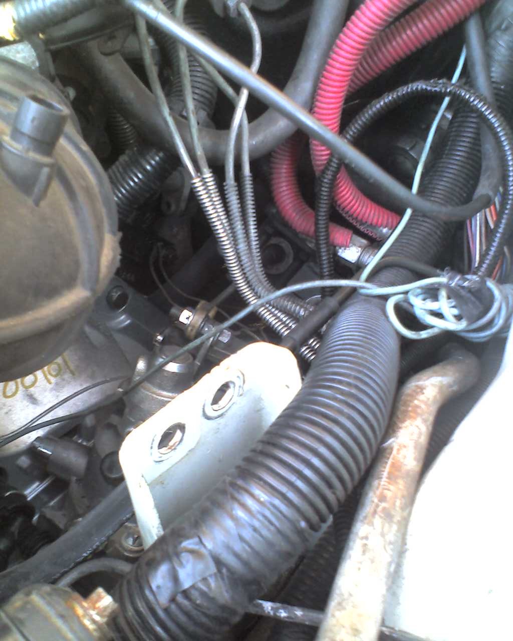

My '89 GTU was converted to a five-speed a few years ago when I also converted the car to the 3800 Series-II SC hybrid. The tranny had worn synchronizers when I bought it from the junk-yard (from another GTU, no less), and I've also had trouble getting into reverse since day one. I got sick of it. I've finally completed the six-speed F40 swap into the car. It was NOT an easy swap, despite the fact that the car already had all the five-speed stuff in it, but as usual, I made it even more difficult in my quest to save money and use off-the-shelf parts for standard wear-items. I do NOT need a custom clutch, I do NOT need a V-8 Archie flywheel spacer, and the only modification to the shifter-cables was to pop the plastic insert and threaded pivot-bolt off the end of one of them (see pic). I did have to do some modifications to the tranny housing, that one CV joint (as mentioned above) had to be shortened, and the shift-cable mounting-bracket was a totally custom-made piece.

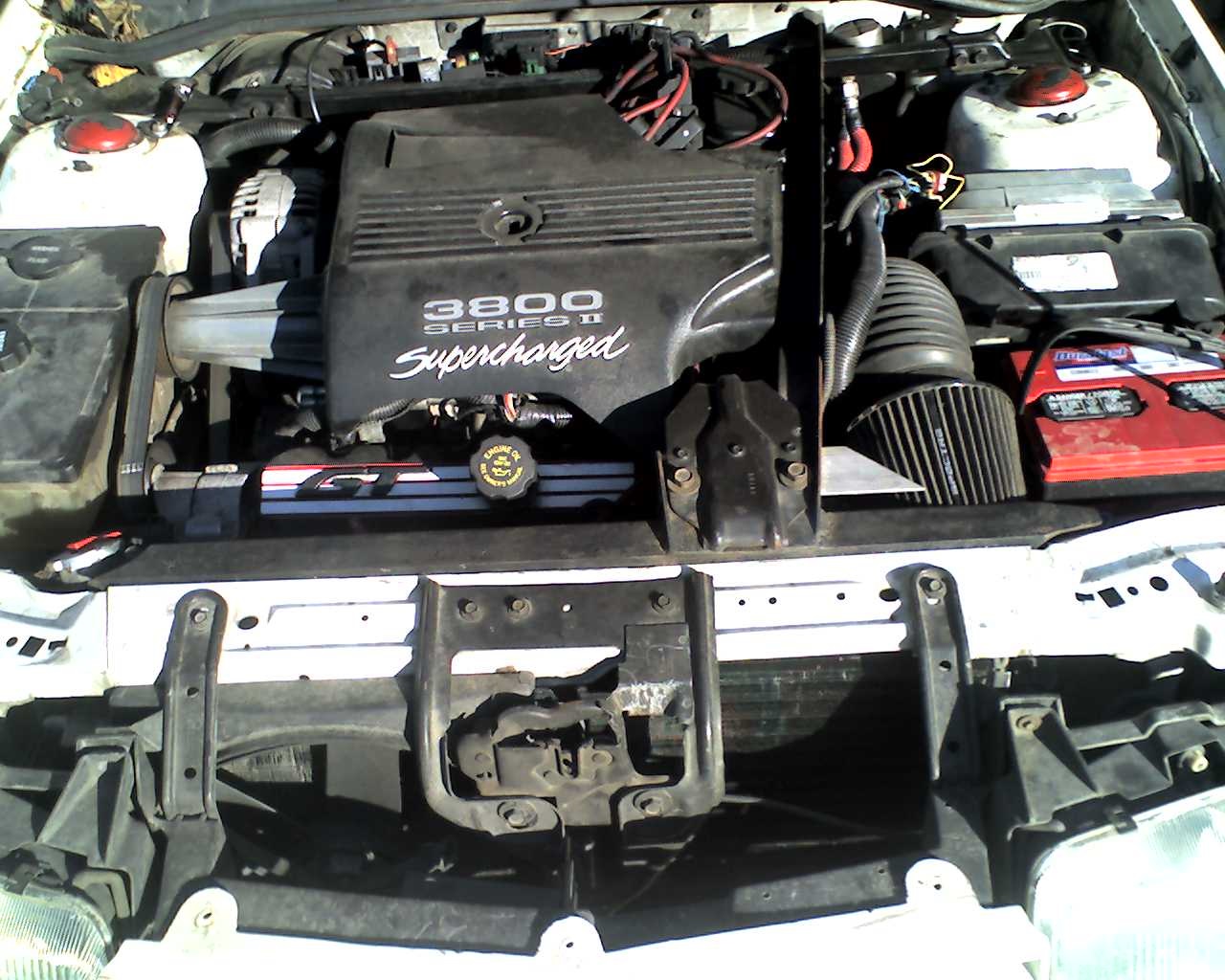

The 'u' on the valve-cover GTU fell off,  I still have to put it back on.  And wash the engine-bay down.  Twice.

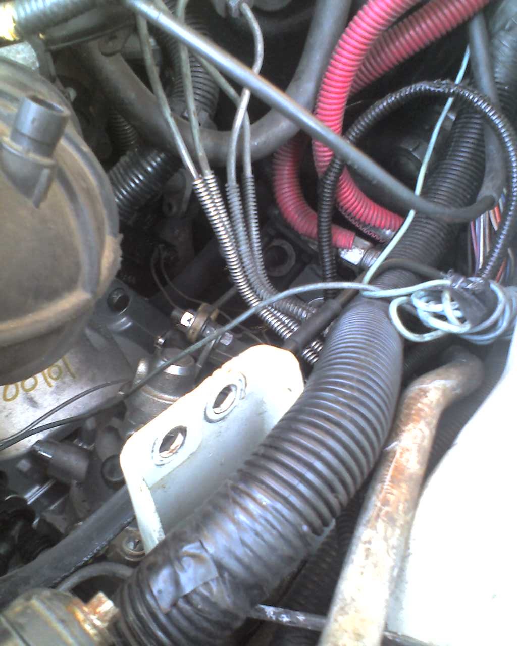

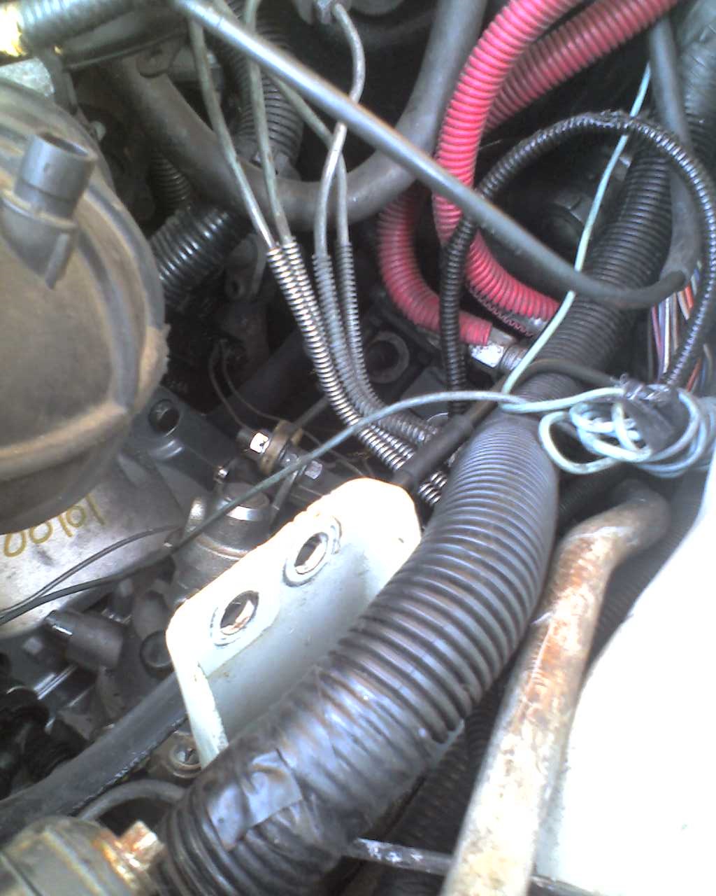

I modified one shifter-cable by popping out the plastic retainer on the end, and put in a bolt with cotter-pin.  Ooo, that was tough.

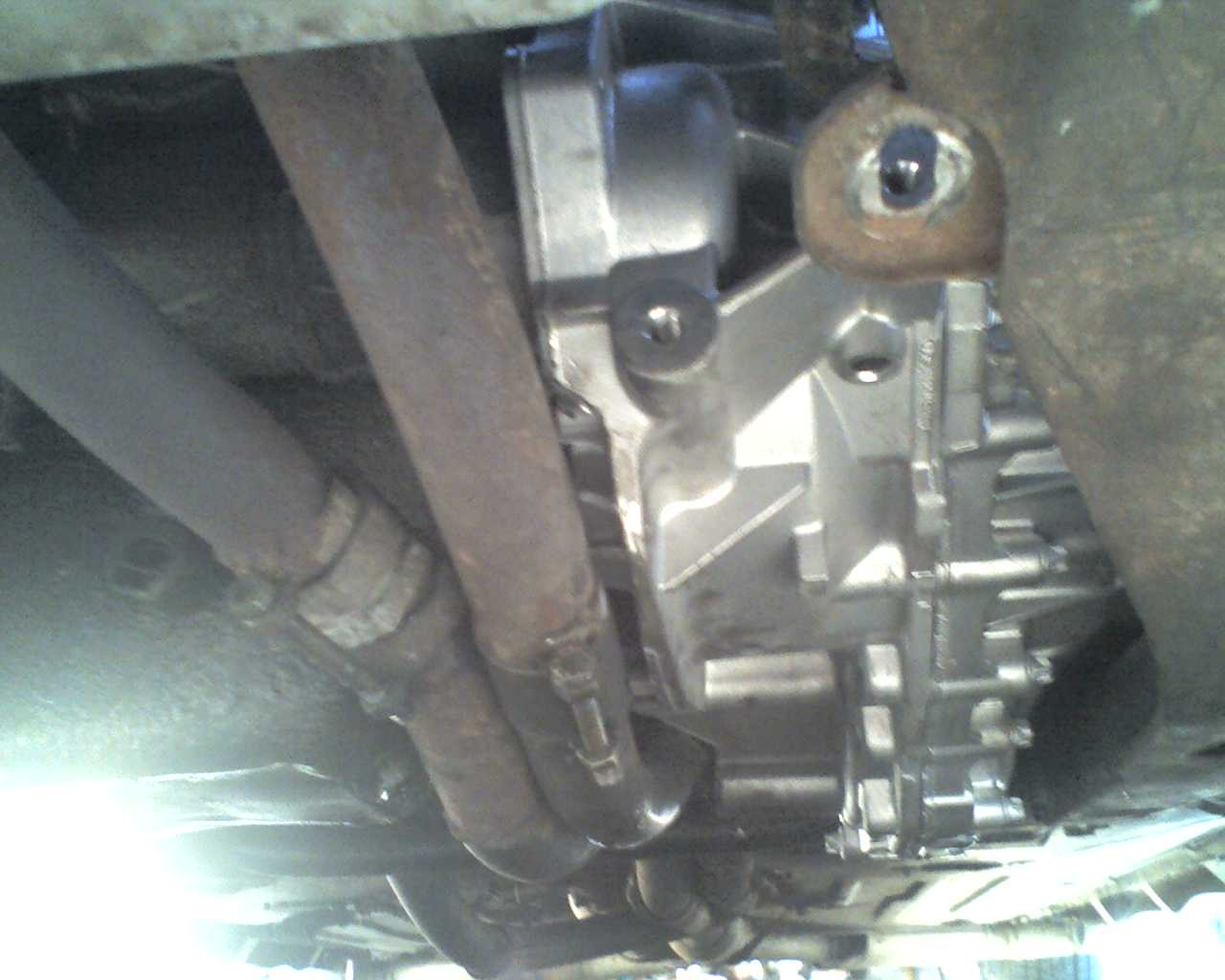

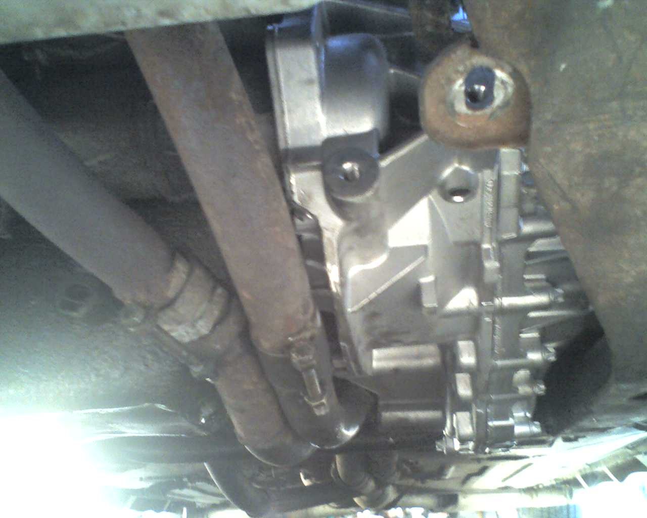

Becaue of the insane headers on my car (which are not as badly rusted as they look, but they are showing a lot of surface-rust at this point), I had to modify the bell-housing to clear two of the primaries.  Stock 3800 exhaust uses a cross-over on the top like the stock Beretta V-6s.
