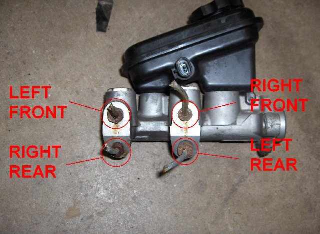

Can anyone with a pre-92 master check the ports and which line goes where? I'm replacing all the flare nuts and would like to double check the layout. I used a 94+ brake/fuel line assembly in my 91 and had to change a flare nut for it to work. Everything worked well, but I'd just like to double check that everything is correct, because now would be the time to change it in case.

Here's what I found on V6Z24.com
Top front: Left Front
Top Rear: Right Front
Bottom Front: Right Rear
Bottom Rear: Left Rear

Ok, my car was right. The pattern is different from what I would have expected (front lines from the bigger ports in rear), but it works! Thanks old man.
Re: Non-ABS master cylinder ports
You're right it does seem weird, so I went and looked at mine.
That is correct.
That is correct.

i used this pic for the abs delete on the sunfire. I used a corsica M/C iirc.
