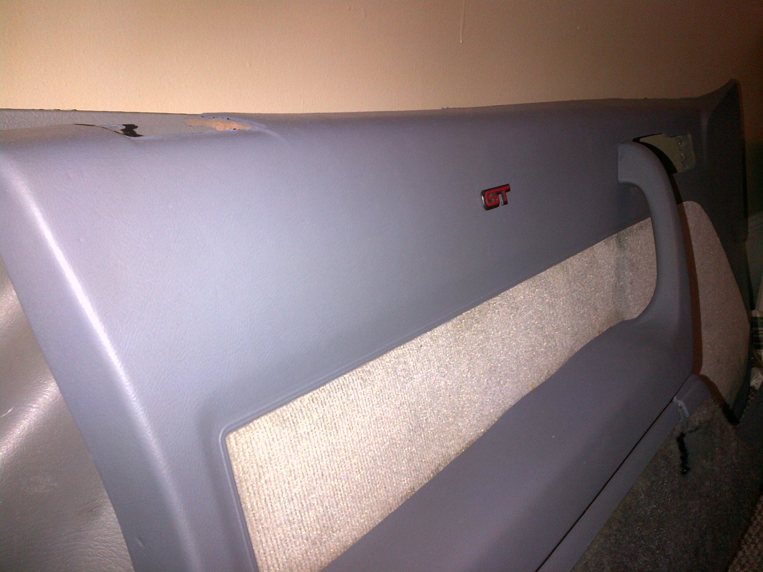

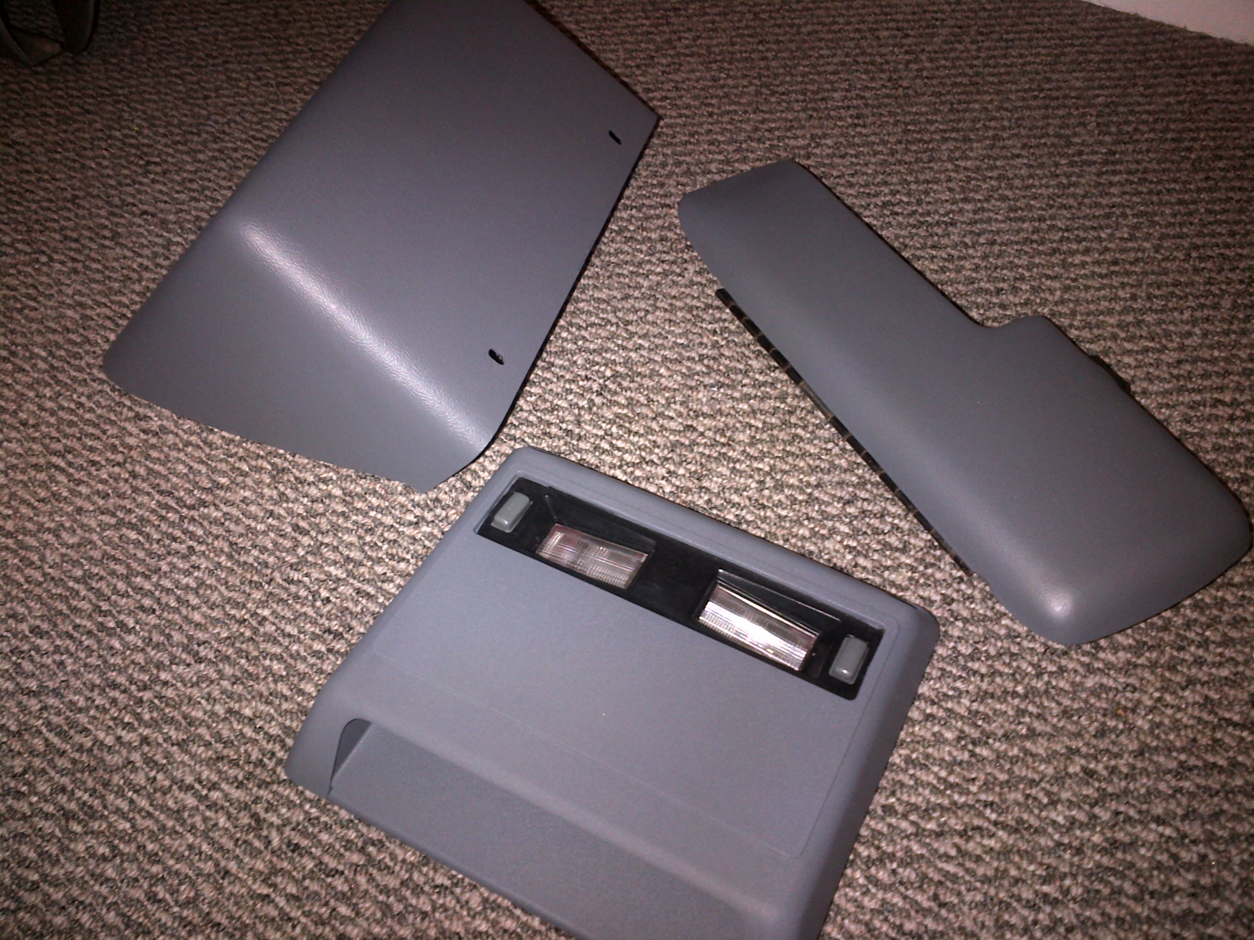

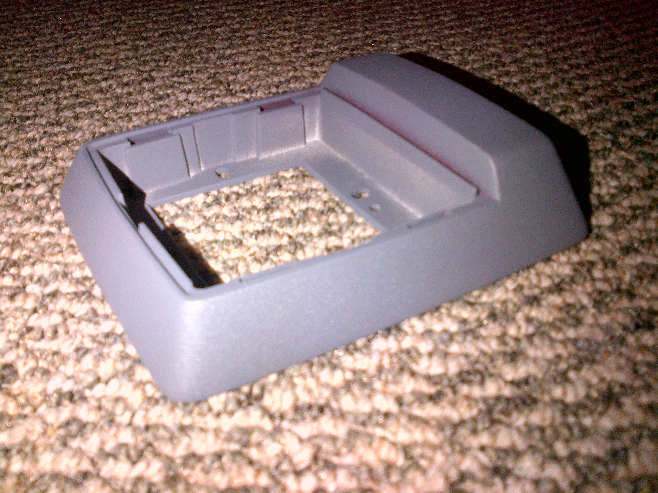

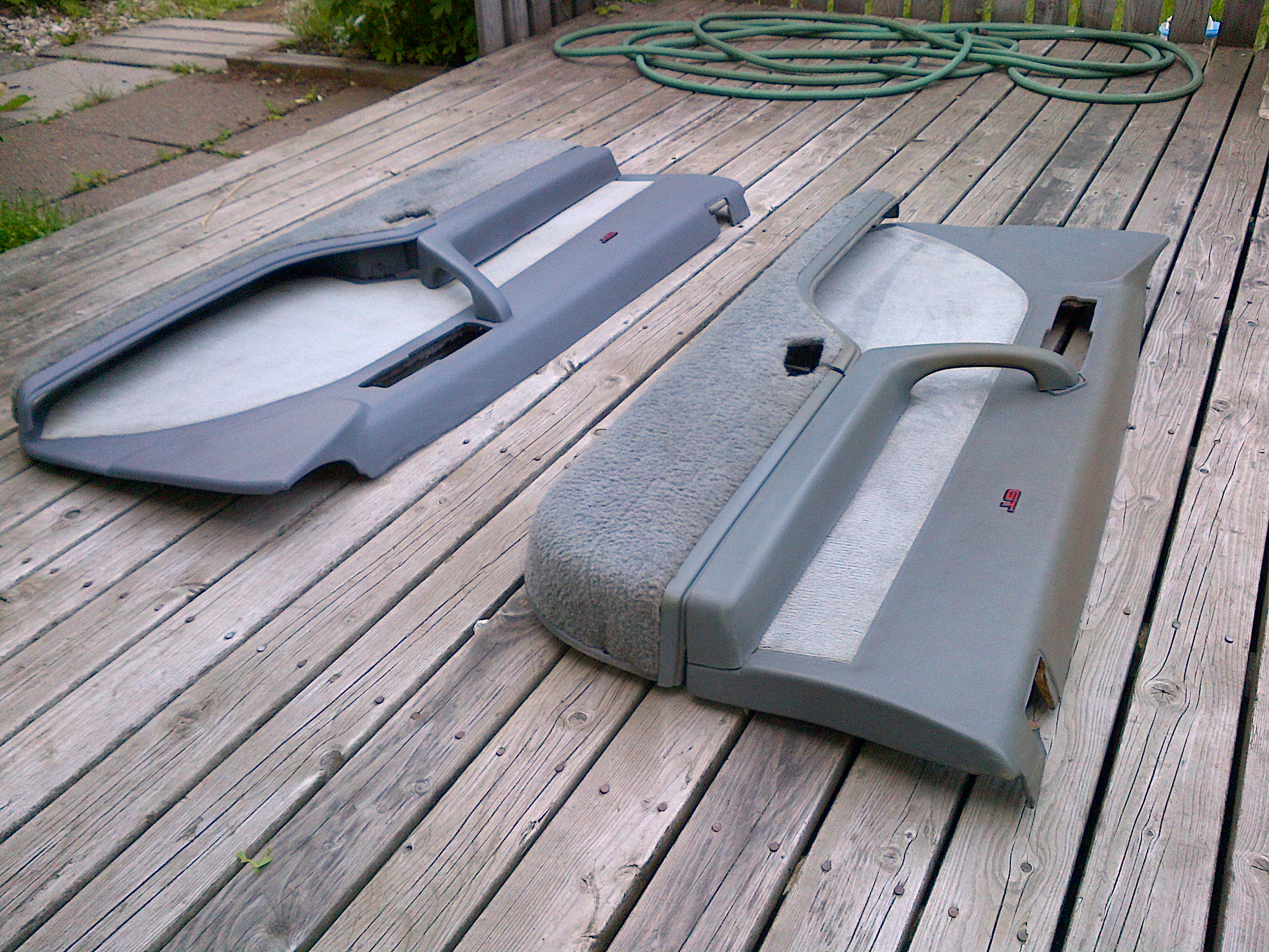

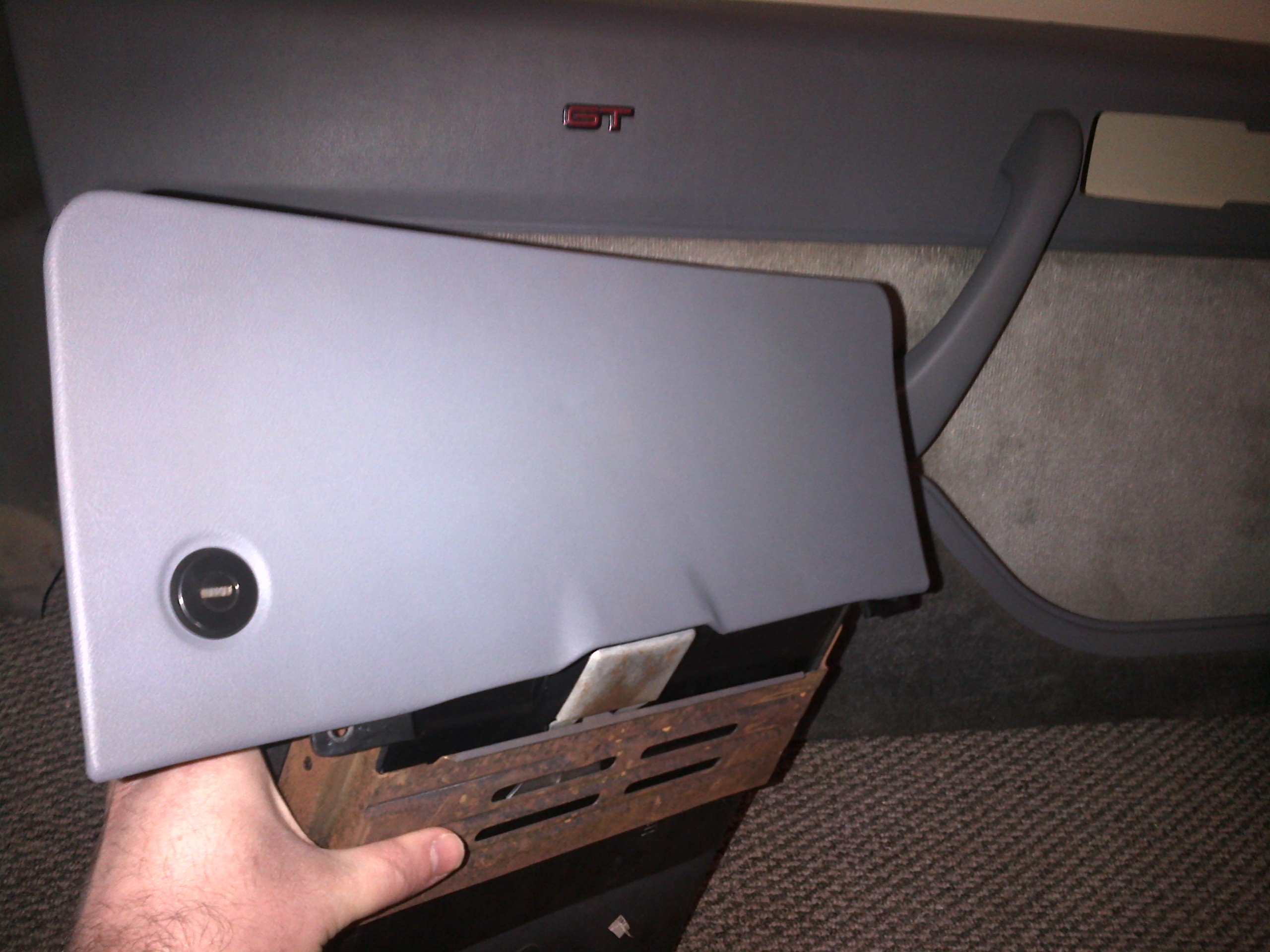

Re: Colorbond anyone tried it?

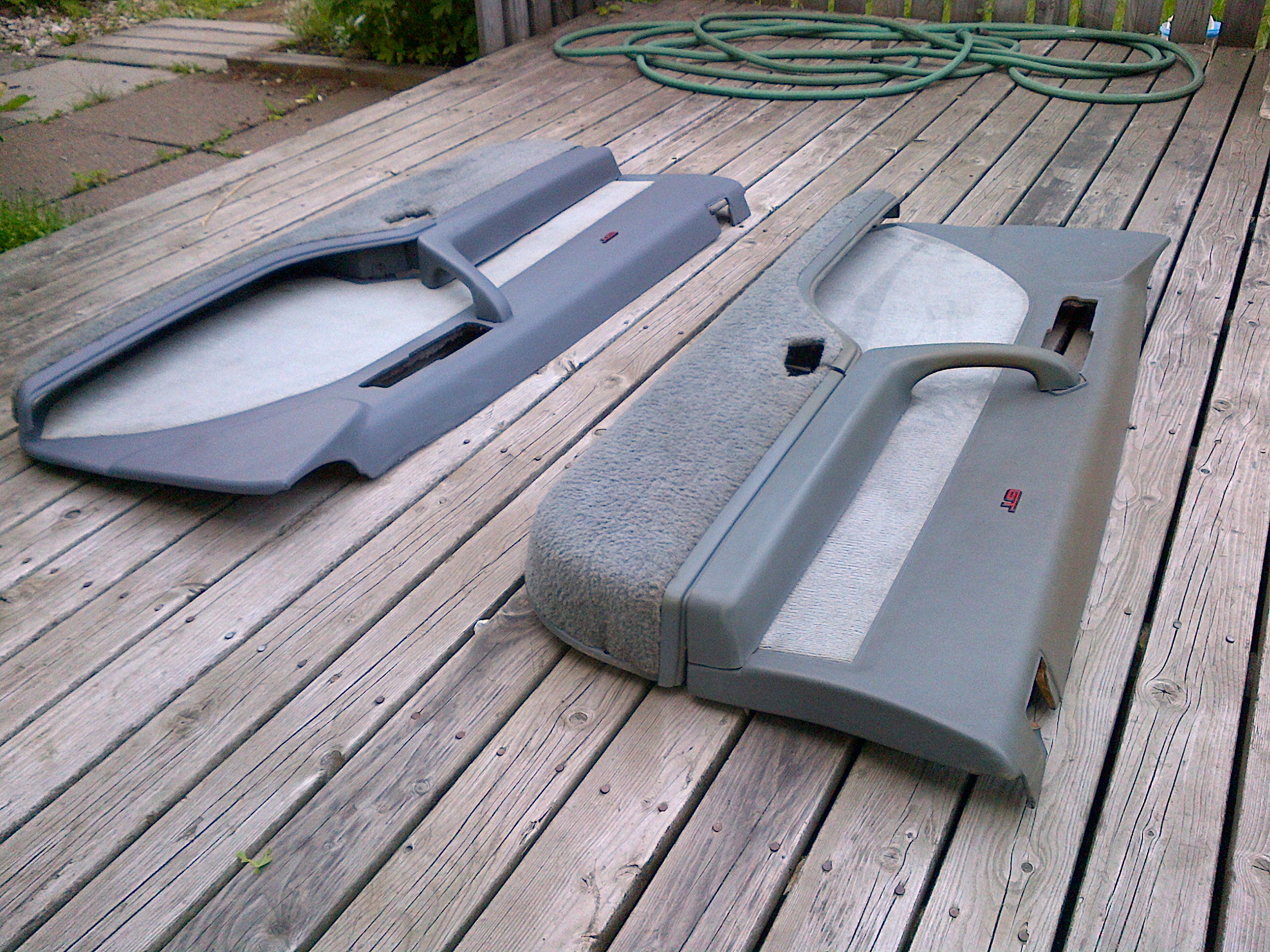

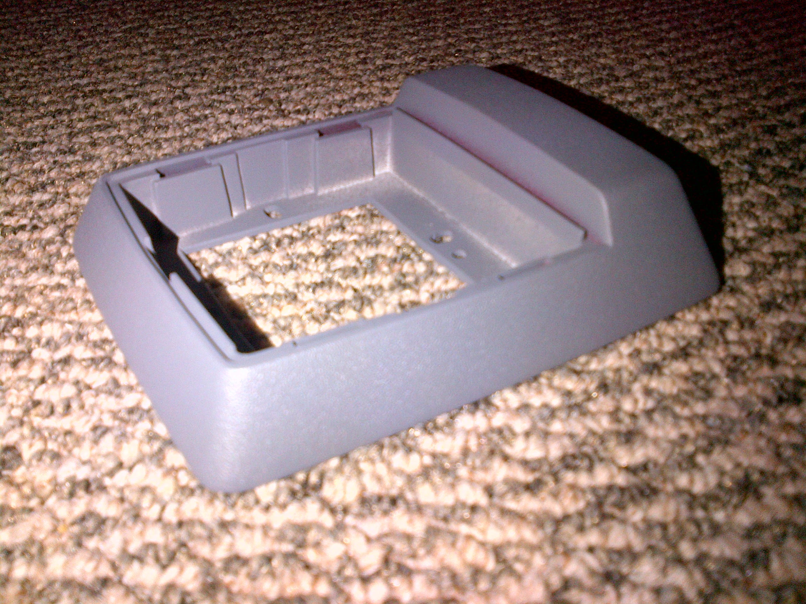

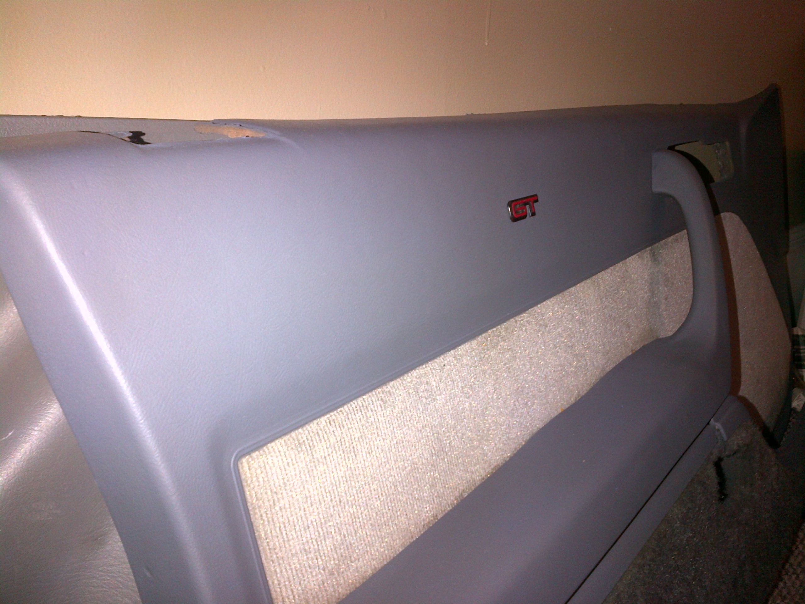

I used dye on some of the interior plastics and to repair some door panels had excellent success with the product and after a couple weeks to try is very hard to remove. Its all about prep and cleaning first, i used 99% rubbing alcohol dish soap lots of water and dried very carefully before applying very very thin coats. Most of the parts I started with for a test were red but will be installed into my 89GT when doing the GTZ interior swap, as they turned out quite nice.

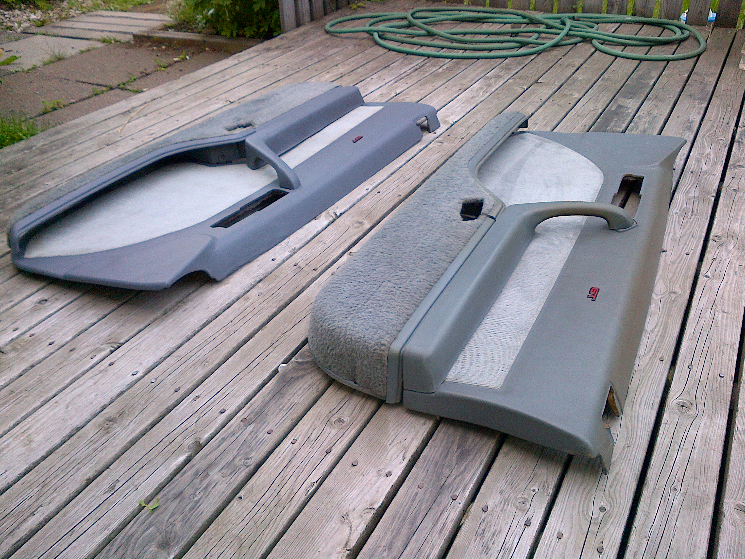

Posts: 4767
I did the maroon to black change back in 2005 with my car. The DupliColor stuff didnt hold up very well. I've used SEM on another car and it was better, but this is only for the vinyl and plastic. It does not work on fabric, period. Even strong dye made specifically for fabric does not work on synthetic fibers. I wanted to dye a set of Z seats and contacted a specialist who had me do a test. If a fabric lights on fiber and burns it will take dye...if it melts it is synthetic and will not take dye.
Posts: 4767
In this pic you can see how the fabric still looks kinda red. And it made it scratchy.
So then I recarpeted the kick panels and door trim and it was much better. The floor carpet was also changed already when I first did the swap. You can see how it looks like a true black against the console in the first pic.
