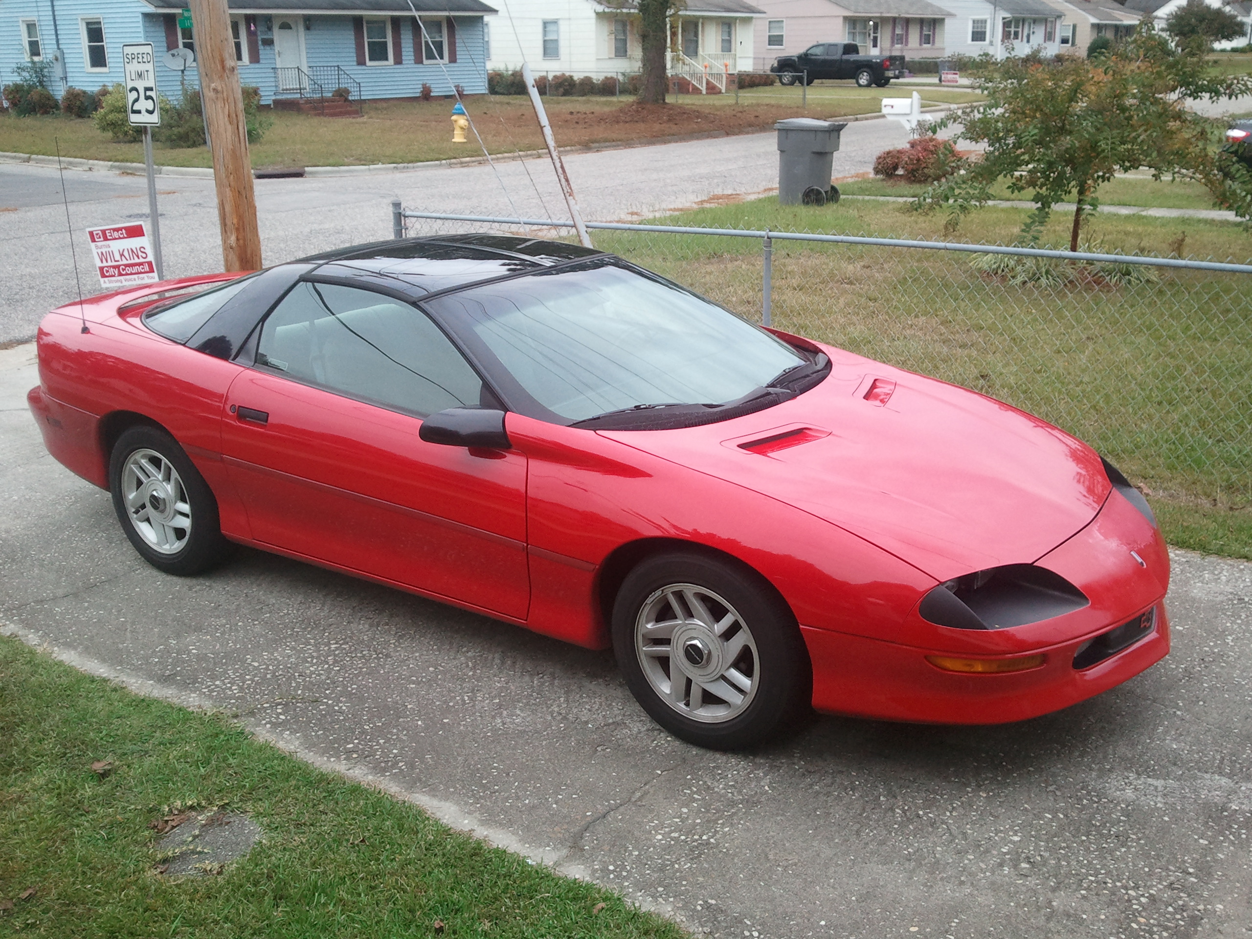

96 camaro with 3.8 v6 and 119k on the odometer. it needs a paint job and a tune up but other than that it beating the streets! i bought it yesterday to replace the cavalier that i bought...then hated. the t-tops dont leak! :Yahoo!:

NICE!!
Rodney (3400beretta) has an '01 Z28 black on black leather with a Tremac T56 6-speed he never (or seldom) drives.
Love that series Camaro!

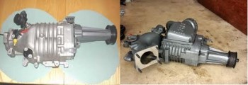

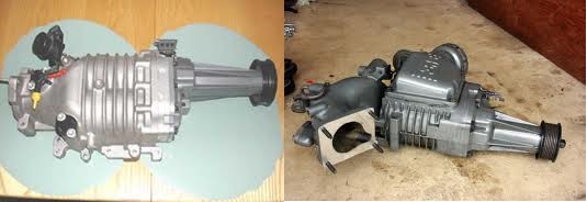

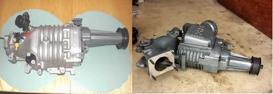

The 3800 in my GTU is the same engine as the one in your Camaro. Except I added the heads, injectors, computer and harness from a L67 Super-Charged 3800 Series 2 Bonneville SSEi, and the flywheel from a 3800 Camaro/Firebird from the same era as yours. So, imagine taking the engine from your new Camaro and dropping it into your old Beretta, and adding another 40-50 HP of forced-induction goodness on top of that. :twisted: My GTU's engine is modified a little more beyond that too. It has been a very good and reliable daily driver and very competent snow-car (FWD, and manual tranny for the better control) for the last few years. And it was one of the easiest builds I've ever done, until I went six-speed on that car... :roll:
You could use the L67 3800's computer and modify your wiring harness in your Camaro if you wanted to run forced-induction, but the 3800's M90 Super-Charger would not fit into your car because of how far the engine is pushed back into the engine-bay -the Super-Charged L67 is a FWD engine, so the TB would be on the back of your engine pointing into the firewall! The M90 also came in the Ford 3.8 liter Super Coupe Thunder Bird in the '90s, and the case on it was different to accommodate the RWD Thunder Bird and also to feed the engine through an intercooler (if GM had used an intercooler on the L67, it could have gotten an extra 20-30 HP on top of what it already got :pardon: ). I don't know how hard it would be to modify that M90 to fit the 3800 in your Camaro, but I'm sure it could be done. Or you could use something more generic, like a turbo setup or a Paxton-style Super-Charger, and have the all-GM L67 computer to support it (I'm sure shift-patterns and gear-ratios are a difference you would have to tune for between your Camaro and any L67 application).
Photos courtesy of Google.  On the left, GM's M90.  Add a MAF and TB onto the length of that unit... On the right, Ford's RWD application M90, note the shorter snout.
