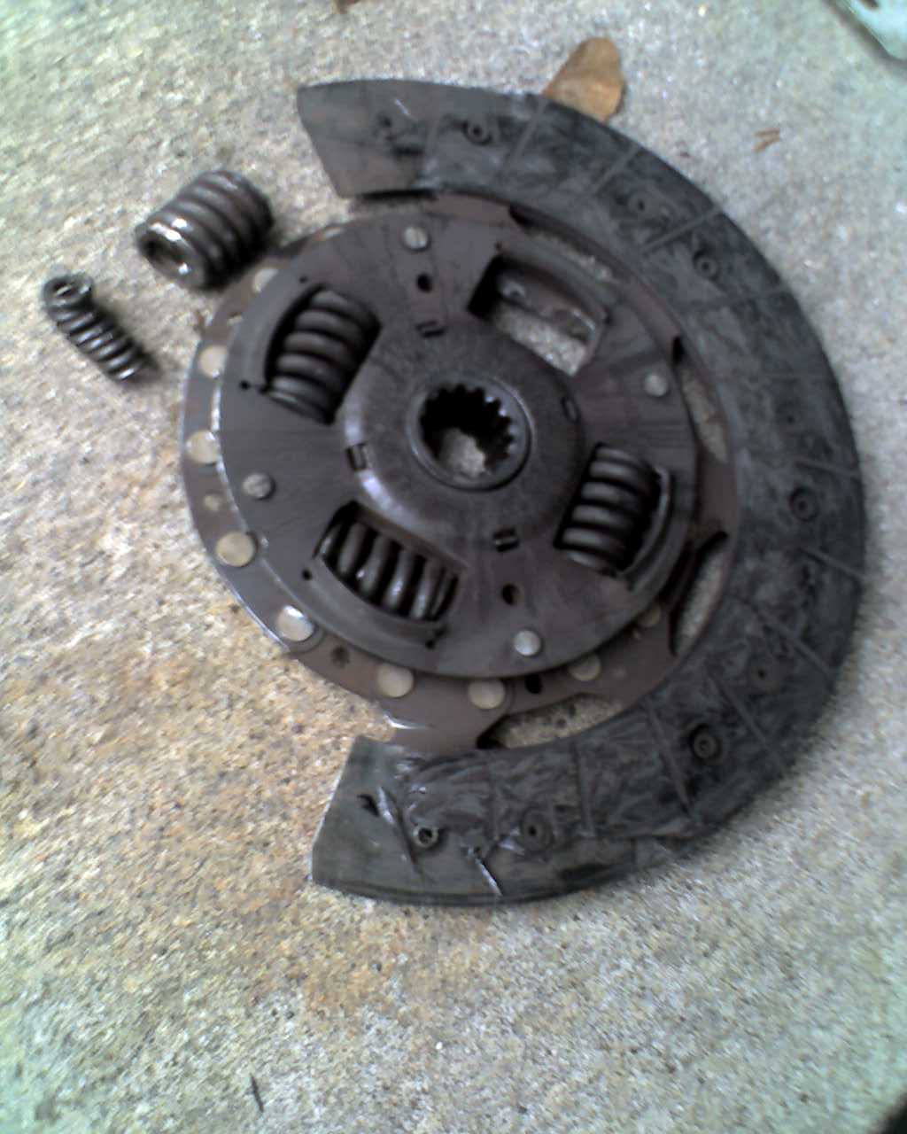

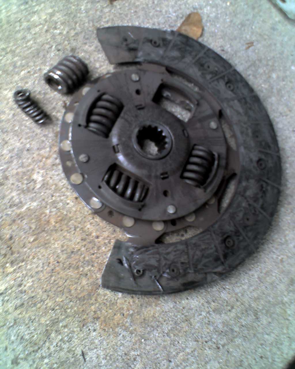

The clutch friction-disc from my GTU exploded on me a year and a half ago. The car had performed almost flawlessly for years before then as a DD, except that the 3800 SC would cause the clutch to slip under WOT in fourth or fifth gear, sometimes in third. I was pulling a second car when it died, and the GTU was heavily loaded too. I have no one but myself to blame for it, but the timing was... terrible. I did minor damage to the pressure-plate, and luckily didn't hurt anything else. I ended up going with a Stage 3 ceramic puck-clutch, but my car is already pushing the envelope for even this clutch so far as estimated HP, so it was worth the extra $$ for me. If LUK was rated for ~300 ft-lbs of torque and ~275 HP, I would have gone with them for their price...
