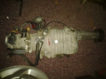

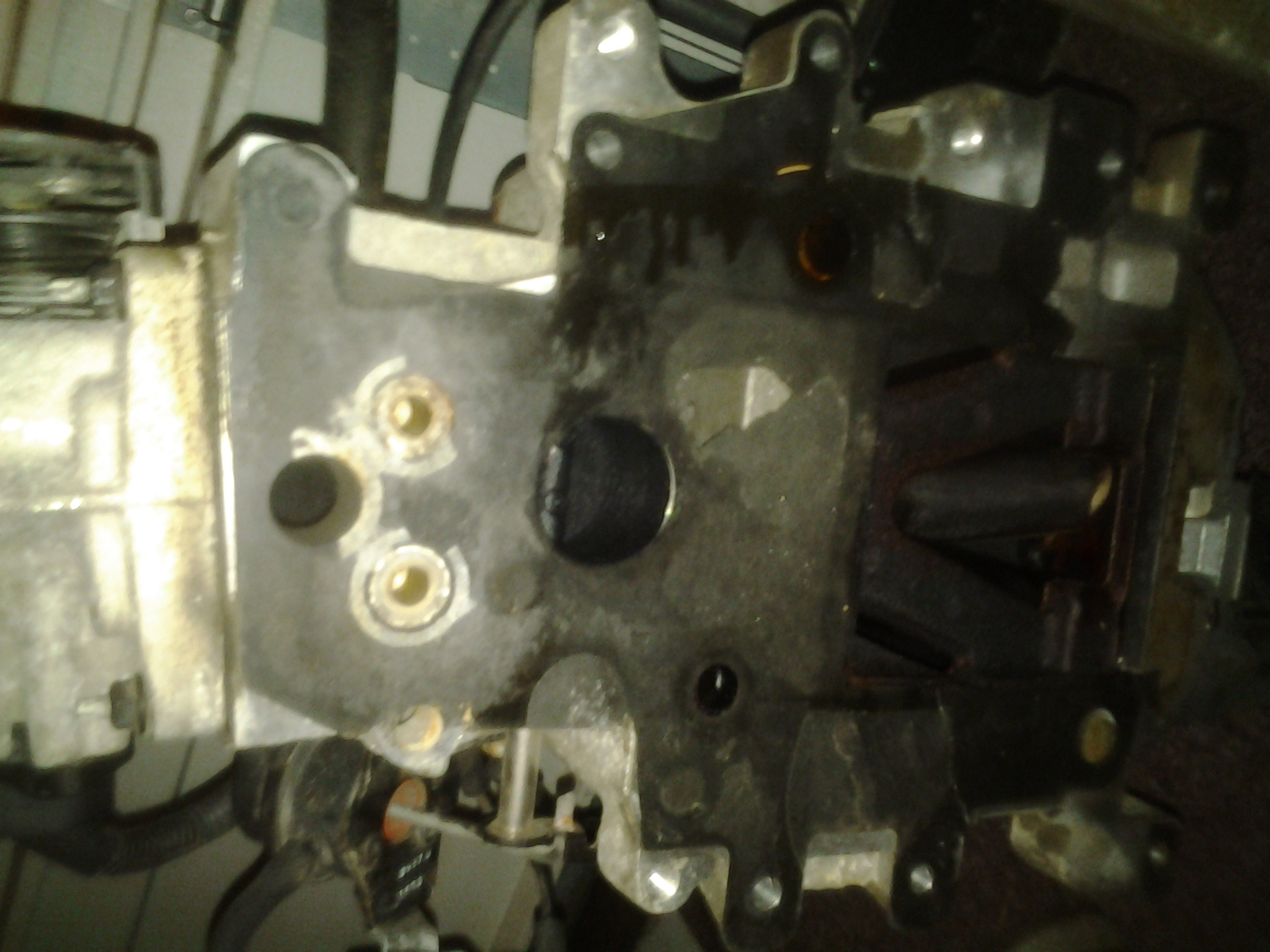

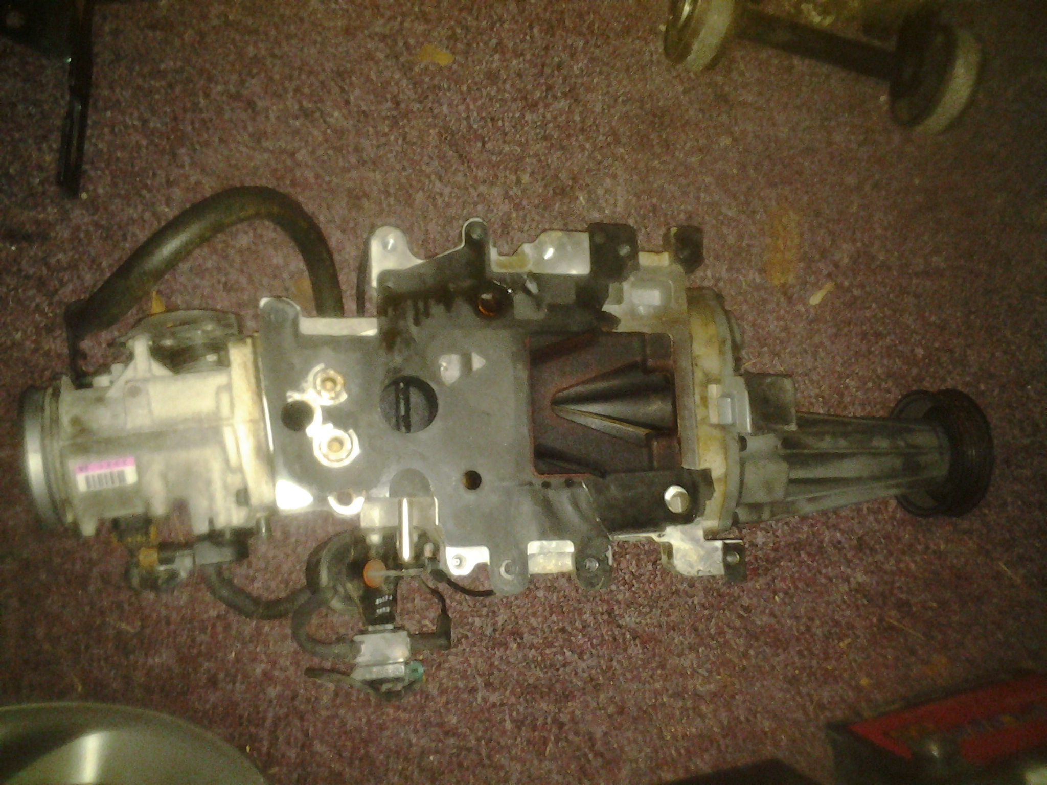

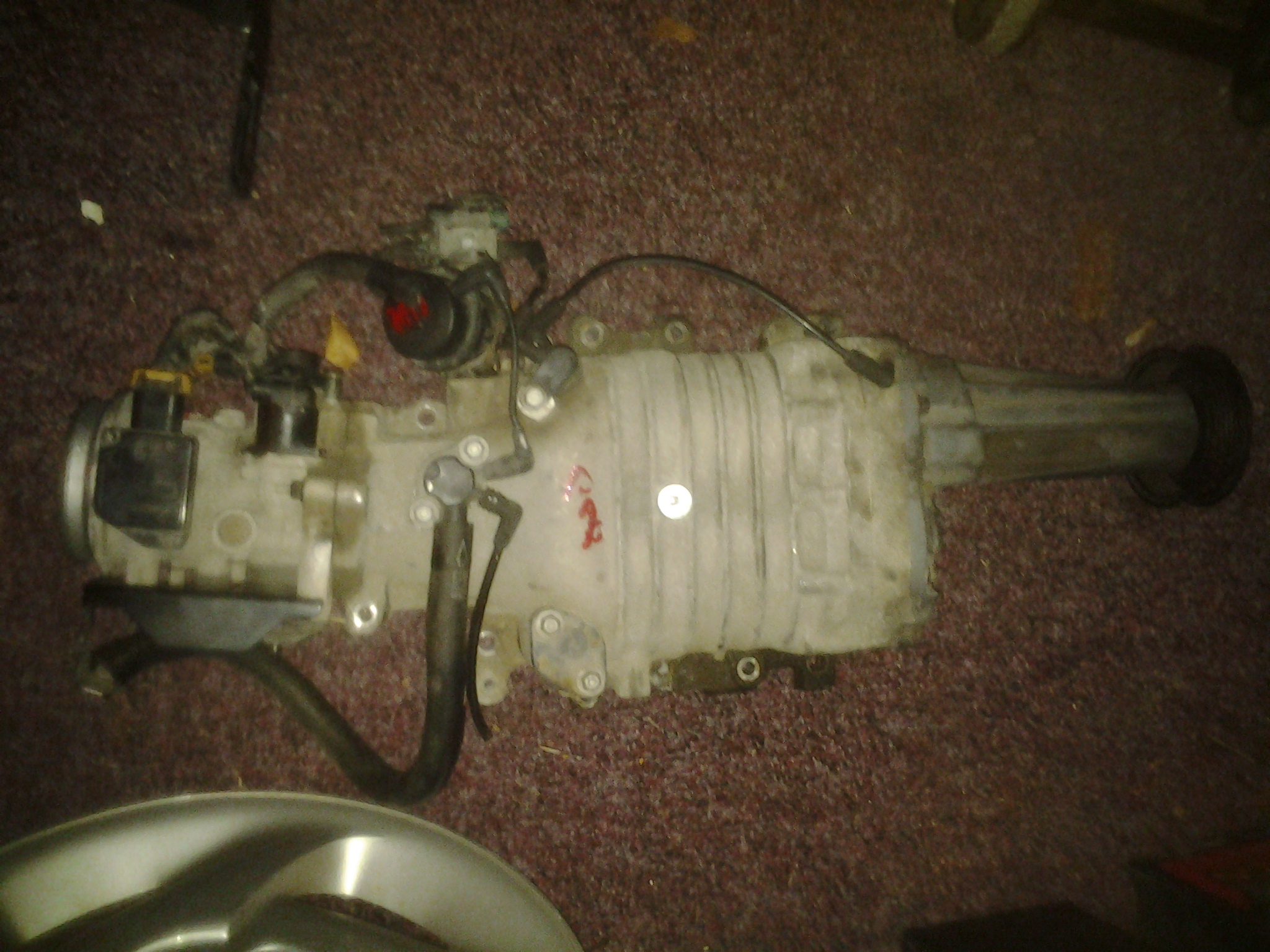

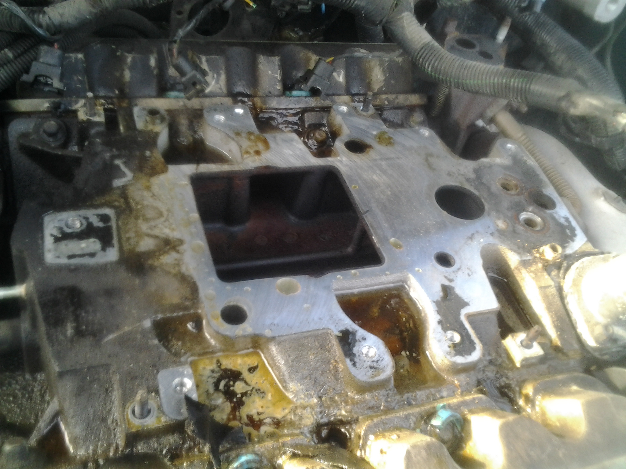

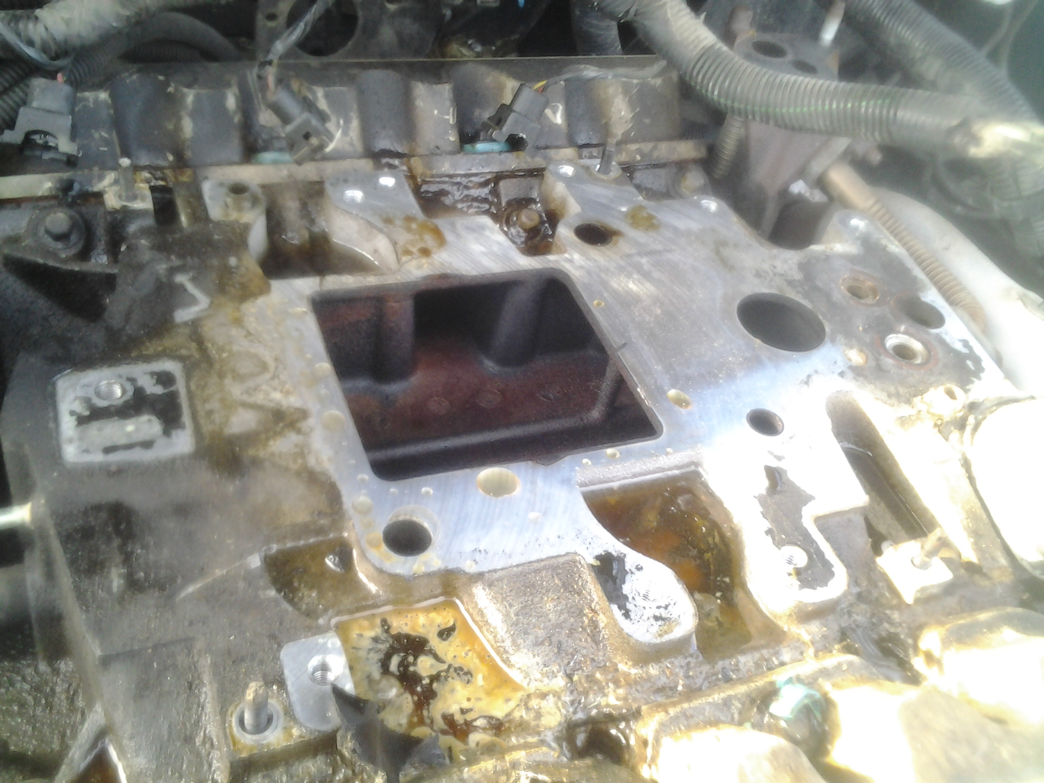

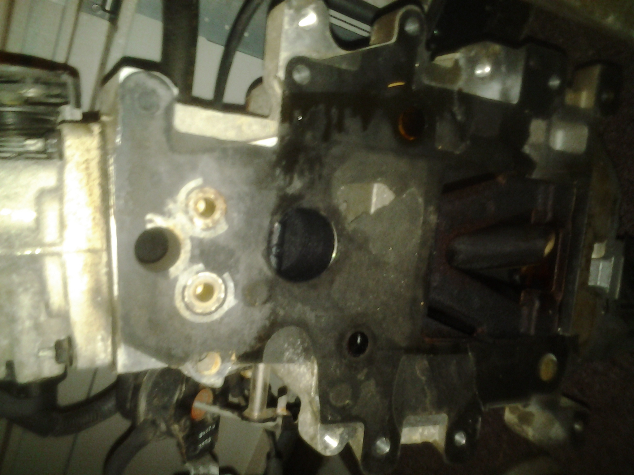

Here are photos of the M62 and the top of the lower intake of the 3800 v6 that the M62 came off of.
Top M62 close up
Top M62 close up
Top of M62
Top of M62
Bottom of M62
Bottom of M62
top  of lower intake of 3800 v6

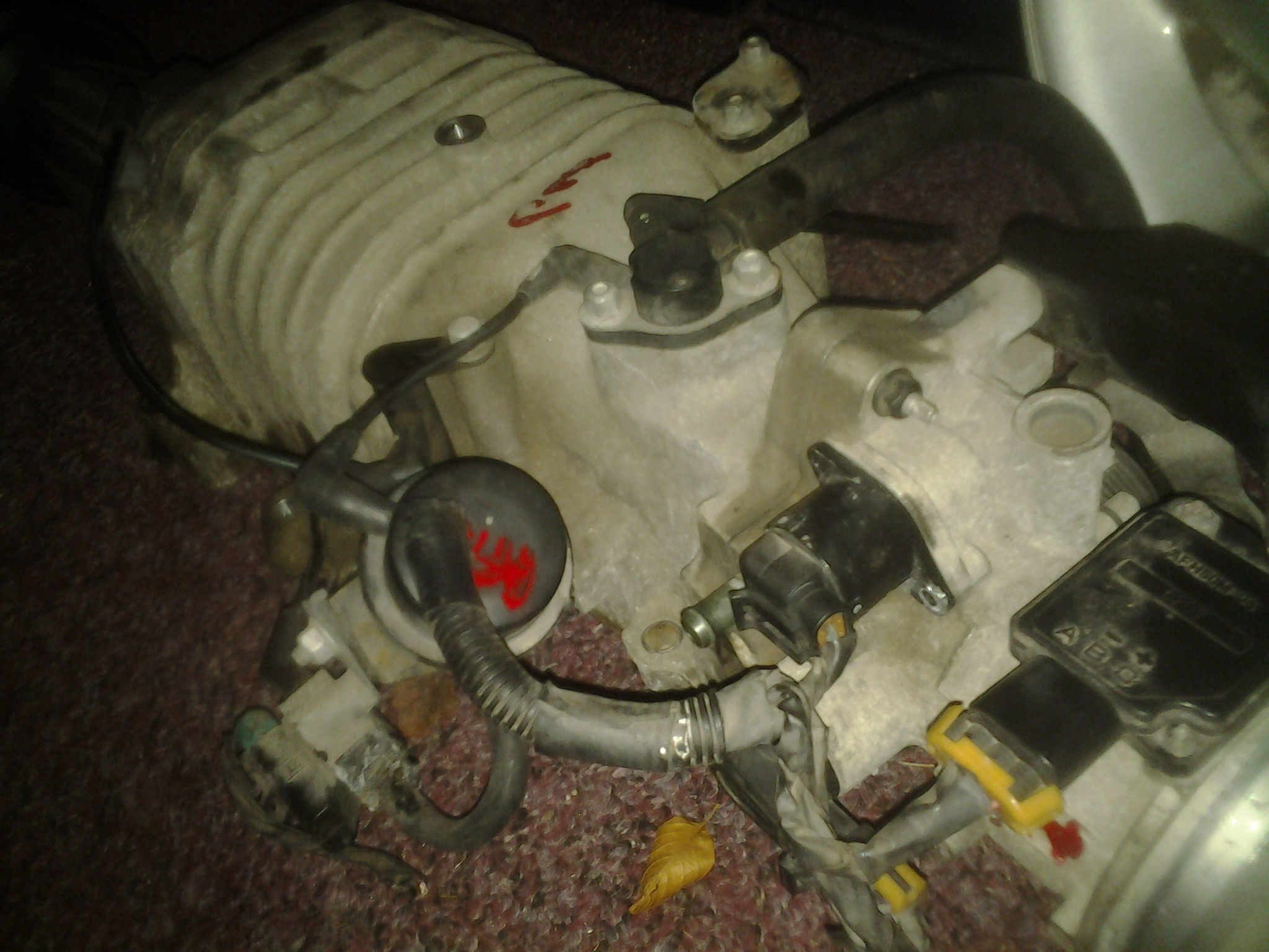

One more photo:
In this photo from left to right on the supercharger:
1) EGR input hole.
2) Throttle body cooling lines both next to each other. two holes about 1-2 inches apart vertical.
3) Pressure relief flapper controlled by vacuum thing.
4) 2 holes, I am not sure what for, cooling? Not sure what they are for, about 5 inches apart vertical.
5) The big hole where the forced air enters the engine lower intake.
6) bottom right of the unit in the photo, looks like another possible coolant opening?
What do you think?

Posts: 1851
Re: I finally made up my mind. M62 for my Beretta!
I have two of those bad-boys sitting in storage, I'm not sure what I'm going to do with them yet... 8) Are you planning on machining-down the 90-degree 3800 lower intake to fit into the 60-degree 3.1? I have a really hard time believing that will be doable, I don't think the ports will line up at all... :no: Or are you planning on mounting the M62 on top of the 3.1 upper intake plenum? That intake is almost flat anyway, if you can machine it down a little, the M62 would fit pretty well, I think. I say go for it. I've looked at doing a similar setup on my '86 Fiero GT, which has a 3X00 in it right now (despite that I'm not a big fan of those engines due to the LIMG issue, but it will get a Dorman steel-gasket upgrade when I swap it over to five-speed once I have time to work on the car. Alternatively, I have a 4.6 Northstar that I may drop in there instead, especially if I find someone interested in buying the 3X00 from me in the future). You will likely lose the power-steering pump, at least from the stock location (not a big deal on my Fiero, since those cars didn't have P/S in '86). I would say that you could plug the 3.1's TB opening off to make everything cleaner under the hood. You might have to find a different throttle-cable though, I had to swap mine out on my M90 (Series 2) on my GTU. This will NOT fit under your hood though, and sitting transverse, it is too wide to put a standard cowl or anything like that on it (again, not really a problem for my mid-engined Fiero -the stock spoiler blocks half of the rear-view anyway :wink: ).
What are you planning on doing for the tune? Right now, I would eat Ramen noodles for a week if I could get someone to sell me a DHP for a decent price, but if you are still running the ECM from the '88, you would need a chip instead. Have you considered fabricating some sensor-mounts and using a 3800 PCM for this? The 3800 Series 1 is a MAF-controlled engine, so it should work pretty cleanly without an absolute need for a tune to make it reliably driveable, although a tune will certainly get you more bang-for-the-buck. Just a thought... :pardon:
As for some of those mystery holes, the M62 has the PCV valve mounted inside it, so the system breathes up through a couple of those holes. I would ditch the TB coolant-lines altogether -they are rarely helpful. And front-most port (closest to the TB) is for the EGR -blocking that off is my recommendation.
Good luck, keep us posted. :good:

I am a bit confused here I thought the M62 was the supercharger that mounted in front of the engine not the one that mounted on top of the engine do a quick Google images search and you will see what I'm talking about, yeah the m62 I'm thinking of They only made 20 of them and they were for a 3400 engine not the 3800,
I could be wrong but the ones pictured in the photos above is and m90 supercharger
In my opinion an m62 would be much better because his design for the 3400, but it's rarity and it's reliability puts it in a price range around $2000-$3000, I thought about it instead of my RSM kit but there is no room to mount and intercooler or aftercooler piping

Slinky wrote:I am a bit confused here I thought the M62 was the supercharger that mounted in front of the engine not the one that mounted on top of the engine do a quick Google images search and you will see what I'm talking about, yeah the m62 I'm thinking of They only made 20 of them and they were for a 3400 engine not the 3800,

The pictures you provided are an M90 -this is the same SC I have on my GTU's L36/L67 hybrid 3800 Series II. They were used from ~'96 or '97 up. The M62 was used on the previous 3800s, the Series I -it looks totally different, and is a lot smaller.
THIS is a 3800 M62...<br />Photo courtesy of Google Images.
Now, when you say you won't be using the bypass valve, please tell me you aren't talking about disconnecting the butterfly-valve built into the SC... If you disable that, you can seriously damage your supercharger, and almost certainly WILL damage your engine... It keeps the manifold pressure from spiking during RPM changes. It isn't quite the same as a turbo's bypass valve (or blow-off valve for non-MAF units), as most turbos are placed upstream of the throttle-body (something I've been thinking of changing on one of my next turbo projects :twisted: ), and it is also not exactly the same as a turbo's waste-gate, but it is more similar to that. Without this bypass valve functioning, well... =@
