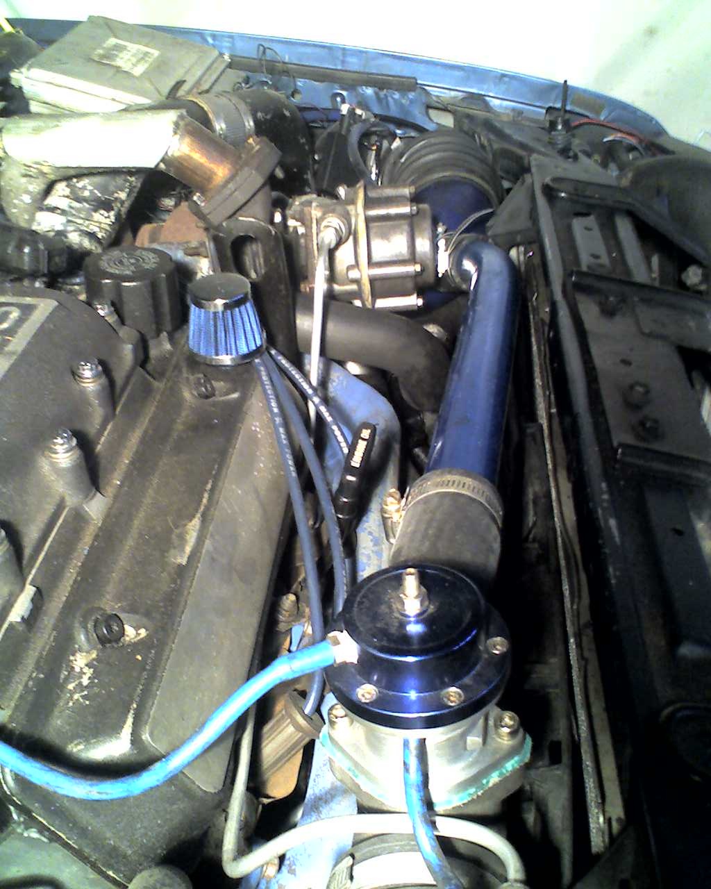

...I 'simply' relocated the battery behind the engine on my '90 Turbo 'Retta to get more space in that area... I pulled the HVAC blower housing out, notched it a few inches, and welded in a new tray. That way, I have all the room I need by the throttle body. Of course, I was moving the original intercooler there for the NACA-style hood-scoop to feed... Now I use that space for the ECM, MAF, CAI filter (still force-fed by the NACA scoop
), and intake lines running from the turbo to the front-mount intercooler... In theory, I have a better weight-distribution too.
Without going so extreme though, I would just bend the edges of the battery-tray down where you need the battery to go. It looks like Woody's battery moved a little inboard and angled a little.
