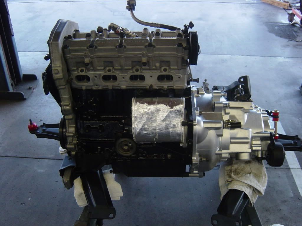

Cam tower to me is the whole cam carrier assembly/housing.
LO vrs HO = smooth vrs non smooth style.
Image = LO
Image = HO

I don't think there is actually a difference in any of the casting style/quality or more importantly, specifications between L.O., H.O., or even W41 housing/carrier/tower/whatever. There may be a finish-quality difference from one year to another, I don't think so though. Mostly, I think you are seeing the difference between old/corroded and clean/well-taken-care-of engines. So far as I recall, the only functionality difference in the cam housings was on the SOHC engines (which never made it into a Beretta), as they switched mid-year '92 from using the intake cam housing from the DOHC engines to using the exhaust cam housing (or vice-verse).

Please relook at the pictures.
You cannot run all cams and lifters in the LO version.

Okay, I see the difference you are talking about now. I still think that is a year-group difference, not a VIN A/VIN D distinction, as it looks like they changed the casting style for the '90 year, but I am not certain. However, the lifters DO cross-reference for all Quads from '87 up except for the '95s, which appear to be using the 2.4 Twin Cam lifters instead, so I am still not convinced that the housing would not be interchangeable. But, I am not a Quad expert, and have only had a few engines in that family, and most of those were the 2.4L cousins. I guess further research would be necessary, unless a Quad expert wants to chime in here to settle it for us.

It's hit or miss with HO cams in the LO towers, but more likely be an addressable concern with cams that contain more lift.
To be safe for those that swap and go parts, it would be in ones best interest to stay pure with guarantee to interchange parts.
