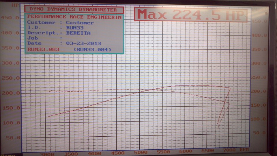

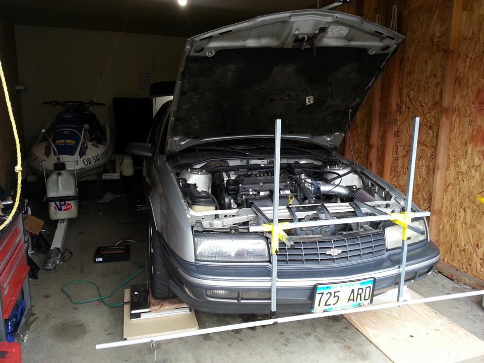

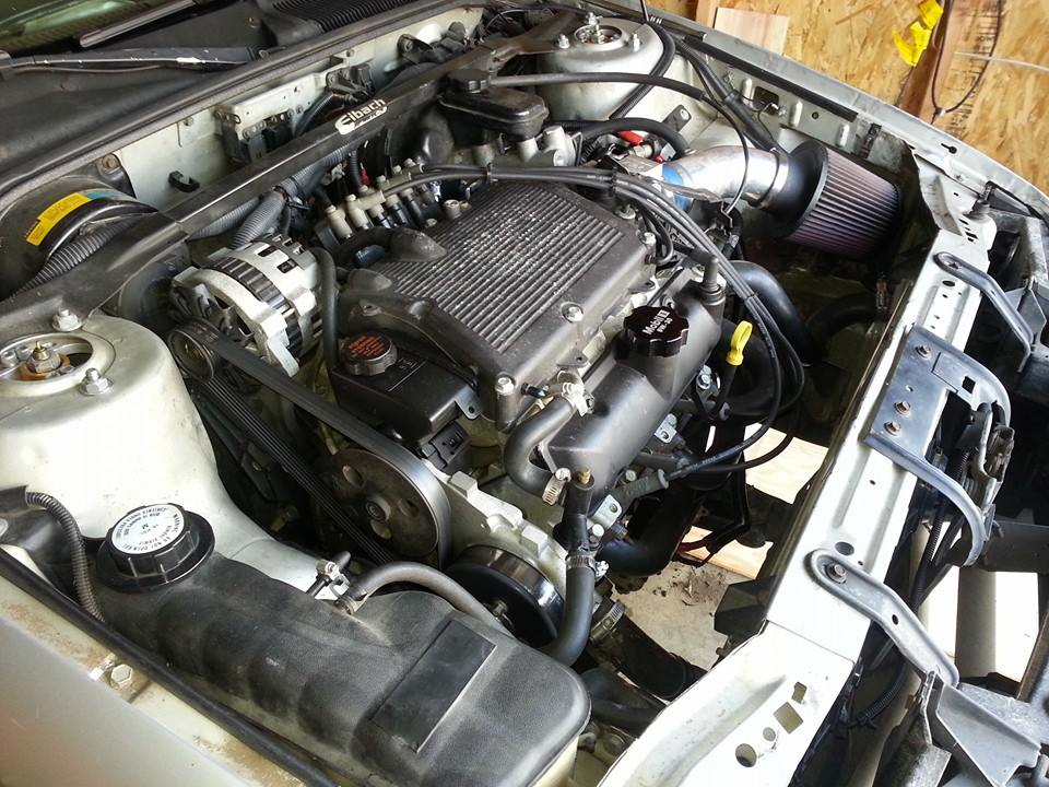

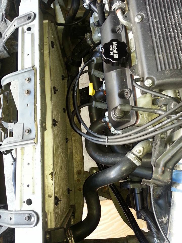

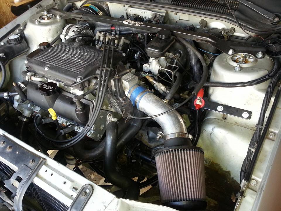

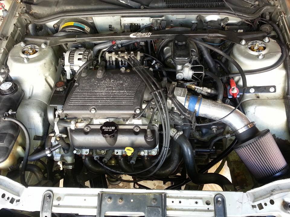

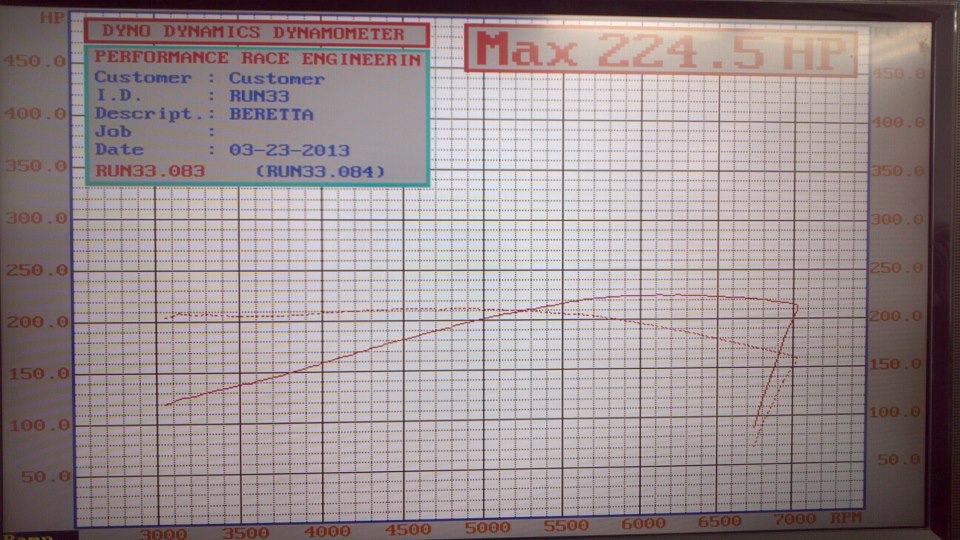

I dont think I have really posted pics since bstuff so here are some of how the car is now. 100% random and in no correct order. these are the past 2 years or so

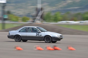

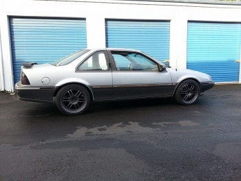

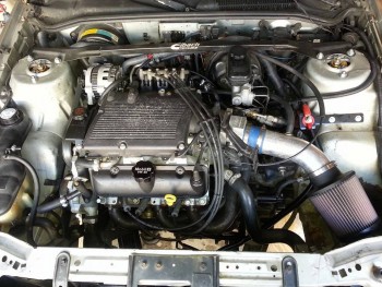

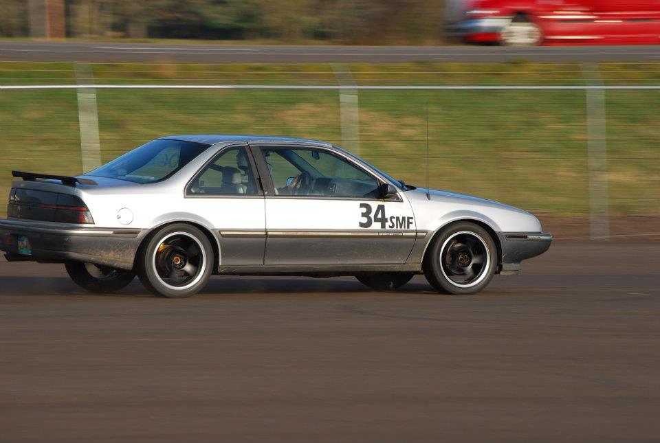

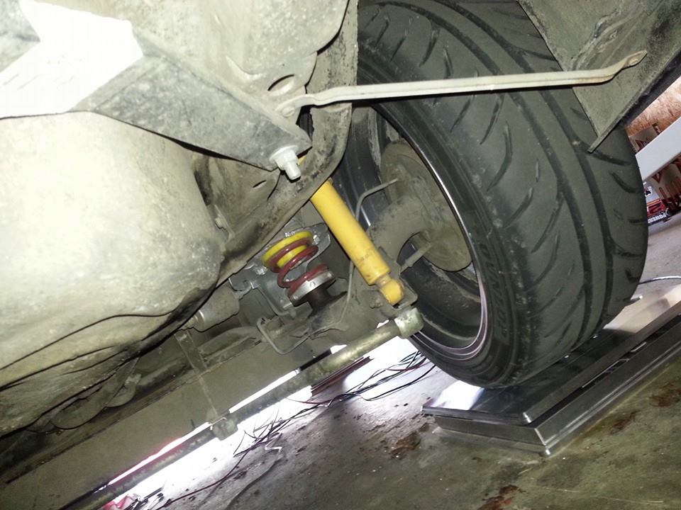

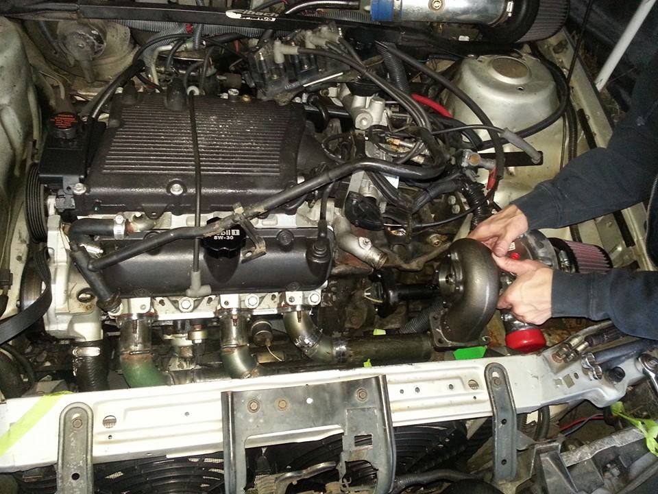

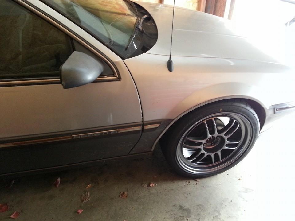

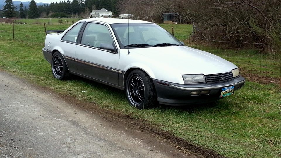

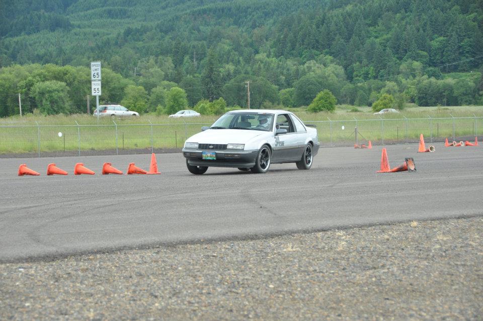

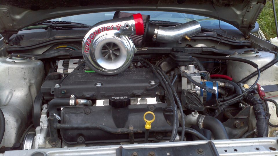

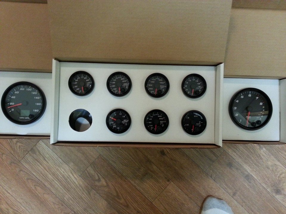

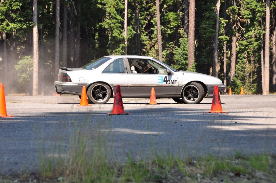

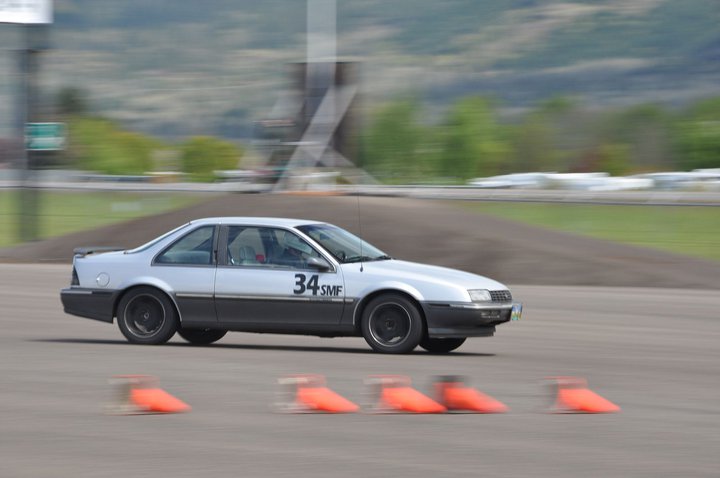

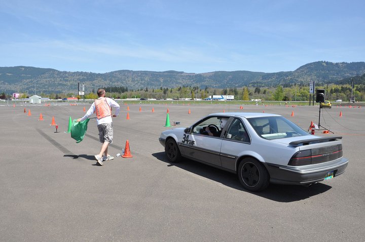

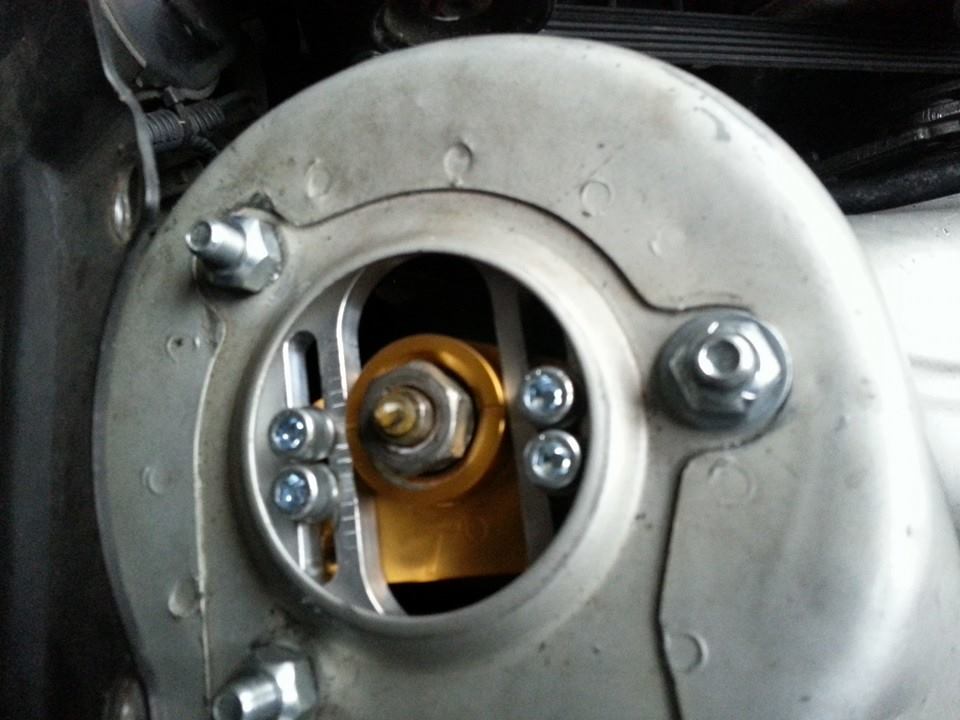

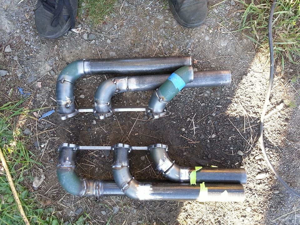

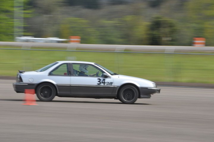

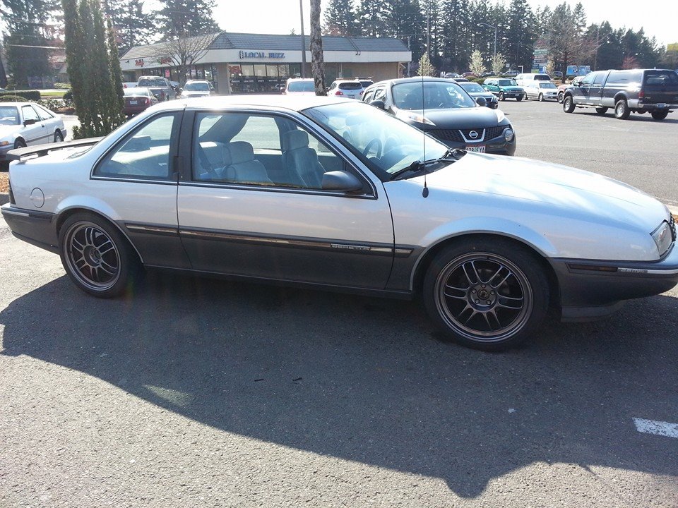

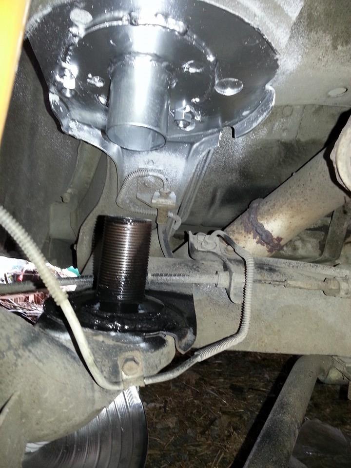

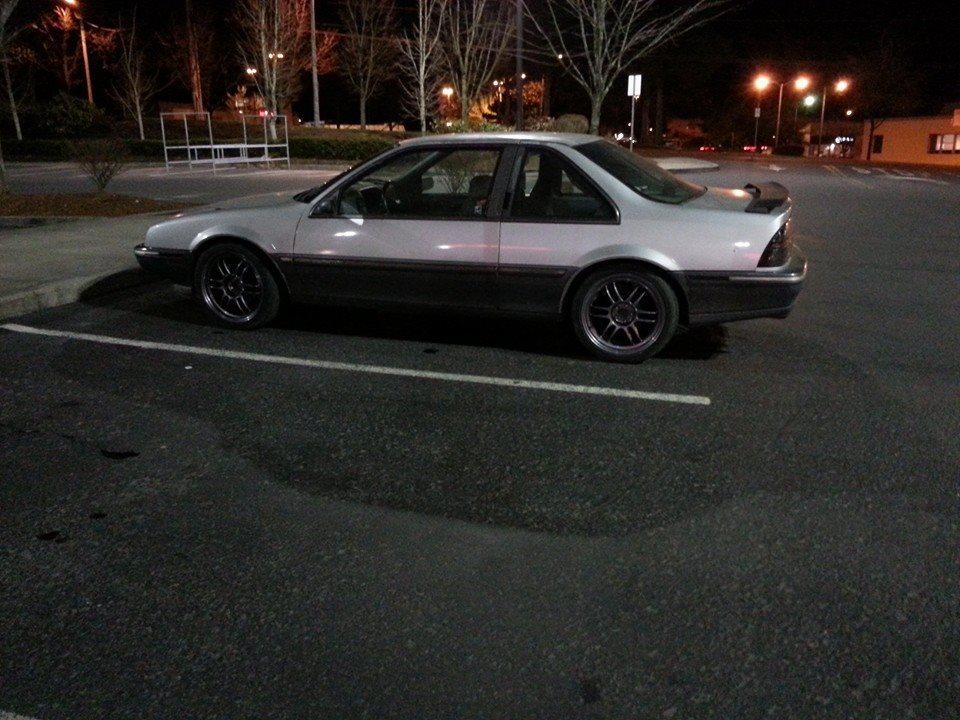

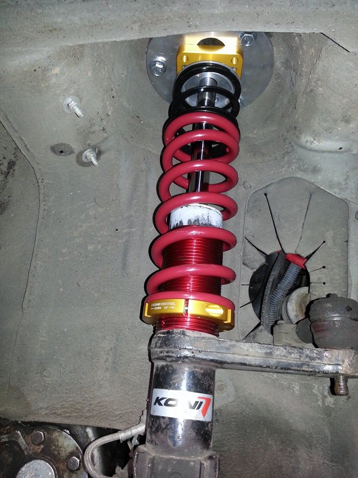

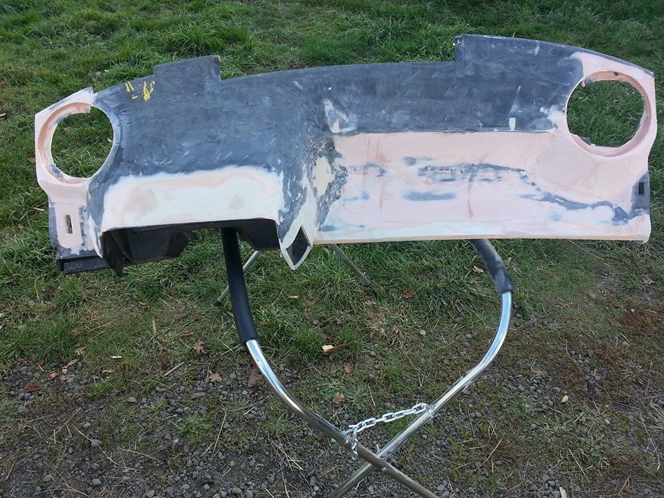

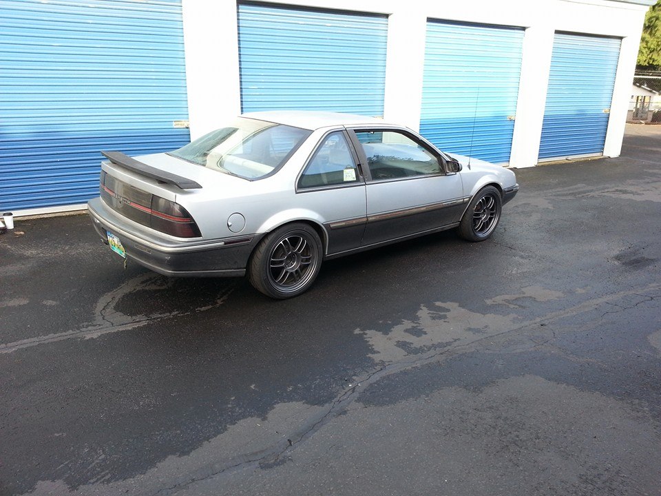

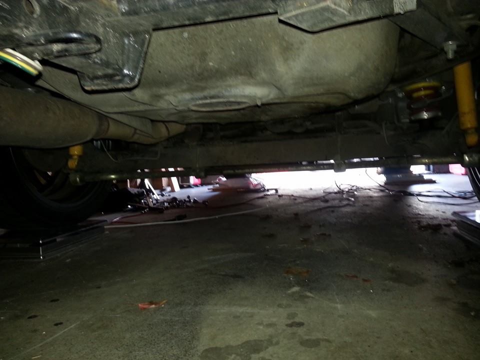

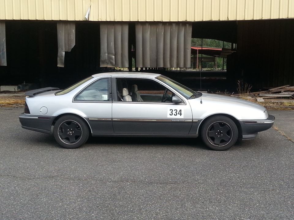

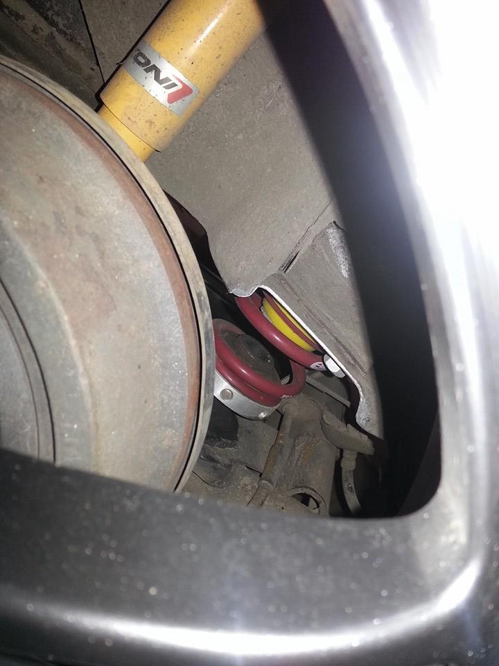

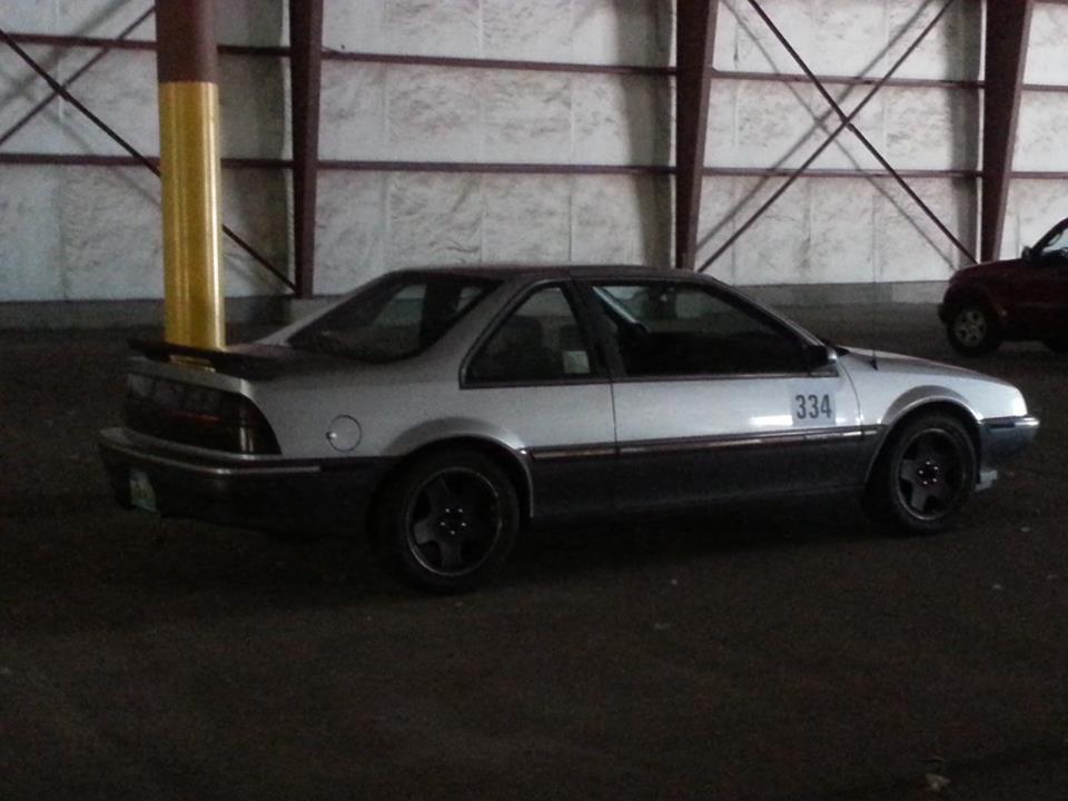

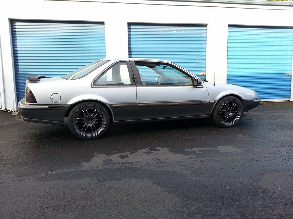

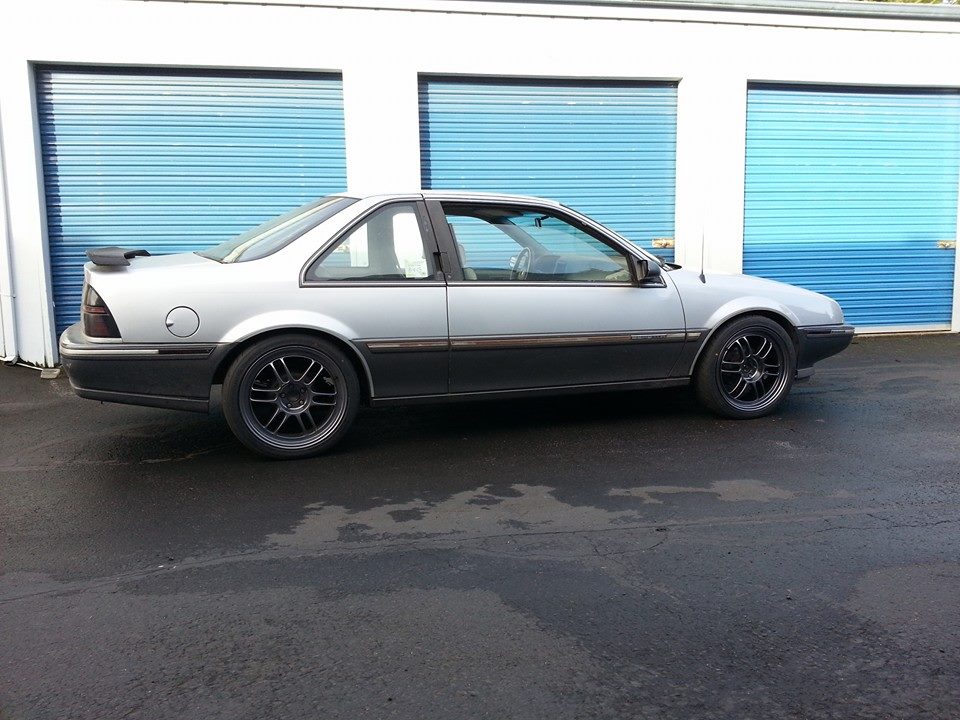

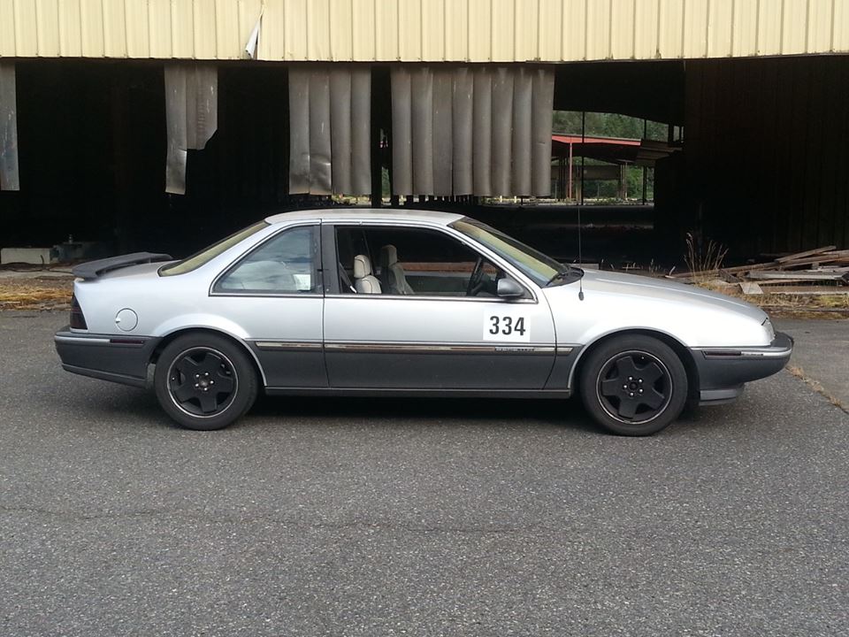

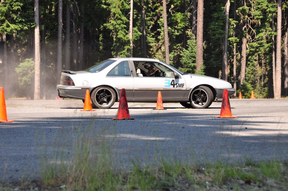

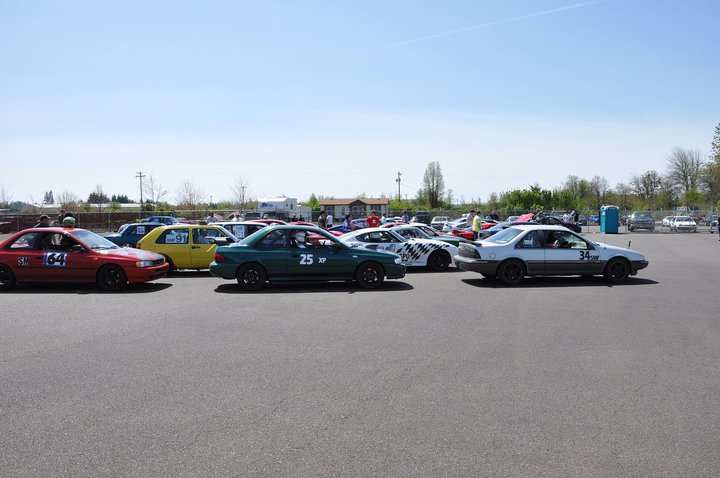

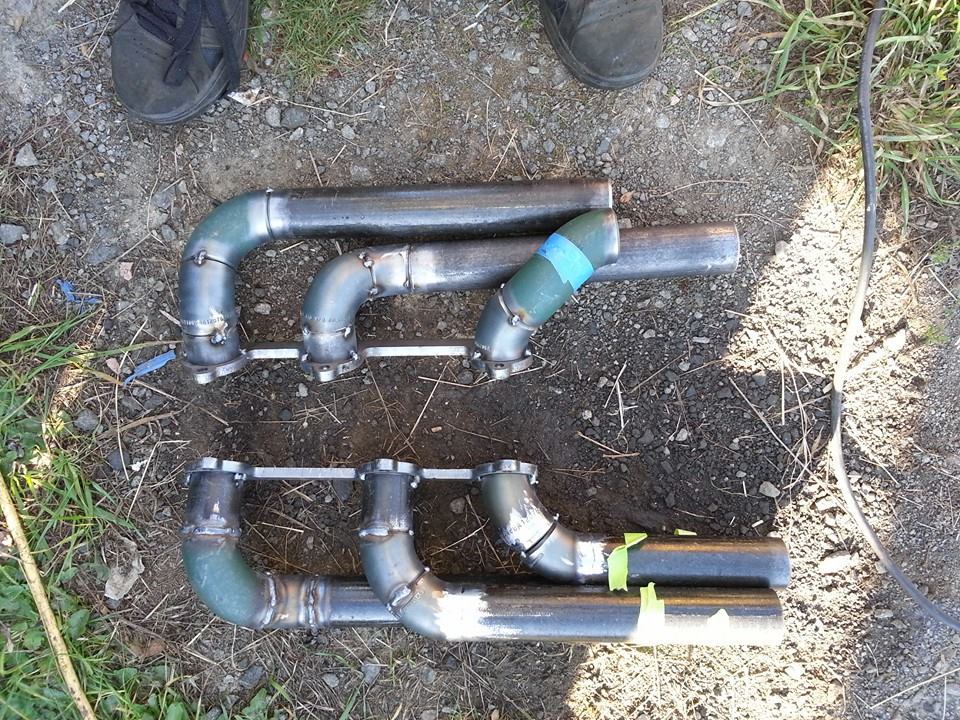

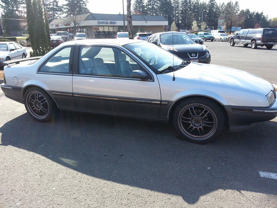

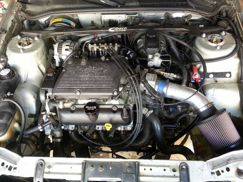

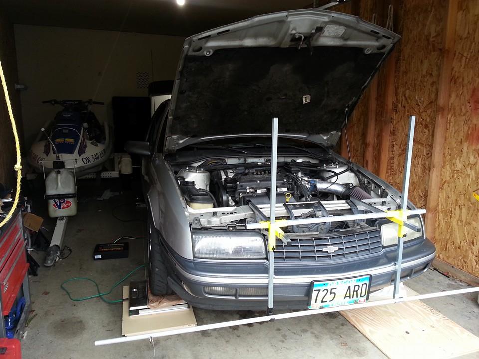

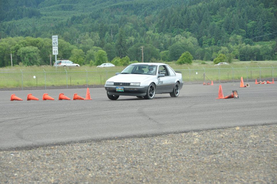

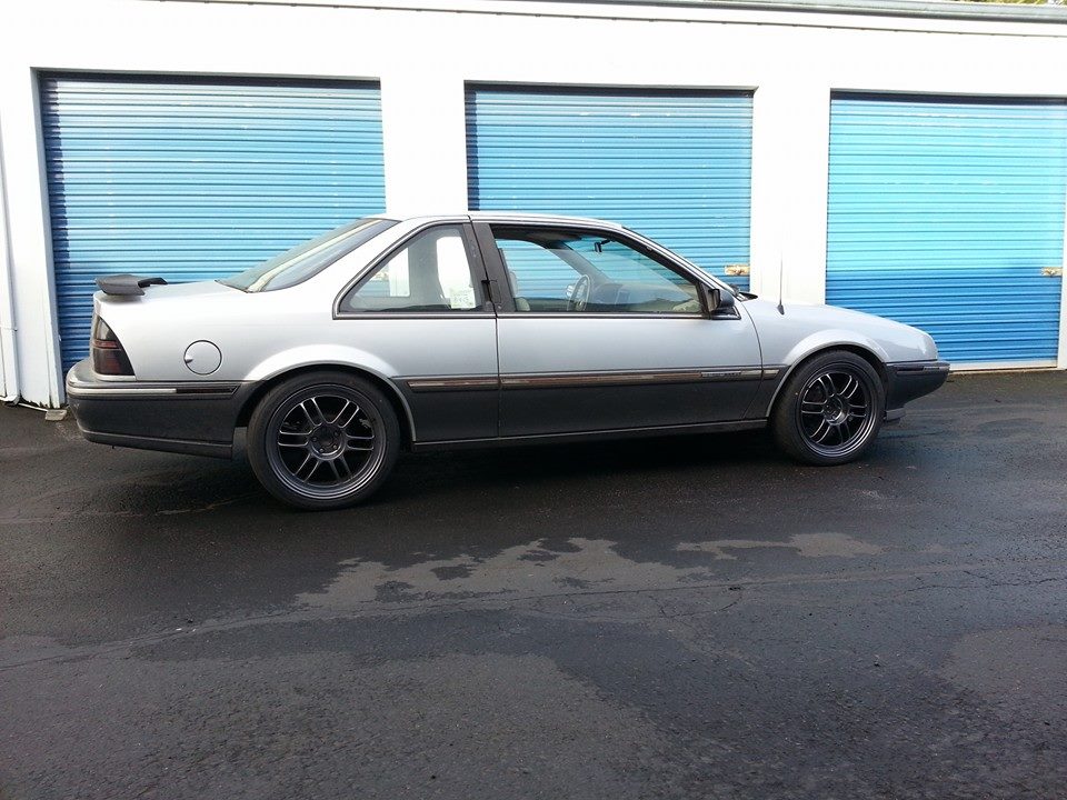

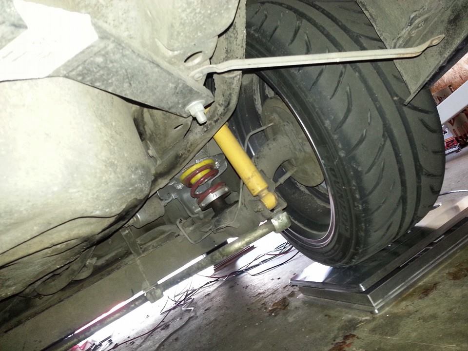

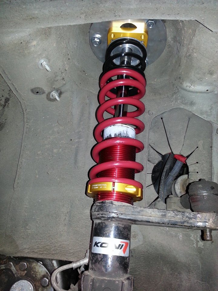

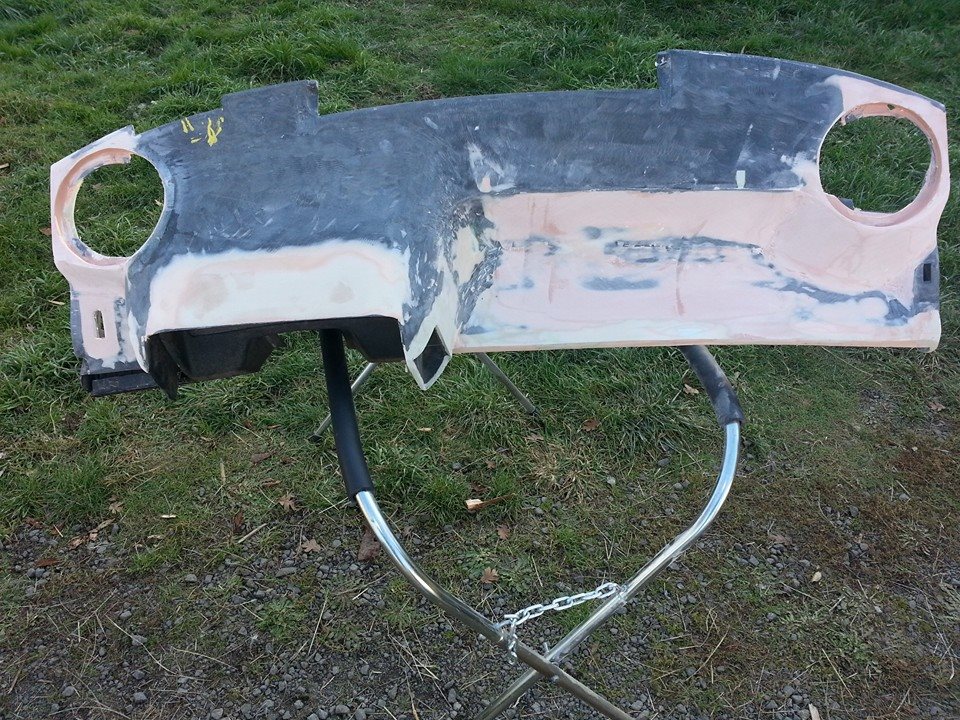

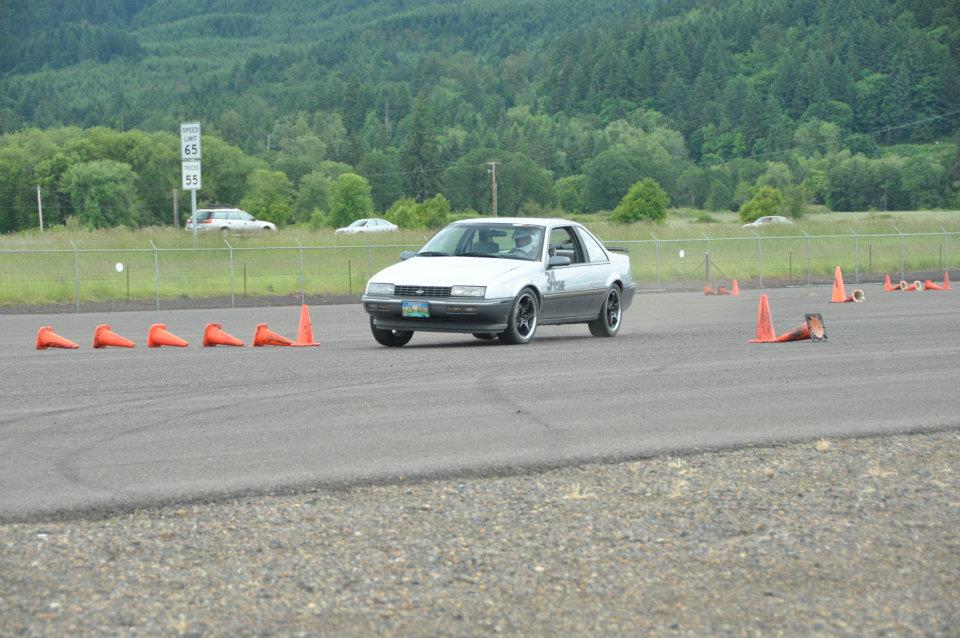

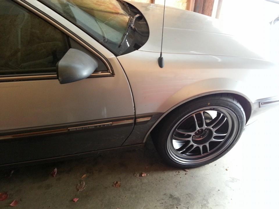

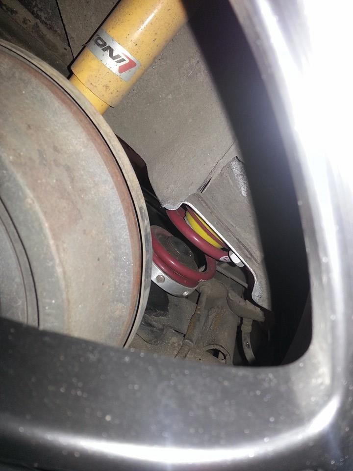

alright this is the last of it im going to post. to answer a few questions.. no the turbo is not on, and it never was. it was the plan but im changing it. the headers were never finished due to that. next engine might get a turbo, not that it will need it. the dash is still in progress and I will finish it along with installing the gauges. coilovers are done, the car turns. 600lbs on all corners (yes I played with spring rates) and NO front swaybar. all the pics of the car racing are with the "drop in" eibachs and koni. I will have pictures soon with the new suspension getting abused. newest pics have gunmetal wheels, those are within the past 2 months

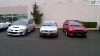

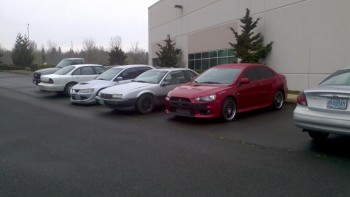

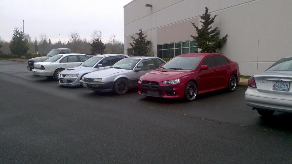

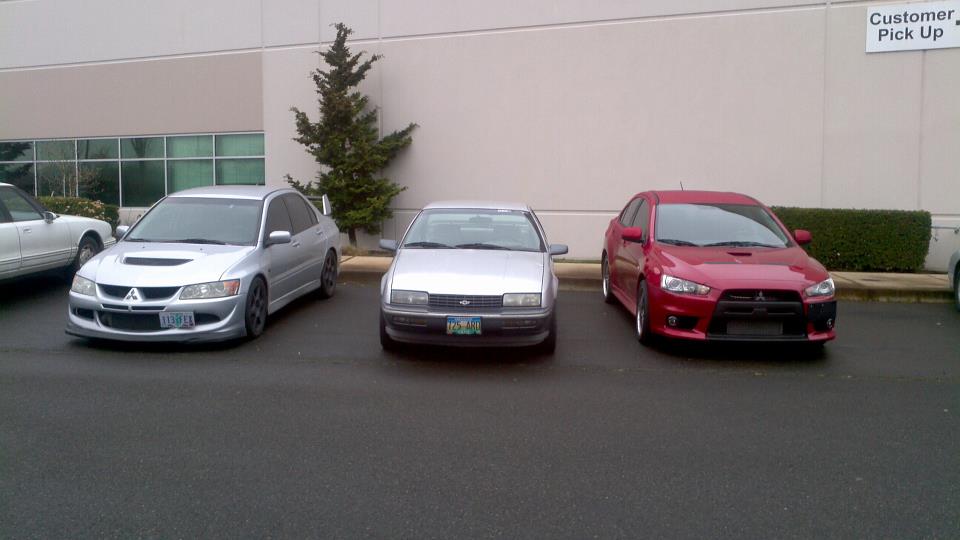

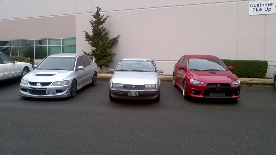

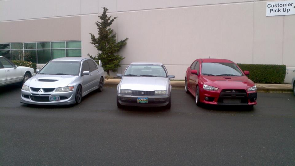

and yes, I keep up with the silver evo (300whp) from a roll.. were are neck and neck. the red evox MR.. beats me in the quarter by .1 or .2

what did you do to your dash?

More info on the shorter rear spring setup you have... and why.
Looks excellent. Very intriguing car for sure!

Looks to me like the shorter rear spring is packaging for the coilovers.
I was going to ask how you like those Speedhut gauges, the GPS specifically, but you haven't installed them yet. I'm putting a set in the Camaro. Any more info on the dash project and how you will finish it?
A lot of quality work there. Killer sleeper except for the new wheels...they kinda give it away. haha

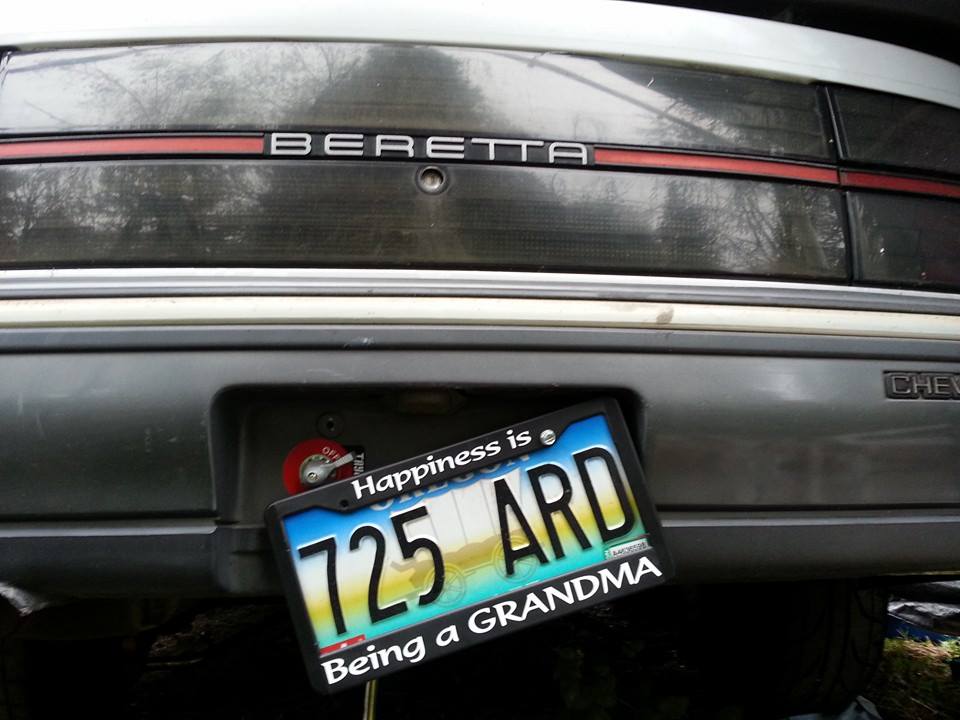

Your license plate frame...
Love it, lol.
