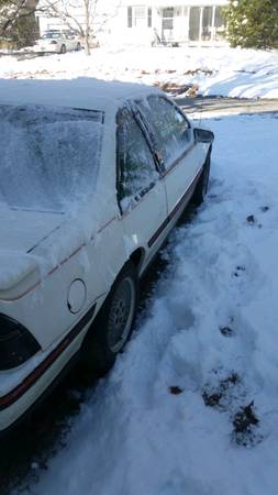

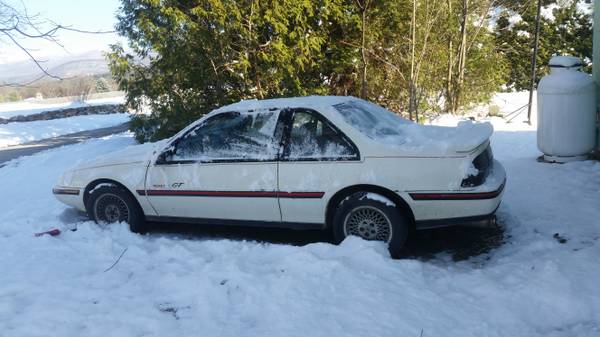

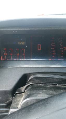

I am considering rescuing a decent looking white Beretta GT (1990, 3 spd auto). I am unsure if the guy will take my trade offer, but if it goes through I am willing to put the work in myself this spring, as I miss having a Beretta and this is a perfect commuter project for me. It has the radical Digi Dash just like my first car (89 GT auto) had. There are some pics below.. ok so now for the general repair question I had for this thread.
How hard is it to do a head gasket job yourself on the 3.1L v6? Are there any tools other than your standard issued ones that would be necessary for this gasket job? Would I have to pull the engine? If so, would it make sense to track down a 5 speed getrag and swap it in? I have many ideas, but they will obviously only come to fruition if I score this deal.
In the meantime I'd just like the gasket questions answered. Thanks!

That is a nice looking GT! I hope you get it.

It is a good job to learn on and build your skills, and also an opportunity to get to know the vehicle better. If you are really a fan of these cars, knowing how to work on them is a really good skill to have. Overall, that car looks pretty good, and if that digi-dash is fully functional, that is a big plus. Curious to know what they are asking for the car though...
