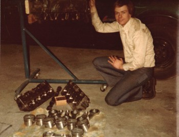

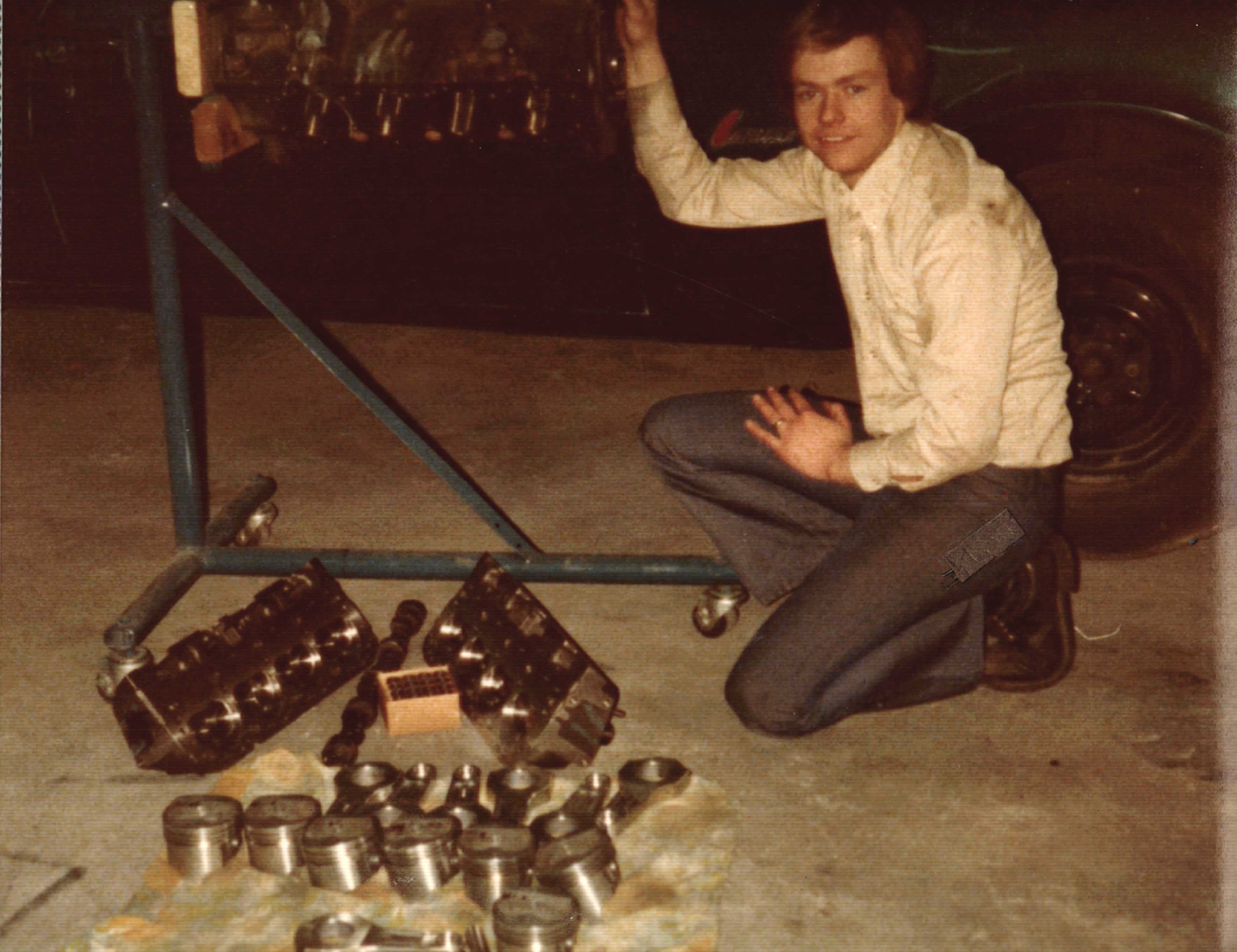

Back before you all were born, I did my build of my SBC. I was a skinny man barely out of my teens.
She had .030 over 12.5 to 1 TRW psitons, BRC aluminum rods, a drop
forged steel crank, 2.02 angle plug heads, solid lifter cam, windage screen
deep sump oil pan, headers, high rise aluminum manifold etc.
She powered my 68 Camaro through a turbo400 and 5:38 gears to a best time
of 11.83 on a full 1/4 mile. I did 183 successful runs but lost interest in drag racing.
She sits on an engine stand and has been sitting for many more years than I care
to think about. I think I may someday, bolt her to a trailer just to hear her run again.

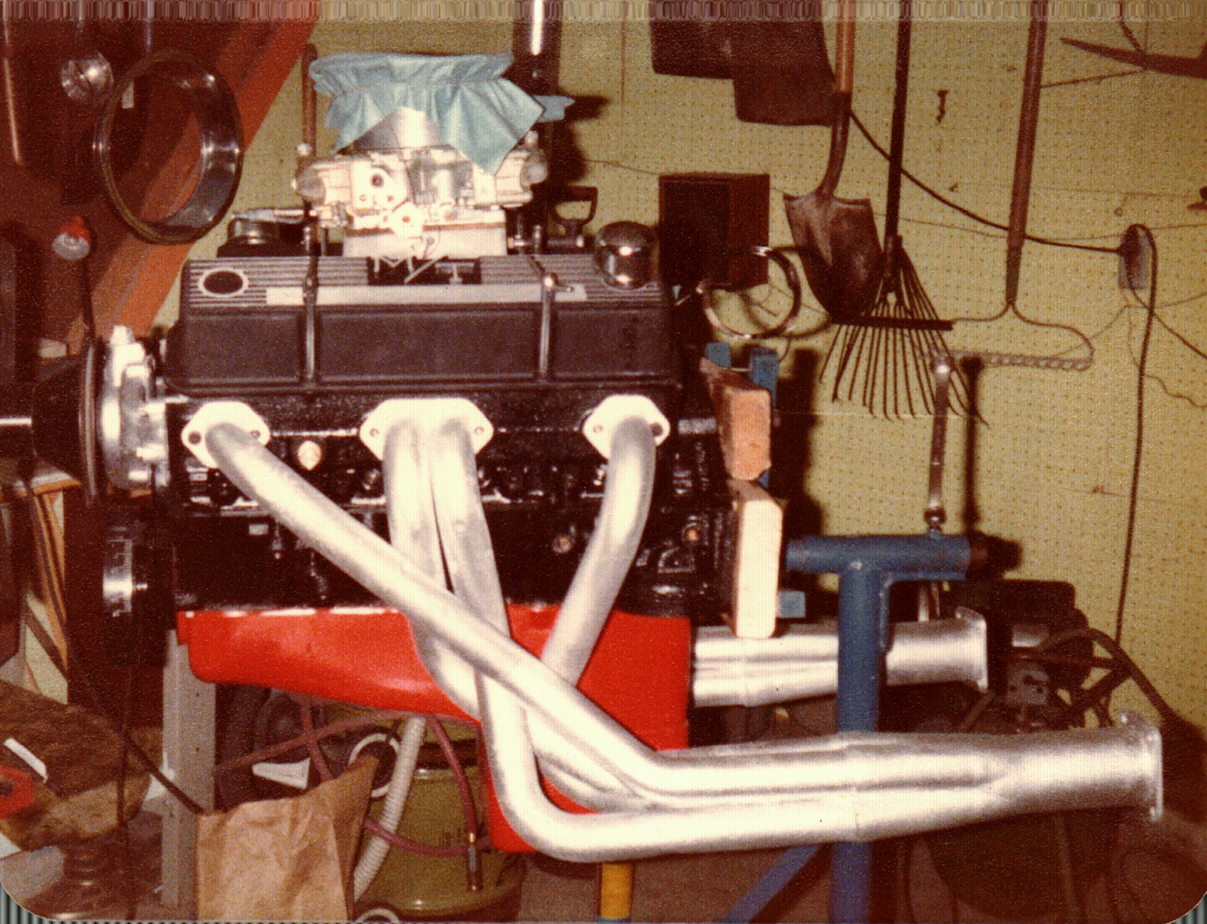

Those are the 292 GM Turbo heads, bought them new in 1976.Money pit Beretta wrote:What heads are those?
I didn't do anything to the ports. I just had bigger spring pockets,
Teflon valve seals and a competition valve job done on them.
This build was in late 1970s, so close to forty years and 50 pounds ago.
Looking at the posts from BerettaZ28, Mr Pink and Camaro paint job after ten years,
just to name a few, takes my memory back to my build.
You guys are doing it so much better today.
It's amazing and you can document and post pics for all to follow.
I just had the old Kodak 110 camera and then I had to take the film in to develop.
So I only have a few old photos of back then.
There is an abundance of information at your finger tips on the internet too.
I bought and read "How to Hotrod your small block Chevy", Bill Jenkins and
"The Chevrolet Racing engine". I asked a lot of questions at the speed shop.
I still have those old grease stained books, just in case, haha.

I'll have to ask my friend, but I'm almost sure he had the same heads(just 20 years later). They were damn nice and his were exhaust ported(that was the only change). Pulled hard even past 7k with a duel pattern cam and a bone stock short block(TRW rebuild kit).

I shifted at around 7200k rpm and by the time the trans shifted it would hit 7600K rpm.Money pit Beretta wrote:I'll have to ask my friend, but I'm almost sure he had the same heads(just 20 years later). They were damn nice and his were exhaust ported(that was the only change). Pulled hard even past 7k with a duel pattern cam and a bone stock short block(TRW rebuild kit).
So yes these heads were good for high rpms.
