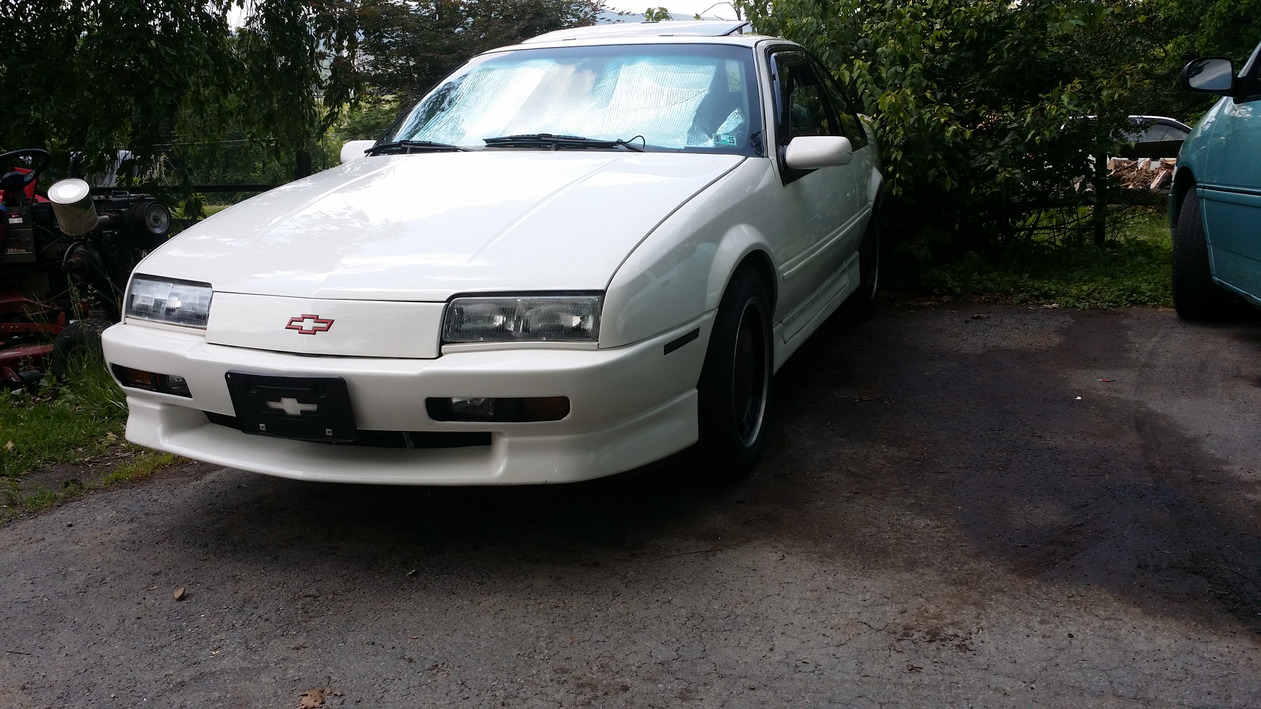

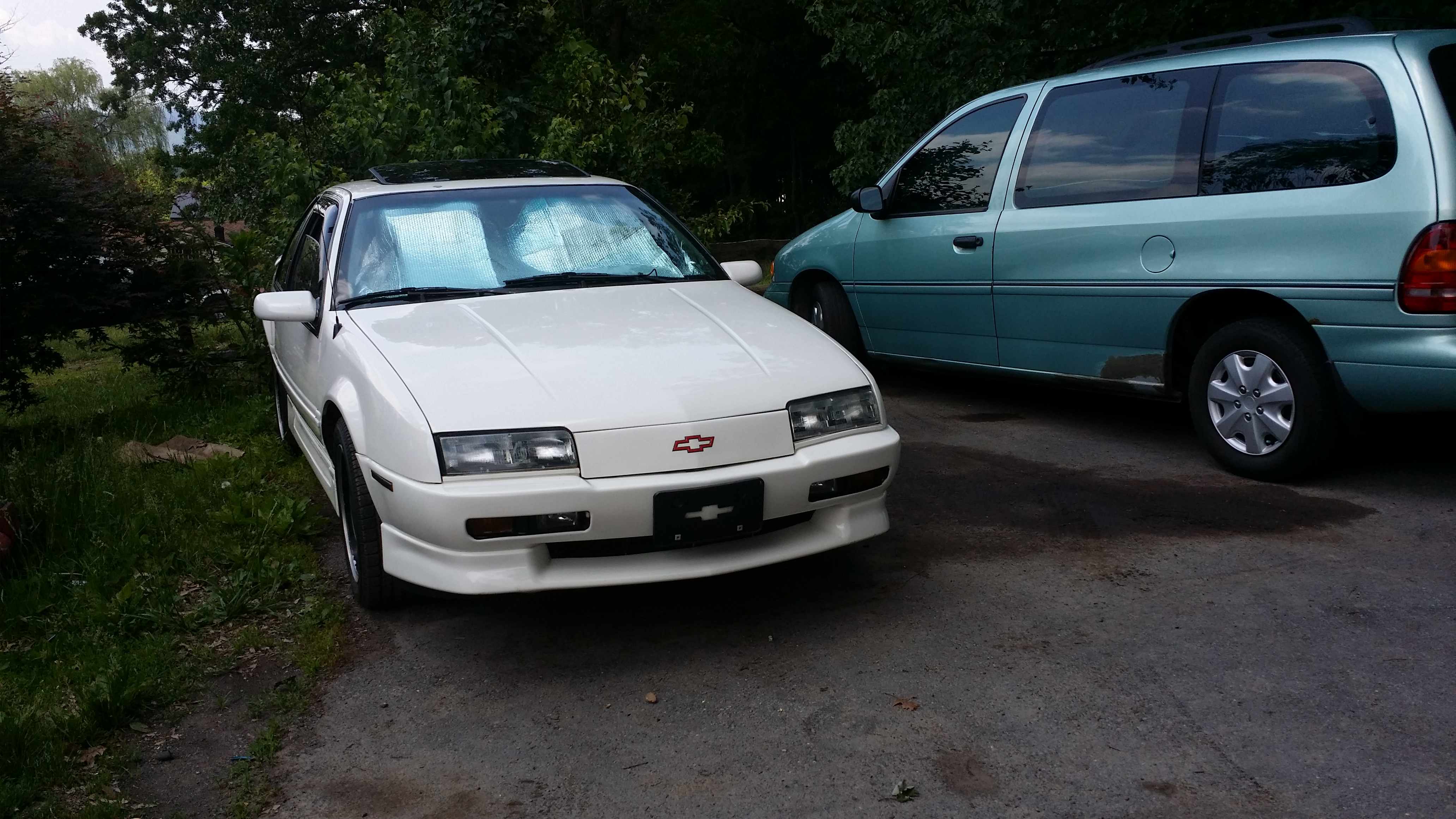

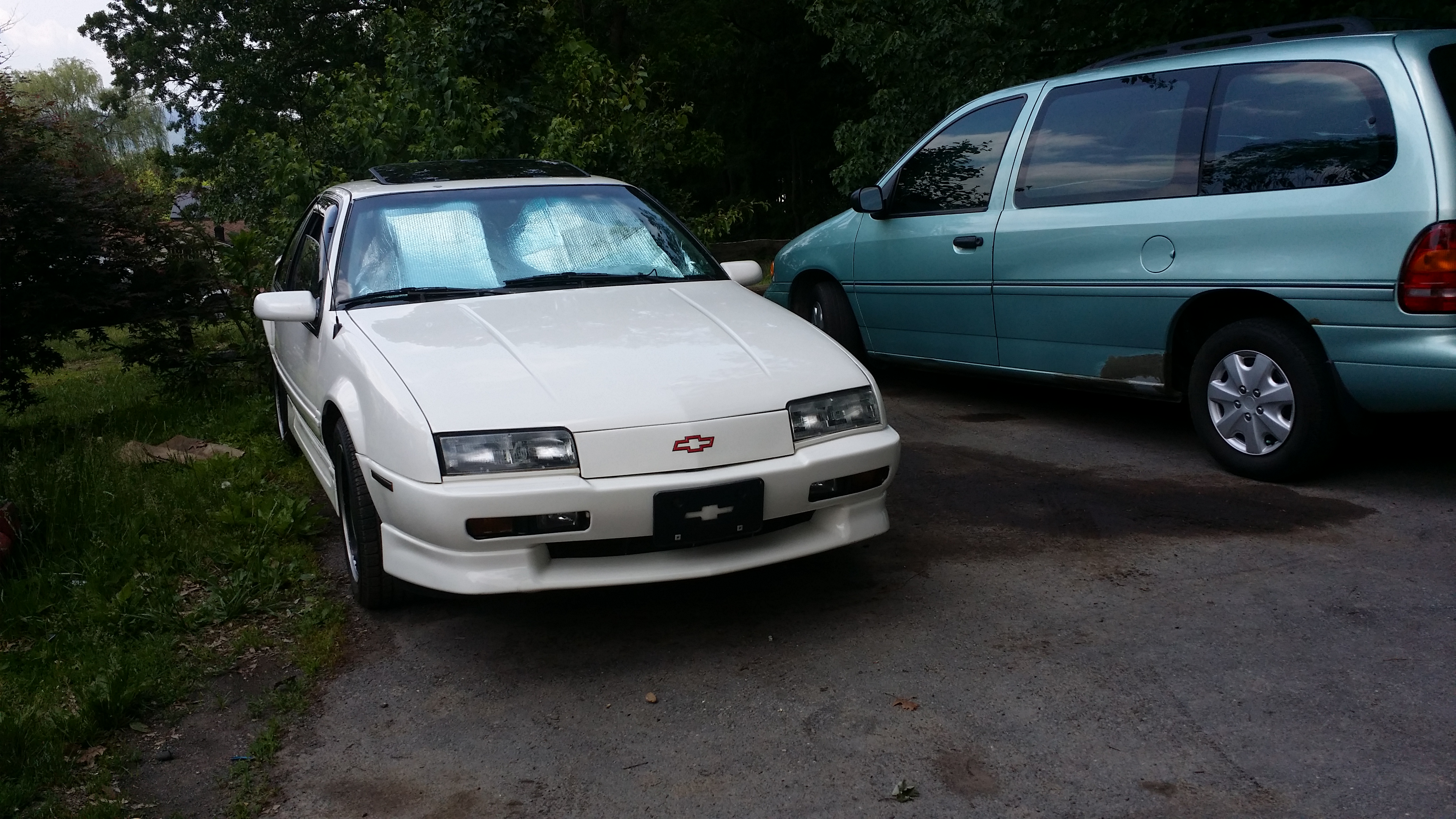

Ok, i was gonna sell the GTZ a while back but I ended up backing out due to coolant starting to appear in oil. Runs as good as ever (I do not run it more than a few seconds, a minute tops to move it)
Do I seem right in assuming headgasket? It is to my understanding that the water pump can mimick these symptoms when it fails since it can dump into the oil since it is driven off the timing chain, is that right that it can dump into timing housing or was the person who told me this wrong? is the weep hole external?, I already bought a entire engine master gasket set and head bolts so it will be redone (cylinder head has almost no miles on it) my question is:
Am I being a fool going with head bolts versus studs?
This is all assuming the head is OK and not warped which I do believe it is but I will see for sure then, I will be doing the water pump too.
I may just replace the new timing set for insurance if budget allows since it is making noise again, should the cam towers/housing be replaced since from what I know they act as cam bearings?
Anything else that should be done while it is under the knife? I do believe I will just keep it since I have a good bit of money invested and it is a impressive ass car. If I can locate some I would love to do W41 cams and prom while it is ripped apart as well.

Also on the older Quads like yours, a failed water pump will NOT generally dump into the timing case (external weep-hole). The newer Twin Cam engines do not have the intermediate bearing between pump and chain because GM wanted to save .43 cents and screw the engine's design up, making a WP job ten times more difficult. But yours is good, and you would have to have multiple seal failures to get coolant into the engine that way. Blown head gasket or warped/cracked head, most likely (common issue with Quads). As stated above, perform a block test (consider changing the oil first if highly contaminated just to save the bearings), especially if you can get it up to operating temp for the test. Good luck, nice looking car.
