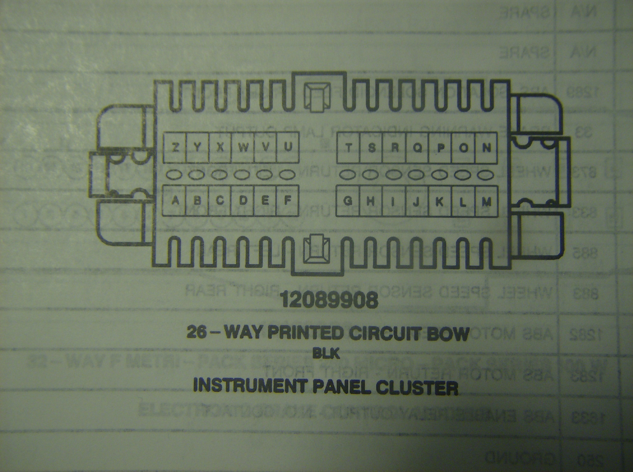

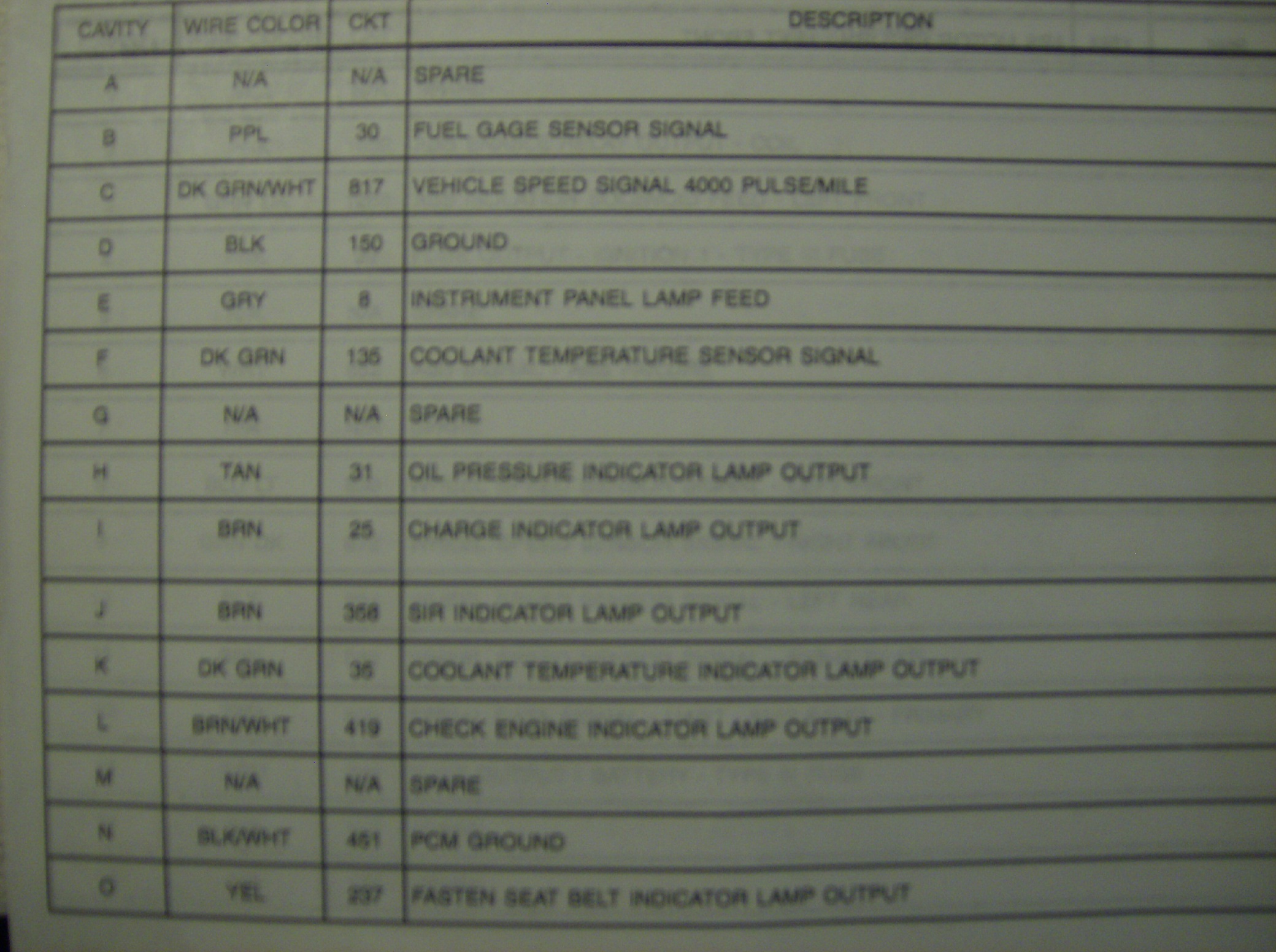

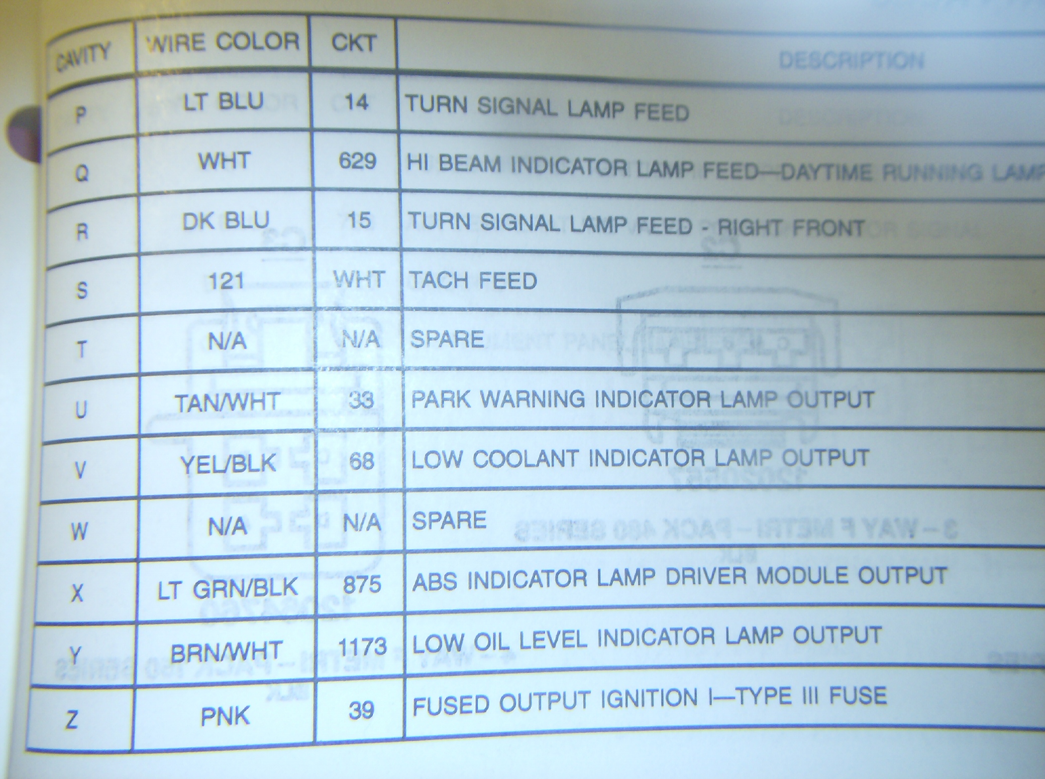

How can I tell what pins on the cluster control what functions. ...?????...
Posts: 668
Re: 1995 Beretta z26 or base wire diagram for gauge cluster
Post by ifixalot »
this is from a 1996 service manual, I hope it helps.
You need a 95... They may actually be the same, I forgot that a 96 the main change was the way the Tach signal was fed... 94-95 was from the ICM, 96 was an ECU output so the clusters are different. Not sure if the pin designation changed though.
