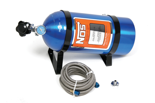

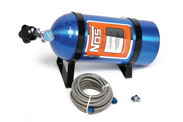

Nitrous Oxide?
Seriously considering of running a 50 shot of NOS. Anyone have experience with a system of this method on a Beretta?
