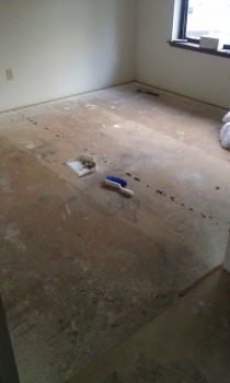

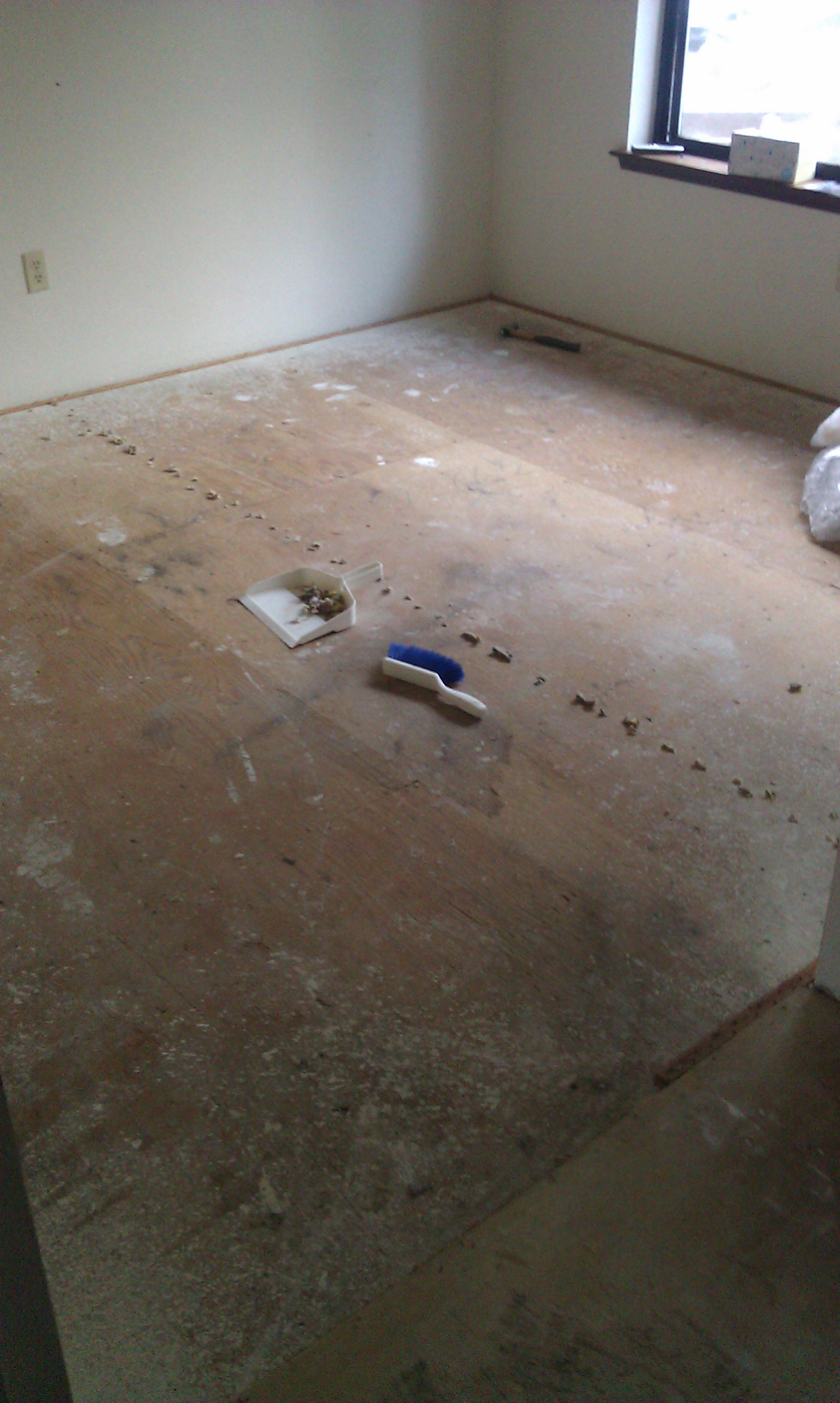

Nasty old carpet out -who puts carpet in a dining room anyway?

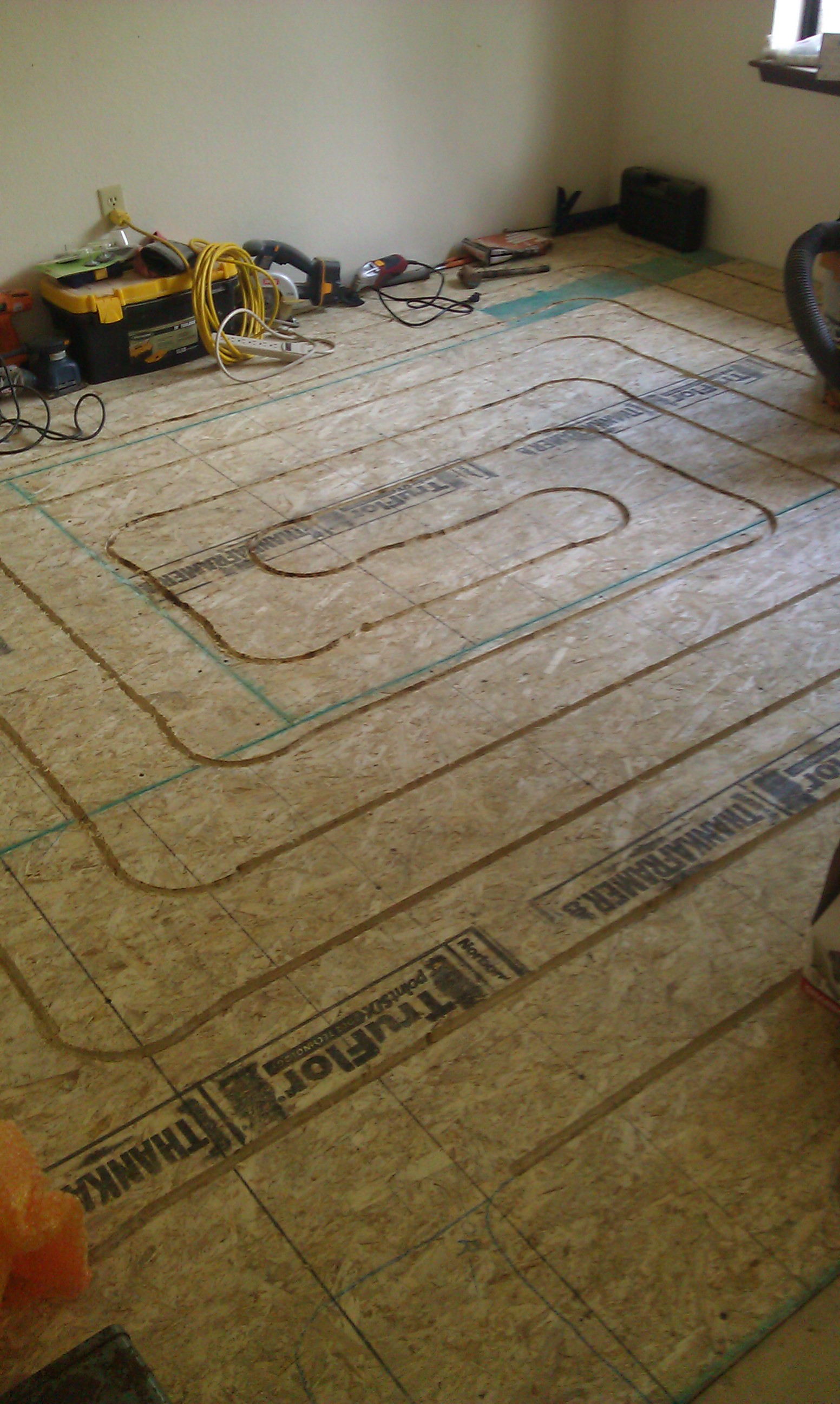

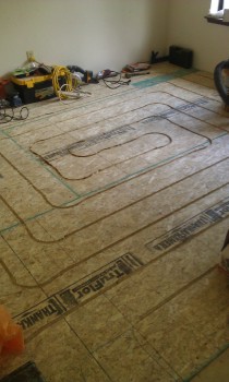

Second layer of 3/4 subfloor paneling -adds strength, rigidity, and a place for a 5/8-inch deep channel...

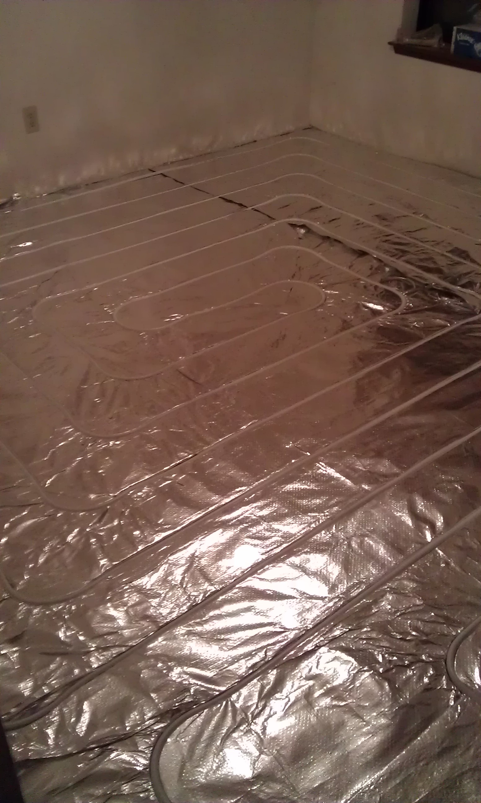

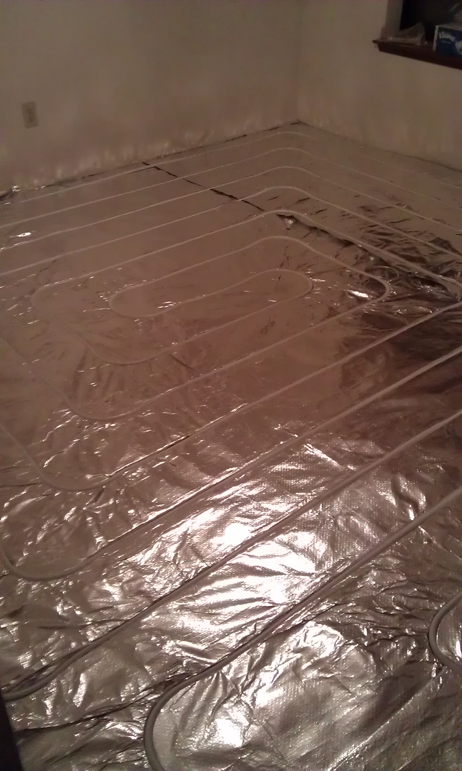

Ready for beam-up!  It looks like a space-ship in here... Or the insides of a giant refrigerator, but either way...

This was the first room I did, I'm just going room-to-room redoing as I go. The living-room has three separate loops (pretty big room, but I could have gotten away with just two) and is 2/3 done now with the sub-surface stuff. It is taking a lot longer than I had hoped, but it will all be worth it in the end, I think. I've been learning the fine art of making more spare time in the day, so I could use it on this. So far, I am up to about 25.7 hours in each day, :crazy: but I've got to get better at it so I can get this thing done.

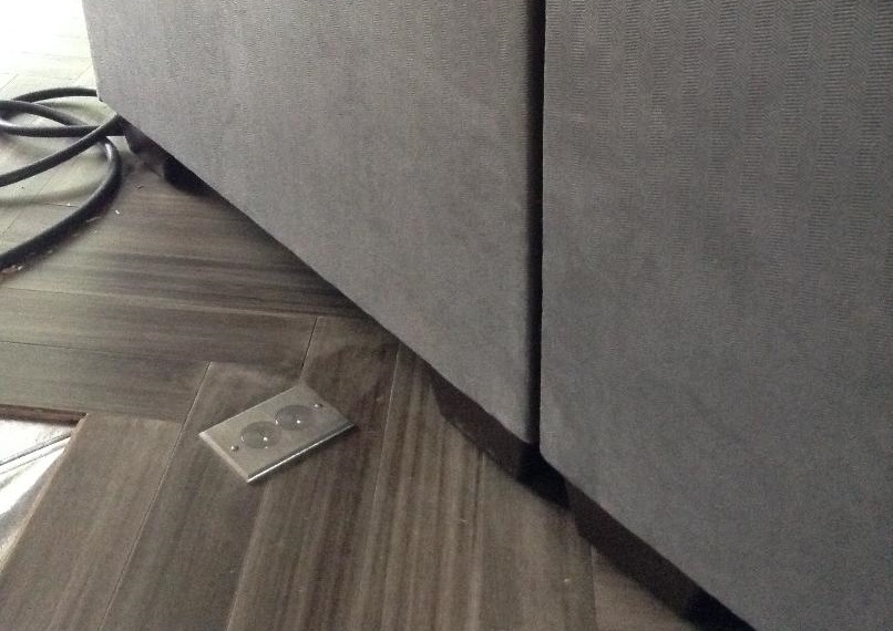

Well, most of this project is done -I had to step away from it here and there as life continued outside of my project. I am currently operating five of the seven available loops (I haven't done either bathroom yet -I am not trying for complete remodel there, but each one does need to be stripped-down, any water-damaged subfloor replaced, then everything built back up, Hardibacker panels installed over the routed second sub-floor layer and our chosen porcelain large-format tiles installed. I am taking a complete break from it for a week or two while I catch up on other things. The short-plank solid bamboo we chose for the living-room fought like hell going in -would have been fine as a glue-down, but nailing was tough because the planks are relatively thin for a solid construction and the bamboo material is so incredibly hard and unyielding -the tongue-part would get swelled-out by the force of the nail driven through, and would bottom-out in the groove part before the edge-gap was properly seated. Not every time, but frequently enough to cause serious delays -I recut CASES of the stuff on my table-saw to deepen the groove and even knock a little off the bottom edge for the planks that also swelled-out UNDER the tongue. I had a lot of hand-nailing along the edges too where the pneumatic nailer couldn't reach, and every last one of those had to be pre-drilled -quality bamboo flooring is too hard and the nail will literally bend 95% of the time rather than go through. PITA, I wish I had just used the same stuff as the dining room, but it is basically done now, except for the back hallway.

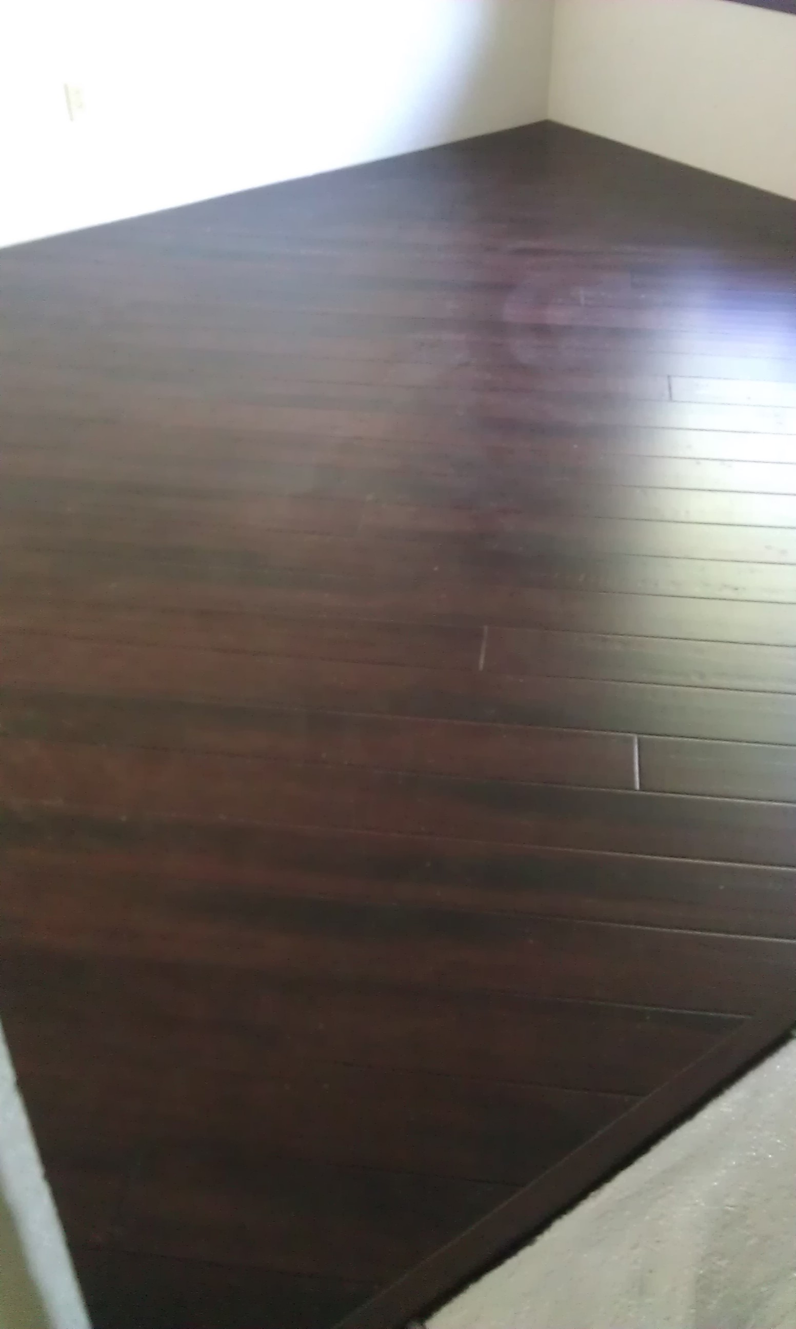

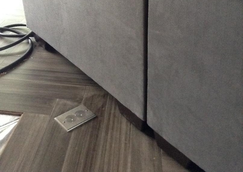

Living-Room flooring, zig-zag pattern, looks good and even matches the fabric of the couch, but hard to work with and didn't come out as good as I had hoped.

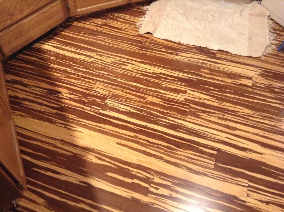

Eventually, I will come back around to our pantry floors too (we have two of them), but as they weren't getting any heating loops, they are able to wait and should be separate sections anyway, and they are getting the same flooring as the kitchen, which was much easier to work with.
Beautiful material -easy to work with too, great for where we put it but would have been a bit much if we used it throughout the whole house IMO.
As for the heating, I've actually had to turn everything down a couple of times, it was getting too warm in the house. I bought a high-efficiency three-speed circulation pump, and everything is being regulated mechanically at the manifold valves -no electronics needed. It hasn't gotten really cold here yet, but we still have our fireplace if we need to boost it up a little, and I've got safely at least 20% higher supply temp I can go on the heater, and watching the cycling, the heater isn't being stressed at all. So far we haven't wanted to go even near the fireplace after turning the floor on. I got a great deal on a Watts accumulator, and found a good company that sells brass plumbing fittings for a good price, so virtually the whole system is made of aluminum-layered PEX tubing and brass fittings, no actual 'pipes' anywhere in the system, and as few fittings and joints as I could manage to minimize leak potentials.

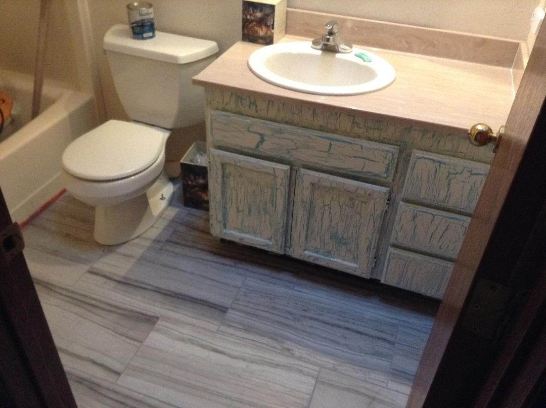

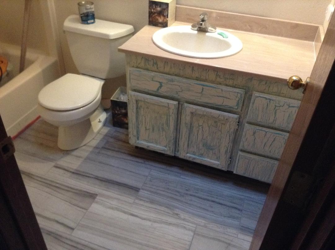

Here are a few shots from when I did the first bathroom floor back in November...

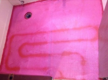

I used Red Gard -this is a water PROOF membrane.  100% protection  from water damage, and fantastic adhesion for thinset mortar.  You can see where the heating pipes are, helping to dry the Red Gard.
We decided to have some fun with the vanity, and did a crackle-finish on it.  We will be doing a conventional two-tone stain in the other bathroom.  We also intend on epoxy-coating the counter-tops to change the coloration and freshen them up.  SOMWHERE I have a few slabs of green marble and blue granite that might work well here, but I think the epoxy color-coating will be better.  I still have to trim-in the baseboard tiles here.
I can't say I am crazy about the operational cost, but the effect is worth it.
