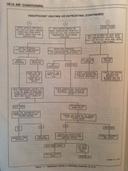

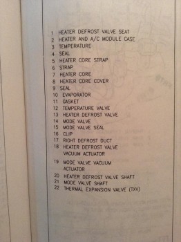

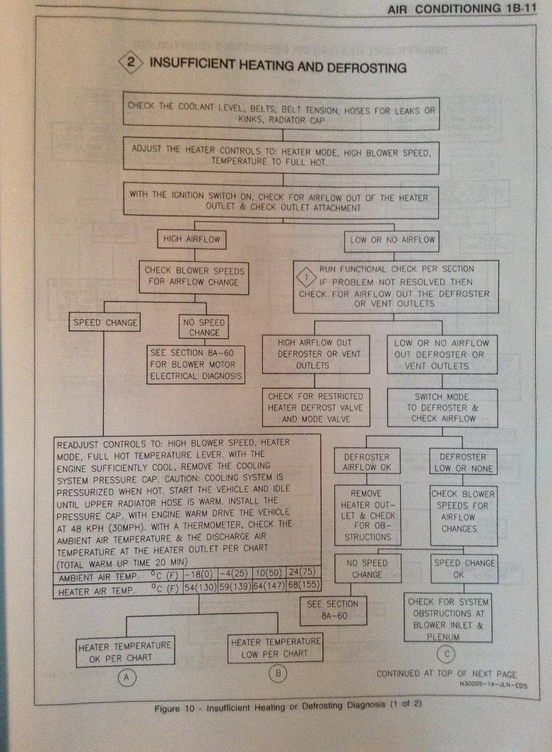

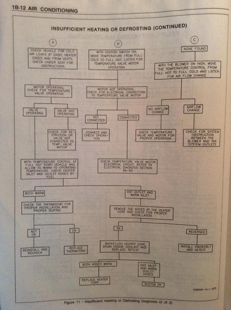

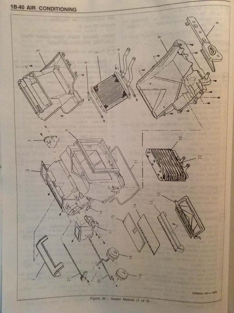

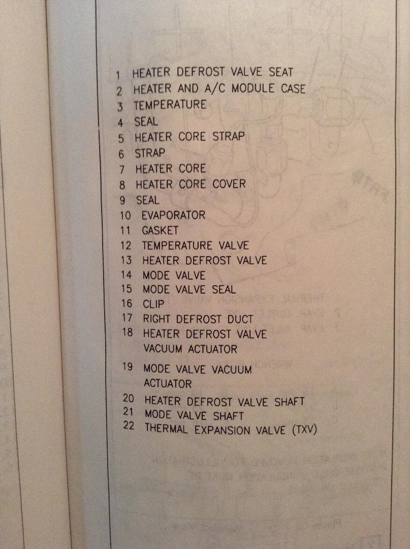

Posts: 1851
Re: Replaced heater core, now no heat
Here is GM's diagnostic tree -this is from the '95 L-Body service manual, but should apply to your '96 for this system. I'm also posting the assembly schematic and parts identifying list. Note the 'Temperature Motor' is known as a 'Blend Door Actuator' in most of the industry in case you need to look for a replacement, but I am suspecting that something is binding or loose on your blend door causing it to fail. Of course, it is controlled by the temp knob, so a problem in the control panel could cause a failure to operate too.

Rettax3 wrote:Here is GM's diagnostic tree -this is from the '95 L-Body service manual, but should apply to your '96 for this system. I'm also posting the assembly schematic and parts identifying list. Note the 'Temperature Motor' is known as a 'Blend Door Actuator' in most of the industry in case you need to look for a replacement, but I am suspecting that something is binding or loose on your blend door causing it to fail. Of course, it is controlled by the temp knob, so a problem in the control panel could cause a failure to operate too.
Ok thanks. I tried to find the troubleshooting steps in my book, but honestly didnt even try that hard haha. Thanks for them though! I will look try and diagnose later. And thanks for clarifying the temp motor thing. I was very confused about what that was and where it was, but now it's more clear
