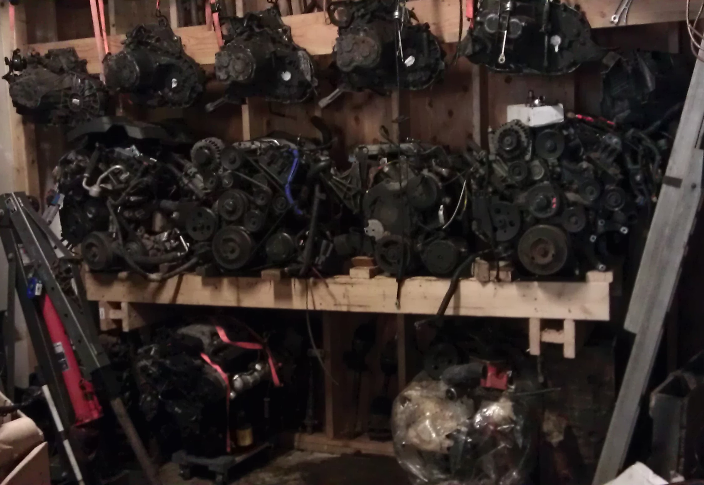

I needed more storage space for some of the larger spare parts, i.e. engines and transmissions/transaxles. I had a pair of old Chevy straight-six engines sitting around and rotting (not worth rebuilding to me, both came with the house when I bought it), so I stripped them down to the blocks, and they became the base for my new engine-rack. Initially, I had intended to make a vertical 'tree' for the transaxles, but I like this 'beam' much better -no additional floor-space used! The beam is solid, supported on each end all the way down to the floor and boxed-in to keep it from trying to twist forward, but since the weight is all overhead, I wanted to add straps up to the rafters just as a backup precaution. You can't really see them in this picture because my 'little' hoist is in the way, but there are a pair of RWD five-speed transmissions stored on the far side of the engine rack, and I pushed the 5.7 TPI L98 from my GTA Trans Am in the empty slot under the rack right after taking the picture, so... Five transaxles on a beam, over four engines on a rack, with three engines underneath, and two transmissions to the side, and a partridge in a pear tree! I still need to do something with the engines sitting in the next bay too...

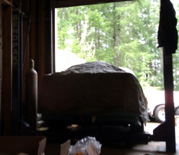

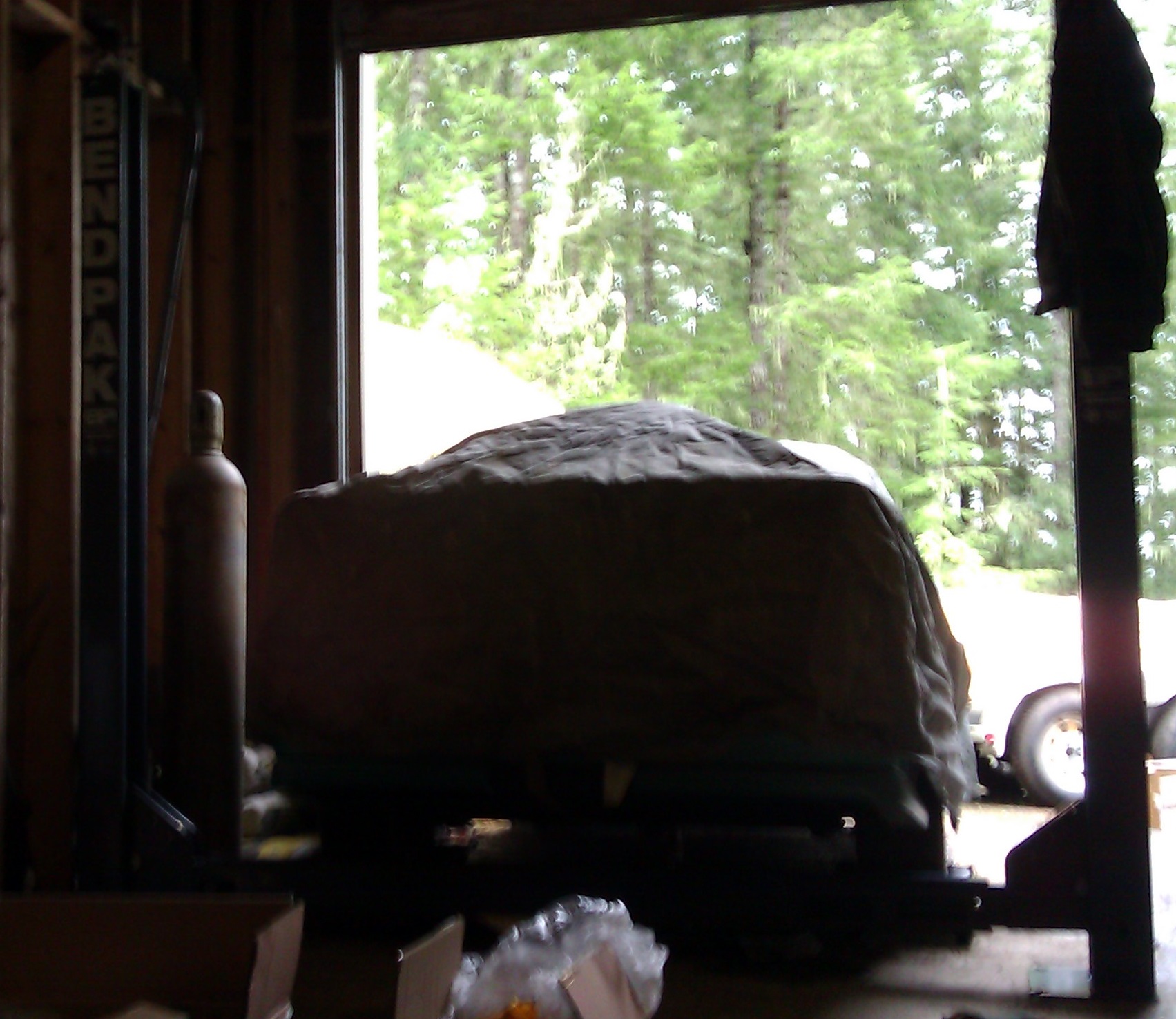

Turning the other direction, the big upgrade can be seen, somewhat hiding in plain sight. No, I don't mean the V-8 Indy project... If you know the name though, you will recognize what is going into the bay. More later, once assembly is complete.

Man, that looks like it was a lot of work but worth it.
How big is your shop? How did you get those trans-axles up there?

I actually really enjoy engineering things like this, then making them into reality, so it was fun. The shop isn't real huge, a couple of bays and a workshop. It will be nice when the next 'upgrade' is finished, and I'll have an extra spot in there
. The transaxles weren't too hard -I have a couple of engine-hoists, and I made an extension arm for the small one -only safe to use at max reach with lighter loads and I also have to calculate the extra force on the hydraulic ram, but those trannys only weigh about 80 pounds +/- (the 284 is closer to 95, I think). The little hoist actually reaches that far normally, but the legs are a bit long and start interfering with the back wall once the arm is cranked up so high, as it is also pivoting backwards at that point. The extension just makes life easier. "One of these days" I will make it a 'live-load' adjustable arm, with thrust-bearings and a crank handle, that has been on my drawing-board for a couple of decades...

Bend Pak is NOT the cheapest lift around for sure, but ever lift in the shop I used to work at was a Bend Pak, and those things were work-horses. Aside from their new 'made in China' Grand Prix series, their lifts are all commercial-grade units, so far as I can tell. Even comparing next to Rotary, Bend Pak lifts are heavier-duty or comparable for virtually every component across the board. Safety, longevity, and reliability over-rode my typical search for 'better value' in this case. But, I got a year-end sale on my lift, which helped a bit, and the salesman screwed up a few things, the shipping company screwed up, and my lift ended up sitting in some warehouse for a couple of weeks and was never going to come to me, so they are supposed to send some cool extras out to me to try and make up for the inconvenience... Freight was also free as they refunded the fork-lift/flat-bed fee to me, and I only needed to drive down to the shipping hub about an hour away to pick it up, so overall I feel like I got a decent deal on it. They also threw in a couple of free drip-plates (I feel it should come with them anyway) because they showed a 'refurbished' accessory I wanted in stock, and they only had it in factory-fresh for twice the price. The customer service could have been better, I actually had to write a nasty-gram to them to get someone to pay attention to the fact that my lift was weeks overdue and the salesman couldn't figure out how to dial my number back to address the problem, but it has worked out okay to this point. It was a PITA to move all the parts in by myself, especially the ~600-pound-each ramps, and setting it up isn't an overnight project either, but I don't even have everything set up yet for the power supply, so that is okay. By the time I am done, I will know every nut and bolt on this thing, and I will know it is all put together right, too.

Yeah, I bought the 'caster kit' for mine too -my shop bay is too small to get a whole lot of use out of the option, but you just never know what you might need to do around the shop, and having it mobile might just be 'priceless'. My garage door is just wide enough for it to roll through, and we have an eight-foot deep pad in front. My loving Better Half suggested that we should consider eventually extending the pad to provide enough room to roll the lift completely outside if desired -um, sure! Twist my arm...woody90gtz wrote:He's looking at 4-posters. The place he's pretty much decided on is in NH I think. I forget the name. Saves shipping and sales tax if we pick it up there. And it's got a feature where you can move it around on the floor when you need to.

Finished running the lift cables, air lines (safeties are released by air-pressure), and hydraulic lines yesterday. I guess I will end up waiting on the electrical after all.
