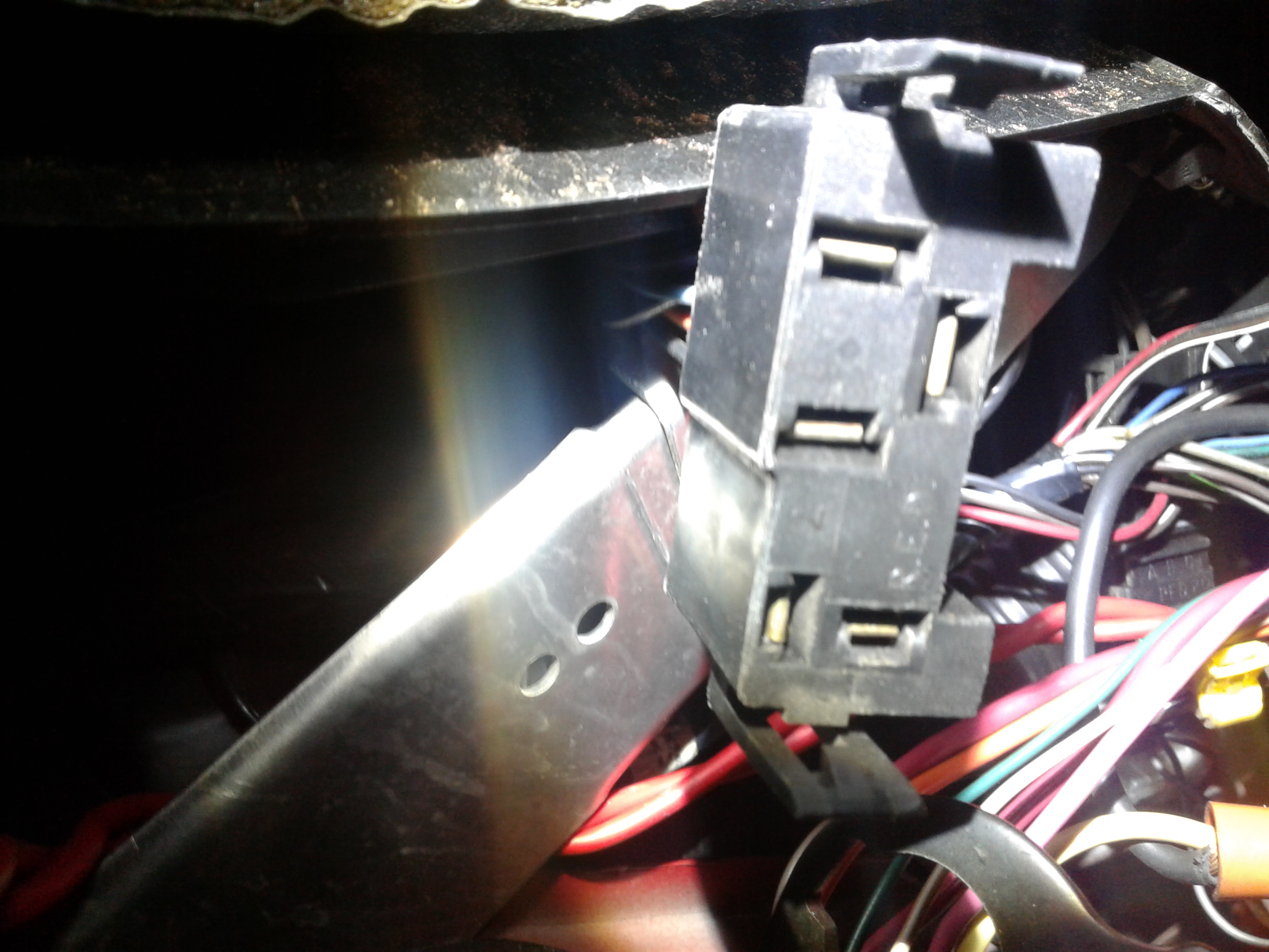

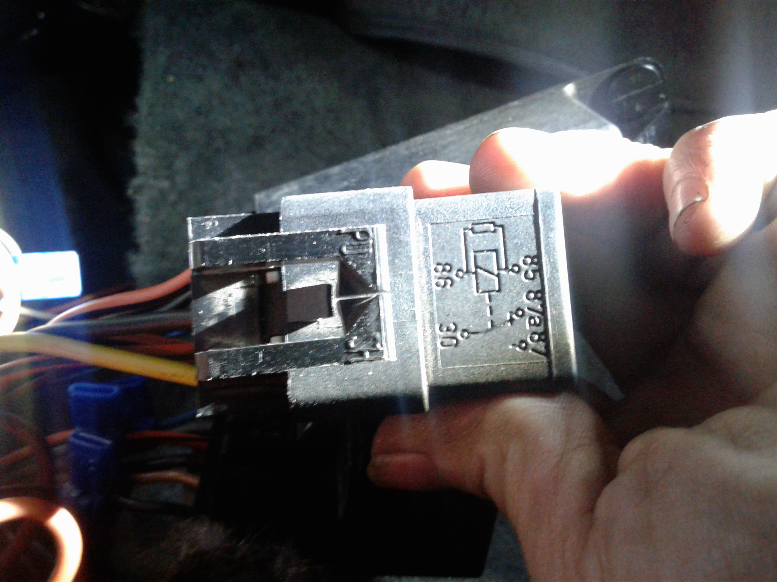

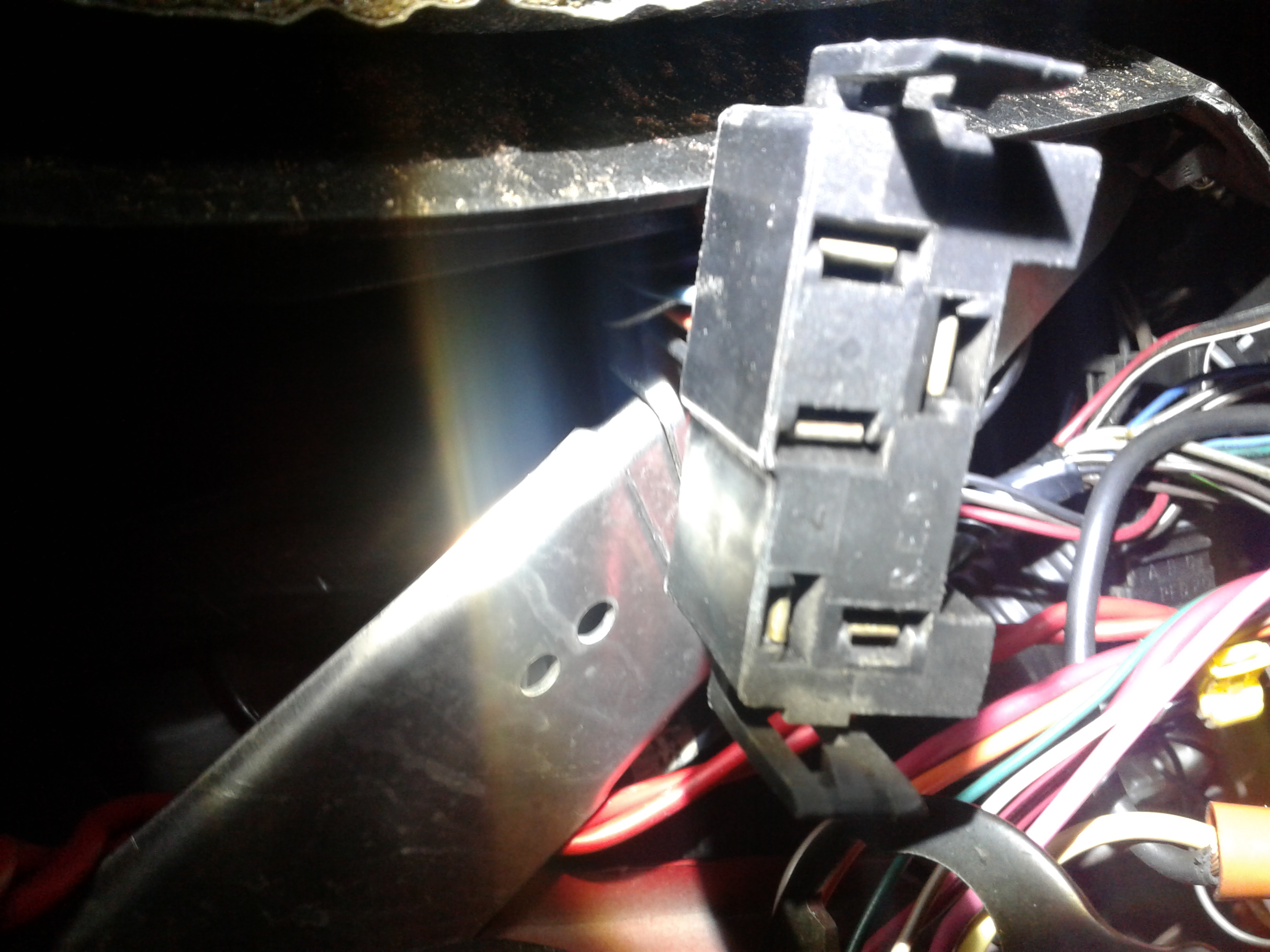

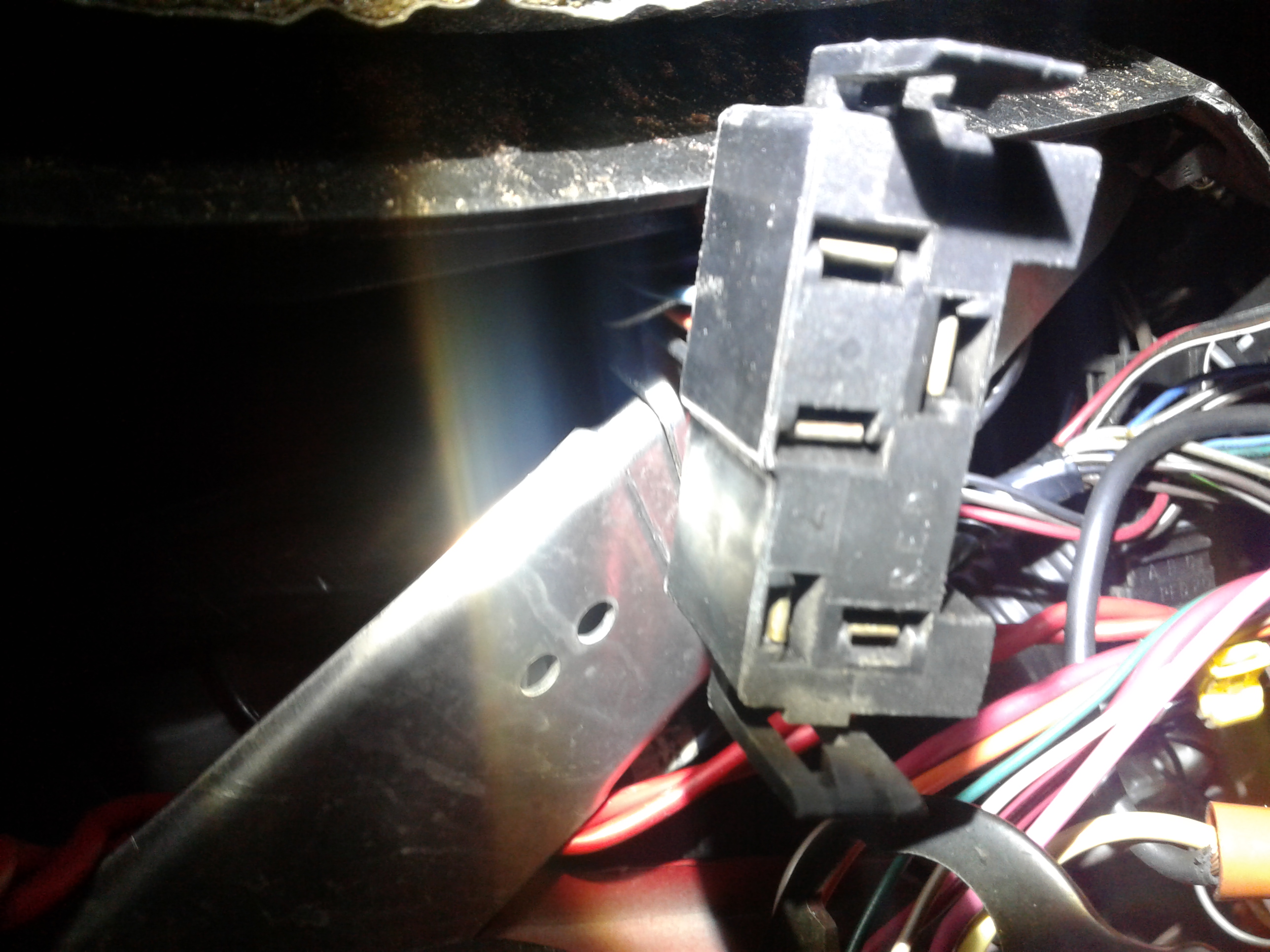

Your fuel pump is energized by either the Normally Open side of the fuel pump relay that I mentioned (orange wire, this gets power from the fuel pump fuse) or the Normally Closed side of the relay (red wire, this gets power from the computer for a few seconds during 'prime' mode, or from the test-lead near the fire-wall if you hook power into it). This power goes out from the relay (grey wire, some cars used tan instead) to the pump and powers it. Also supplying power to the pump on that grey (or tan) wire is the oil-pressure sensor on the front of the engine -basically if there is enough oil pressure, it will activate the pump that way.
If you run a power wire to the red test-lead connector, the pump will run continuously, whether the engine is running or not (not a good idea, old or cheap injectors can leak a little, and you could end up hydraulic-locking the engine or even starting an engine-fire) and if the power isn't shut off or disconnected, it could run until the new pump is fried or your battery is dead. Check the fuse and the relay, that is probably where your problem is, and if it was the fuse, make sure you find out what blew it -probably the old pump, but maybe not.
If you are looking at the other side of the fuel system, the injectors, they are powered through their fuse as soon as the key is turned on. This fuse is inside the box in the dash, you have to open the driver-side door to get to it. The computer grounds the injectors out in micro-second pulses. Running a fuel injector continuously for even a second or two risks overheating its' coil and burning it out. You have three fuel injectors on each circuit, and two circuits (pink and pink/black wires carry power from the fuse box, blue and green wires go to the computer under the passenger-side dashboard where they can be grounded inside the computer). The computer controls the pulses' frequency, based on RPM from the ignition Control Module and Crankshaft Position Sensor (make sure the yellow and purple twisted wire from that sensor is in good shape or the engine will not run). It runs the pulses longer or shorter times (still fraction of a second) based on engine load, as it calculates throttle position sensor, RPM, and intake air pressure (vacuum, read by the MAP or Manifold Absolute Pressure Sensor) and also very importantly engine coolant temperature*. The oxygen sensor helps the computer adjust and fine-tune the fuel pulses once it gets hot enough to work.
*As a note for you, if this coolant temperature sensor (two wires, one is black and one is yellow -unless you have the digital dash gauges, you also have a one-wire (green) sensor that controls the temperature gauge in the car, so even if that reads right it doesn't mean your computer is getting the right temperature reading) goes bad or gets disconnected, the computer can get so confused that the engine will get too little or too much fuel, and likely won't run, or almost certainly won't run well enough to drive. If you know you are getting fuel pressure, noid-lights confirm you are getting pulses to the injectors, and an inline spark-tester proves you have spark but the engine still won't run, the coolant temperature sensor would be the next place to look. Good luck.
