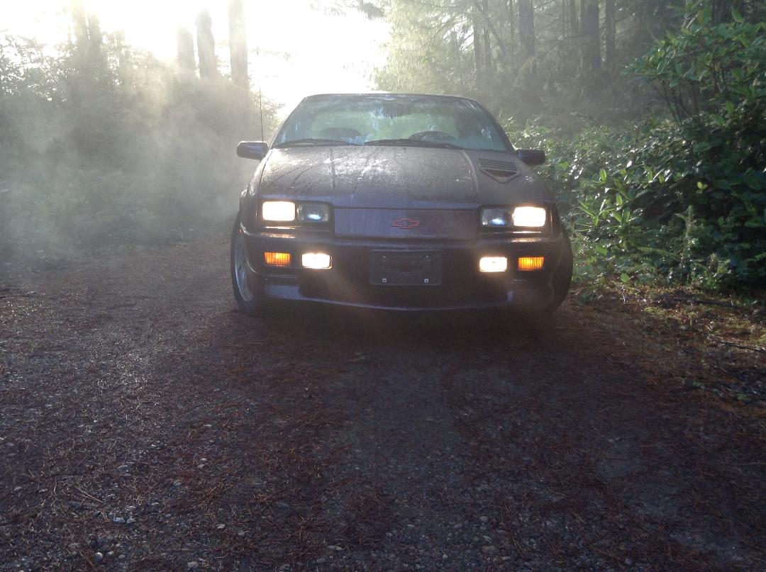

Posts: 1832
Re: Functioning ram air??
I can't even pretend to hate on that. My '90 Turbo 'Retta was supposed to get fender vents for hot-air extraction from the intercooler -before it got a massive FMIC instead. :roll:
Honestly, the Z04 body kit (GTZ and Z-26) feeds a LOT of air pressure there already, from underneath at the nose up into the fender in front of the splash-guard and in from the big hole there normally under the airbox. But I too supplemented my Z-26's airflow there with a NACA-style 280-Z hood-scoop.
A divider plate (not installed in this pic) separates the intercooler/intake area from the turbocharger and the rest of the engine bay. This keeps the air fresh and cool here. The hood-scoop has a 'vented' area behind the scoop to allow the hot air a place to rise out, so it does good providing both in and out breathing for the intercooler.
For me, it is not just fresh air for the intake, but also cooling air for the intercooler, but regardless, more isn't worse here, for sure. Looks like your cuts were pretty clean too, so that helps. :wink:
