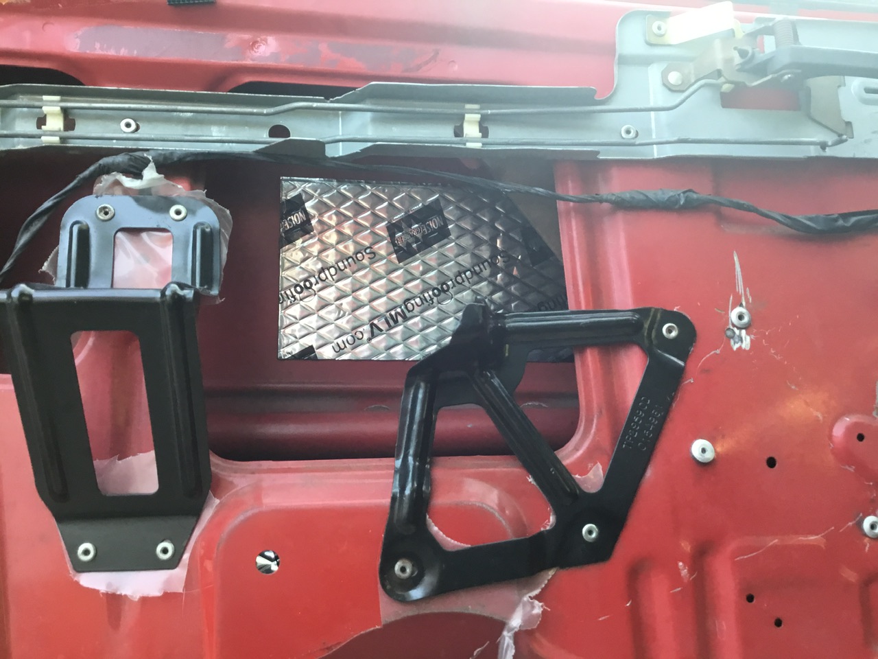

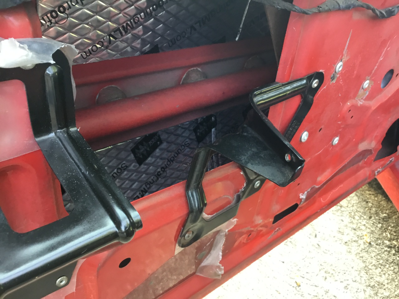

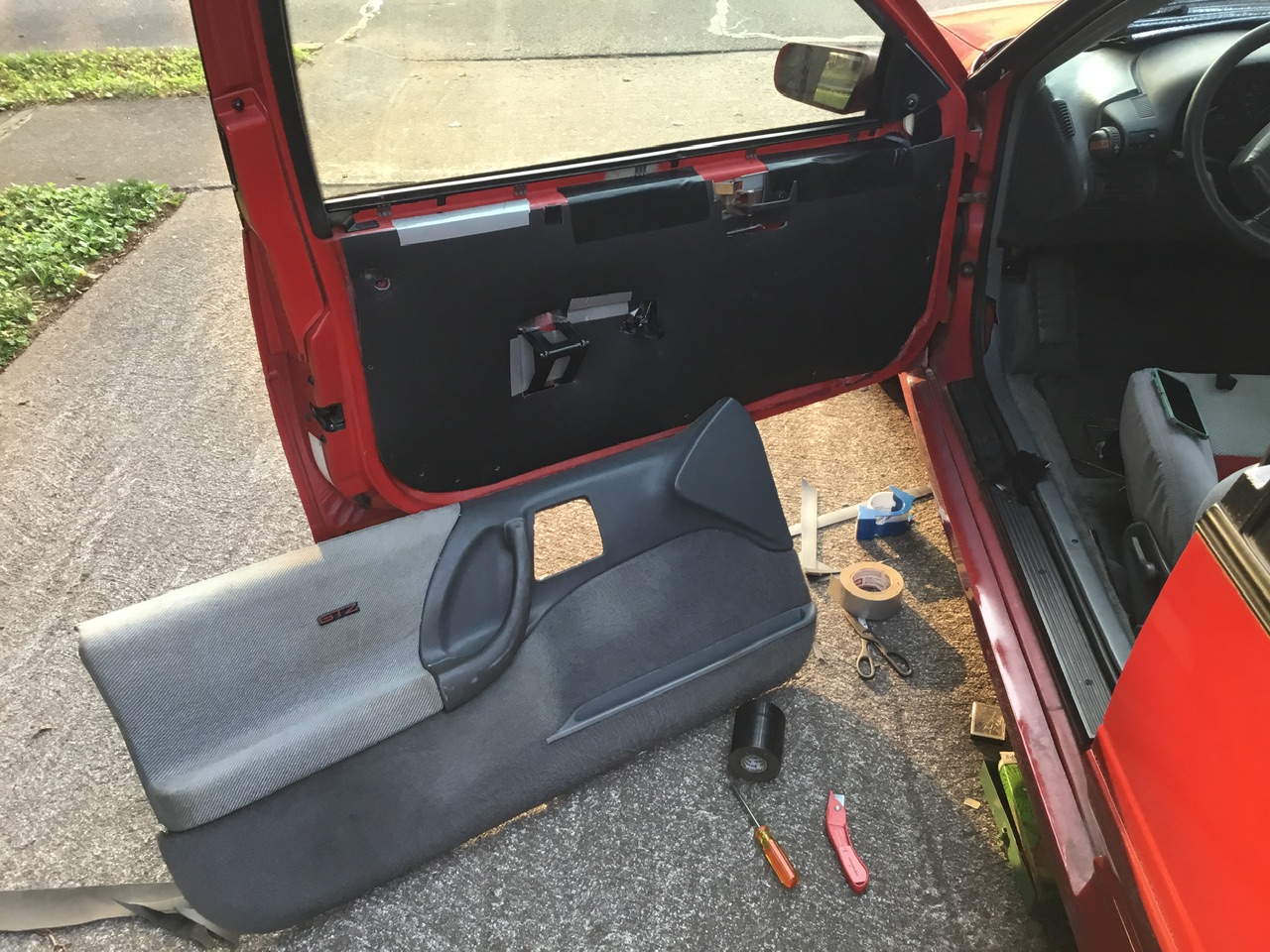

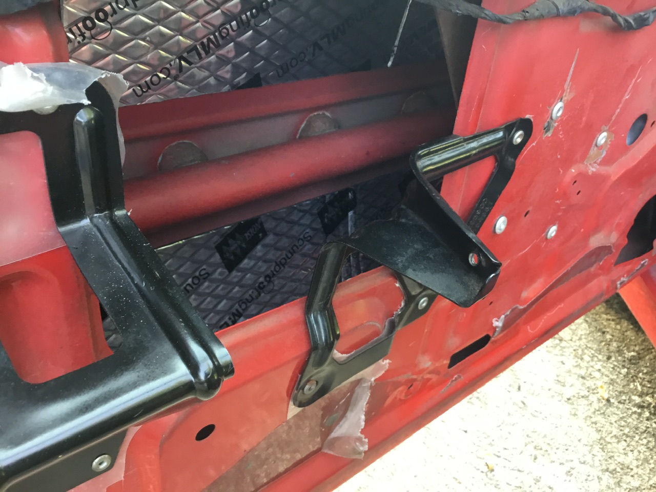

Here is my experiment post!
This test cost me $200 and several days time. I have a lot of time into this. 3hrs typing this just today so draft is what it is and I need to get back to the garage! I used a stock 91 v6 auto gtz for this test.
I bought more material than I needed because I believe that this will work for more cars. The purpose of this post is to give you a further-than-factory decibel reduction level for price paid in actual weight and dollars.
There is a lot of information here so bear with me as I try to summarize everything that I’ve taken in from reading many hours of forums and company-owned scientific data and testing results for all types of installs. The one thing lacking more than anything else is before and after results! Here for our little spot on the internet is a BERETTA forum post that reflect CHANGES before and after sound material was added! Here is the experiment and my results!
The changes from what I mention above are that the experiment car here tests DOOR PANELS ONLY, so the HH-66 glue for mass load vinyl is not needed. Melamine foam is not needed (well, not used) - it’s purpose is to separate the mass load vinyl from substrate (under carpet / the floor) to use it’s characteristics to the fullest.
However the same MAIN CONCEPT (3 layers) has stayed the same:
1)Cover big metal panel with Constrained Layer Damper. We see this also as “CLD tiles” or what we see when we close our eyes and historically see DYNAMAT. The new thing is to recognize a bell curve to use way less than covering the entire panel and making your car heavier.
2)Decouple layer using foam. Eric Wood’s pic of the door panel with the flat foam panels above should have been in my experiment to do this right THEN put the darker MLV over Eric’s foam. Separating the MLV from the base metal is required. To sound proof a house, soundproofingmlv.com sells clips to hang this stuff between studs like towels drying on a rack in the bathroom. The foam layer doesn’t appreciably do anything to block, damp, reflect, or otherwise stop sound. It only supports #3…
3)Mass Load Vinyl. Known as Limp Mass Barrier in some circles. This is vinyl as we all know it expanded to 1/8” thick min and about 1lb per square foot. Hence the mass. Barium Sulfate is often used. It’s non-toxic and has density (see below that mass is needed to block sound)

CLD tiles work by the rubber converting vibrations into heat which is then dissipated by the aluminum sheet that it’s covered with. Once I learned this, I stopped shopping for those without metal. The panel resonance changes. The more mass, the less frequency (tweeters are small and woofers are big)… to a diminishing return point, or bell curve if you will. We only need 25-40% coverage on large flat panels for this to be 100% effective. there is no need for 100% coverage as we’ve seen all our lives.
Sound Deadener Showdown (enjoy retirement guys!) referenced in my first post had been a major reference for many installs. They had a formula (240 division something…) and liked a checkerboard of tiles on a panel and their formula would reveal how many 2-1/4” squares this would be…. And wouldn’t be 50% coverage necessarily. See second skin/ Damplifier Pro videos to learn more…I gravitated to secondskin test results using thicker sheets instead of the checkerboard pattern but only on 25% surface of the panel! Save weight!
Getting closer! Stay with me!
As for the doors, it would be great to replicate a BOSE sound absorb room, with 3D conical fingers projecting in from all sides. This however would suck up moisture and truly would be the definition of sound dampening! Use closed cell foam will you? Well, that will still capture 10% of water and cause corrosion. Priorities mean we don’t do this. Otherwise it would suck the sound out of the car!
What I did with the doors is put on CLD tiles 25% coverage top half and bottom half. That’s one strip up top and one strip totaling 295 sq in for 1 LB 7 oz per door. That’s adding 3lbs total to the car!

Eng off, in driveway ambient sound 29db
Eng on, idle in driveway …………………51db
45mph on designated road segment 64db
(Note Road smoothness worth 7db)
ADDED CLD STRIPS in the doors (put door panels back on)
Eng off in driveway ambient sound 27db
Eng on, idle in driveway………………..51db
30mph…………………………………………59db
45mph…………………………………………61db
52mph…………………………………………63db
60mph ………………………………………..69db
ADDED MLV!
This weighed more than I hoped. 4lb 10oz per door, or 9 lbs total to the car just in MLV. Moisture barrier also put back on. MLV is NOT moisture barrier.
Eng off, in driveway ambient sound 27db
Eng on, Idle in driveway ………………..51db
30mph………………………………………….59db
45mph………………………………………….59db
52mph …………………………………………61db
60mph …………………………………………65db
Success! TOTAL weight added is 12lbs.

Impressive research! I don't think it was me that helped out with those stock dB levels, but I could just be plain forgetting haha. Later this summer I think I'm going to tackle some more deadening. I haven't done the doors yet, that I recall, so that's probably where I'll start.
