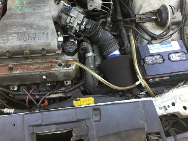

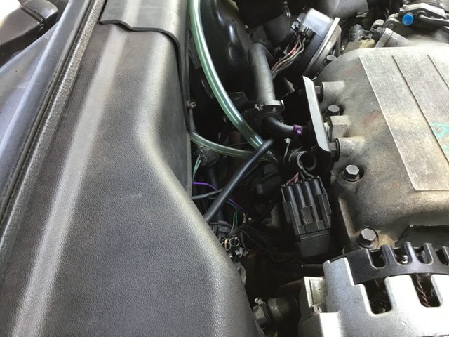

Okay, finally got around to messing with this. The main prob on this 89gt is oil smell, evidenced by oil residue all under the hood and surrounding the valve cover (front). New valve cover gaskets and grommets both front and back. Yes I cleaned it well! Gotta add some sealant from a tube on these to do it right. It’s obvious that oil is coming out of the front valve cover that currently has a breather filter installed.
Here is what I did: I wanted to see if eliminating the PCV valve itself would suck more. It does but it affects idle too much with too much air. So I’m gonna put one or two pcv valves in and see how that goes. Spill opinions here please. I do not know how the 3800 pcv system works (it’s internal - never messed with it) or anything newer than 2008ish model years. I do know how we got here from 1950 however. It’s a slow technological improvement.
No I have not compression checked the engine for info reasons. It gets full mpg and is strong as new so I don’t suspect any bad valve area… now there IS a crack in driver front cylinder wall from top to bottom… so maybe this is pushing air on its compression stroke to the pan area… but haven’t verified that. Don’t care really. When I drove my low mile Indy hard, it throws up oil in its stock airbox so this is a test bed for that too.

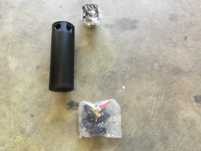

The oil catch can can’t be fabbed by me for cheaper than an eBay buy. $18 did I spend? It comes with a top breather filter and draincock in addition to the standard in and out line ports. Also comes in small or large! I’m impressed. Retail or the best option otherwise is $120. It looks like a quality deal!
I attached the manifold suction line in back to the out of the can (some YouTube say that it’s reversed… mine is not) and then I connected the front and rear valve covers together through a TEE fitting on the 3/8” vinyl tube used here. This line goes to the other port, IN , of the oil catch can. This will draw from both valve covers into the separator.
I think it’s the same s Eric’s except that I don’t have pcv valve(s) in at posting. Don’t know if his ambient air filter is used. I wish that I didn’t hollow out my pcv valve for the first test.
Premature post, I’m going to add one or two pcv valves and try again. Idle is 1100 in this setup. When the manifold input line is plugged the idle comes down nicely. Oil cap suction is massive. I’m impressed for a 3/32” stock ID hose dia that runs to the stock pcv valve. Takes less than 10sec to develop full suction I’d guess.

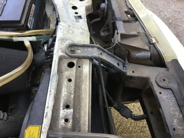

Can is mounted behind driver side headlight. Pix show vinyl hoses run and the rear of engine. For behind the headlight pic, follow the vinyl hose in to barely see the can.
The optional breather filter can be put ontop of the separator can. I didnt use it because I wanna suck vapor from that front valve cover. I don’t see a prob without a fresh air inlet. I worked on an 08 audi once and it has this strong vacuum sump.
Please comment and I’ll post new findings with pcv valve(s).

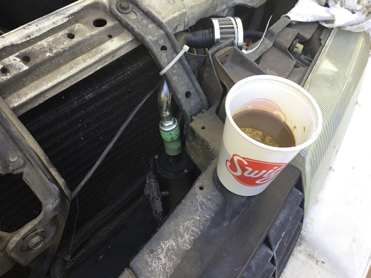

Here is what I hope is the final revision, and it addresses the overcoming blow-by, the changing of vacuum in cruise to positive pressure when throttling. I’ve noticed it occurs when hot, as little as 6” of power more from cruise at 40-50mph. So this is not much! I now added a filter but also moved the PCV valve to ON TOP of the oil catch can! This allows the vacuum PCV system to prevail, and both valve covers are open-holed. When the system changes to positive pressure, the PCV lifts as it should.
PICTURE: see green garden hose atop the oil catch can to PCV valve to hose to breather filter. More refinement can be had with hose size, this is 5/16” vinyl here. No strong feelings on increase or decrease. Yes this filter should be upright, but oh well.
The CUP OF OIL is after 1500miles I’d guess. Car is floored everyday, driven to 3000rpm torque peak, and so this makes me think that this can should stretch between oil changes for “normal driving”. Back to the oil in the cup: It has been ripped through the the passages with moisture and was noticeably thinned. Look at the color! The oil on the stick is still clear. This tells me that this mod is mucho-bettero for keeping that condensated oil vapor OUT of the engine. I can’t be happier. This mod should be done to all of our cars in my opinion. But once again, going to wait a while before putting on my Indy. Test of time is the hardest.
