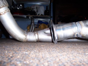

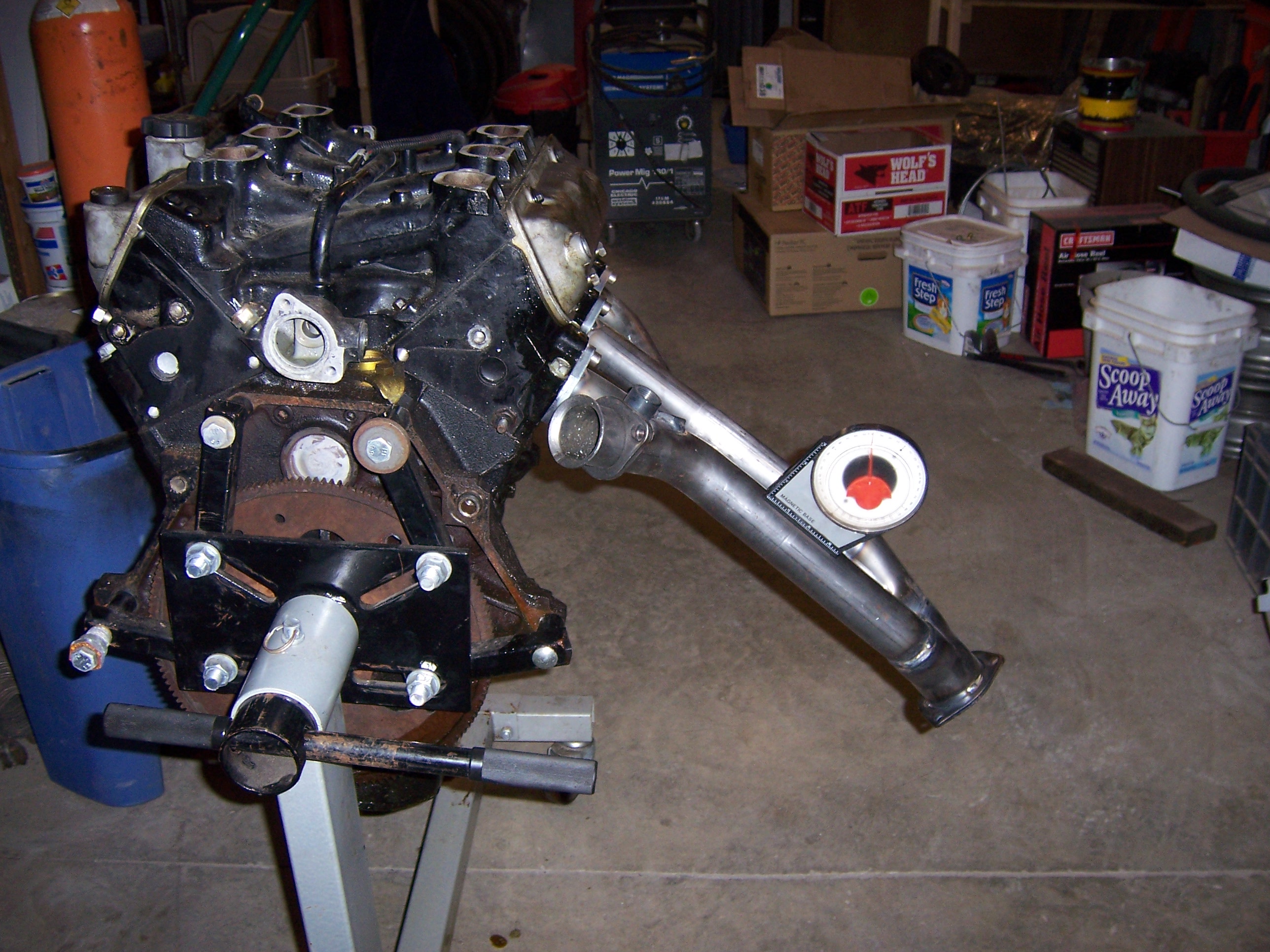

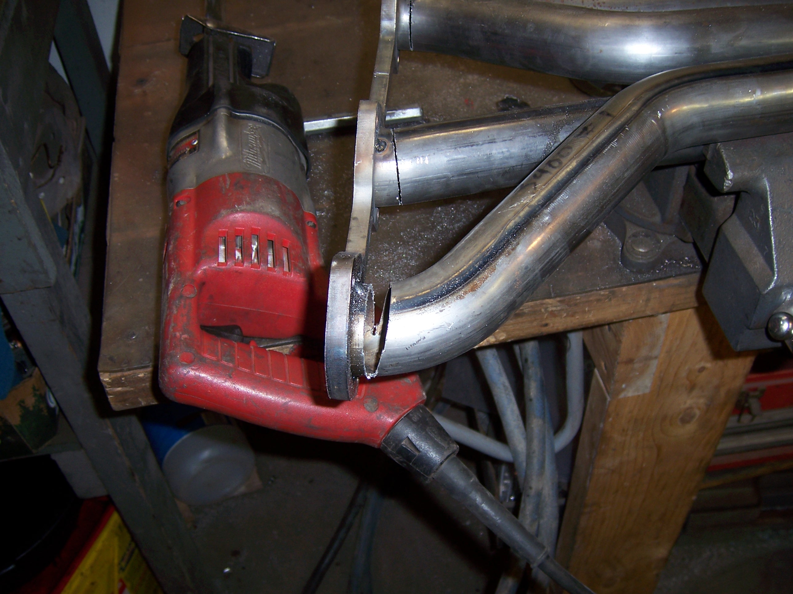

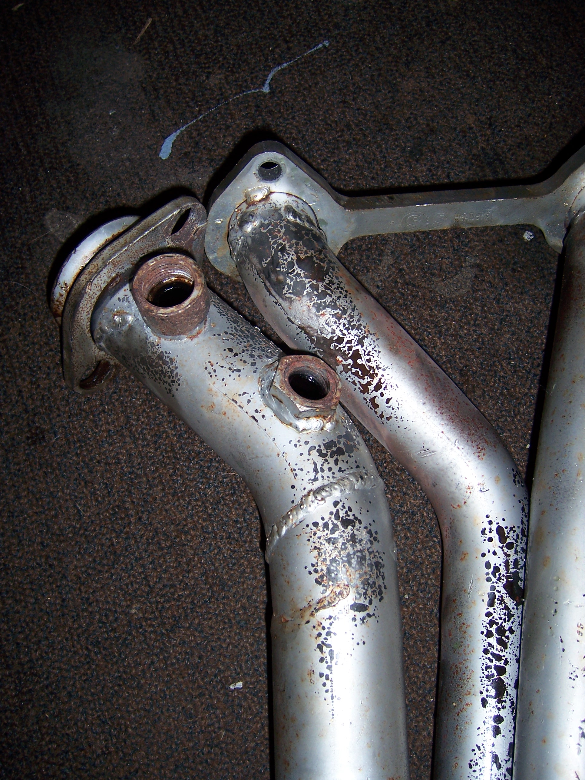

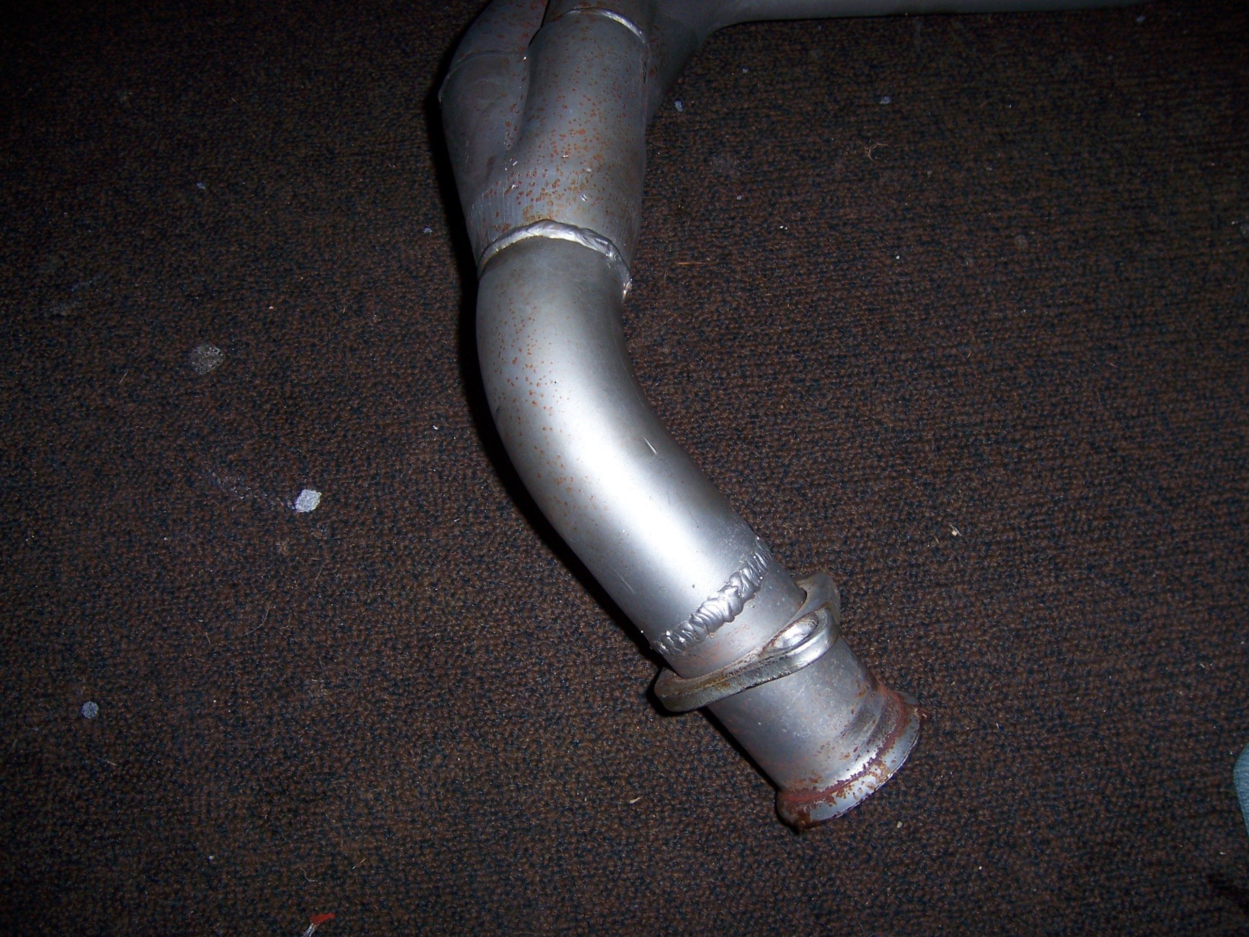

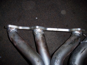

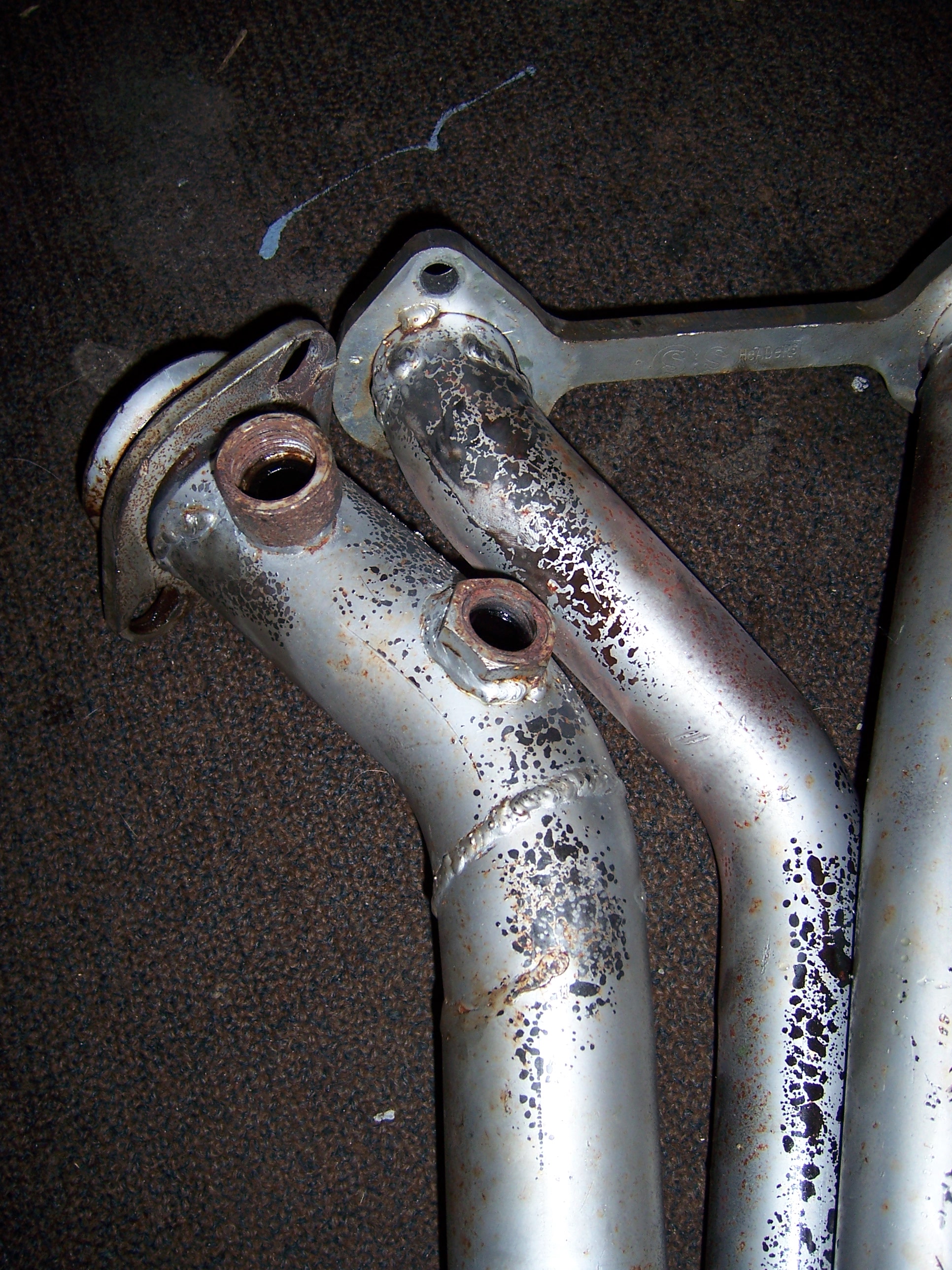

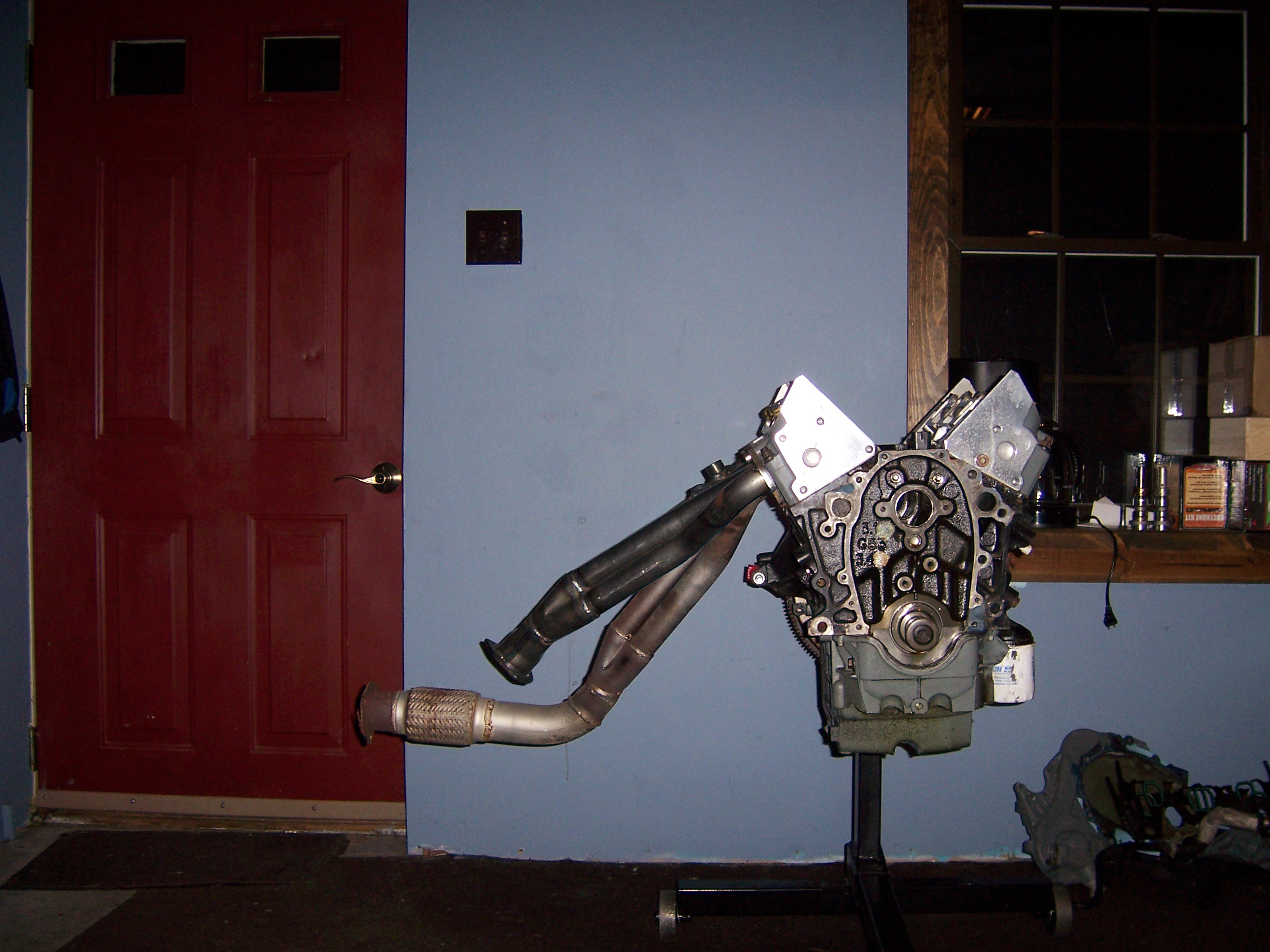

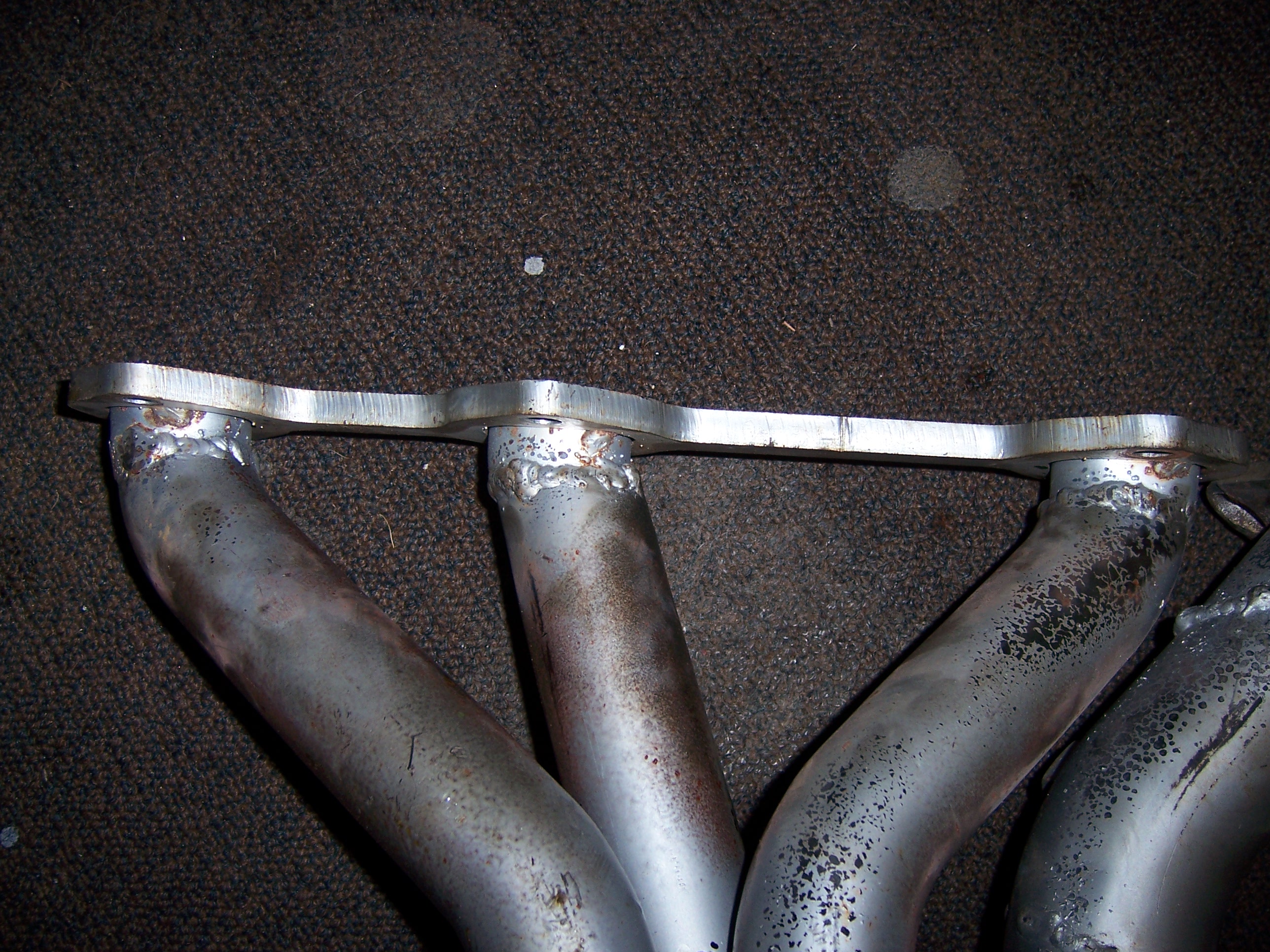

Here are some pics of the modifications I had to do to the S&S headers to get them to fit my car... Also pictured is Erics unmolested set... which will soon receive the same treatment.

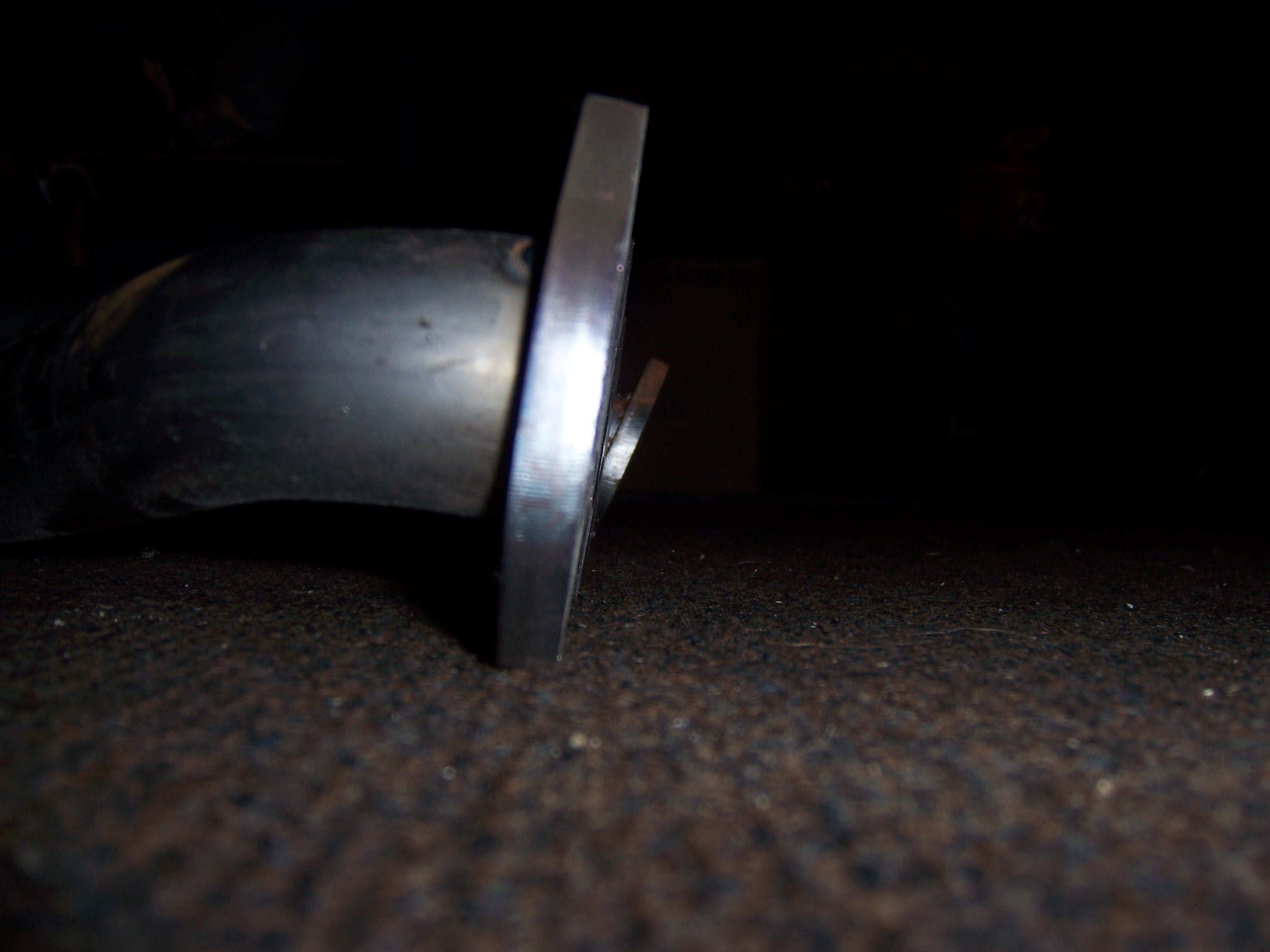

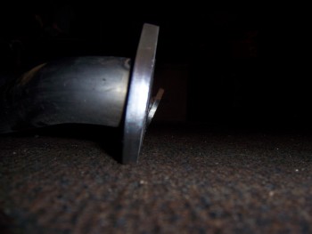

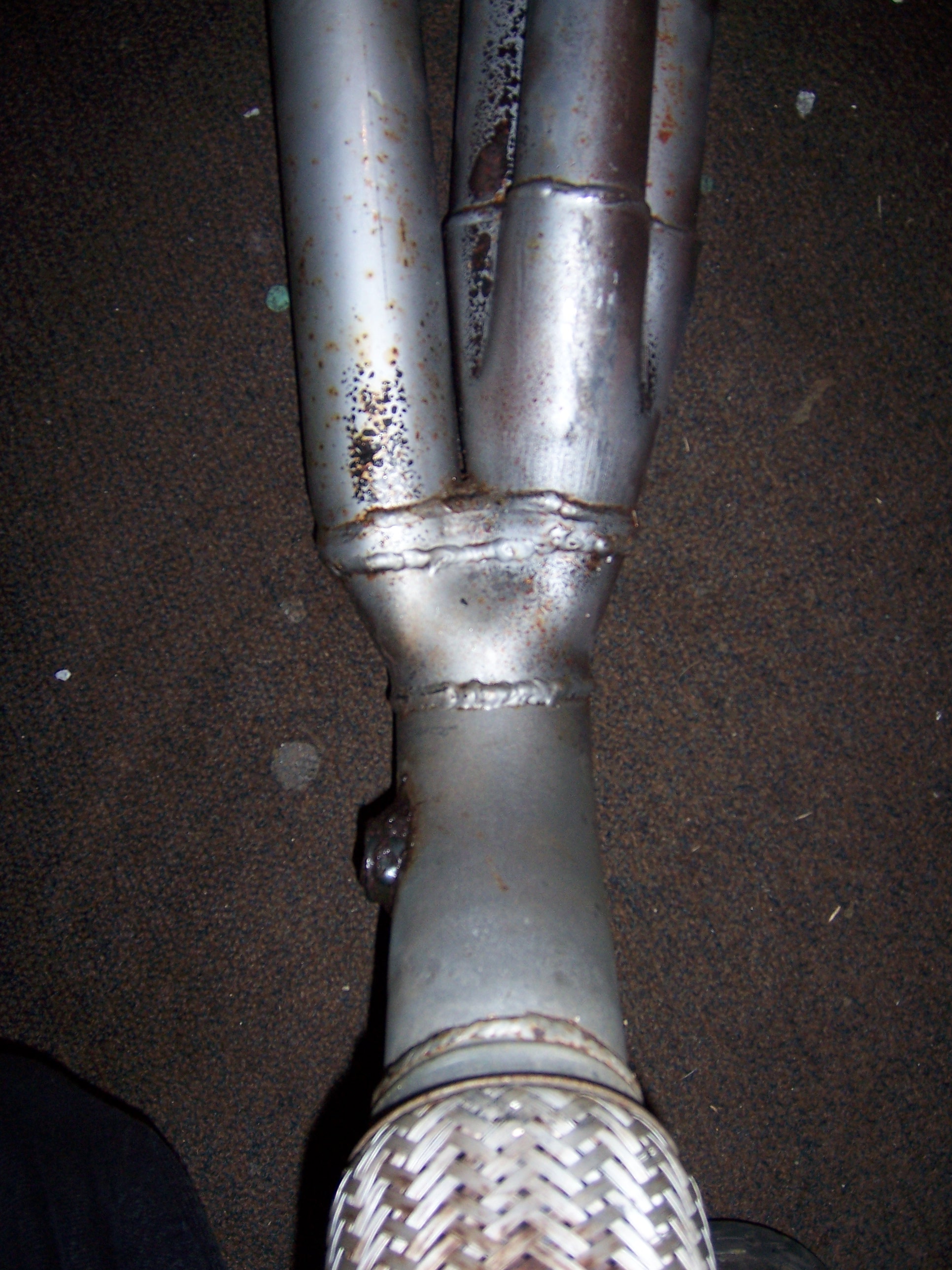

A few notes of things I did was cut all three tubes at the back flange and bent the main header down further to give it a sharper angle, then shortened and angled the last collector in the opposite direction so it wasn't aiming so far down. And lastly re-aligned the cross over pipe again.

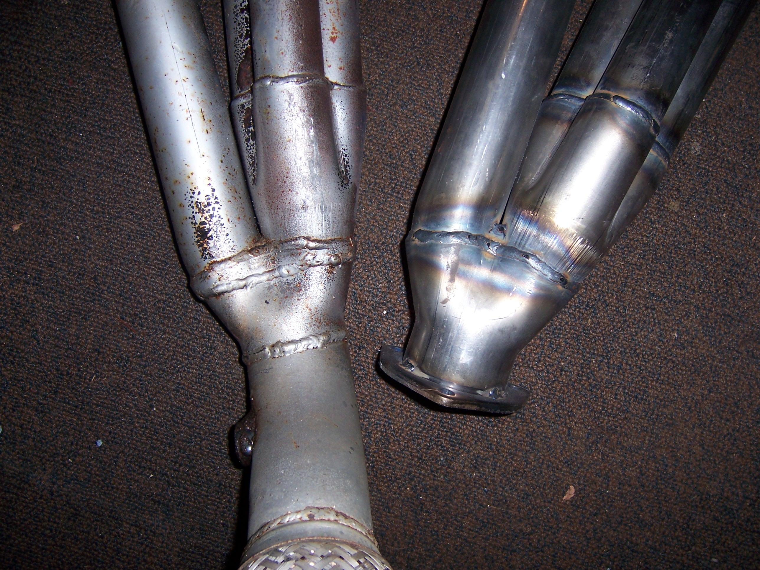

Completed header Last collector cut and weld. Cross over hacks, It could have been done it one cut on each side but since I didn't have both on the same motor it took me two or three shots. Bottom of rear down tubes. Angle of mine Comparison to unmodified... the rear flange does angle it a little more too since its not flat. Collector comparison collector flatness comparison.

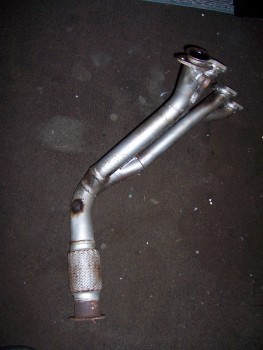

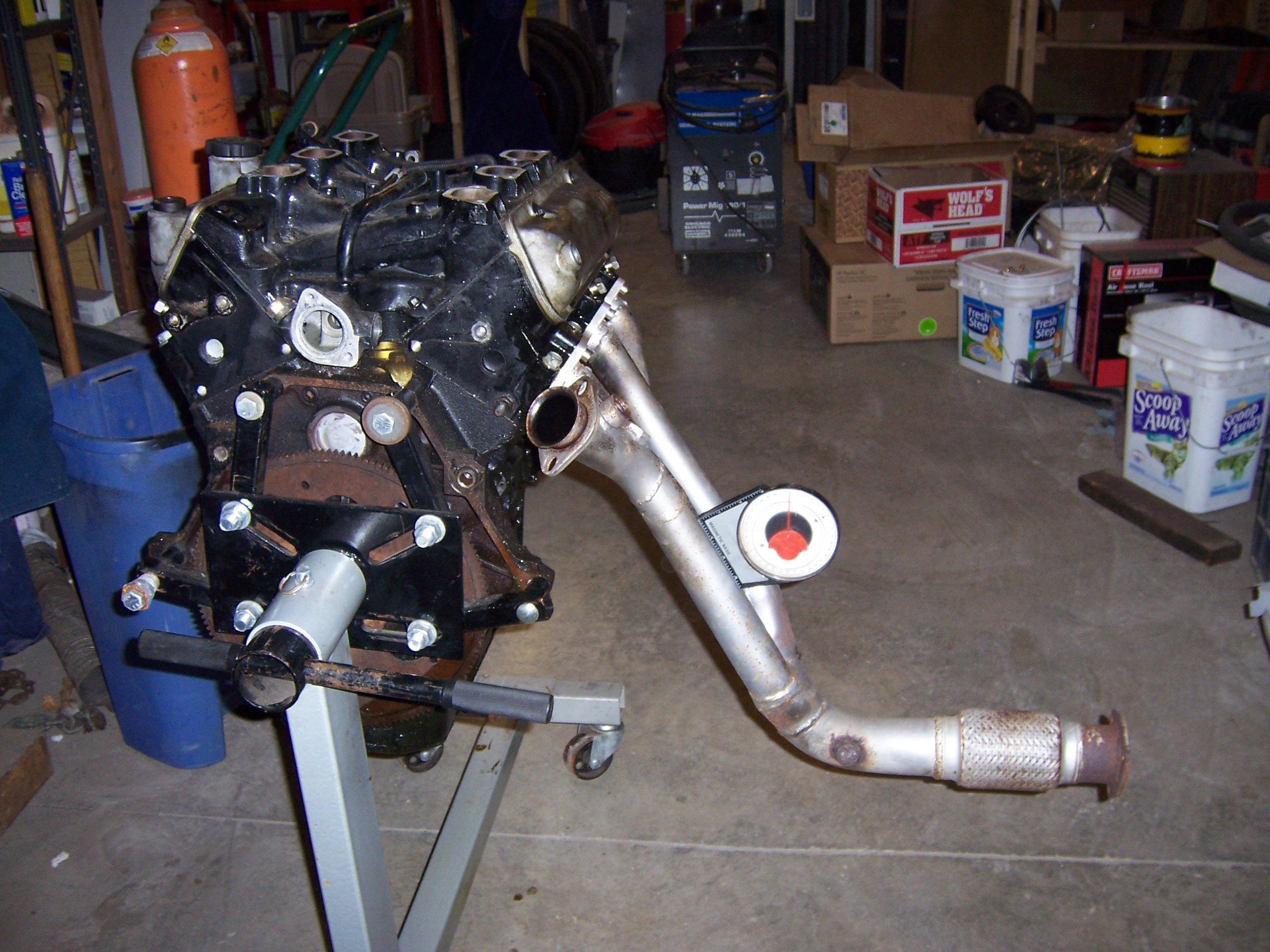

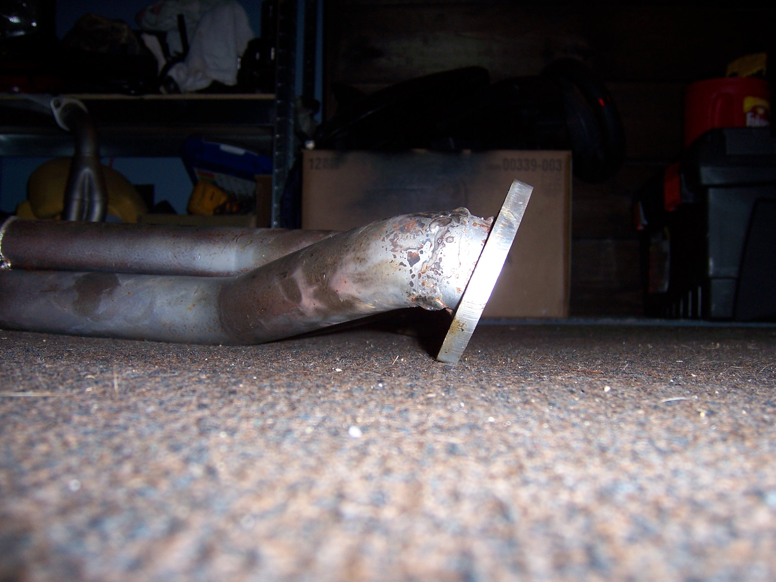

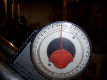

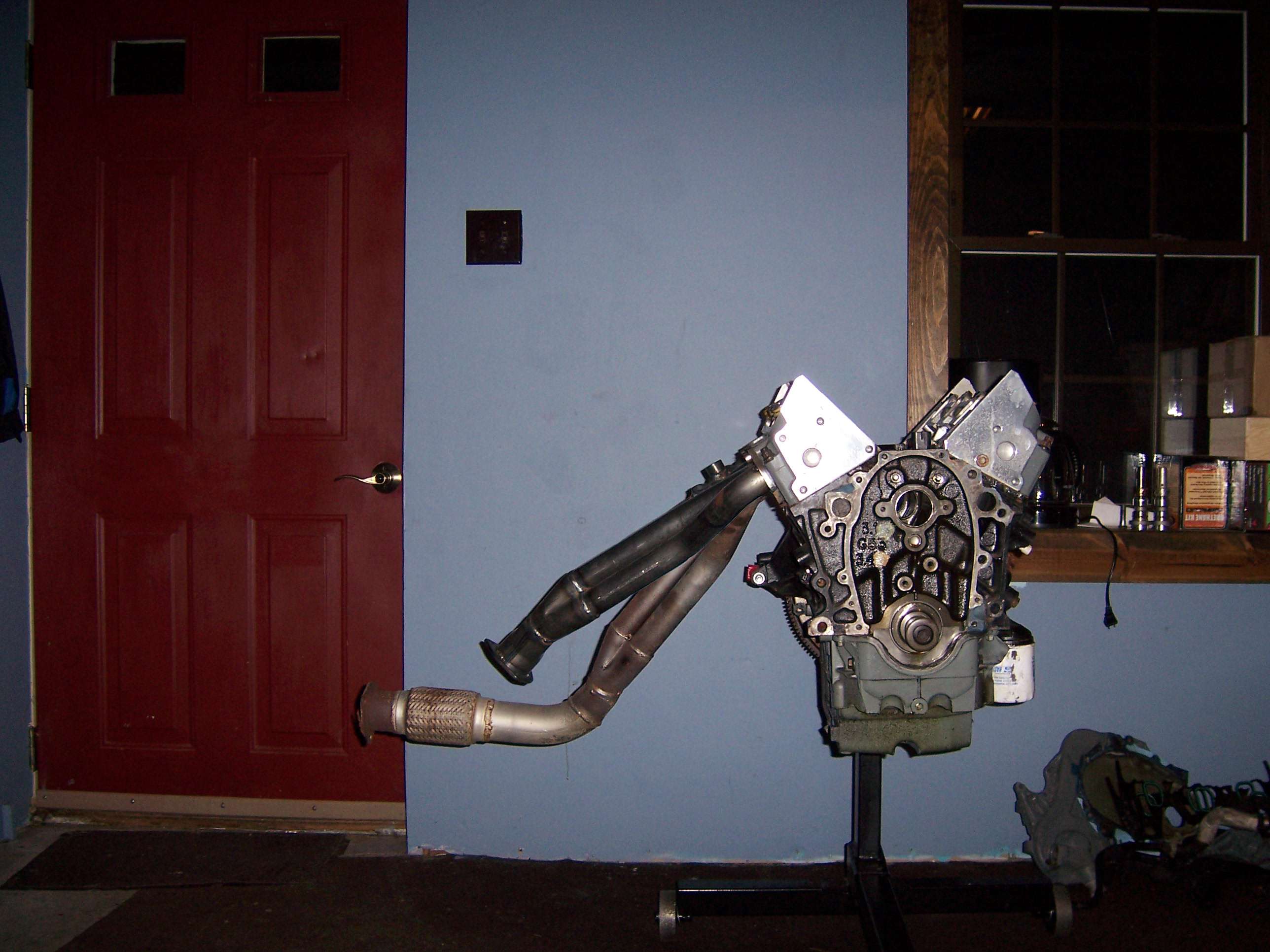

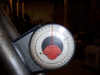

I know this pic had been done before but it was with a manifold and a S&S stock to compare... here is the header that works and a factory S&S so you can see how much I modified it down to fit.

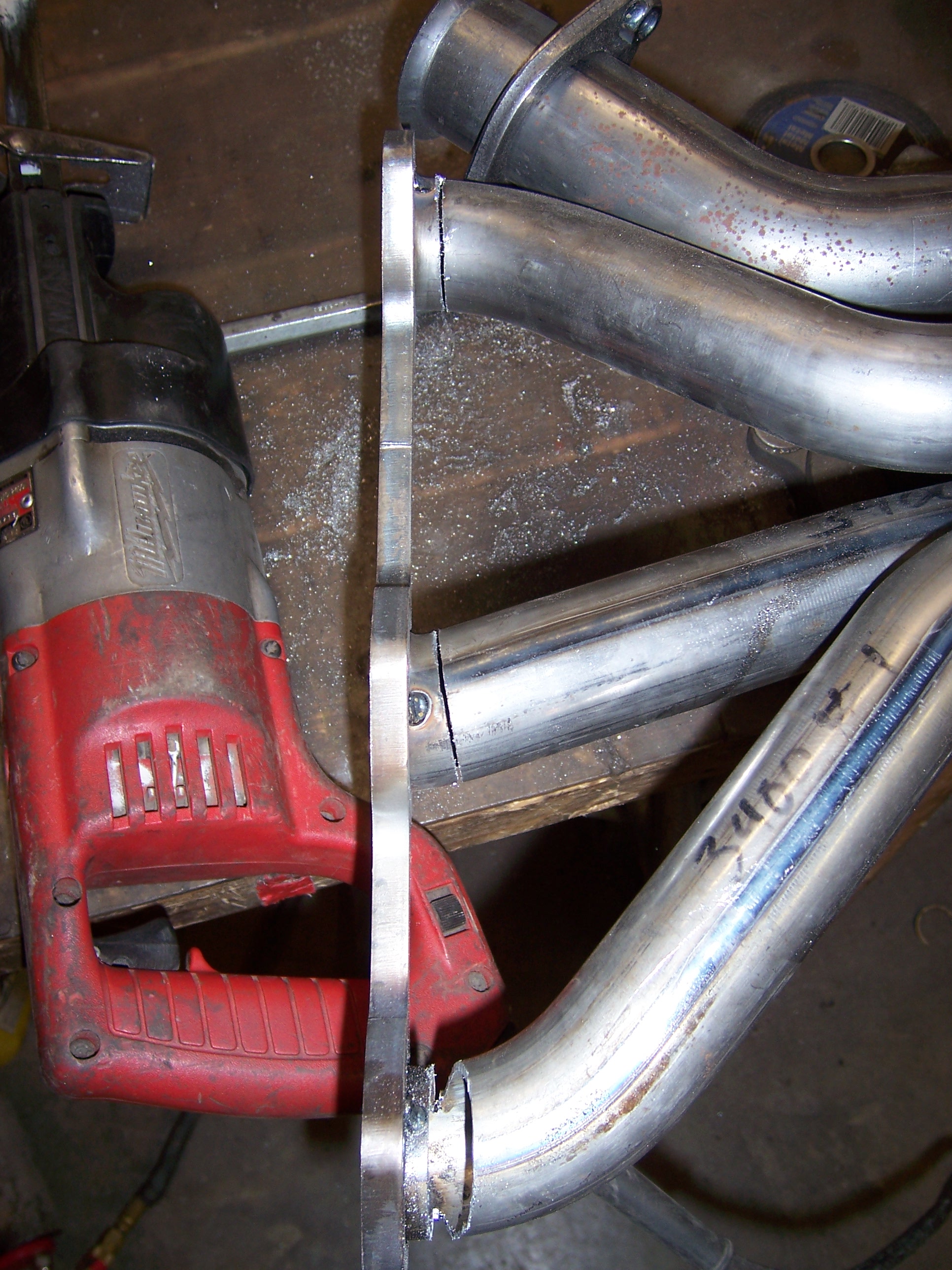

All chopped up!!!

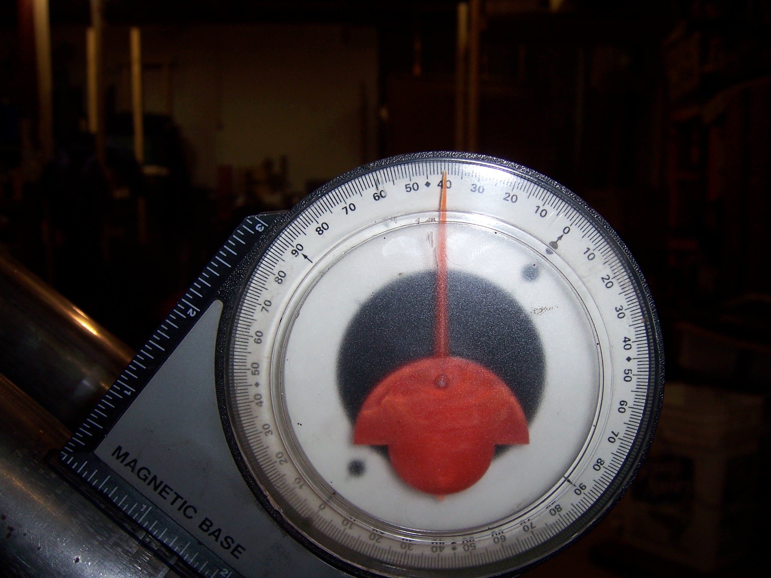

I had to add 20* to get the angle right.
They don't call it a 60*V6 for notin... LOL What I started with Right now the tubes are welded back up and set for a 60* angle on the mock up motor. Remember that's not a definite measurement, that's what it ended up being after I removed the DIFFERENCE... That's all you need to remember and tweak for.
All chopped up!!!

First of all, I don't know why the collector needs to be almost rubbing the t-stat housing. With it's position, the #2 primary is 27" long vs the #6 being 16" and all the rears are 12". Moving the collector a little closer to the corner of the head and having the crossover start earlier, then I believe it will make them fit most of the transmissions. Also the #1 primary can be moved a little closer to the others so they won't have to be dented. Still unsure about how the final collector should be finished to make it easy for the end user to install them without going to an exhaust shop though...
