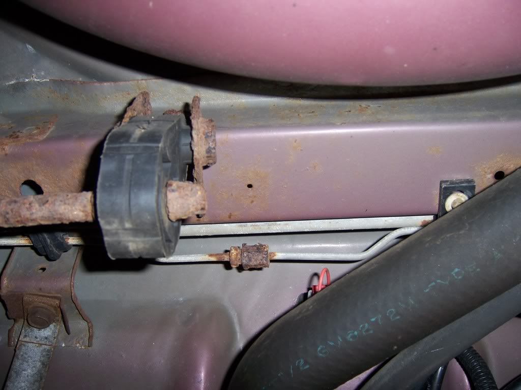

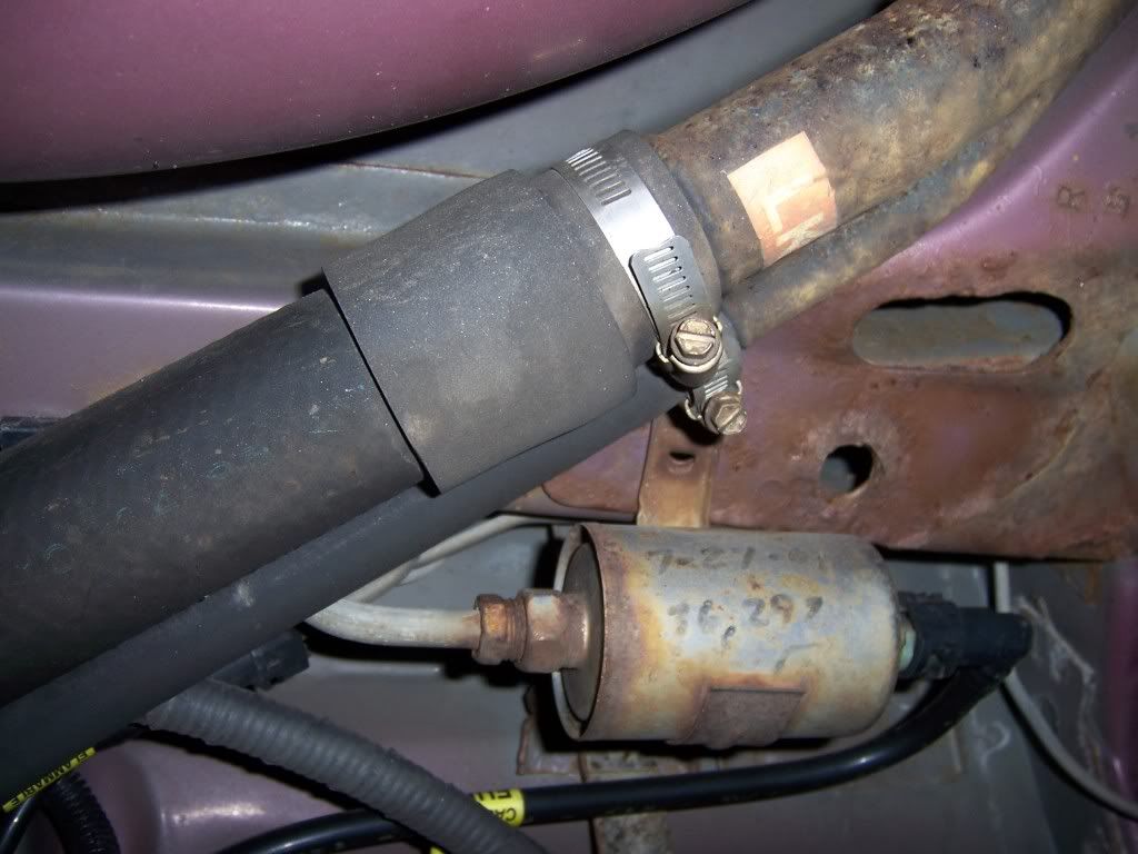

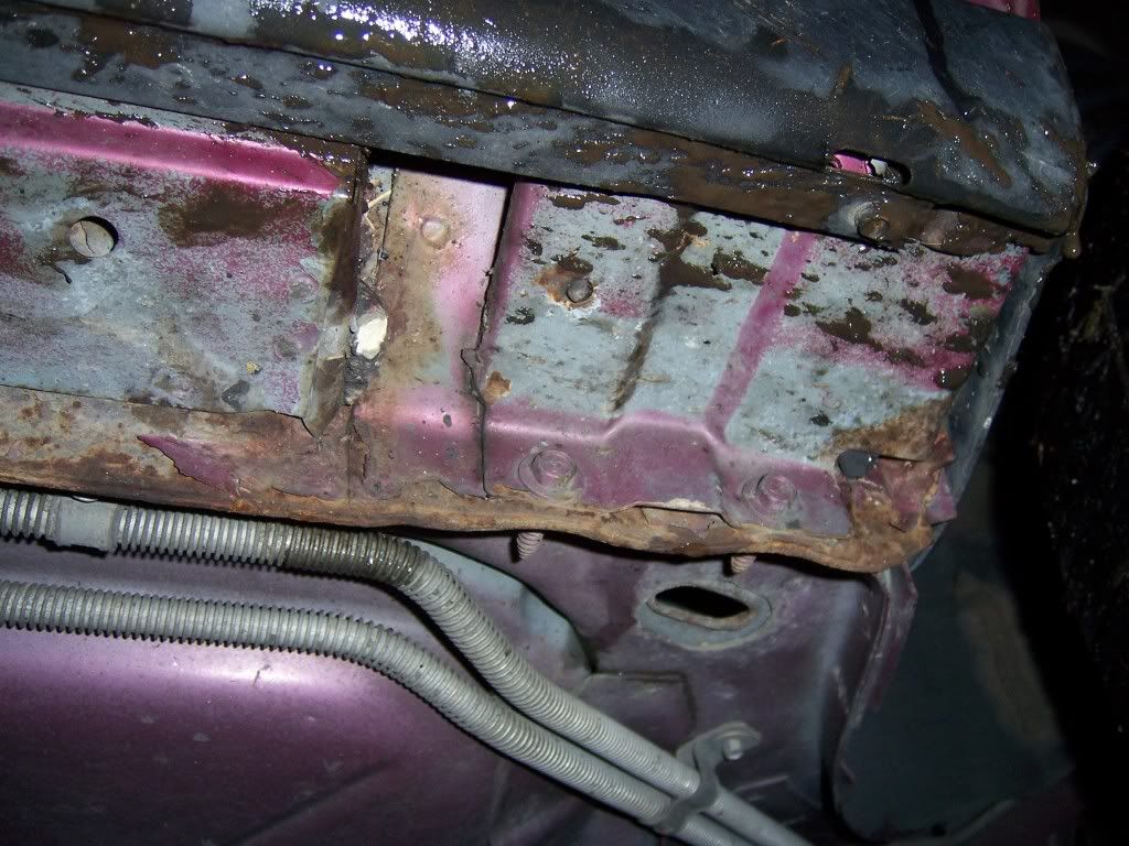

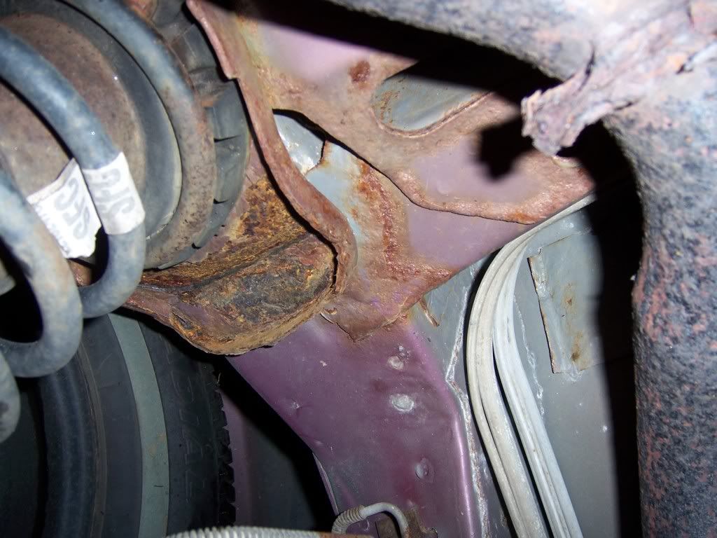

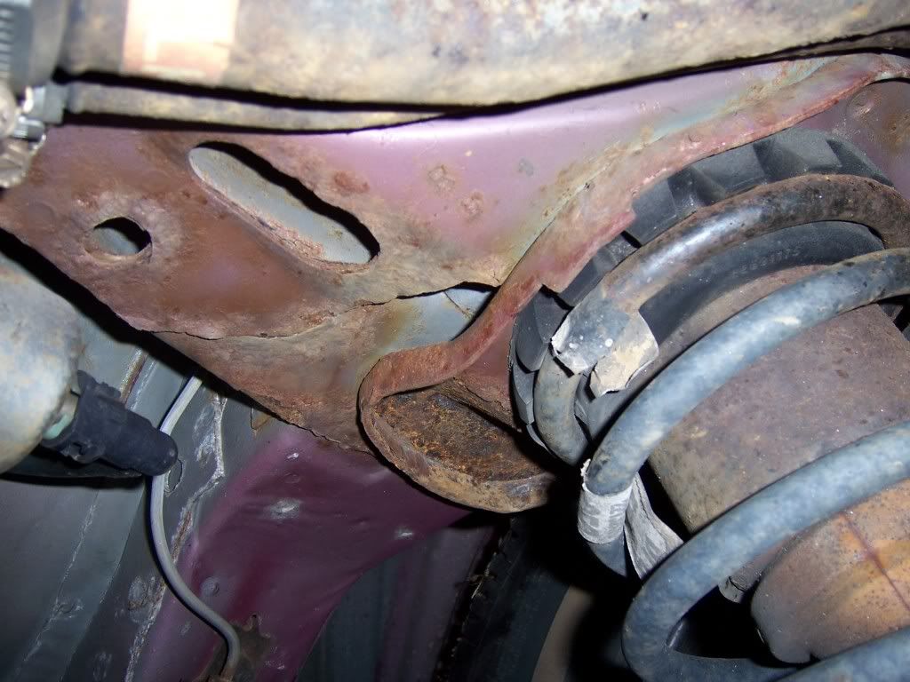

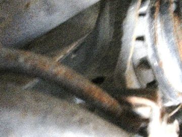

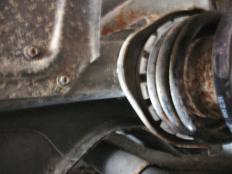

Is this stuff just surface rust, or worse? I know the pics aren't great, but from what I can tell it's not completely disintegrated like my 94. This looks like some wire-wheel work and some good primer/paint and it'd be good as new. Am I right? Just cosmetic and not structural or too deep yet right?
What about the bump stop, I don't see those long metal bump stops in Ixion's thread... Are those removable pieces?
From Ixion's thread it looks like the 95+ is a lot simpler and has less pockets both on the side wheel well and up top of the spring to catch dirt and rust out. Looks all smooth and less complex. The frame rail looks bigger and cleaner than older styles... But I figured I'd ask someone that owns one...
Thanks!

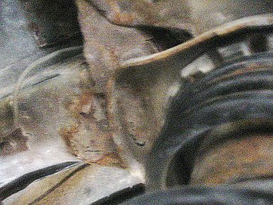

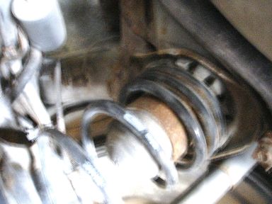

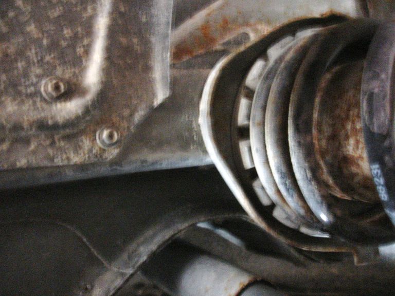

Here are the rest of the pics.

Yours is better than mine. I had alot of shale rust back there. I had to knock it off with a screwdriver and a hammer. Then I hit it with Eastwood's rust converter. All the paint I put on it came off, but the rust has stopped. My 90GT was more like yours. Watch that bumper support. That thing rusts like crazy and fills up sand. I also hit that with the rust converter. I had to clean out the sand twice this summer.
Those were the spring mounts I was going to send you. I still have them. You can pry the bump stops out and put better ones in. It's kind of a pain, but it can be done. Mounts without rust are hard to find. The ones I have downstairs have just spots of rust unlike the ones in the photos. Also the inside has very little rust(they rust out bad in there, they are open on the top). Drop the axle and they will come out with the springs. By the way a 95 Skylark has the same mounts(if you have to look for them).

So you're saying the photos don't look bad at all? MY car is 100x worse than those photos. Those are not of my car but a car I might buy.
So the eastwood paint came off? The metal rear bumper is rusty on mine, but it's pretty thick steel...
Cool so those mounts do come off. I can clean those up I'm sure. If not I'll take those ones from you!

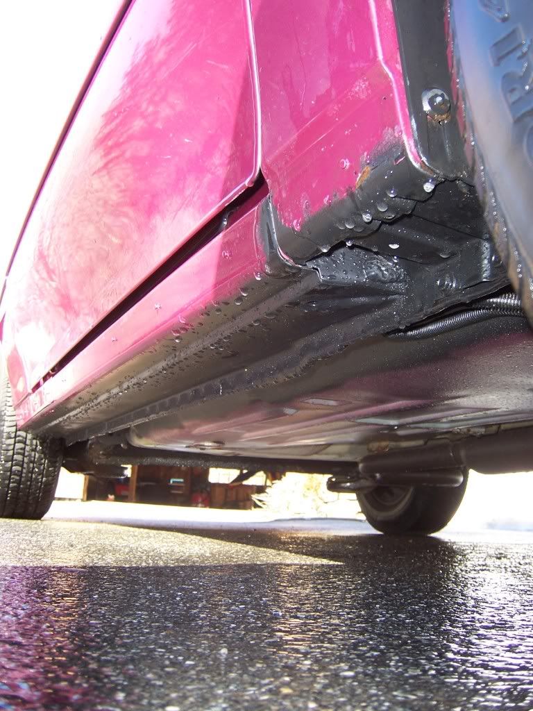

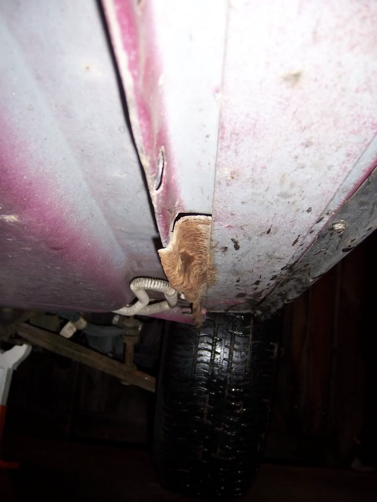

Thats not that bad... better pics will definately tell the story better... How were the rockers? THATS the biggest test... if those are intact then the rear bar is typically ok too.
Those bumpstops are part of the upper spring insulator... Take that off and it's just a steel bump up there about 1-2 deep that centers the top of the spring.
Rust encapsulator only works in dreams... there is no way to encapsulate rust or convert it. Its all a gimic... They only way to stop rust is to clean down to BARE metal and treat from there to PREVENT it... other than that if there is still rust color on the metal the oxidation is there and it will continue to spread when exposed to water and salt and so on. I need to get under my pink car and ensure that all that I have done will hold good... I know some spots I couldn't get before but with my own garage now I can stand this thing and pull everything out from under it and do a better job. I never had the facility to work like this for extended periods of time.
This is what I had when I started for rust... It was all surface and no real bad bubbles. As well as the rockers.. I'm going to go deeper into the rocker area this winter when I remove the splash guard to ensure everything else in there is OK.

Thank you guys. Jon, yours almost looks worse in some areas like the spring pocket at least from what I can tell with the crappy pics I have. I need to see if I can get the seller to take some photos under the rockers. He said the door jambs are not rusting through. BTW what's up with 95+ not having paint on everything underneath but instead just primer on parts, and what's up with the gas tank tubes rusting out? My 94 tubes are mint... LOL

mine was only bad in that area because that was after I scraped off all the paint that was there... it was only surface rust pealing the topcoat of primer/paint off... There wasn't any scaling that I was worried about. Trust me in comparison to what I'm driving its 100x's better and since it wont see salt again it won't get any worse.
