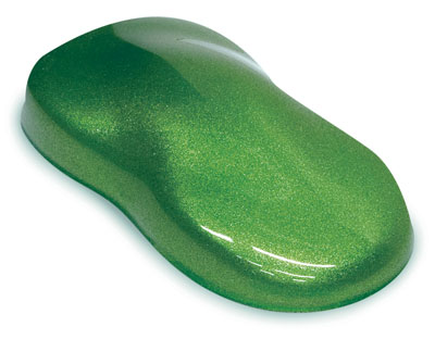

What I want to do is swap my 3.1L for the 3400. I also want to swap my 89 dash and center console for a 95 that i have.In the process of the swap i want to mold my predator body kit to the car put chrome mesh in the front bumper and re paint the car this chevy rally green i found. My first step will be swapping the dash witch im going to do next weekend.

Here are some pic of the motor/Dash/Paint/

I'm not the biggest fan of green on cars... I kind of feel like it looks obnoxious, but if you dig it and know you'll dig it for a long time then roll with it.

You will also have to swap the door panels for the dash to align properly, and I agree with Kurt on the green paint idea.
