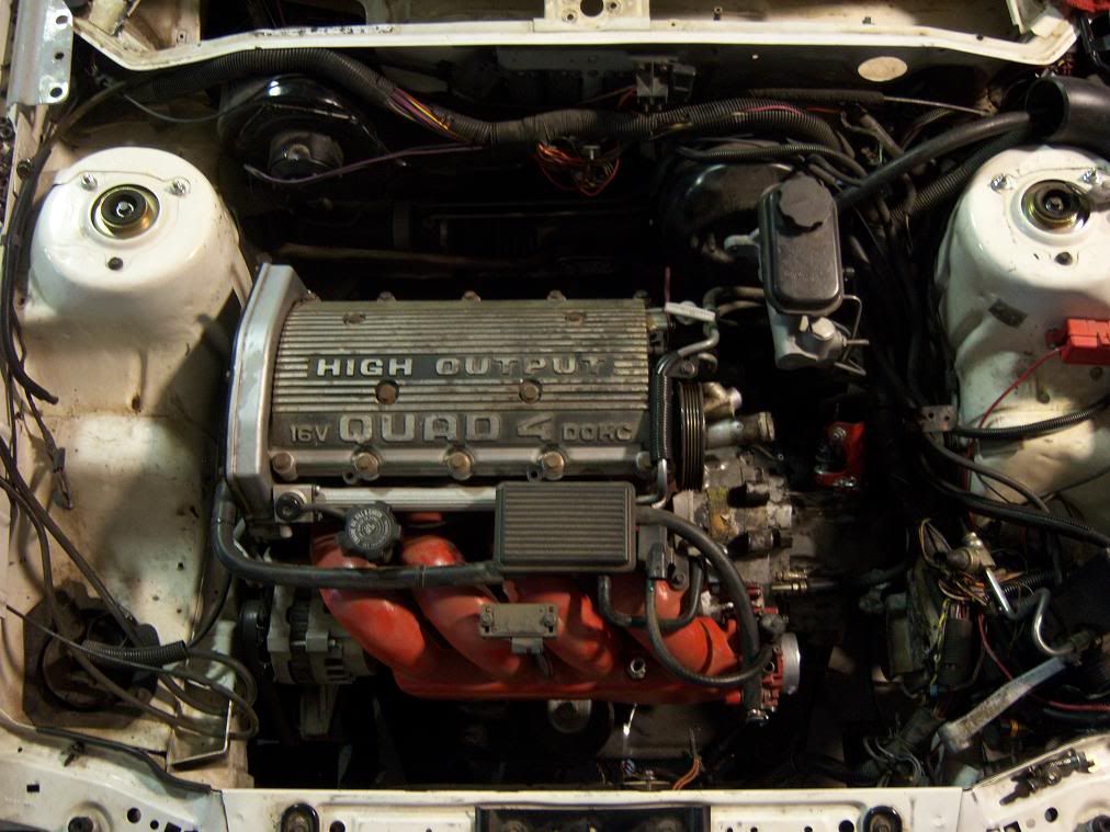

Tonight, i got my car's motor unharnessed and fluids drained. Only thing i have left to do to get the motor out is yank the axles and unpin the mounts and out she comes. I have a full Felpro gasket kit to reseal the motor top to bottom, front to back as well as new head bolts. For those that dont know, i put the motor together with Victor Rienz gaskets when i overhauled it and the motor has been leaking out of every orifice it can for the last 25k out of the 28-30k miles of the engines life. Im also installing a new clutch, flywheel, near mint condition shift cables, and filling all my motor mounts and building a stout front mount.

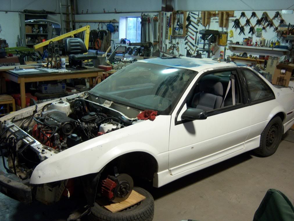

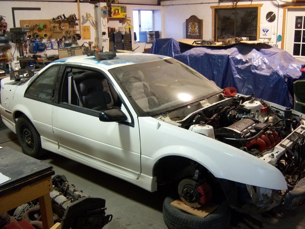

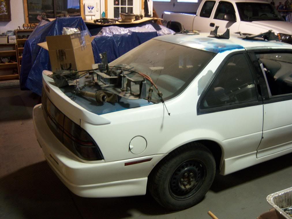

How my poor car looks right now (so dirty

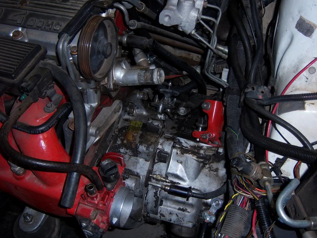

The motor and trans ready to come out

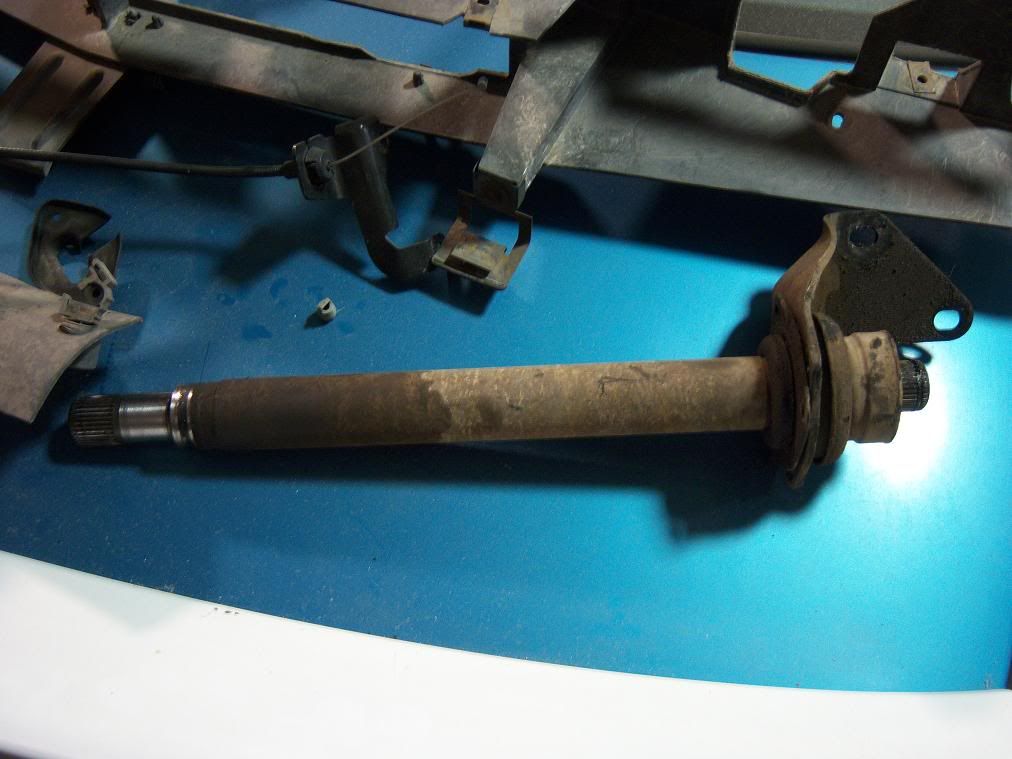

Found a quad jack shaft to replace mine that has "welded" itself to my passenger axle

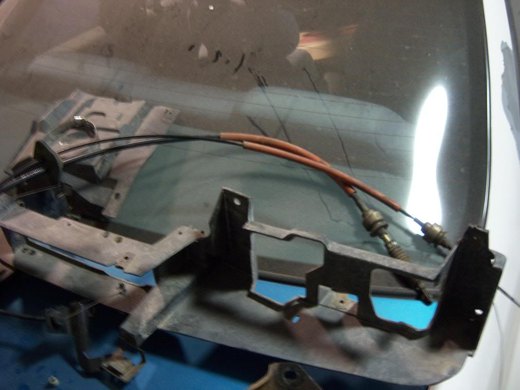

Shift cables, came from a low mile 91 Quad442 in the yard

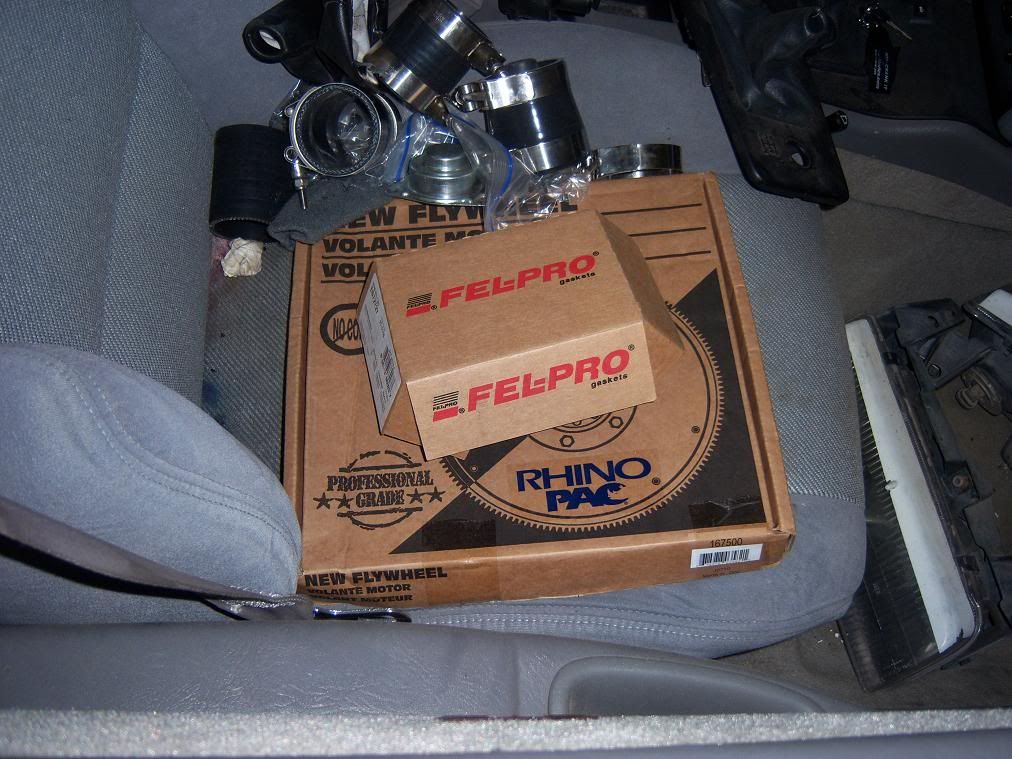

The new flywheel and gaskets
I ordered a clutch from Amazon, thanks to 3400Modified for pointing out that they sell Exedy clutches for dirt cheap. I had a Delco clutch ordered, but when i opened the box and found out it was a China peice of crap, i sent it back to Rock Auto and ordered the Exedy one.

Oh, all the parts inside the car are either brand new, or my headlights, neither of which have oil on them. The shifter plate is just dusty. The wheels im using as jack stands, actually dont fit the front wheels. Since i did the N-body brake upgrade im in need of some matching wheels all around. I would put the car on stands, but i just put the new struts in the front last summer and the car has been down since then roughly. I didnt want my new struts going bad so i flipped a set of tires i cant use upside down and am using the cars weight to keep the struts compressed.
All my engine parts are being stored on a nice free-wheeling 3-rack cart. No oily parts will be kept in the car. Also, everything else that in the car, isnt as dirty as it appears. Only dirty parts are the headlights and they are just dusty.
