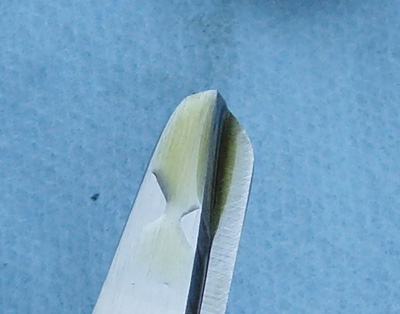

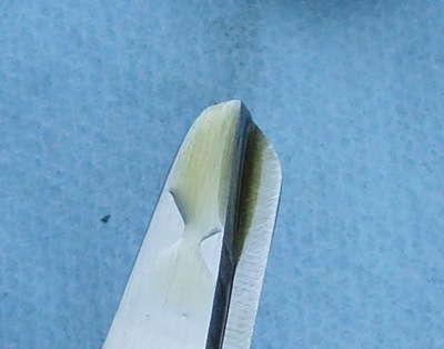

Yea he told me what you said before he left. The fluid looked like chocolate milk with a few tiny visible bubbles around the edges. My first thought when I saw it was air, but I wasn't sure. It's been sitting for about 1.5hr now. I just went out & checked it. It's still the same level (wouldn't bubbling from air also have caused it to be higher until it aired out?). It didn't look like chocolate milk anymore, but to make sure I dipped the tip of a pair of scissors in & the fluid that stuck was a very light tan at the thickest point, and clear at the thinnest. So I assume my fluid was fine & it's just air that made it look that way, like you said.

Once I get it filled back up I guess I'll just have to keep any eye on it to see whats going on with it. Just to give a visual, it looked exactly like chocolate milk after the 2mi drive... my kind of chocolate milk, not will's super chocolatey mix lol. And after sitting for 1.5hr, it had settled down enough to look like this... (still has to settle more from what I'm told)

Color on the scissors actually looks pretty good.
