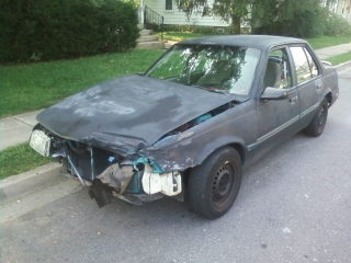

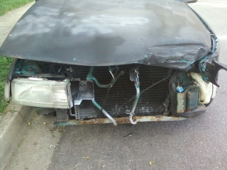

the damage is as follows:
-driver headlight obliterated
-gen 1 ph 2 front bumper and bumper support ripped offa car, bumper cover destroyed
-fan and battery pushed outta whack
-core support bent
-hood destroyed
-fender destroyed
-radiator mount looks like spaghetti
-steering rack outta whack
-i think fuel pressure sending units messed up, fuel gauge keeps actin crazy
-radiator/condenser/fan pushed outta whack
-hood latch destroyed
-evap canister obliterated
im sure theres more, but this is the list so far. bright side- got an excuse to swap z hood, maybe diff bumper. kinda still in shock.

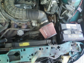

- Attachments
- u can see how everything is pushed outta whack
- car4.jpg (58.47 KiB) Viewed 6490 times
- wanted to start cryin when i first pulled up
- car3.jpg (49.09 KiB) Viewed 6490 times
- car2.jpg (46.12 KiB) Viewed 6490 times

Why the Air Filter set up like that? Just pulling the hot air right off the motor.

Because stock airboxes are the devil and even warm air set up like this is better than stock.indyyellow wrote:Why the Air Filter set up like that? Just pulling the hot air right off the motor.

Sorry to thread steal, but putting in a air filter like that over stock makes much of a diff that you can feel it in the pickup/driverability?

i did the intake at the same time i put new exhaust on (stock), and those combined made a definite difference in power and responsiveness. the old pipe was original and rusted to hell, so im sure that had alot to do with it. the filters just stuck up in the hose, if anybody readin this decides to do it BE CAREFUL, the stock hose is brittle and cracks easy.

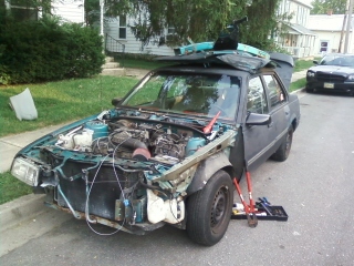

started tearin it down, not much to report. was able to use a hand winch to take some of the bends out.... and i re ran my stereo wires and hood release cable. the cables not hooked up to anything, but i had it and i figured now was good a time as any.
- Attachments
- as it sits now...sucks not havin a garage
- carteardown.jpg (60.52 KiB) Viewed 6434 times
