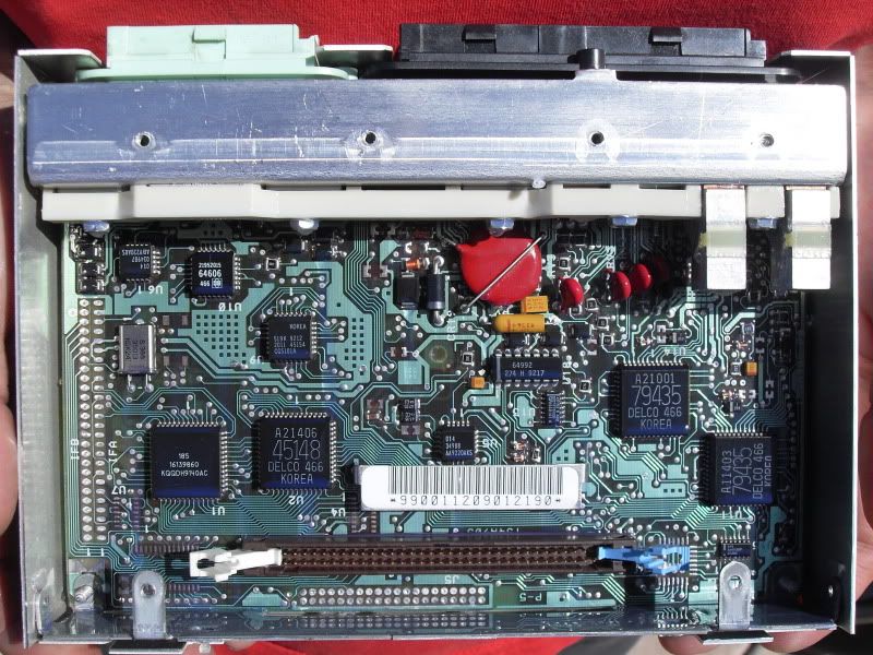

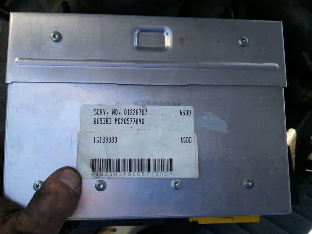

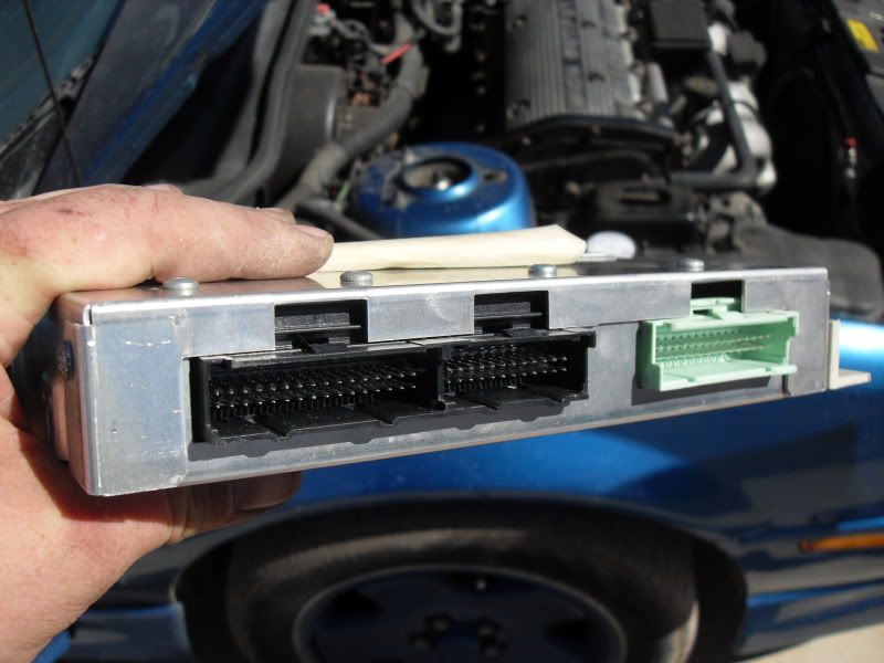

Well it turns out it really IS the ECM. Or has to be anyway......
Put a brand new knock sensor in today and she still threw both codes.
Pulled the ECM and guess what? It appears FINE. No corrosion on the pins or wire harness plugs at ALL anywhere. They were all in PERFECT condition.
I couldn't see any burnt spots on the ECM or chips or what have you. The coating seems perfectly intact on the board. I sprayed the ECM , E-PROM connector and cover out while dis-assembled just cause anyhow. Reassembled and put it back in. Same story.
I cleared all codes, started car and it threw both codes again shortly thereafter.

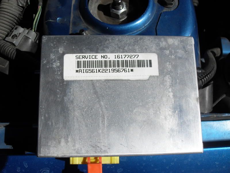

I then took note of what I presume to be the BCM and guess where IT resides? DIRECTLY under the fresh air vent and behind the glove box, which seems to be the source of my leak. And IT has DEFINITELY gotten wet in the past. You could see the stains on the outer case. So I pulled IT and pulled it apart. INSIDE seems perfectly fine as well. Body harness connectors and pins on the BCM again, were perfect. Gold plated on this one even. Sprayed it out just cause,put it back together ,reinstalled, and restarted car again.
Same story. Short time later BOTH codes came back again.

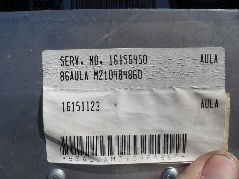

So, I said gently caress it. I had the parts store order me a reman ECM. Btw, my ECM is a 6450 which is exactly what the parts store listed for this year and model of Beretta.
Pics below. Top 3 are the ECM, bottom pic is the BCM.

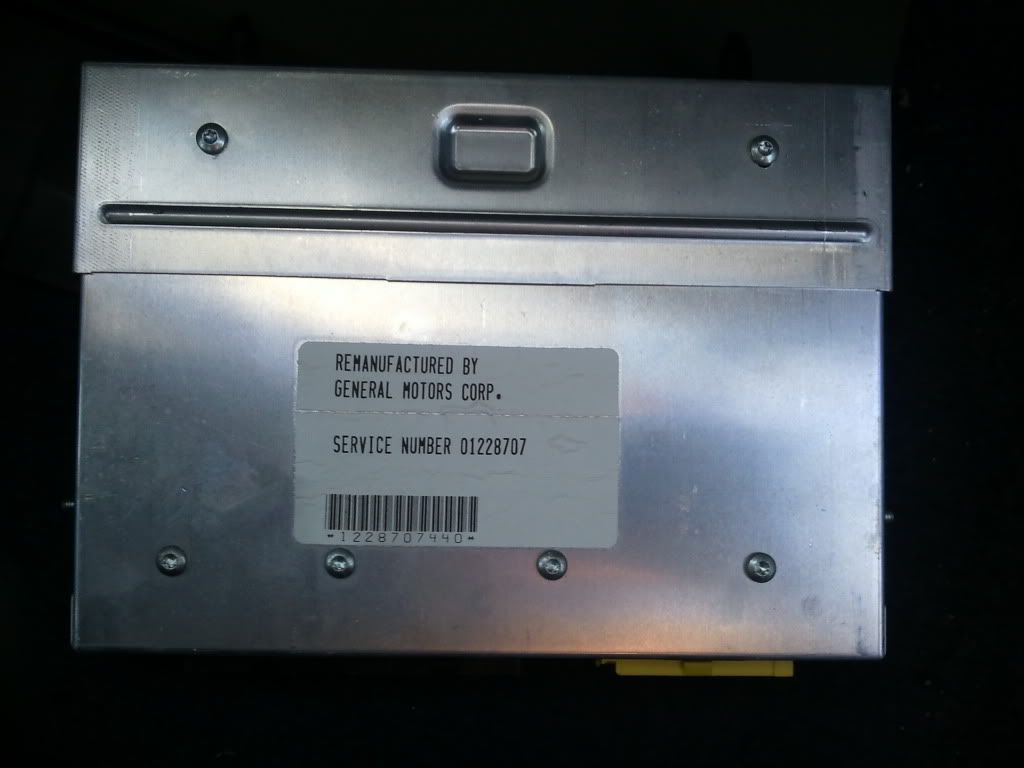

Re: REALLY the Knock Sensor or is it the ECM?
That second box is the air bag module if I'm not mistaken.
Yep. Air bag ECM. Pulled one just like it out of the red base. Yellow plugs usually are for ABS stuff. Notice I said usually. hah
