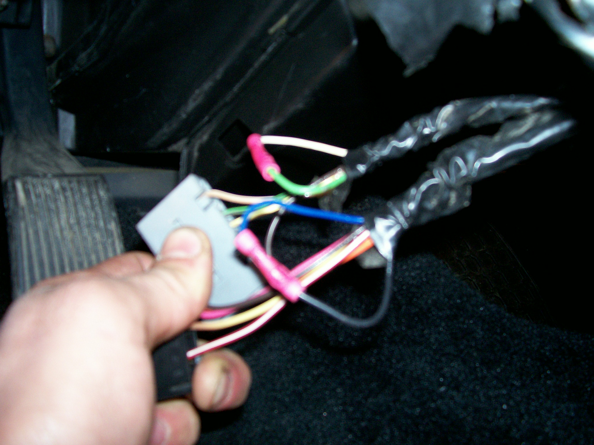

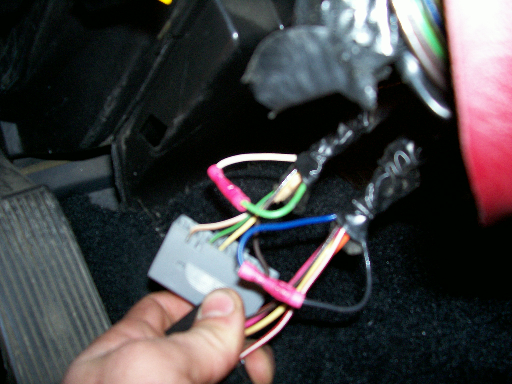

This was stickied over on bstuff but since that site is gone I'd share it with you guys. What made me decide to share is that I read someone saying they do the e-brake trick with their drl's which makes me cringe a little lol. The DRL module is hidden with velcro underneath the heater control knobs on the backside. When you unplug the module you loose the ground for your drivers side highbeam I believe and also the highbeam indicator ground in the dash which means they wont light up. I dug my pictures up for you guys but I can't tell you the exact wire locations and colors but I sure you can compare my pictures to whats in your car and figure it out. Happy trails!
