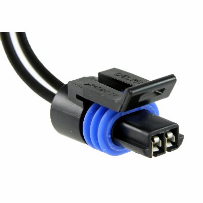

Sorry I kind of worded that pretty badly. What I meant was, when you unhook it, it runs to this A/C line looking hose. Would I just cut the sensor from those wires and electrical tape them together for the replacement?
I also managed to find the sensor. This is the part I am buying right? My local auto parts store has this I am gonna pick it up tonight.
Re: Low coolant light on, no leaks and is full
That picture is not a sensor, that is a plug connector.
You just unplug the sensor, you do not need to cut the wires at all!
You may have to pull the tank loose, to get to the connector to unplug it.
Yeah i can easily unplug that connector. I jus dont know what this sensor looks like.

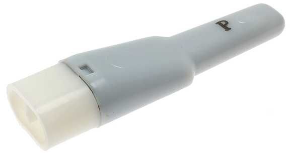

Never had to change this part (knock on wood) but here is what Rock Auto shows for an 89 GT (I do not know the year or engine of the OP.) I am almost positive for an 89 that it is in the radiator, but given some of the replies, I take it that in later years it was in the overflow reservoir.
http://www.rockauto.com/catalog/moreinfo.php?pk=936562

To add to this, when you unplug it, the end of the sensor is right where the plug was. It matches the color of the tank (on mine at least), so it can be hard to notice easily if you haven't seen it before. You just grab the lip of it that's sticking out & pull down until the whole thing slides out.heavywoody wrote:The sensor is inside the overflow tank. You'll have to pull it out with some needle nose pliers.
Here's a pic I found on google of what mine looked like. The lighter colored end is the part that is visibly sticking out of the overflow tank. You just pull it out, slide the new one in, and clip the connector back on.

^^ yeah that is the part. I am picking it up tomorrow morning when its shipped in. I assume I need to drain the overflow tank and remove the tank from the car so I can access this? Or can I just leave the coolant in there and find a way to get under there and remove the sensor?
(3100 sfi, 94 base )
Drain it. Pulling the tank is easy and will make your life simpler.
