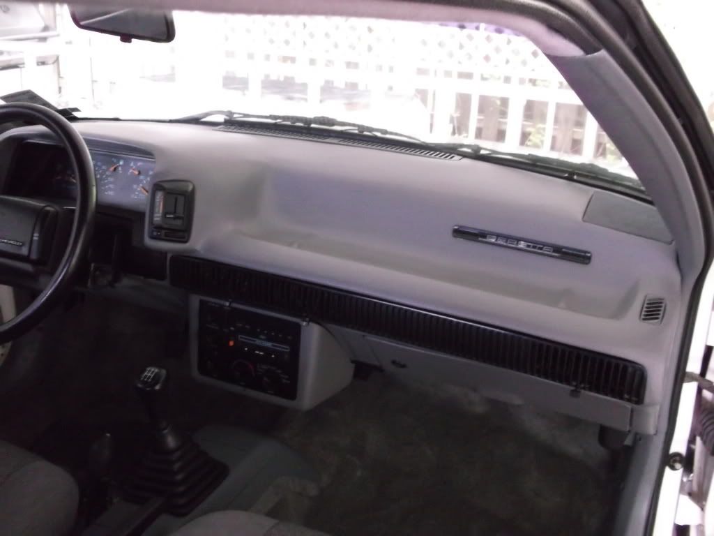

Re: dash help.
My dash on my 1990 GTZ has been professionally restored by Dashboard USA in Oregon.
I had to remove the entire dashboard, package it up to include anything that touches the dash (windshield defrost vent, gauge cluster bezel, door defrost vents, A/C vents, radio bezel, glove box, light and wiper control switches, speaker covers, fuse panel cover) It cost me approximately $150.00 to ship and approximately the same to ship it back. The site at the time said approximately 5 week turn around and about $550.00 for the restoration. The price remained the same but took about 8-9 months to get the dash back. If I recall the owners name is Pete. We were in constant contact throughout the process. It turned out to be a bit more difficult than anticipated and he did make a comment that he did not realize the type of dash it was. Something to that effect. I think he was commenting on the construction of the dash.
Luckily I am a very patient person and all I was concerned with is QUALITY. When I finally got the dash back I was nervous to unpack it as I did not have any pics of the final product. But, I was VERY happy with the dash.
Dashboard USA 360-892-4075 ask for Pete (I think that's his name) Just talk to him and discuss it. He may be reluctant to do another beretta. Never know. My 90 GTZ was done about 21/2 yrs ago.
I am a new member and joined a month or so ago I'll take a pic and try to upload.
Re: dash help.
[img][IMG]http://i1070.photobucket.com/albums/u493/Mojeaux18/th_DSCF0039.jpg[/img][/img]here is a pic of the my restored dash.
