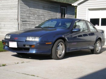

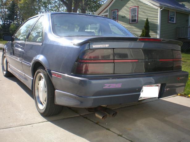

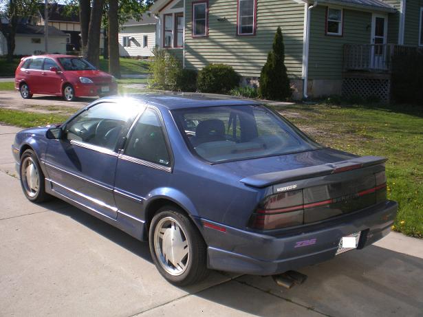

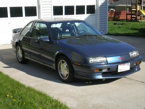

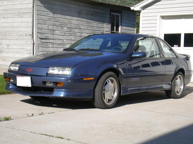

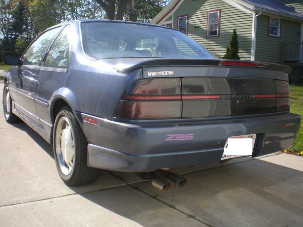

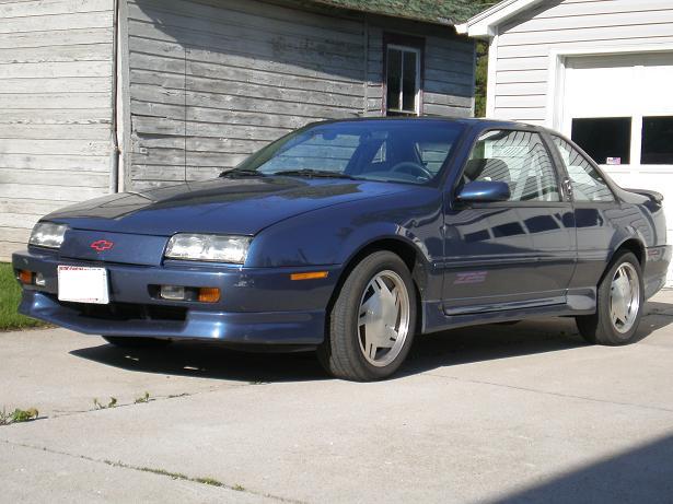

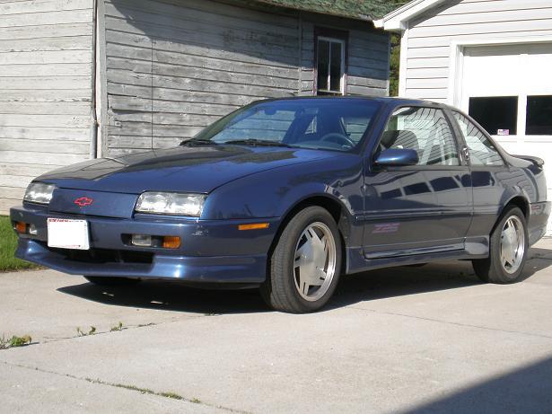

Here's my new 95 Z26 that I picked up last week. Needs some work but I'll be fixing it slowly as it is a second vehicle. I did throw my GTU wheels on as I truly hate the Z26 wheels. Here's some pics:

Looks pretty sharp. I think the GTU wheels look really good on there. I'd suggest painting the inserts body color to match the rest of the car

Yeah, I've been toying with that idea. I have to replace the cracked spoiler and I'm thinking of getting another decklid and putting on my spare GTU wedge. I figure when I get that painted I may have him paint the wheels too. There's quite a few things to take care of first tho.

Looks great! That color is awesome! The GTU wheels do look great on it!

Nice find. Not sure how I feel about the wheels, but then I guess I always like the Z wheels.. LOL But those look good there with that color. :P

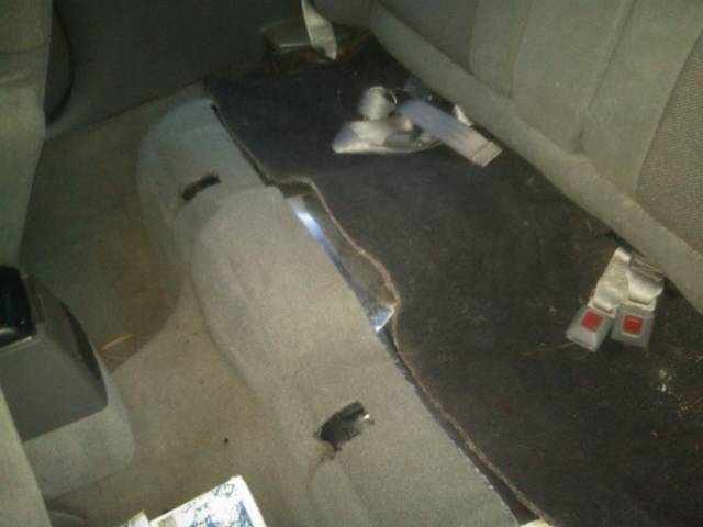

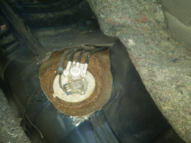

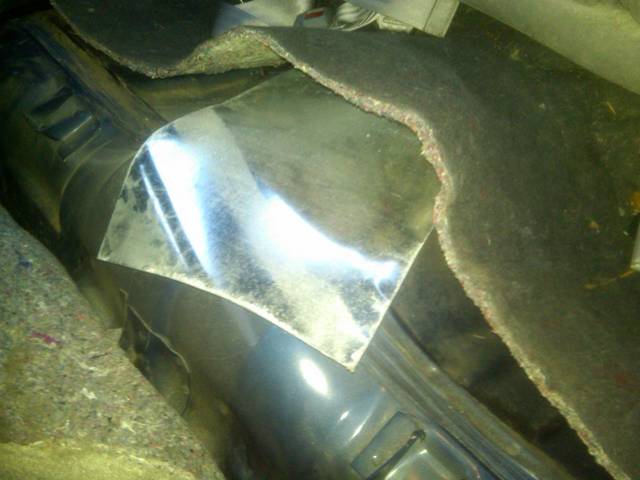

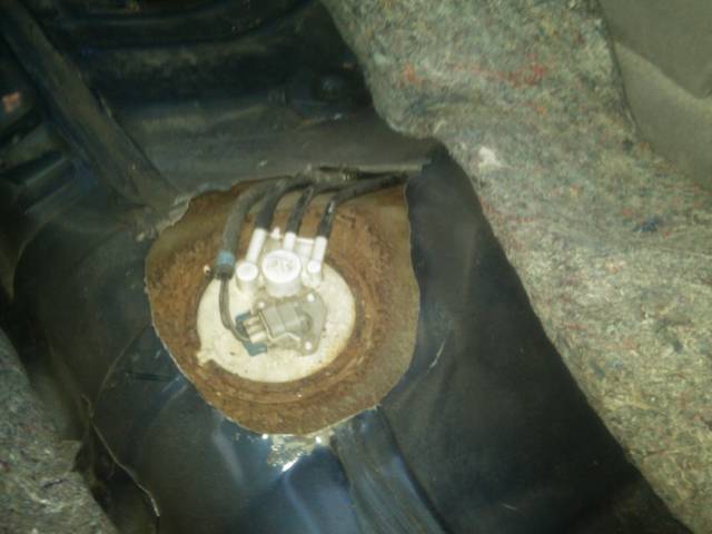

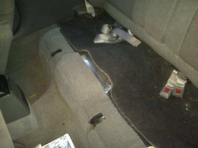

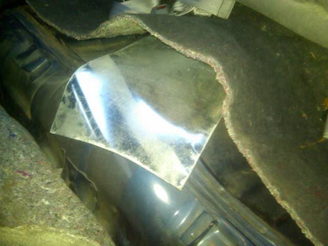

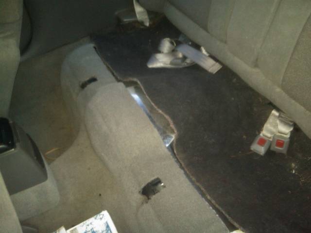

So this afternoon I took some time to start going thru the car to see what shape the trunk and floor were in. The plan is to fix whatever rust I find with some sanding and a good coat of POR15 before hitting everything with undercoating. Well I was VERY pleased with the trunk and shock towers. When I went to pull off the last piece of insulation I had to pull the rear seat and seat back out to free it and when I did I stumbled upon a level of idiocy that I've never seen before. Here's some pics:
Yes that piece of tin was just sitting there loose.

So out of complete laziness this effin moron ruined what was a really nice floor. Now I've got that much MORE work to do. I'm a firm believer that this world needs an enema, and they could start with this DB.

Wow. Now that is lazy. Effective I guess, but then you don't know for sure who did it either do you? lol

That's not just lazy...that's a safety hazard with fuel lines not properly isolated from the passenger compartment.

Wow, I know some do that to gain access rather than dropping the tank, but they properly close up the hole re-using the part they removed.
I'd pay the guy who owned it a visit and ask him if he worked on the fuel pump at all...

Make a bolt on cover to cover that up. My 240 and my BMW has those. I changed a fuel pump in the BMW in a parking lot in 20 minutes.
Just a piece of 14 gauge sheet, some rivets or speed nuts, and some fuel proof gasket material would make a safe cover. So convenient when the pump needs to be changed

I agree on making a bolt on cover =). If the PO had thought about it a bit more than an easy way out, I would have said that it was an awesome mod.
