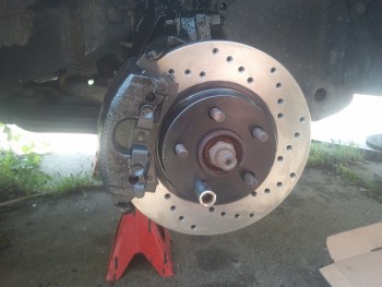

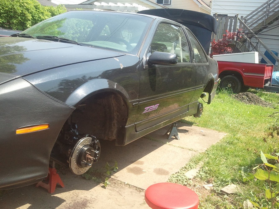

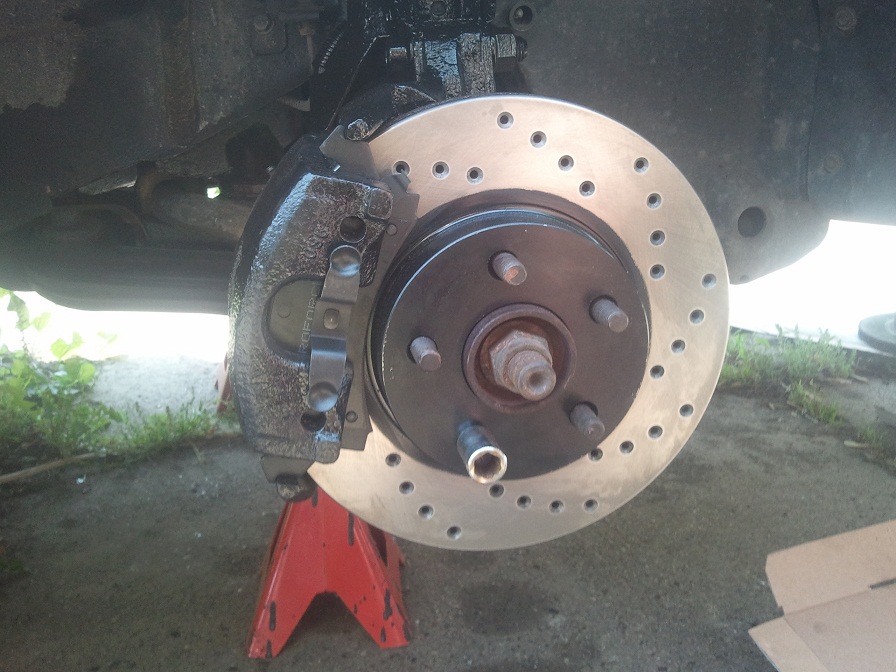

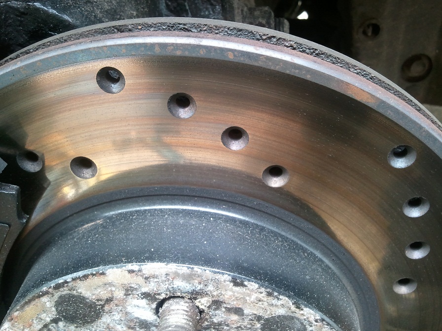

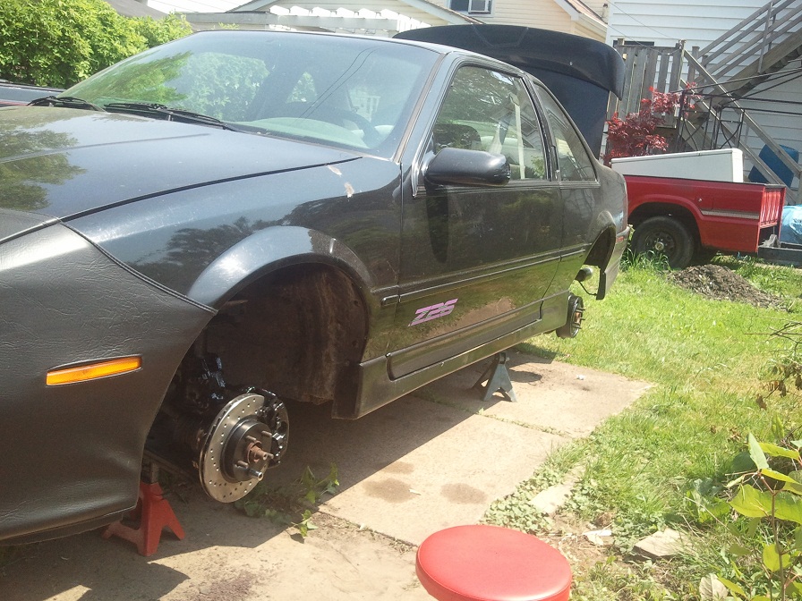

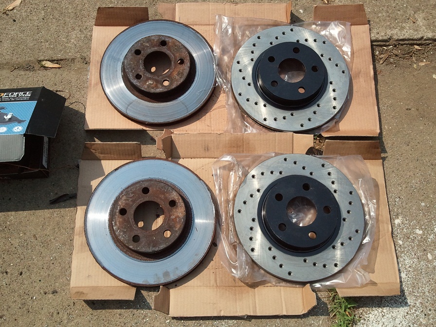

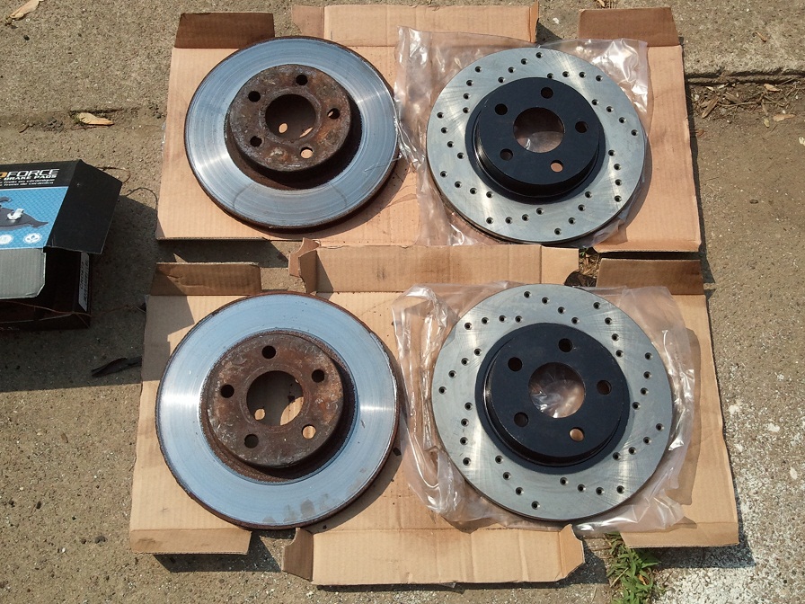

pretty stoked! it'll be nice to have fresh brakes to not worry about on the front! i'll keep updating over the next months and years to see if they end up warping or cracking. they were bought from a canada seller "hansell autoparts - VIK AUTOPARTS DISTRIBUTION INC. (hansellauto@gmail.com)'' for a total of $75.71 US taxes in (canadian 13%) shipped to my door. they are stock thickness rotors, not thinner/lightweight. pads, meh stock style, we'll see how much dust they blast off. an additional charge of $15 and i could have gotten ceramic pads... figure i can upgrade to ceramic later if i don't like these, and get a better brand as well.

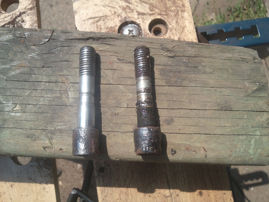

i chiseled off much of the crusty rust on the calipers, mounts, hubs and lower portion of the old struts. then wire wheeled to acceptable look, and then blasted with black paint. nice and fresh! pulled out the slider pin bolts and cleaned them, and lubed them back up.
i'm now waiting for the paint to dry on the upper shock mount plate for the rears... yanked out my completely dead shocks, and almost finished installing some fresh KYB excel g shocks. looking forward to the feel of that as well! new monroe strutmate mounts as well even though the old ones still look great. pulled the rear drums to chisel and wire wheel them as well, fresh black paint!
i will take a caliper to the new and my old rotors and measure the thickness and post it up soon enough as well.

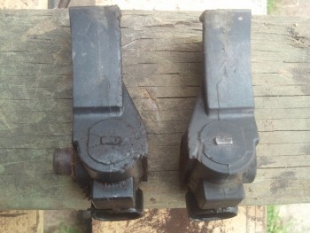

1st pic above shows the box the pads came in... unless ceramic pads have shiny metallic particles in them as well, they most certainly were just tossed in this box... i originally asked how much the upgrade was, then i opted not to pay the extra, but this box came i was pretty happy! but i scuffed up the pads before installing and noticed metal flakes...

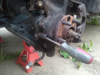

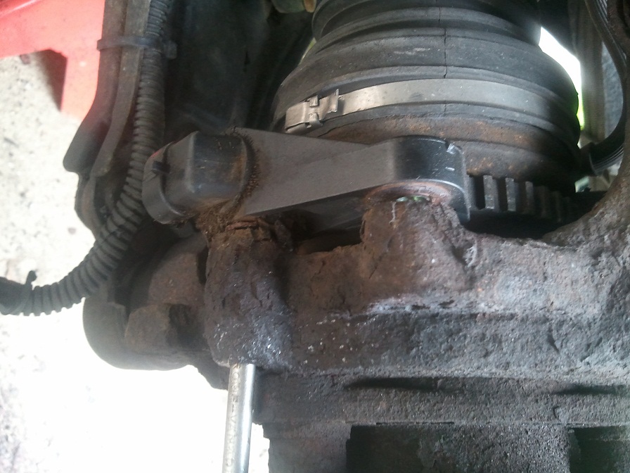

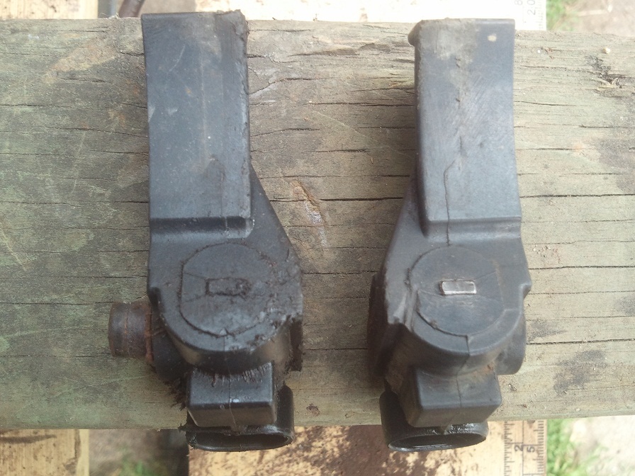

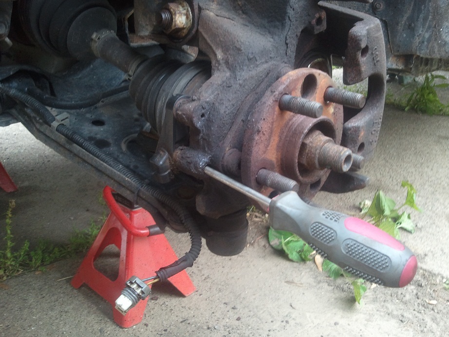

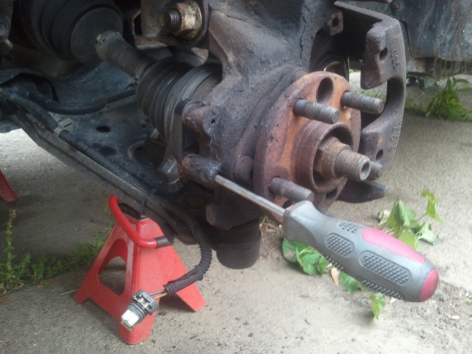

2nd pic is a straight forward way to pop your ABS sensors out (after you undo the one screw). gently tap it out with a screwdriver and a hammer. i put anti seize on the plastic as well, if i ever need to pull it out again. the first sensor on one side, i did break the tab there... it's not hard to break if it is original. a bit of JB weld upon assembly, and it should be good to go... i also cleaned the metal stub that reads the wheel on the axle... it was pretty crusty on mine... so maybe my ABS will work now! not that i really want that...

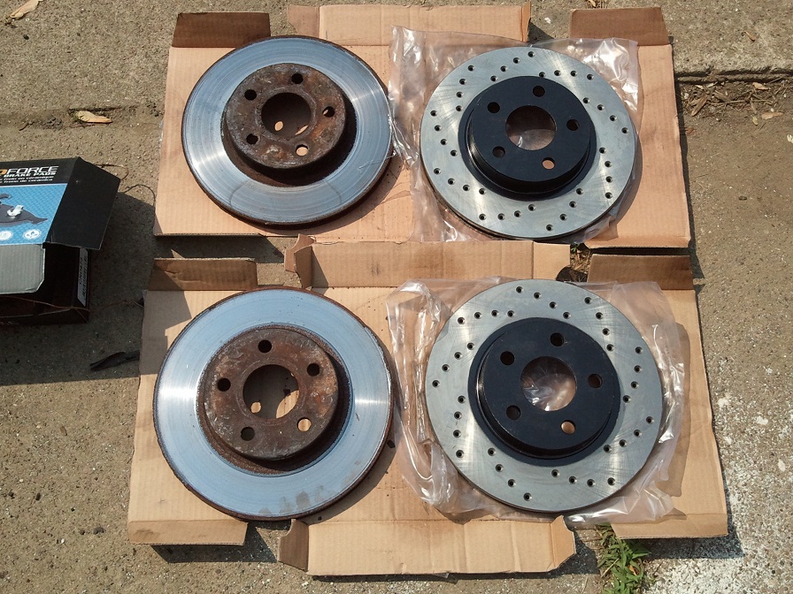

ok new ones are 0.804"(20.43mm), and my old ones i pulled (mainly warped... i recall last time i checked they should be able to be resurfaced... still in spec) are 0.781" and 0.782" (19.93mm). i really need a passenger side wheel bearing now! a lot of play in that bastard! i'm hoping to get a hold of a socket that will fit that... should be able to rent it free in the area, or borrow. try to snug it up, see if that will work for now.
