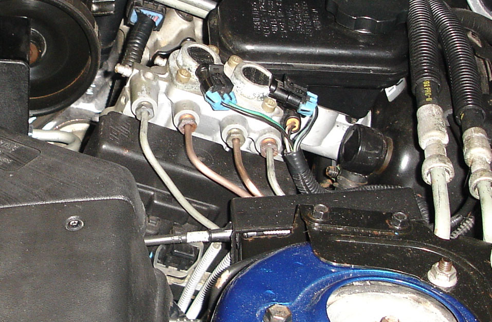

I work in a repair shop and we use EZ-Bend brake line that Napa sells to repair all brake lines. you dont need a pipe bender to work with it as it bends and forms easily by hand which is awesome if you have ever tried to bend your own lines. We buy it by the 50ft rolls since we do alot of box trucks and stuff, it costs about $80 for that 50ft roll. The best part is it doesnt rust and its the last time you will have to worry about replacing your brake lines. they are also easier to flare than regular steel lines.

here is a link, they have 100ft rolls. its $1.97 a foot

Cunifer
Cu copper
Ni nickle
Fe(r) Iron
I sell the AGS brand stuff at work, it's great for first timers and for any tight spaces. In fact it's great for anyone, but it is more expensive.

I've done that 2 years ago for the rear lines, all the way from the front to the back. Great material...
